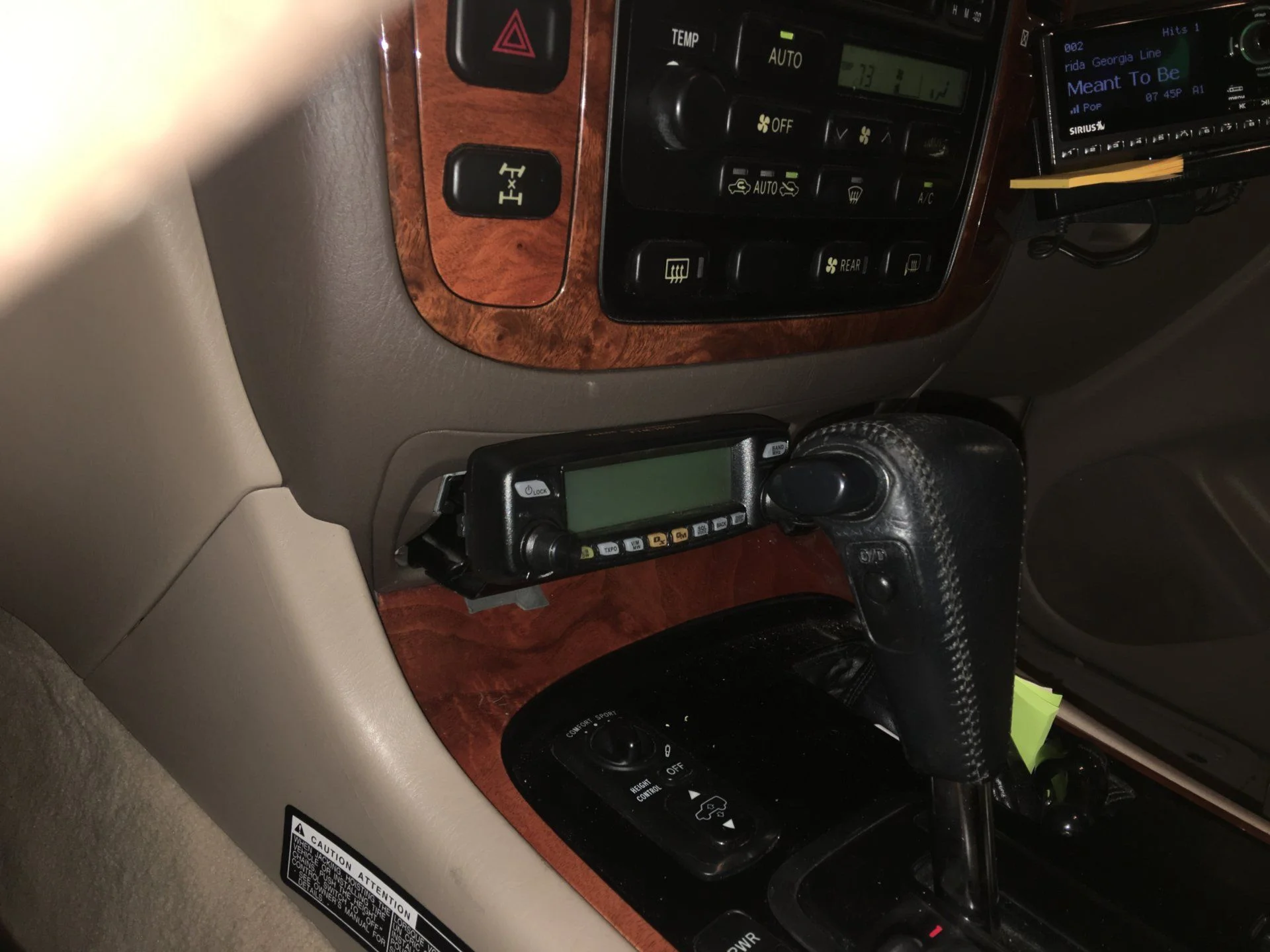

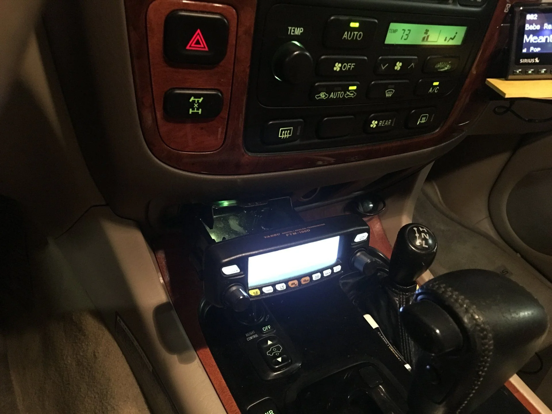

Here are a couple pics of my Yaesu FT-8800 install. I removed the worthless flip-down sunglass holder and made a bracket to hold the faceplate. The main radio box is mounted to the back side of the mesh grill for the factory subwoofer in the back cargo area. The subwoofer was removed and replaced with another sub that I have built into my rear storage system, but there are several places you can mount the small box back there if you get creative.
I fabbed up a really simple metal bracket and the face plate is rock solid. The mic extension is routed down the passenger A-pillar and out trough the dash in front of the shifter. The antenna was mounted on a Labrak mount in the back. Sound quality is great.
