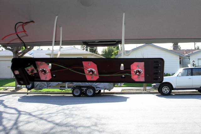

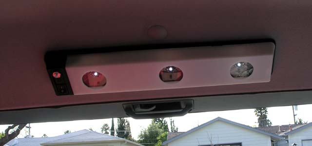

MORE light... The old fluoro tube died (yep, they do). Gutted and installed 3 1W Luxeons and opened up the diffuser since Luxeons are close to 180 degree beam width already.
Yeah, tiewraps! Worked well for several years already.
Buttoned up and the LEDs set to dim level (the driver I used has 8 output levels - selectable via a single switch).
Late dusk and boy it's bright back there now :D
george.
pretty nice George, that sure does produce alot of light .
