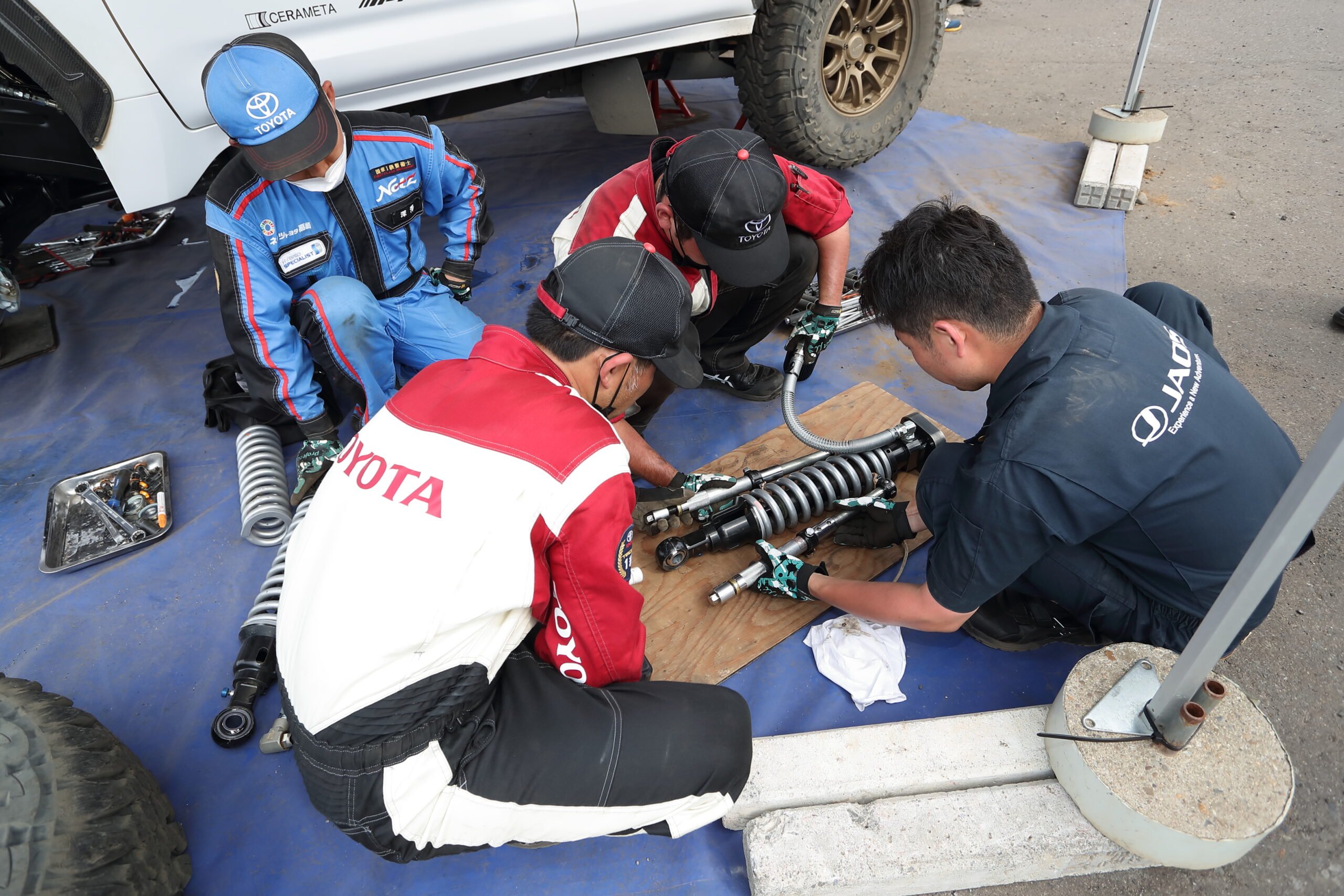

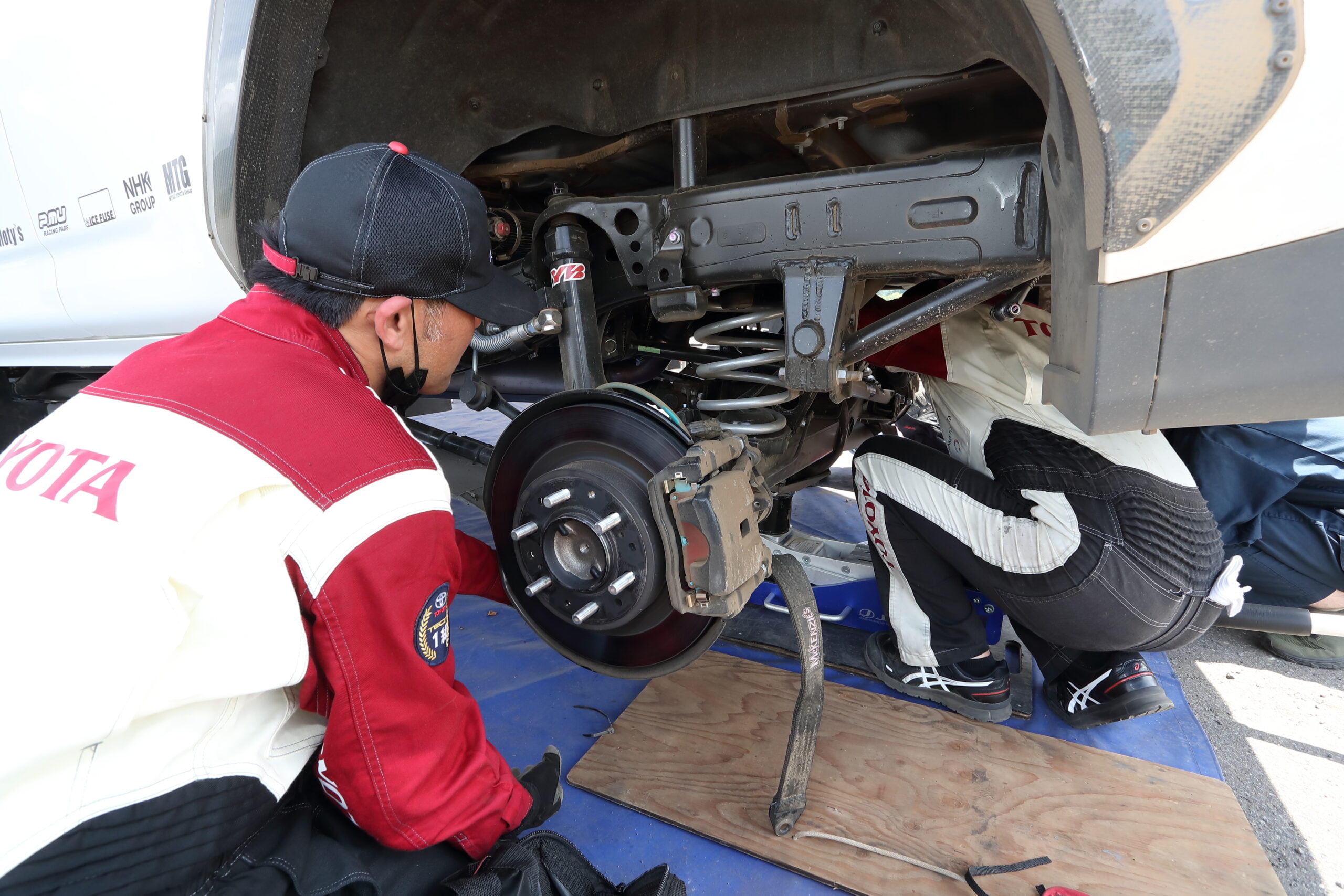

Can you share anything about what suspension Jaos chose to run on their 600?
Looks like KYB shocks, seem pretty small compared to Monica. Is Monica also running a tube from the pan hard mount to frame like they are on the 600?
No. We've not dealt with any cracking or issues with the frame side panhard/track bar mount. We have had issues on the axle side, primarily the captured nut breaking loose.
That’s dramatically smaller than Monica’s Kings! But Monica was custom built by a top TT builder. Hope those KYB’s hold up 😬
Yes, they would work for rally racing, not Baja. I bet some Class 11 bugs have more oil in their shocks than those KYBs. I have seen some massive reservoirs on them..
