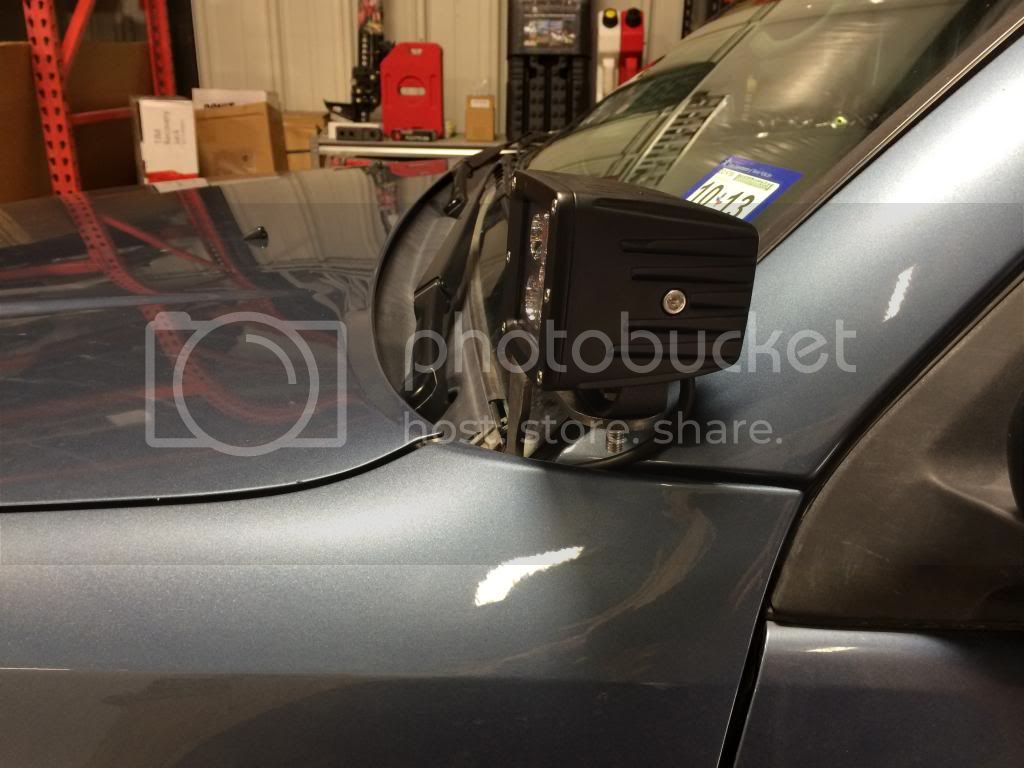

Anyone verify the ones pictured in the beginning of the thread won't work? Seems like they would be easy to make work on just about hood hinge.

As far as the mirror / bracket clearance scenario I have already considered this, and came to the understanding that the bracket should be placed similar to the one pictured at the o.p. the reasons are as follows:
-Line of sight, my goal is to minimize view obstruction
-The bracket needs to be outward enough to clear the wiper arm, and inward as much as possible to not extend past the folded mirror profile (obviously light choice will be a major factor in the effective clearance.

I considered this as well. The lighting width would be somewhat limited because the pod will be wedged between the mirror, and the wiper arm. Every light pictured would be able to be mounted via one hole.
Honestly, my biggest hang up is likely something that has nothing to do with the design of the bracket. My concern at this point is wiring. The bracket itself is going to be mounted between a pinch point, however the wiring would not be able to withstand that route for any significant amount of time. Any ideas outside of drilling the hvac intake? I have no qualms about drilling, but I would presume that this would be a deal breaker for most. Input please?
