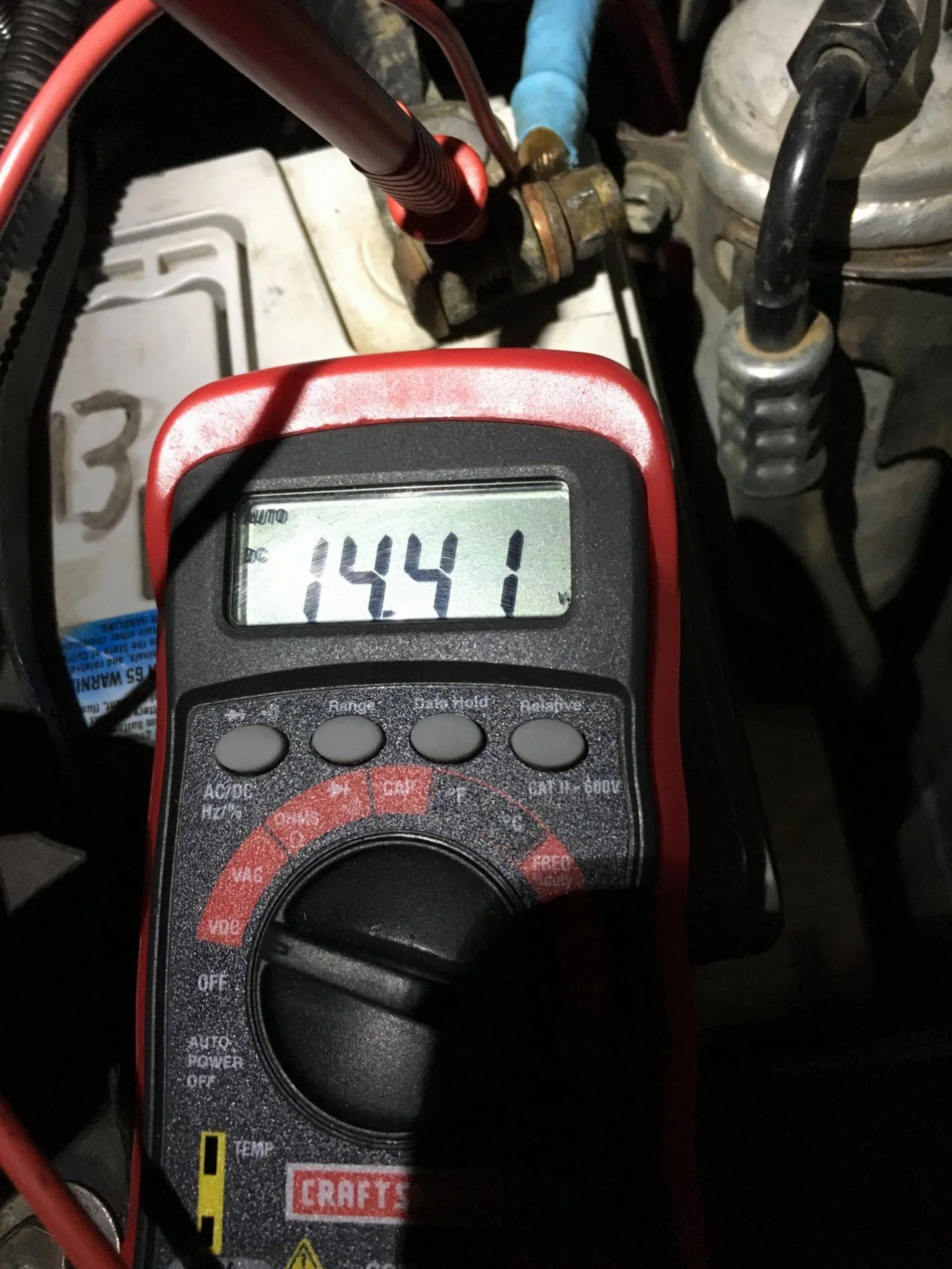

I ended up swapping the L & I connections on the old alt. plug, since their functions seemed to be reversed, and now everything is happy.
To summarize:
On the FJ60 factory alt. plug:
Yellow ---> L
Black/yellow ---> I
Battery+ ---> S
= Working Lamp & 14.4V output with everything running.
I even used three different color wires so you wouldn't yell at me :grinpimp:

Operational update:
First few minutes of my drive to work, my scan gauge is showing 14.2 - 14.8V.
Pulling into work 15 mins later, it drops to the mid 13's.
Looks like it's working!

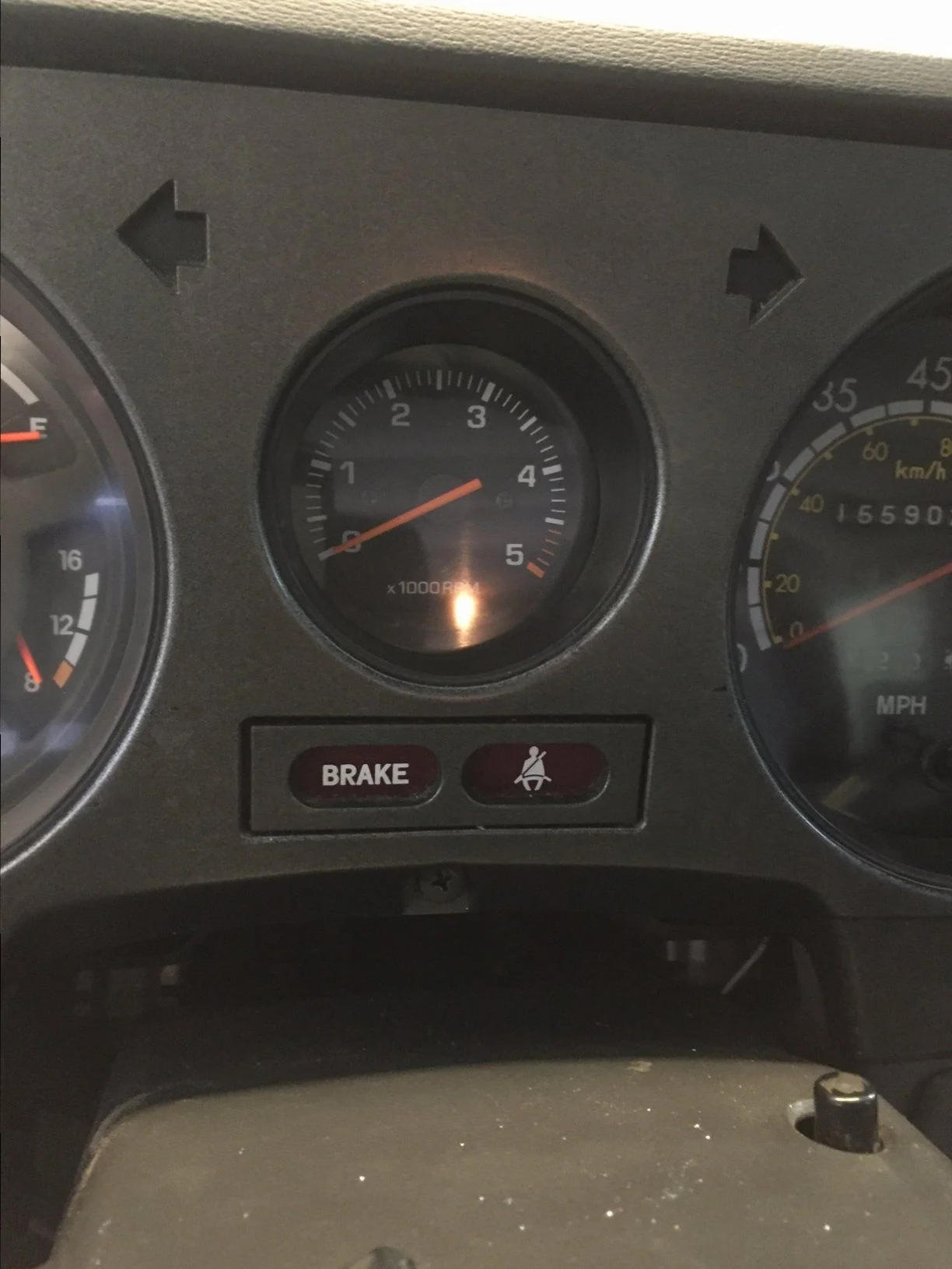

First, I upgraded to a 62 tach. Plug and play. Worked AWESOME!
But when I put the AC AMP from the 62 in, tach doesn't work! Neither did the original tach with the 62 AMP.
Unplug the AMP--Tach works! I remember you saying there were some wiring mods that you can/did do with the 62 AMP. Did not get to the AC yet. Tackling one gremlin at a time.

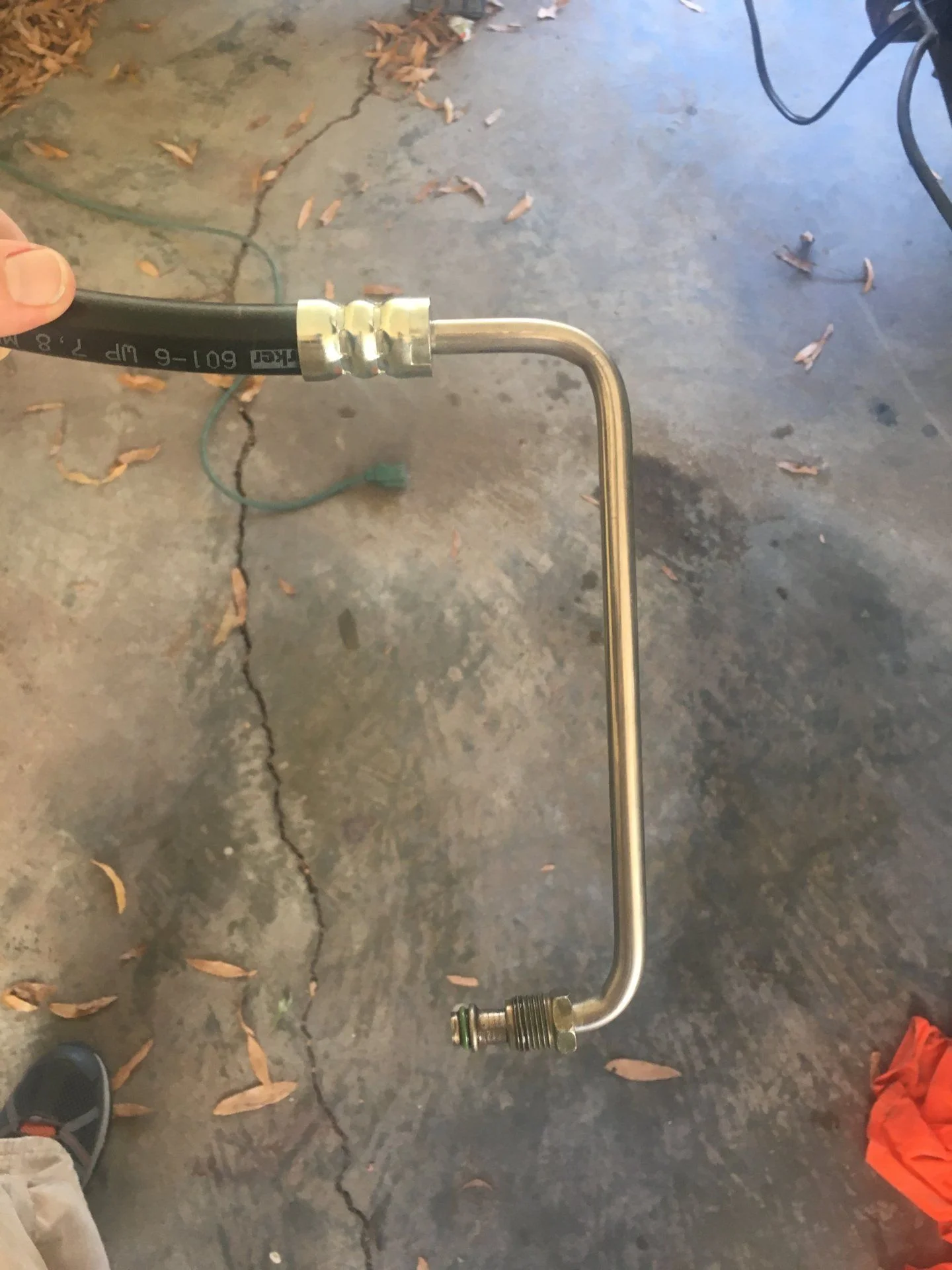

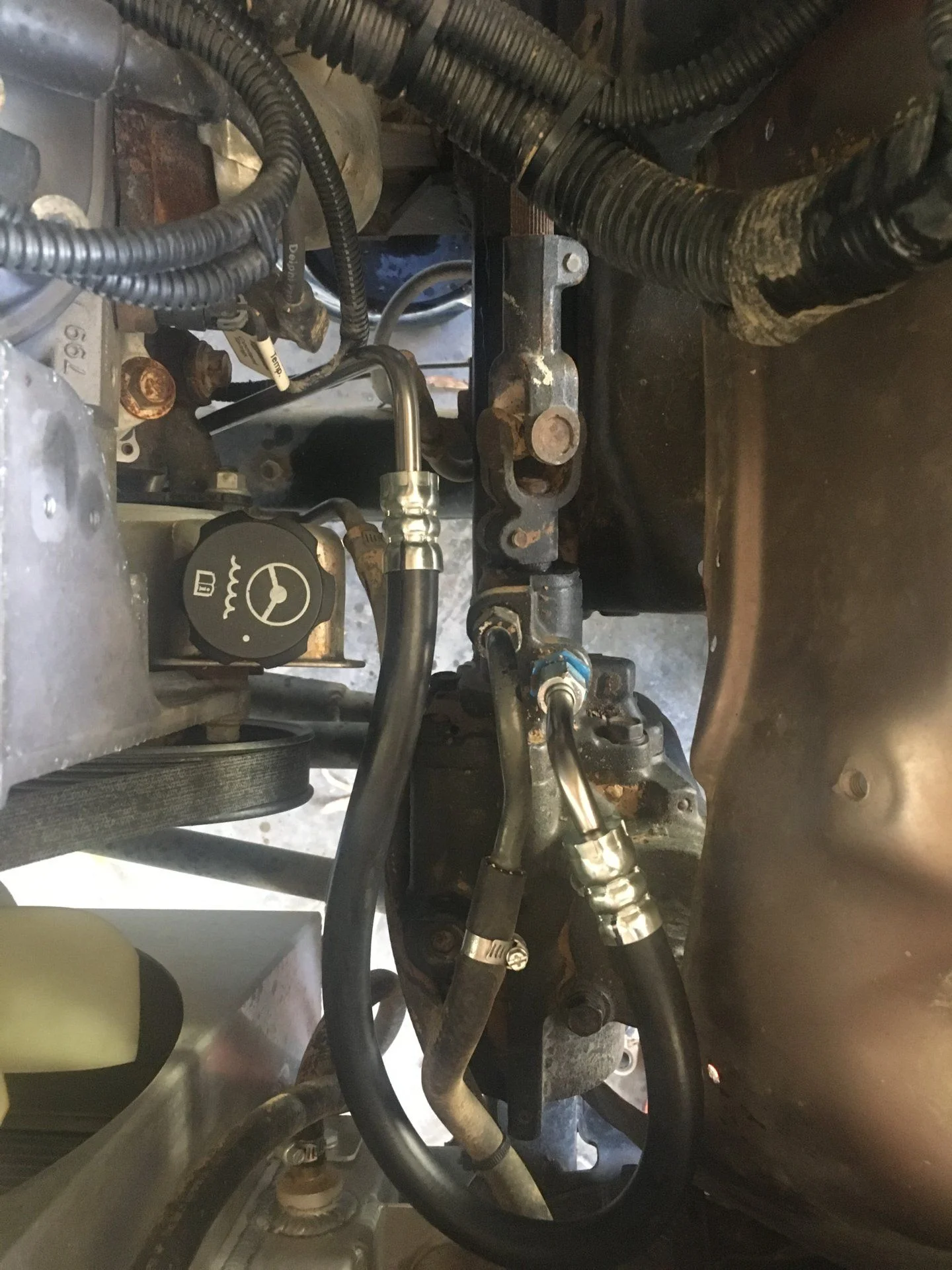

I’ve got a cross country trip coming up, and noticed that the PS hose that the hydraulic shop made is starting to crack...
Not wanting to chance it, I called my man to come out and make a custom hose...
He put a new GM end on the pump, and an AN fitting on the box end, since the Toyota fittings are not super common. This will make it easy should it ever need to be reworked in the future...
The hardline line (which is stainless so it should remain pretty) is bent to get the hose well out of harms way from exhaust or the serpentine belt.
Now I’m kinda glad the old one cracked!
Funny things happen.
Not sure how I missed this. Did you ever get it sorted out?

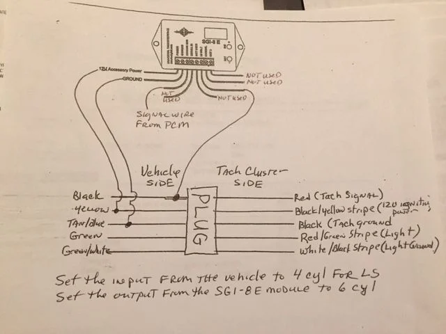

I did! I ended up adding a dakota digital SGI-8 E tach interface unit.
Here is how the 62 tach got wired in with the Dakota Digital Module
