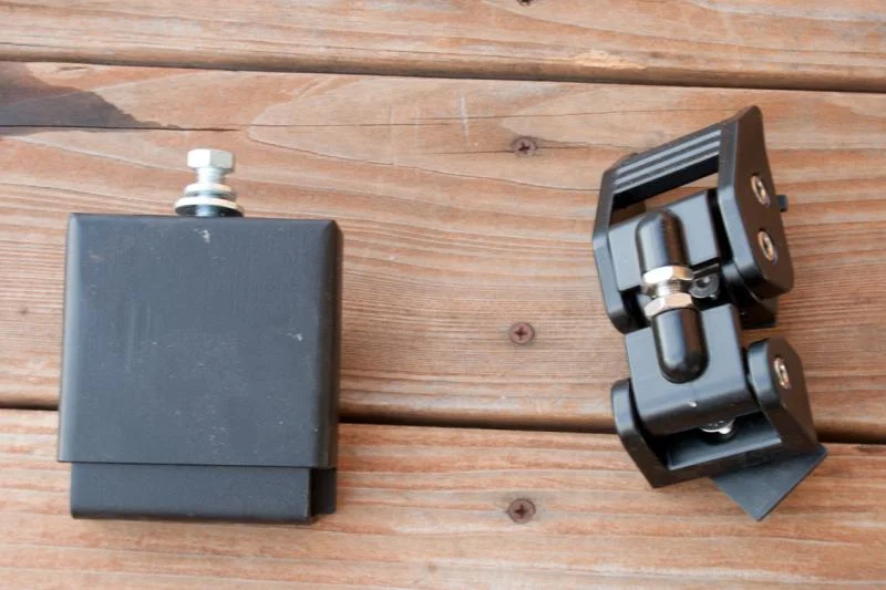

New hardware
Diamond Rax Bulldog 2.0 raingutter clamps
Rugged ridge latches

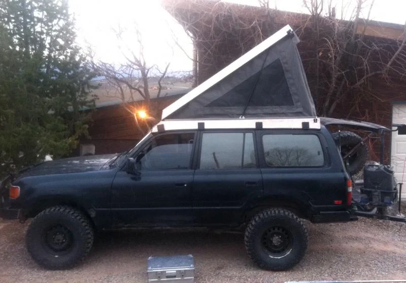

When I can afford it, I'll buy a Ganz GSP-55 55W flexible solar panel and install it toward the rear of the Campteq top. They're so thin - less than 1/4" - that it will be well below the top of the Mac's TieDowns lashing rails Eric welded to my top (and which I use in lieu of a roof rack.) Using the threaded studs that Mac's sells - and which Eric posted a photo of, you could easily fab up some square tube crossbars and be way lower than you'd be with Yakima or Thule bars for kayaks or a canoe - and remove the bars more easily than Yaks or Thule's.
As far as the height - one of the first things I did after Eric and I cut the roof (took about an hour, BTW) and installed the top in Flagstaff was to drive to downtown Flag and zip into the underground garage in old town - where I could never venture with my AutoHome Columbus on a Hannibal rack.
My truck has 33" tires (BFG AT's, LT 2345/75 R16) and a 2-1/2" OME's all around. The distance to the top of my Campteq top - to the top of the Mac's rails - is 81"
Another 80 with the same tire/spring combo might sit a bit higher, since my truck weighs, fully-laden, about 8200#, believe it or not. I've got a 45 gallon stainless WVO tank where my spare used to live, the spare on a Kaymar rear bumper's swingaway, a 32 gallon stainless water tank on a 2nd swingaway, an ARB fridge, slide-out stainless table, 4 heavy Pelican 1550 cases with tools, spares and camp kitchen, and another 40 gallons of WVO in 8 - 5-gallon Sceptre Nato cans in a compartment where the rear seats used to be.
