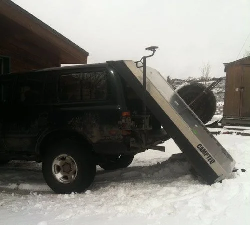

I weigh 160# and when I walk on the top, it does not sag - there are 1" x 1" tube aluminum "joists" running the short way about 30" on center, and they make the top very strong. Last summer, I had 4 Pelican #1550 cases on the top, at the very front, filled with spares and camping stuff - probably weighed 40-50# each, and 4 large mesh river-rafting duffles with hose for the onboard hot water shower hose, tarps, etc. - probably another 100# - and when I'd emptied the 8 Sceptre 40L jerry cans of veggie oil into my tank, they went on top too. Never noticed it. Plus I have the two Hannibal awnings attached to the top.

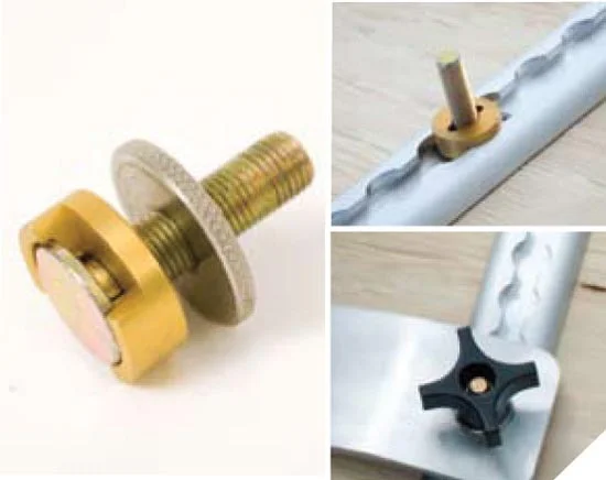

Solar panel and boards is not a problem without adding a raised crossbar. I haven't tried any canoes plus space for a panel. A semi permanent cross bar would be an option using some of Mac's threaded studs
I'm not positive about the roof capacity. I have had 4 mounted wheels and tires stacked 2 high and driven some trails that require lockers with the slightest chance of rain in the forecast. Everything held up. I have some welded and some drilled anchor points on my roof and I don't hesitate to use it like a flat bed whenever needed.
