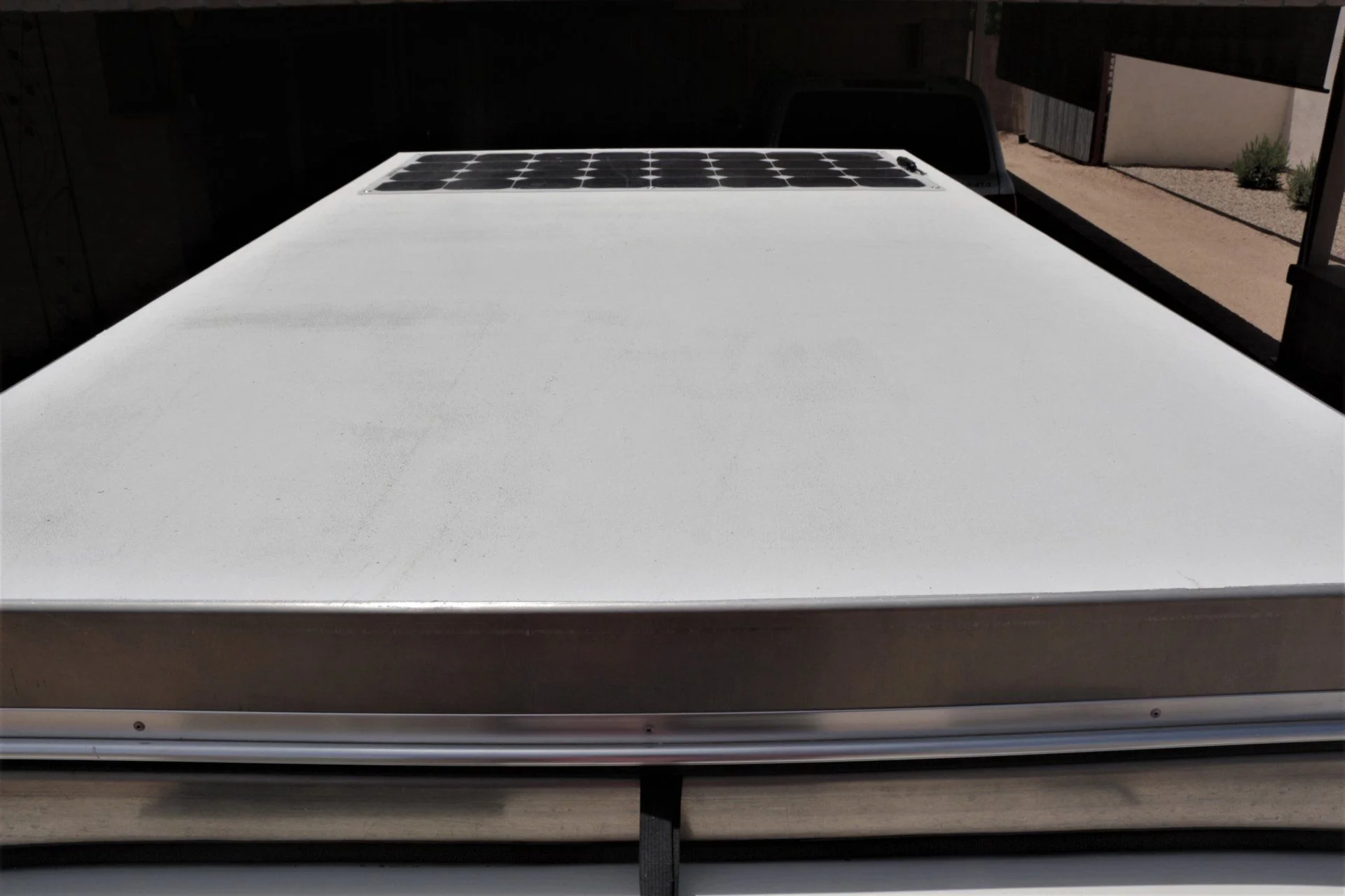

In the past if the sun was out it was hard to get on top of my CampTeq due to temperature. As many know aluminum is the worst for heat conductivity but the trade off is worth it for me because I would have trashed any other rooftop tent made. To the rescue steps in a nice donation from @TexAZ of some super cool Hy-Tech Bus Kote paint. After seeing and feeling the difference it made on TexAZ 200 series I knew it would help. Because it needed to be applied when cool I made a trip up Mount Ord for a 6800' spot of coolness. Paint is super fast drying and several coats I pulled the blue masking tape and called it good. Came down the back way and made contact with several low hanging branches and the paint is tough. Let the 80 set out in the sun for several hours of near 110° temp. TOTAL success very cooI to the touch and can stand on top barefooted without issue. I cant hold my hand on the unpainted side. UNBELIEVABLE the difference.
White now with some yellow and green stripes:wtf:
