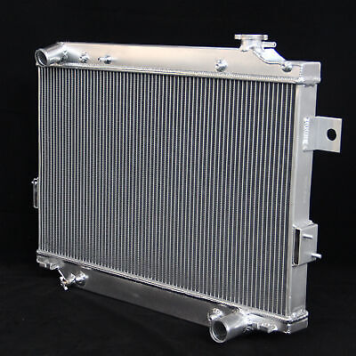

Do you have a PN or link to a oem aluminum radiator that fits the 80? All the ones I'm finding online are single row.
Any opinions on these?
