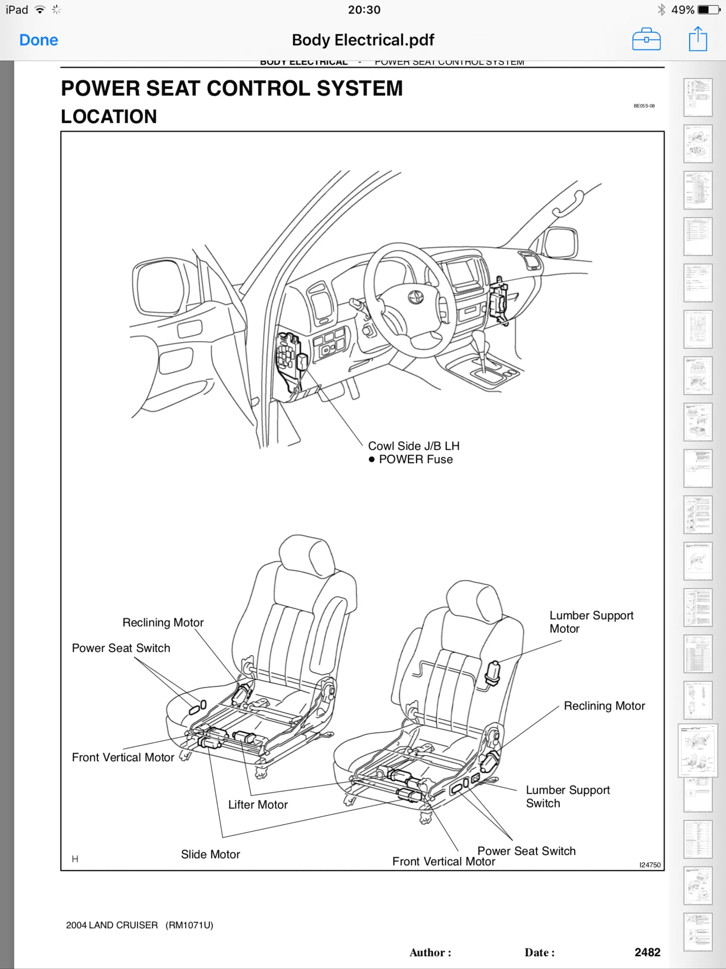

Shows it as a motor on the later models, I would presume they are the same.
I see same in 01 FSM. FSM also refers to "move forward", and "moves to release". So seems it's a motor moving a support. Not conclusive but does make one think mechanical movement rather than inflate.
Be interesting to see what you find Adam.

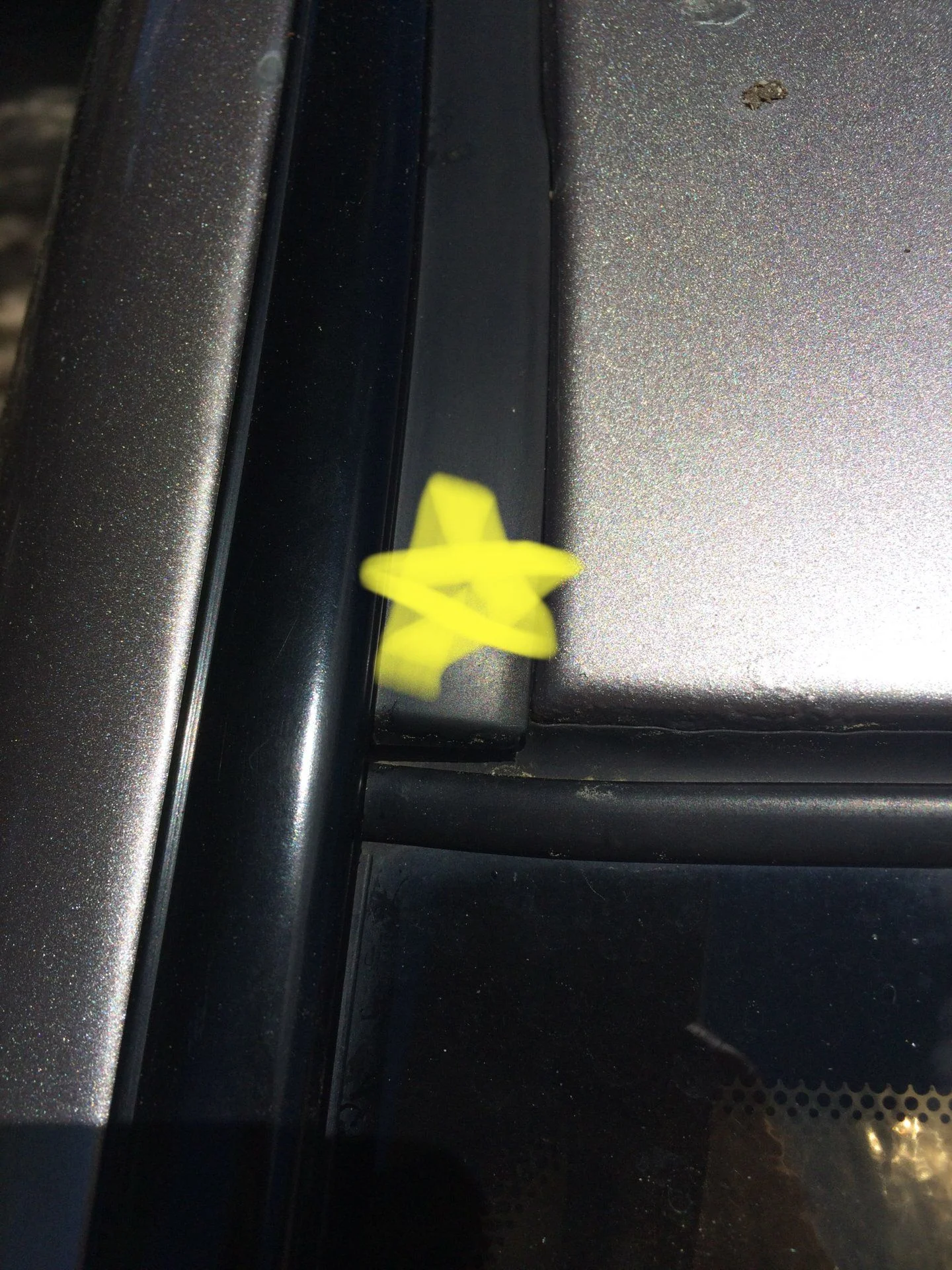

I know you said the part numbers vary on the moldings, and I found the PN for the moldings (left and right) themselves. What I can’t find a number for (or a name descriptor either) is for the strip in the rain gutter next to the molding.
Any guidance on the name or part number for the piece with the star from your picture Of the King?
It’s all one piece/one part.
Yep that is one side molding piece, just looks like two in pictures.
But inside the side molding is one more molding. It's just a strip of rubber "L" shaped. It covers rivets. Your old ones should be fine.

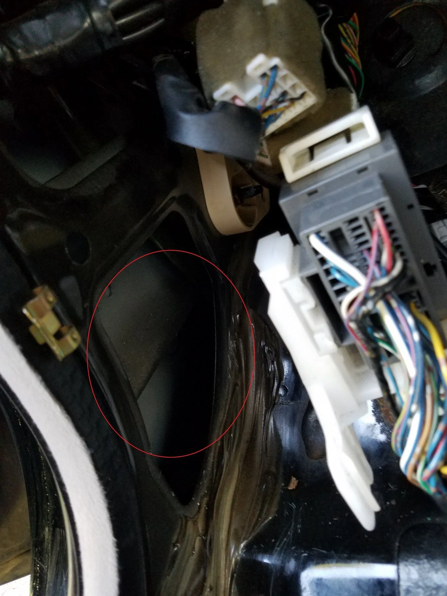

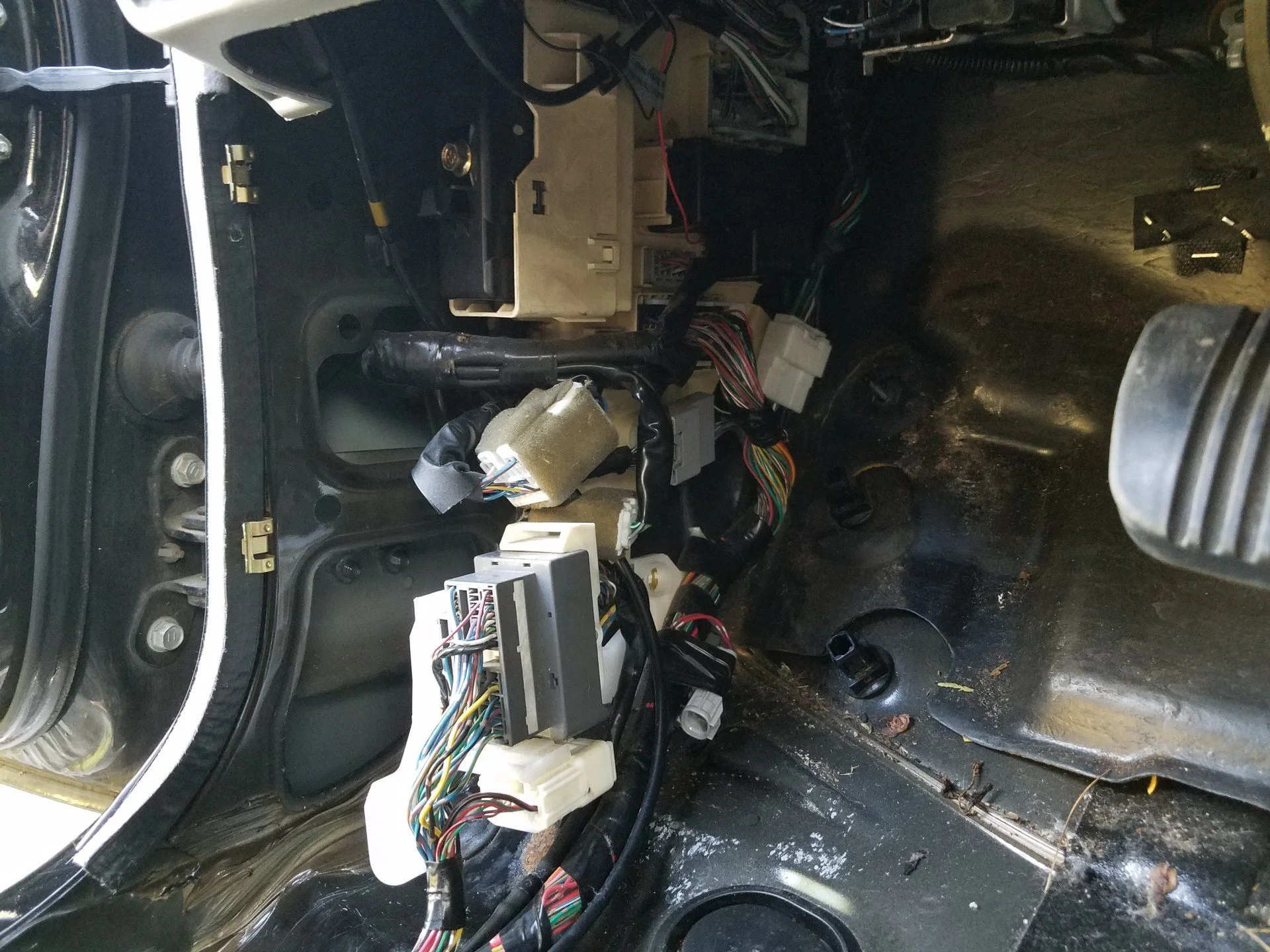

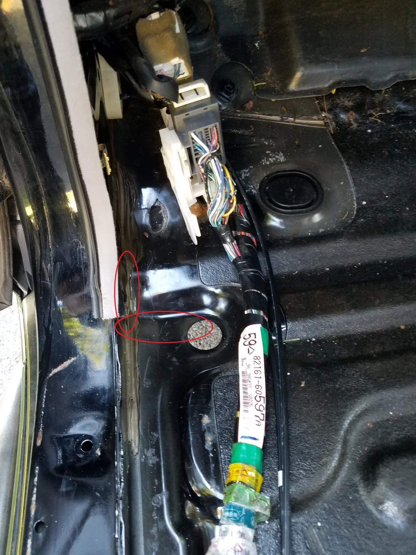

Now... The one I cannot find is one that is leaking behind the DS quarter panel. There's a foam in there that was drenched when I noticed a few drops on the floorboard.
This seems to be recent... There's no rust anywhere and the wiring is all dry. The water is behind the wire loom.
I don't see the windshield being the issue... I may be wrong.
Any ideas? I'm out of them.
View attachment 2630727Is that a missing bung in the picture right next to the “59”? Looks like pavement visible below.
