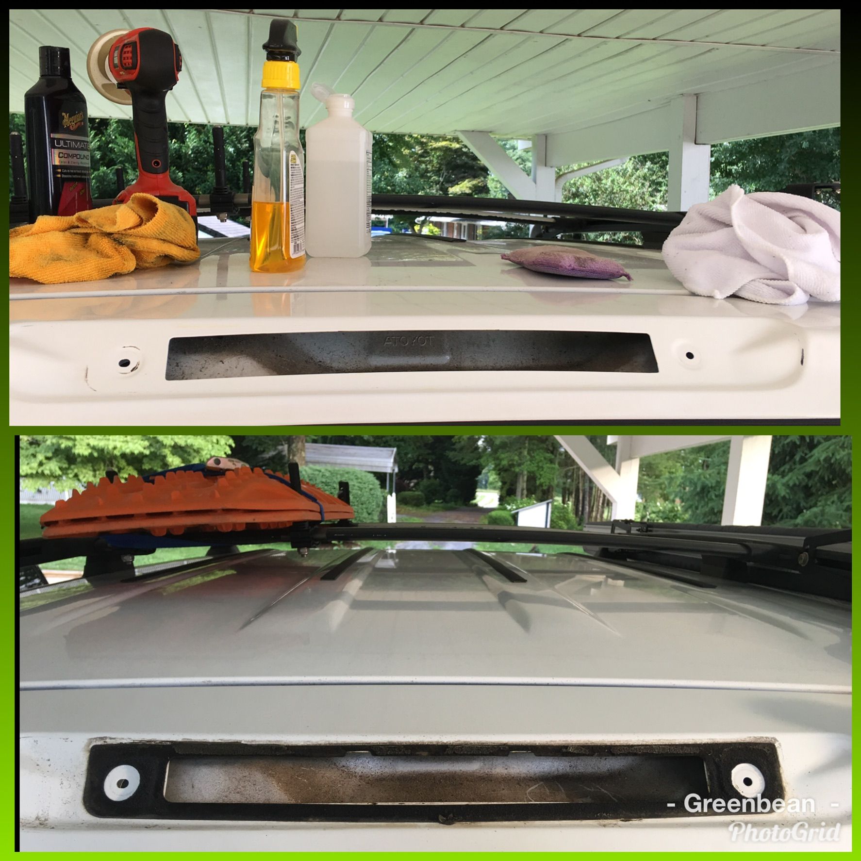

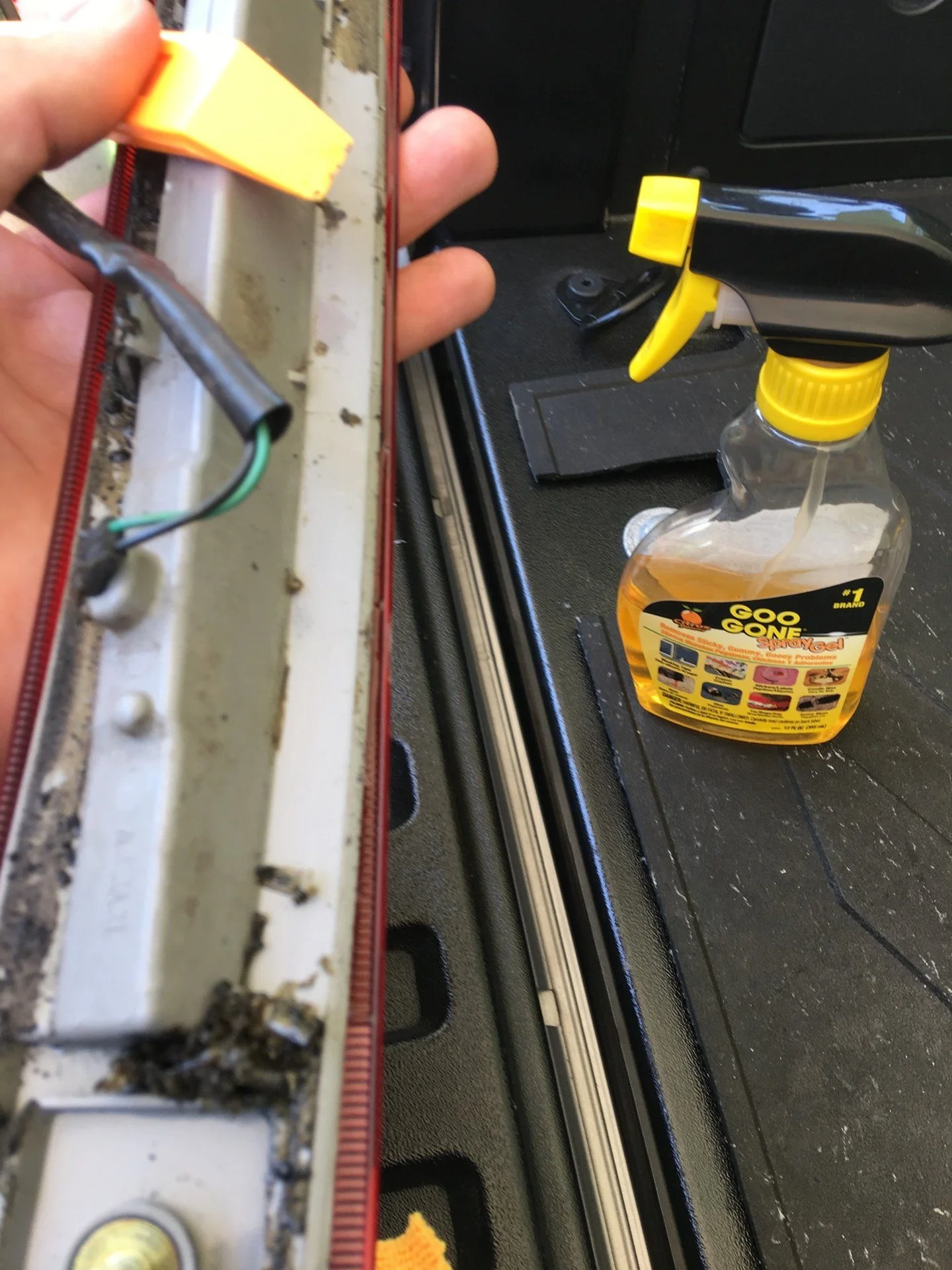

I FINALLY was able to remove all the old gasket and my first attempted RTV crud and now have a clean surface to work with on both sides.
Turns out soaking the area to clean in Goo Gone gell worked really well. The remainder on the body I removed with the 3M wheel, then cleaned it all up with alcohol.

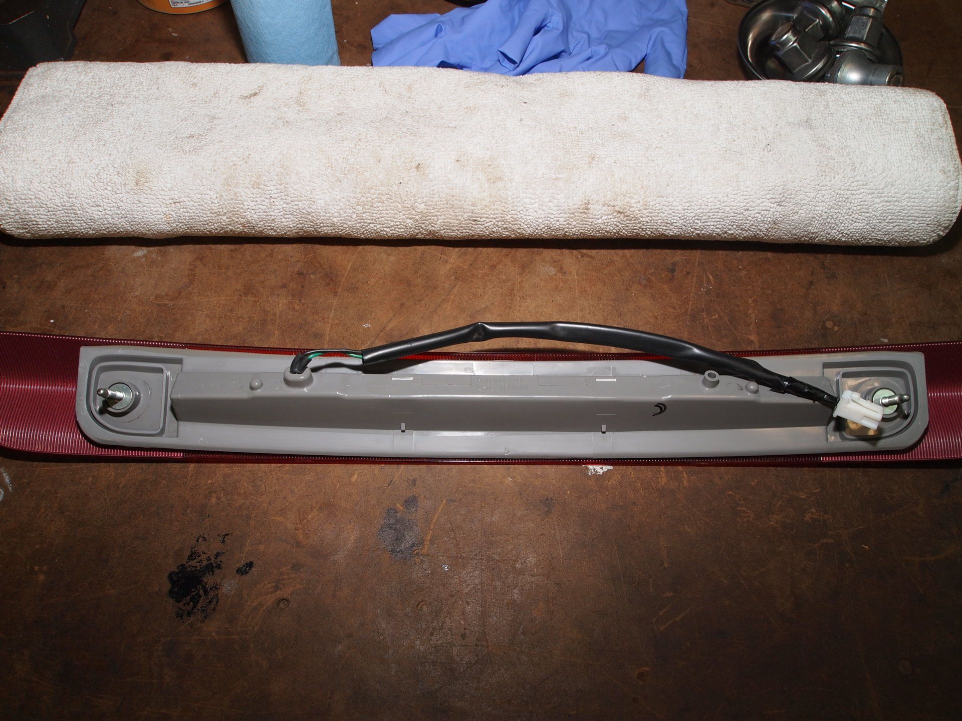

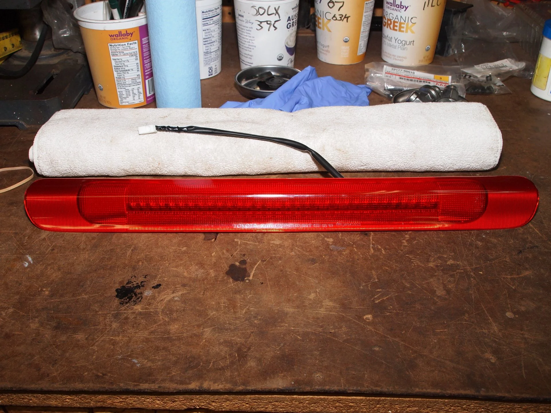

So turns out my original third brake kit is pretty warped.
Even with my valiant attempt and a couple hours of cleaning. I’m not sure it’s going to be waterproof.
So yeah I just got a 54.00 eBay China third brake light.
Just curious at this point what it looks like.
I’ll report back once I have it in and I will photograph it vs my original.

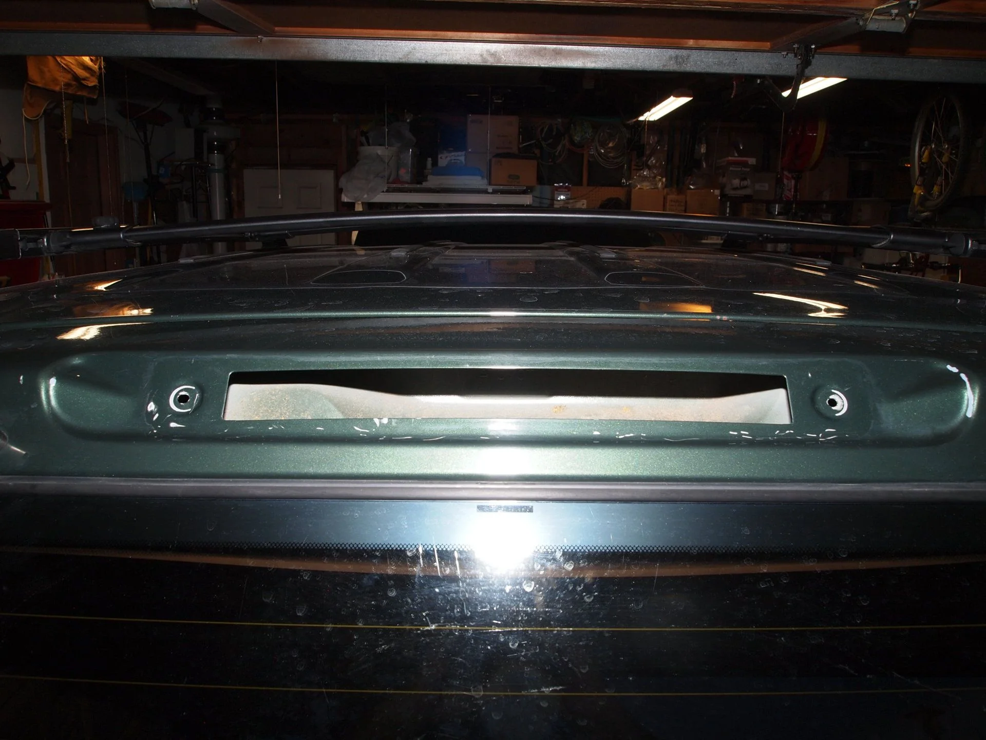

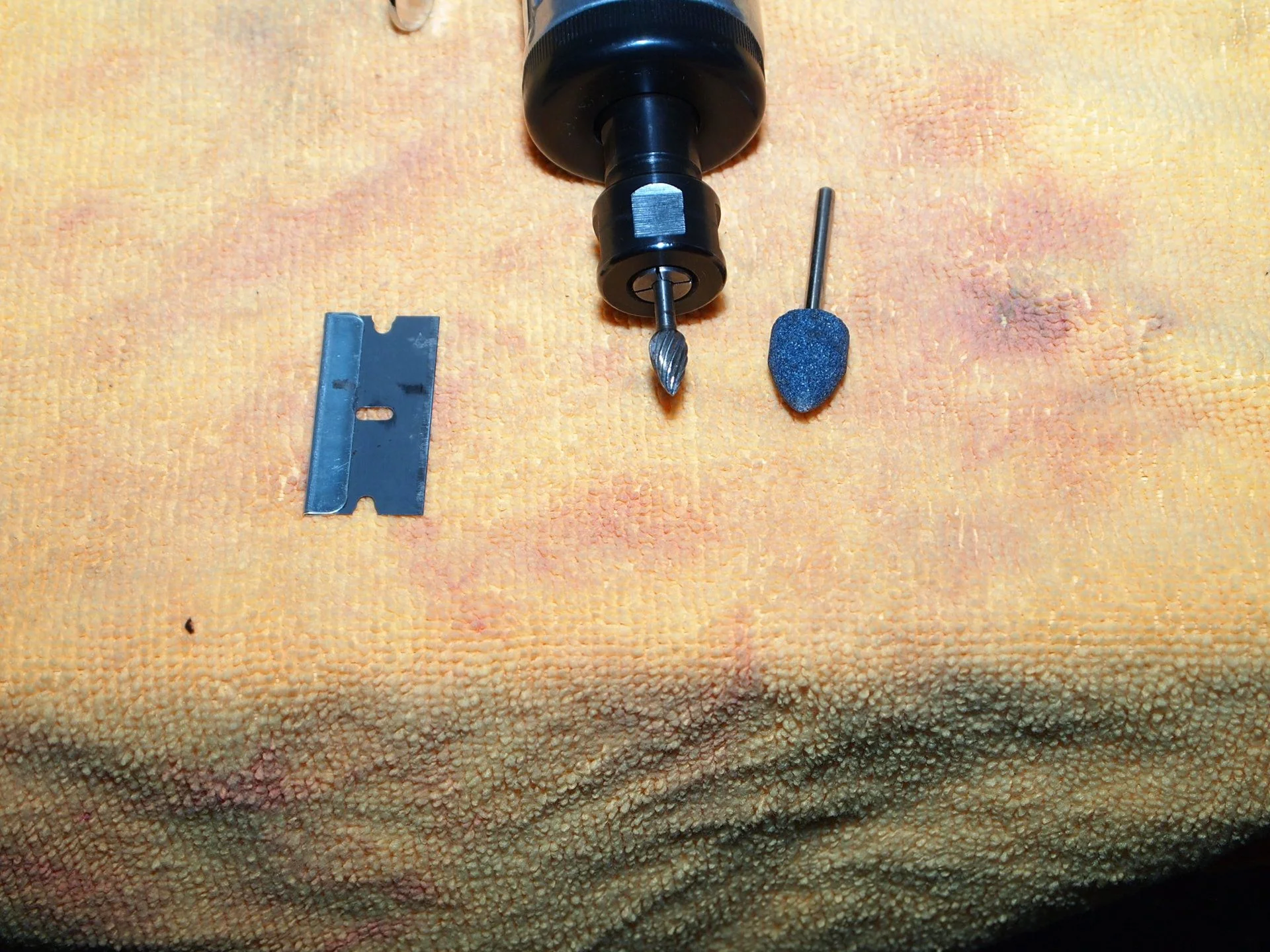

Did a little touch up de-rust with micro stone grinding and epoxy primer on body where the outer ends of plastic of brake lite rubs in prep for sealing in light.
Despite my doubts it actually has!

How hard was it for you to clean up that brake light and the body portion?
I cleaned the foam adhesive off my original third brake light and hatch then resealed with butyl rope. Its been dry for a few years now.
@Greenbean , it was a struggle getting all the old stuff off.

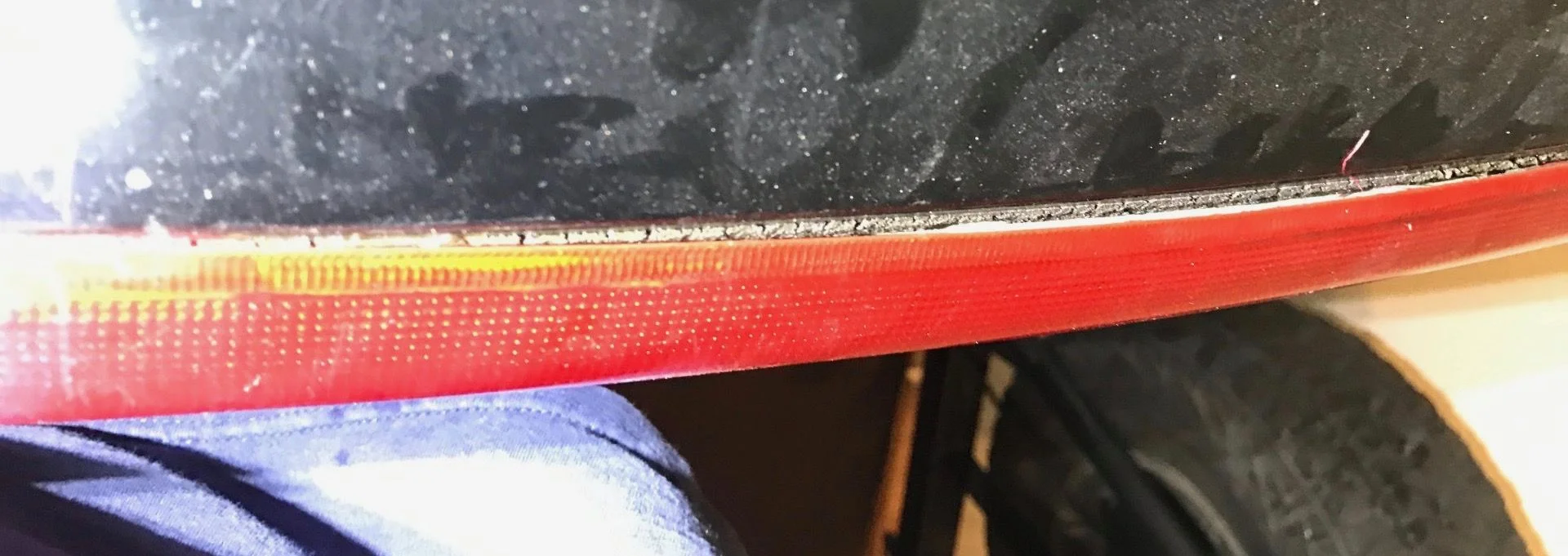

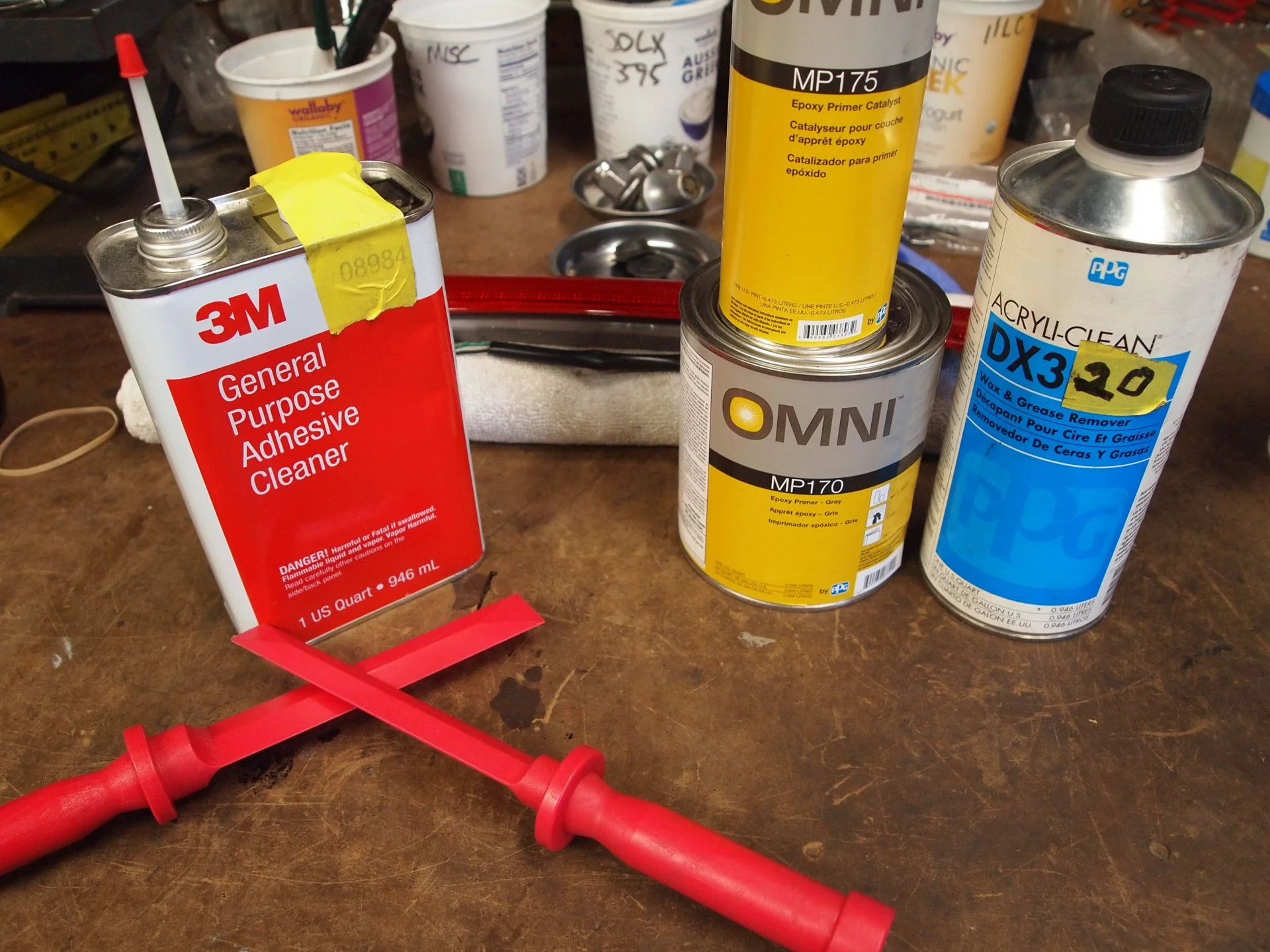

Wasn't hard to clean. I used a heat blow gun to warm area to remove lens, then pried off with plastic body tools. I unfortunately broke two small guide tabs off back side of lens during removal. Look close at picture above and you'll see where.
I've carbon fiber scaping tools I picked up at HF, they work well and don't harm the body paint or plastic. I then used 3M adhesive remover. I'd say 60 minute to pull light, clean old adhesive, paint prep and paint.
