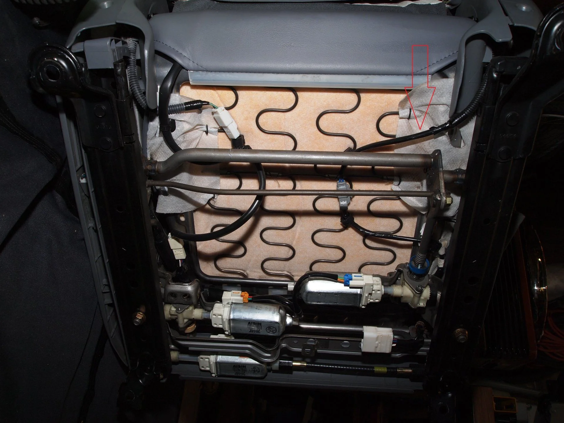

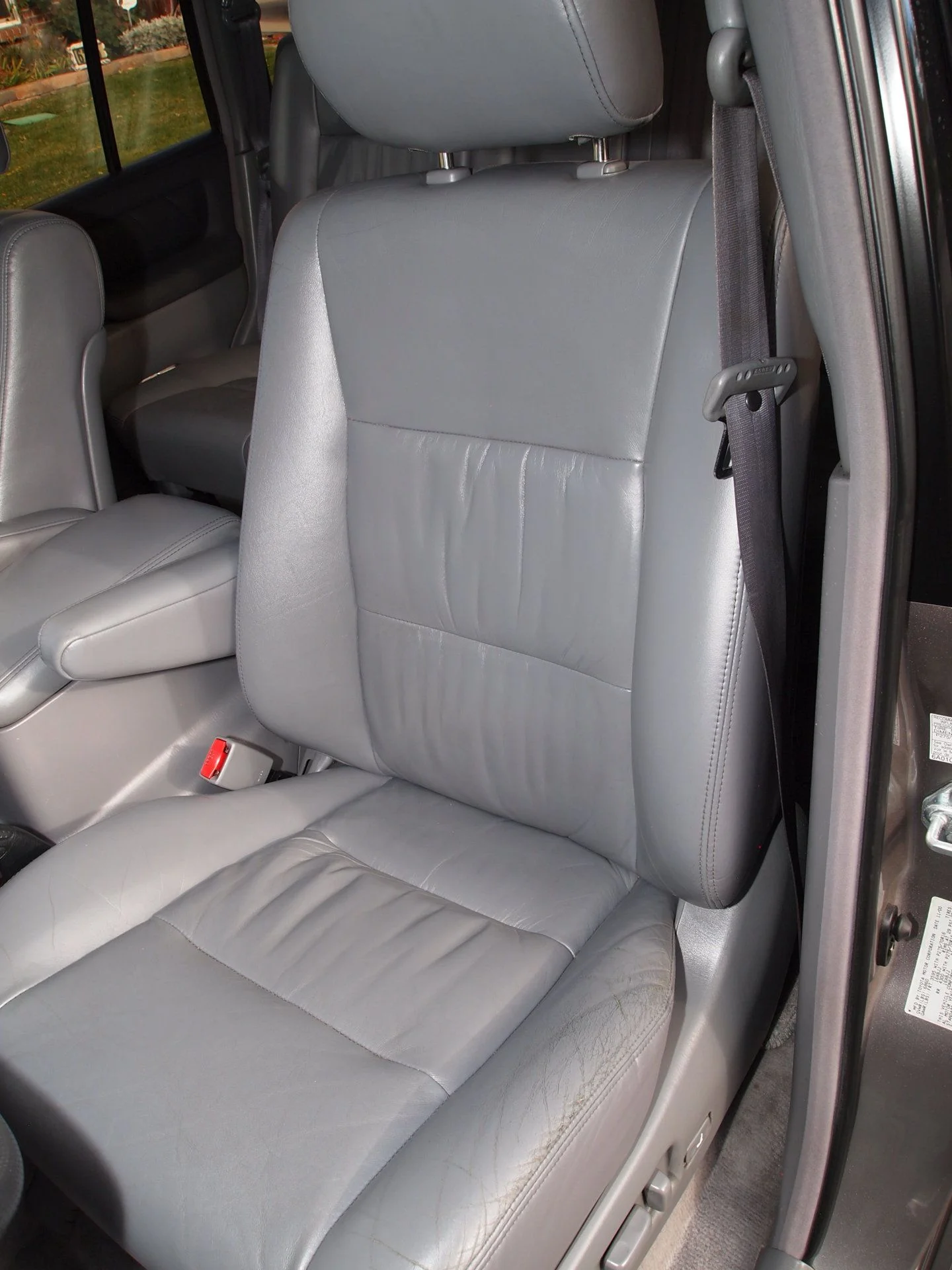

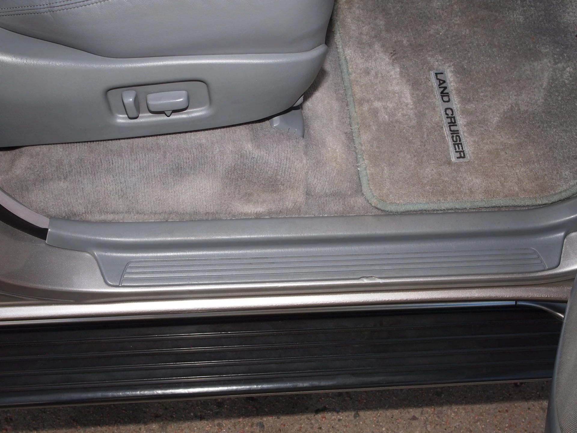

I just heard from @sammybones that lumbar isn't working. I don't recall it ever giving much moment. Can't remember last time I even tried to adjust. Anyone know if the 98-02 gave much moment?
I really don't know if we have a motor or pump with inflatable bag?
I'm thinking first step would be to see if can hear or feel the motor or pump working. If not check to see if power getting to it.
If getting power, pulling seat back would be next step.

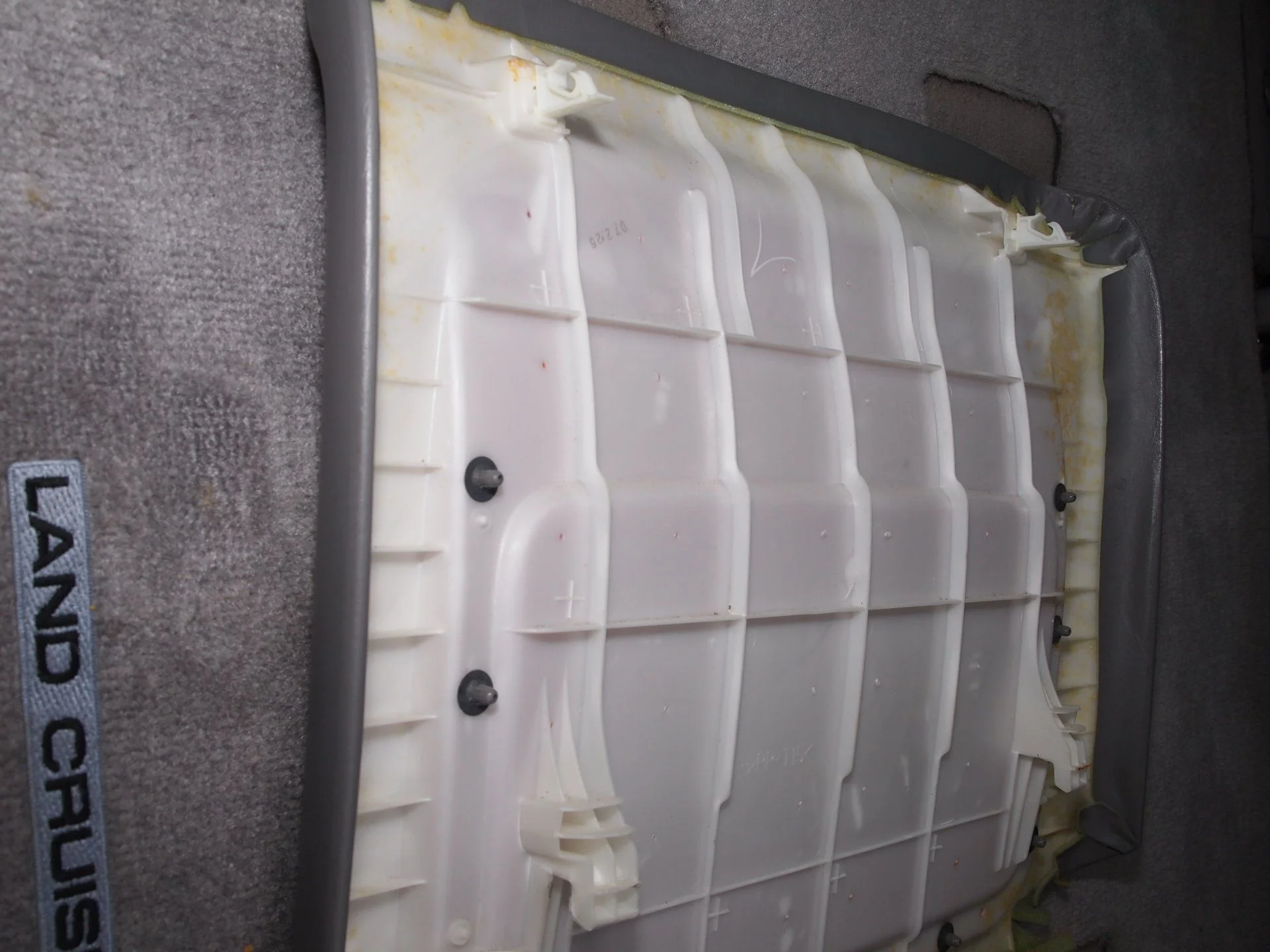

Anyone know how to remove seat back without breaking tabs of hard plastic back?
I'm guessing this is wire to lumbar motor, anyone know for sure?

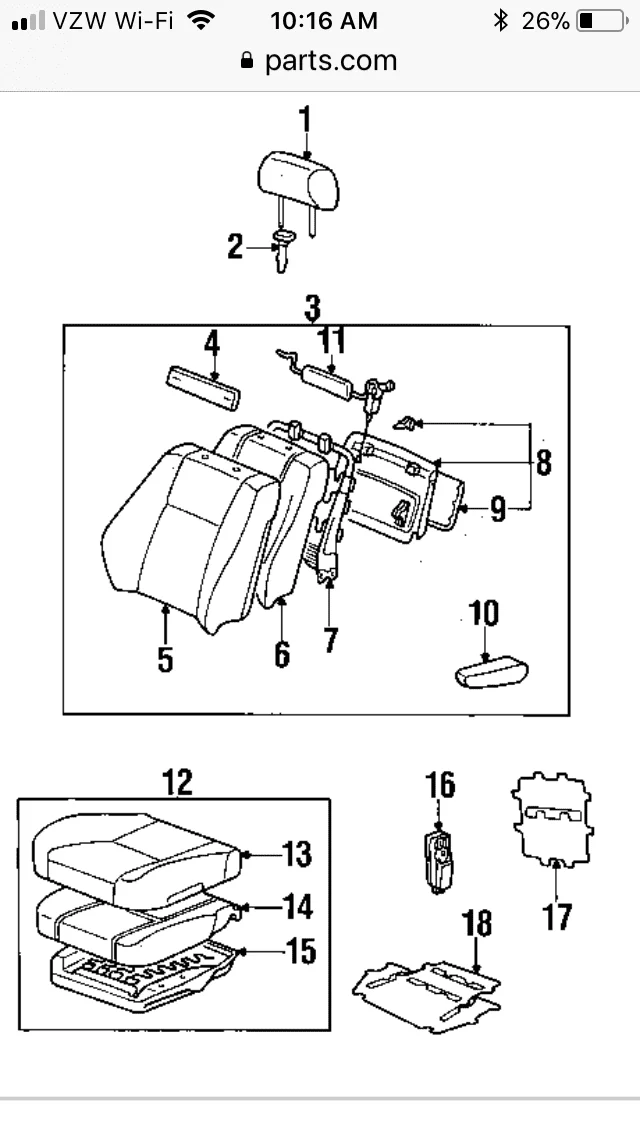

Never been in there, but from the diagram it looks like it can be accessed by removing the back of the seat cover- Part#11 is the lumbar pump-
Test the switch for continuity
Test the pump motor for continuity
So if #11 is a pump it must be air bag.
I did find some pictures of a back for 06, suppose it's same for 01. Looks like trick would be to release upper clips then pull up.
Would be good time to restring netting pouch.

I’ll try and trouble shoot the lumbar. I’m gonna have to upgrade the stereo as well unfortunately, my wife wants Bluetooth and better speakers. I can’t blame her, the audio in Hundy’s suck.
