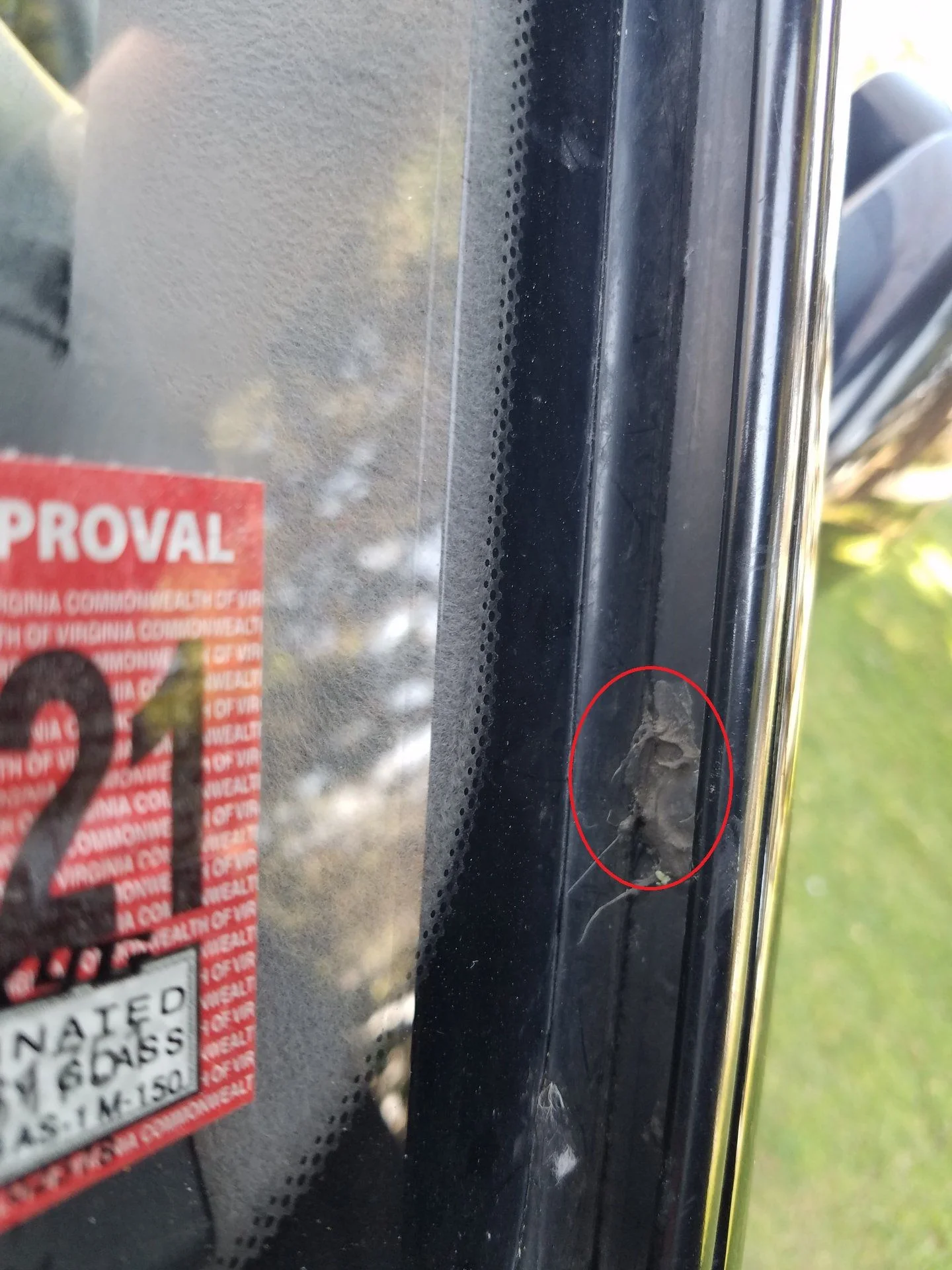

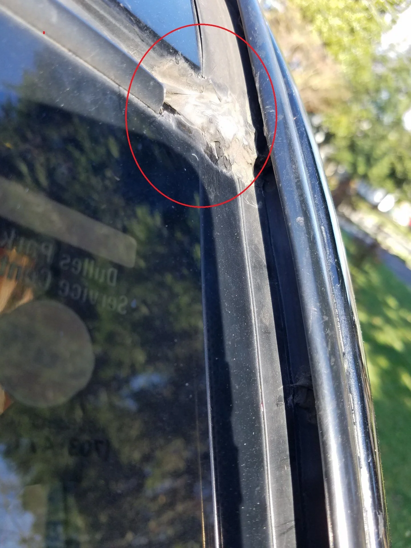

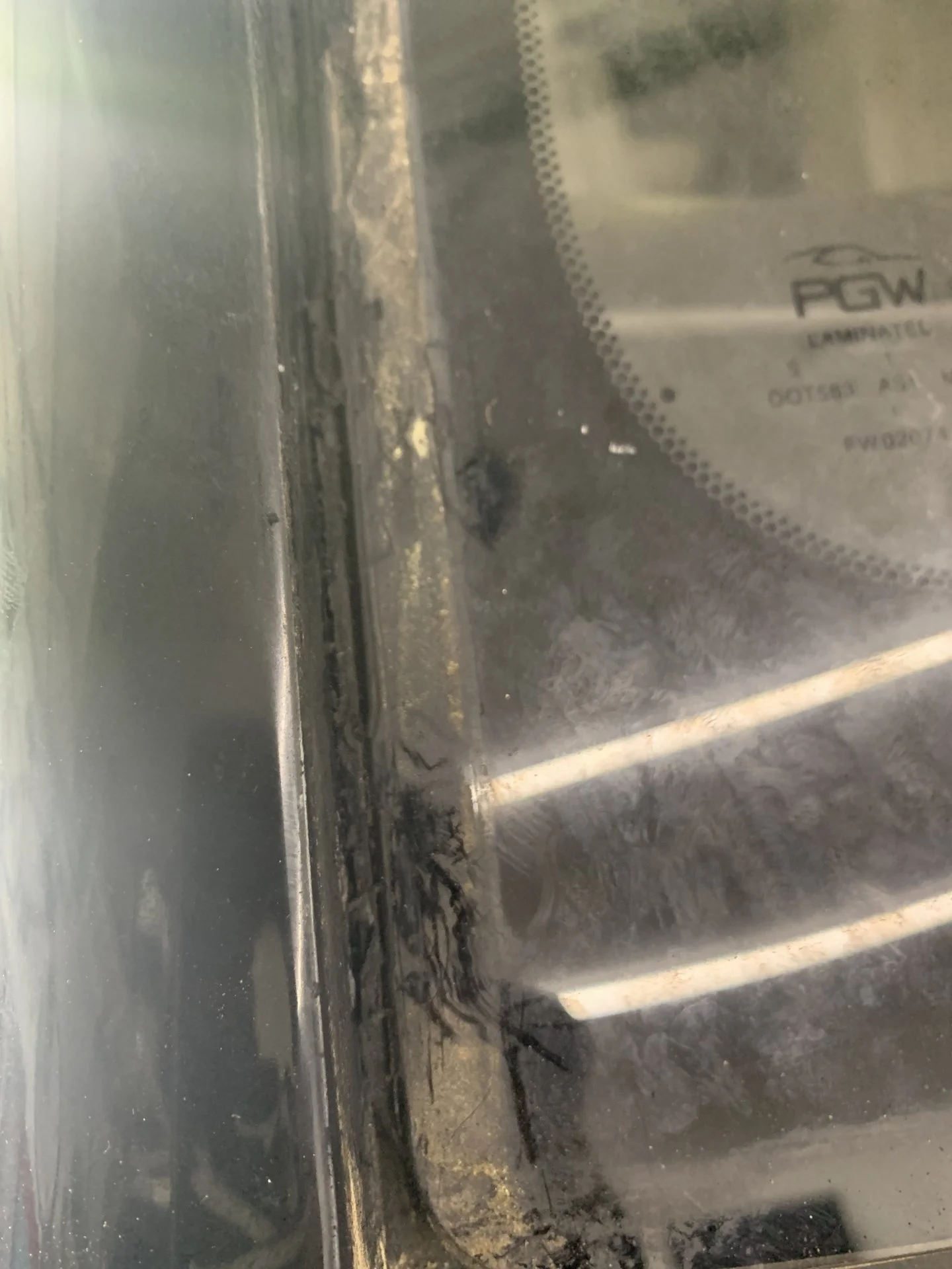

Excellent write-up Paul. Thanks for taking the time to write this.
It looks like I have to get the windshield professionally removed from what you are saying.
The windshield was replaced. The rivnuts are not installed, the strip molding is missing and the rivnut holes have some type of sealant or nothing at all. And, the top corner of the windshield has sealant as well.
Just in case I'll test the sun roof drains again.
I removed the A-pillar cover and saw signs of water droplets (evaporated).
I just received the new sunroof seal and will tackle that when I have time. In the meantime I sealed off the whole area.
I would've like to see more of your side molding. But from what I do see, at minimum side molding needs to be removed.
I also see BP at top comer gluing or sealing upper windshield molding to side mold. That's very bad sign.
Don't pull off top molding from glass along roof line, just side mold for now. Likely they've also glued side molding to "A" pillar and glass. Most times when this done, glass will crack as you remove molding. If so go-head and remove top molding as glass well need replacing. Use only plastic body tool and plastic/carbon fiber chisels, no metal or you'll damage body and paint. Harbor Fright has them! Then fill holes with 3m windshield butyl.

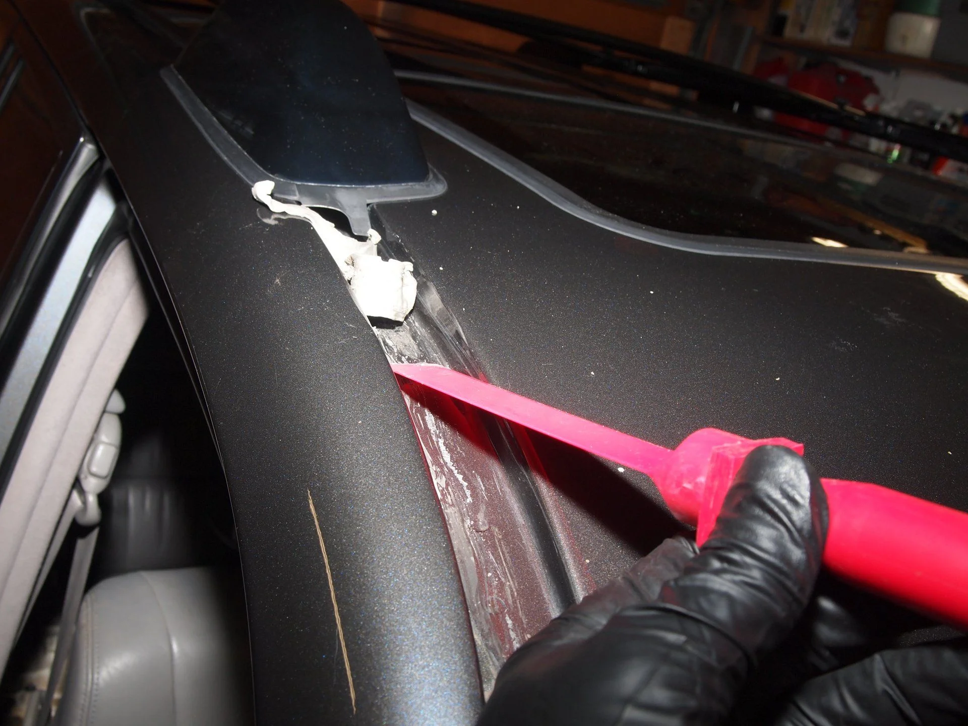

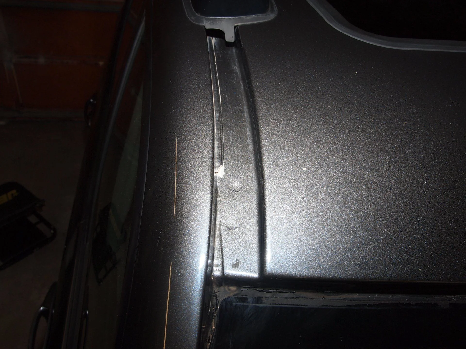

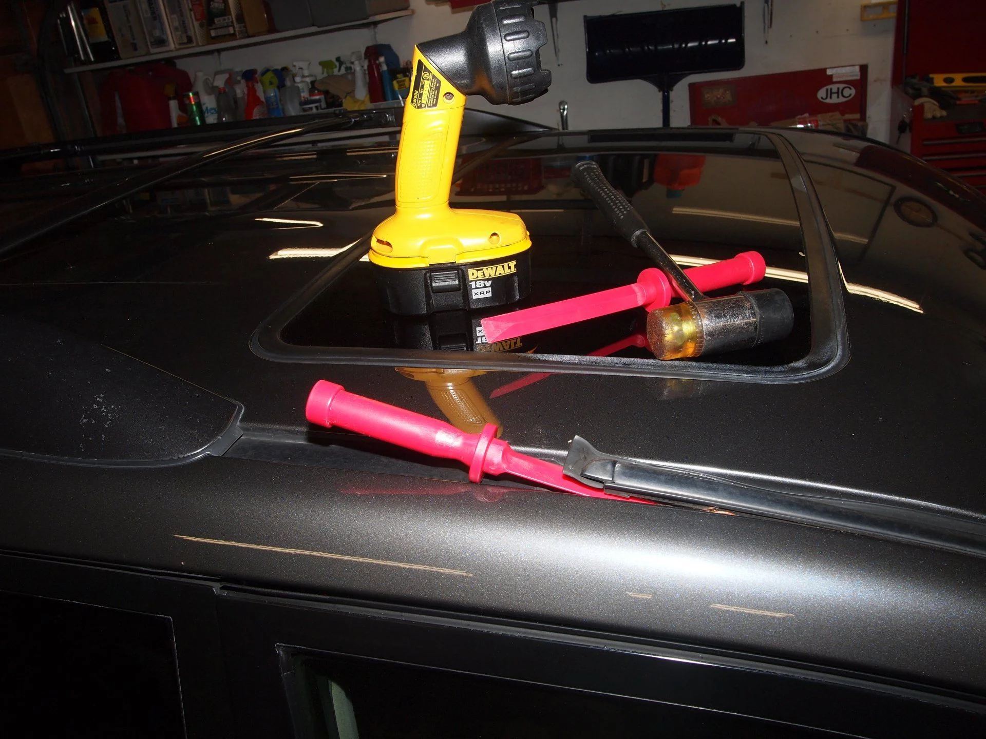

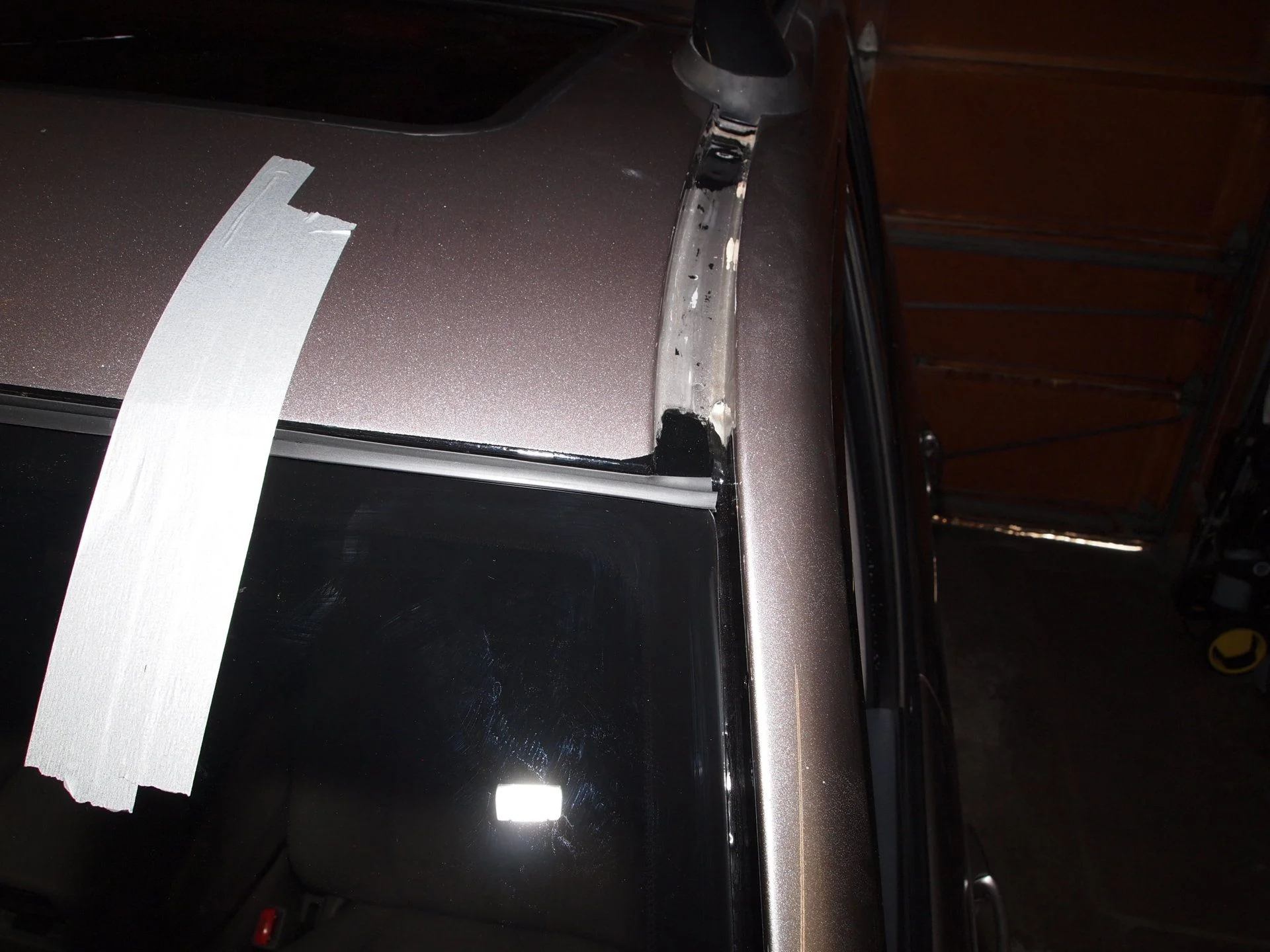

Here one I'm working

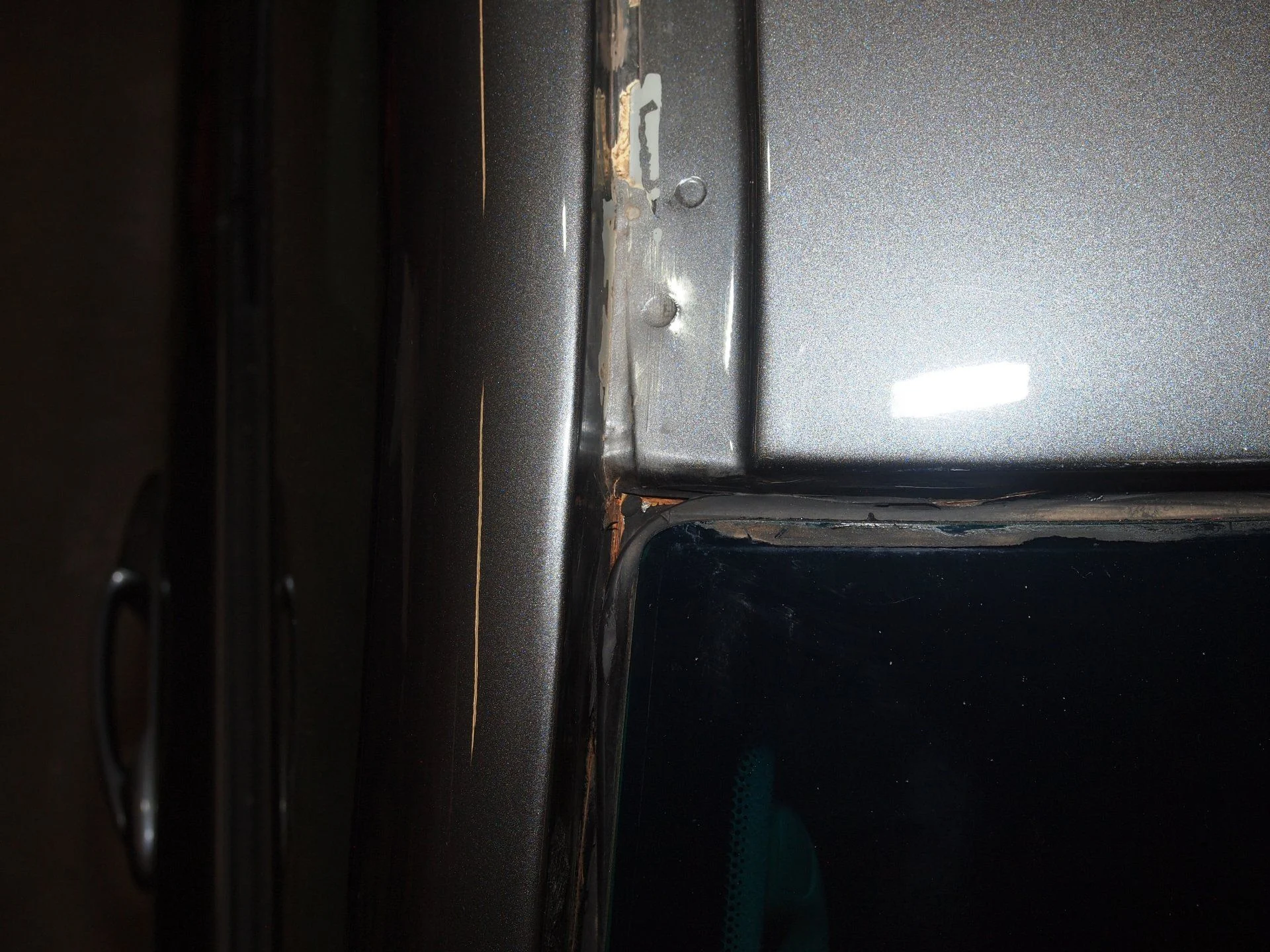

Best is to have new molding across the top. But that likely means new windshield. Some guy have replaced that while glass in. But often time to much BP holding it and in the gap. I'd get side out first and see what you're dealing with.
When done you want to look like this, not some patch work. Which may mean a new windshield.
You don't want to end up like this. So mitigated rust and get it done properly the first time.
This one below, if not corrected will get just as bad as one above. Molding holds in moisture, and it can get very very bad.

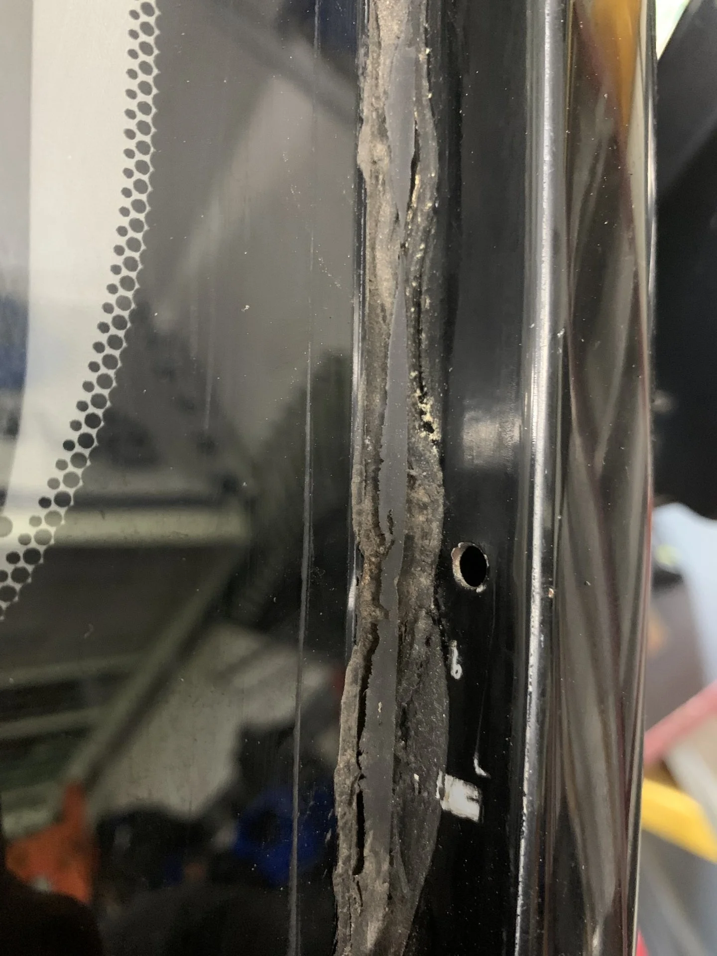

This has been a really helpful thread. I developed a pretty bad leak on the passenger side and a slight leak on the drivers side. After seeing how straightforward it is, I decided to redo all the molding myself. What’s funny is that the passenger side was riveted on, but the drivers side wasn’t on AT ALL. Looks like they attempted it, but didn’t go all the way through the A-pillar.
On the passenger side (the side with the massive leak), the required 1/2” drain channel wasn’t there so I started creating one by scraping away the window sealer with a plastic scraper.
The drivers side seal material is a little harder to remove. This side I suspect had water intrusion at the A-pillar holes where the rivets were supposed to be attached. Should I remove all of the sealant that isn’t directly under the windshield?
I like to take either epoxy primer or POR-15 and paint the bare metal in the holes. By add a few coats, it makes the hole smaller so rivet fits sung, as it rust protect.

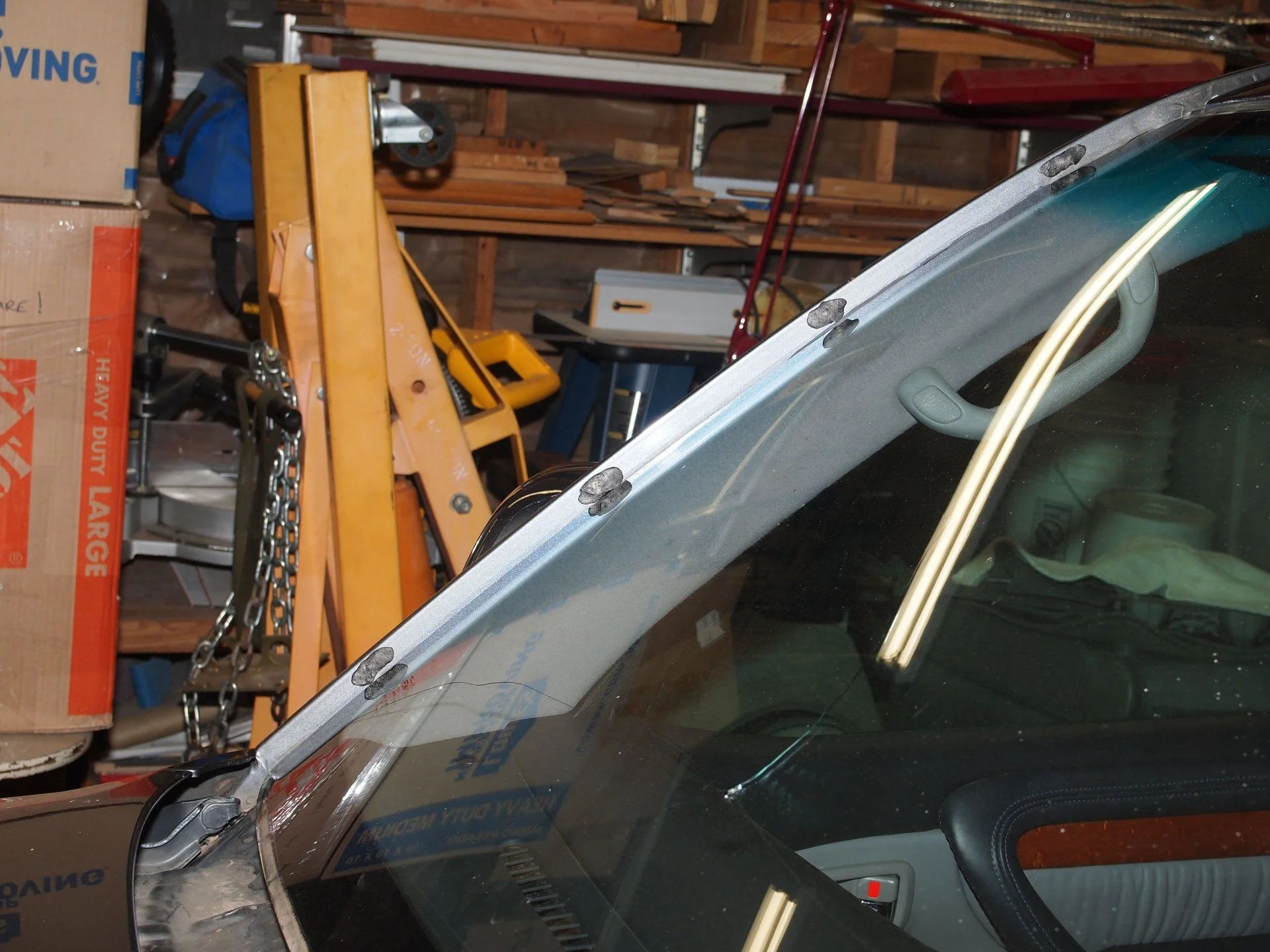

Thanks for all these excellent pictures, I have two questions.
For context, my upper windshield moulding came off from one side while driving and started flapping against the vehicle body. and the rest of it just pulled out with minimal effort. So I'm guessing safelite didn't use enough or improper adhesive when reattaching this piece.
I ordered a new one. Can it be installed *properly* with the side mouldings in place? I see it slides under slightly. I know my side mouldings need tlc but I would like to get this piece in before leaving back to college. I cant imagine it's critical to water sealing because the glass is still sealed to the body. Then I can probably do without the top moulding for awhile, until i'm ready to do the side mouldings?

The windshield shop will say glass must come out, to replace upper seal. But some on mud have replaced with glass in. It depends on how much black ploy the used. To much and seal will not fit sung. Best 3M windshield urethane adhesive. But 3M super weatherstrip adhesive should also work.
You do not need any molding in place. I've 2 that I removed 2 years ago to de-rust and or repair rivet holes. I just plugged rivet holes with 3M windshield butyl. They only issue I have, is more and larger leaves get into fender pocket. Since side molding is not there, to fill lower molding opening for it.
