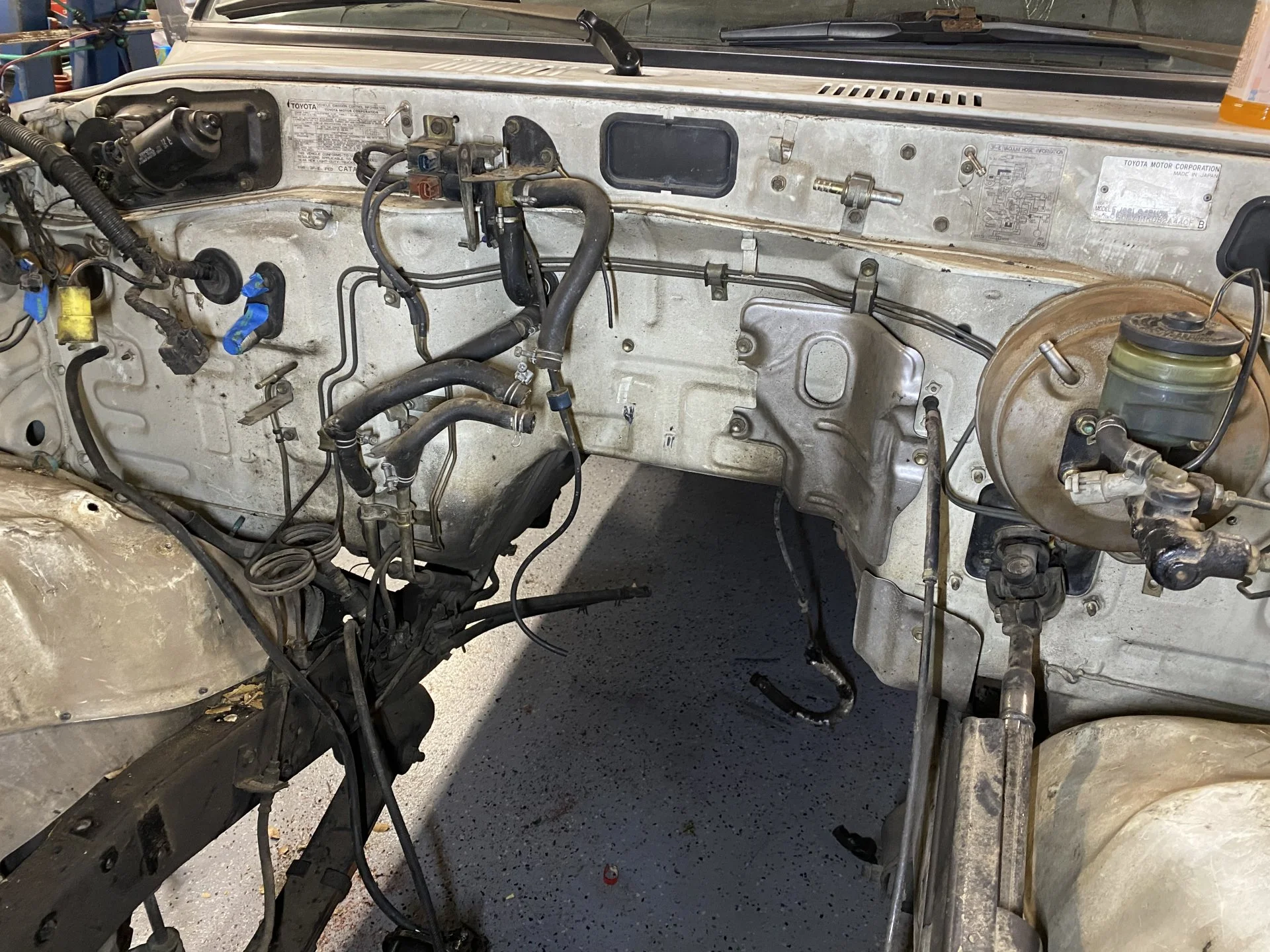

What do y’all do with the convoluted line from the tank to the charcoal canister?
That upper hard line can be removed. I ran a new hose up from the lower hardline that comes from the gas tank and plan to put a small breather on it and tuck it behind the washer fluid bottle, like @dbbowen mentions in the last paragraph of this post.
How much of this engine harness remains?
I am working through that now. I believe it will be very, very little since most of it is 3fe wiring. Only thing I see so far is the temp sensor (if you're keeping the stock gauge), but I am not done going through it all.
How much of this is stock?
That's pretty gnarly looking, but not aftermarket. Looks similar to mine.
And for paint, remove as much or as little as you want. Skipping the firewall will save you a few hours of work.

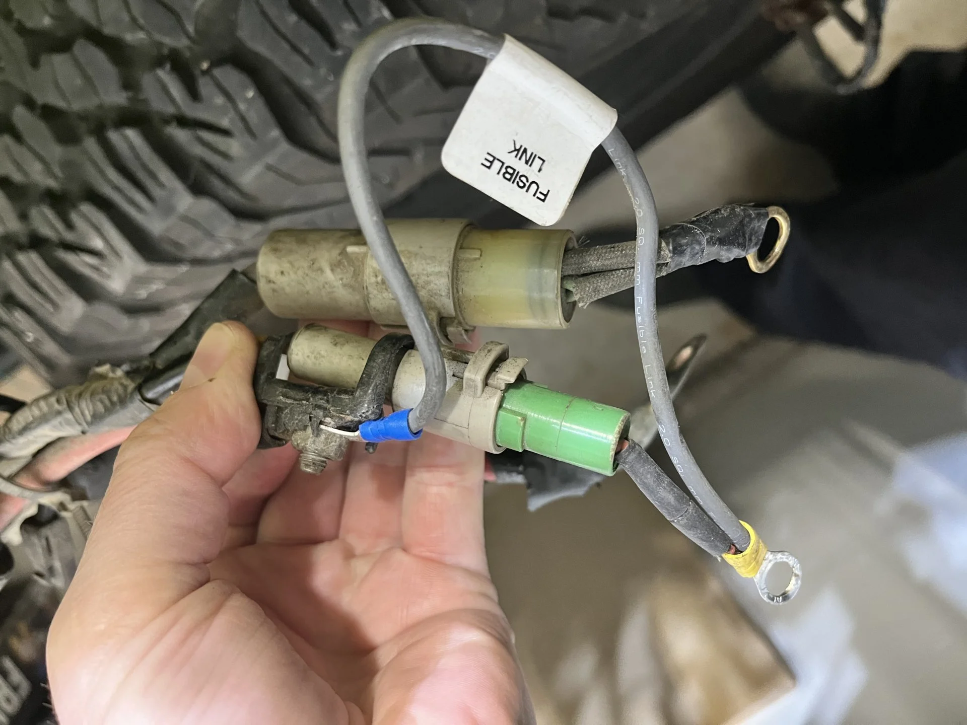

The wiring harness in the engine bay can be trimmed down quite a bit. I tied into my AC and ignition system, kept the headlights and marker lights and everything. I kept the fusible link for added protection, but that one is looking pretty rough like you said. I think @ToyotaMatt sells new ones that would be a great replacement. Mine was in much better shape than the one in your photo

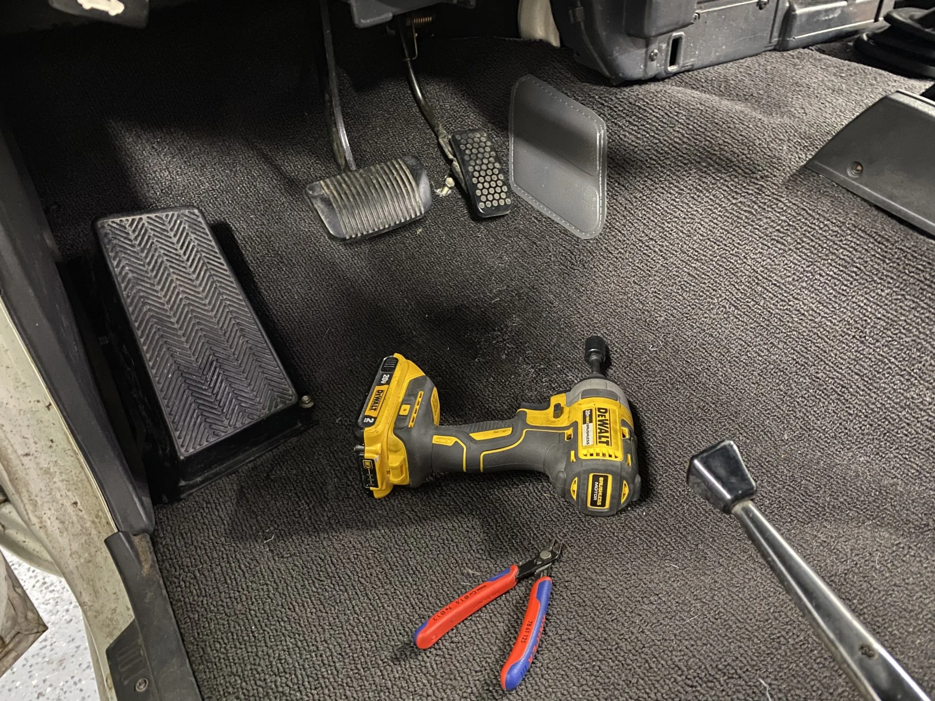

Finally wrapped up the carpet project. It was not without struggles or mistakes. Overall it was worthwhile but I will show the good and bad (mostly my install fault).
Carpet kit instructions from dnp are very useful and I should have read them more carefully. Very excellent insights.
The carpet is molded to the major body shapes of the body, but leaves a bit to be desired. I’ll be honest and say the addition of MLV definitely complicated this so no fault to the manufacture on this part.
First point of trouble, this white beam supports the dash frame ( I think) and requires very careful fitting and trimming. This is my first complaint of the kit, wayyyy to much overhanging material beyond the formed/molded areas. Seems like a easy manufacturing fix to update these borders.

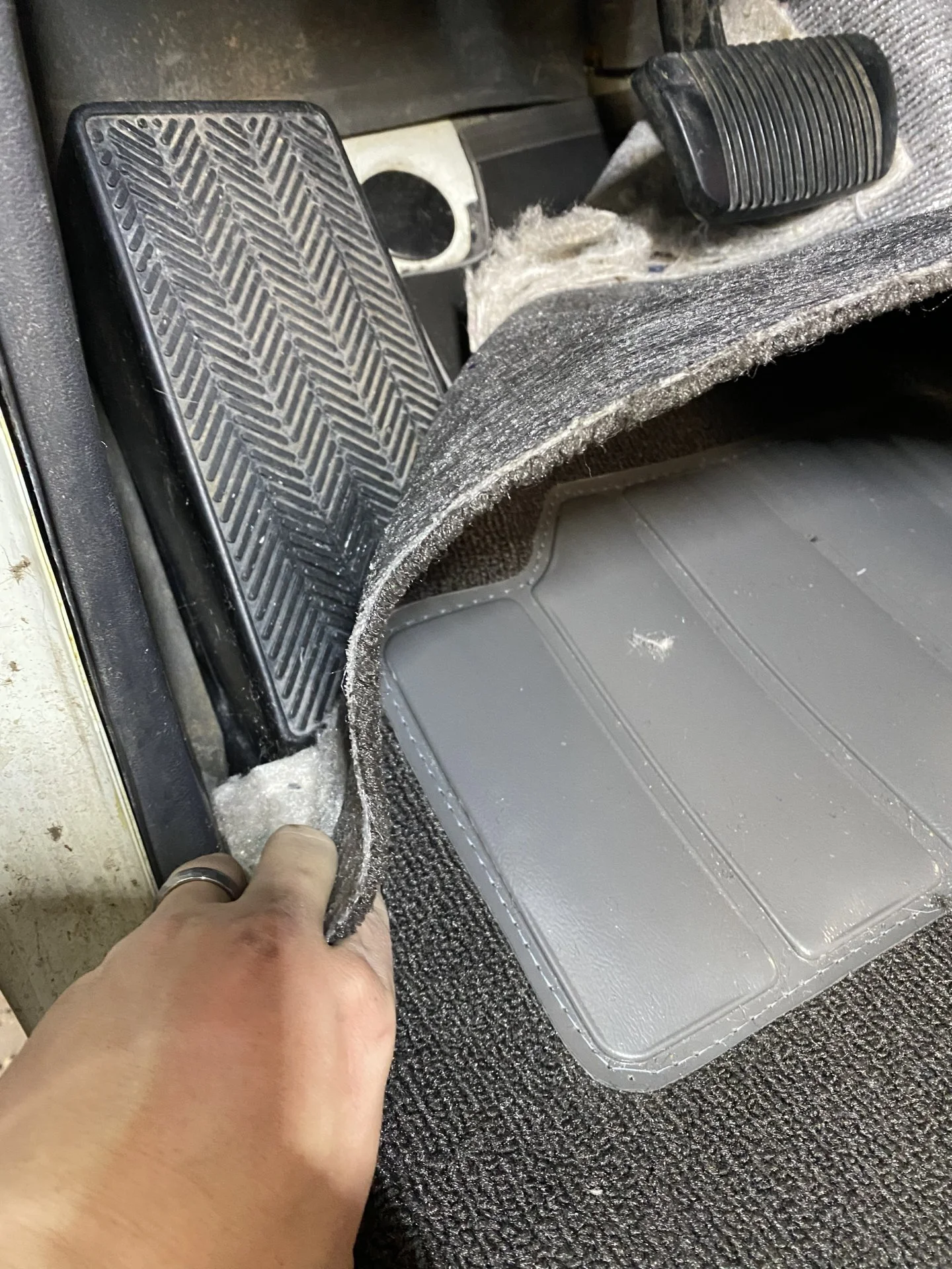

After trimming much of the center console area, the kick plate and dead pedal are next. The instructions say to cut around it but that looks bad in my opinion, carpet should be covered at the edges as default.
Second issue. The heel wear rubber/plastic interferes with the dead pedal (it would sit underneath it). Either you cut the plastic, or remove it.
Not sure if this is a manufacturer issue, an installer issue, or it’s for a 60. I plan to find some rubber mats anyway so this is workable, I cut the stitches and pulled it off.
My pops and I were able to screw the dead pedal over the carpet, so no exposed floor. We removed any MLV in this area.
Either way this leads to a 3rd and final issue, stitching quality. Its pretty average. The plastic wear plates are held on by single stitch and have somewhat poorly hand cut borders. The edges that do have seams, are ok, but can fray if you arent careful. A quick hit with a lighter fixes any of this.

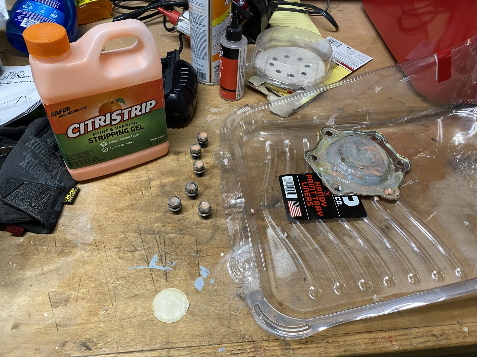

Also picked up a mini parts washer. Trying it out on the small cover for the tcase. Someone had painted it silver so also stripping that off.

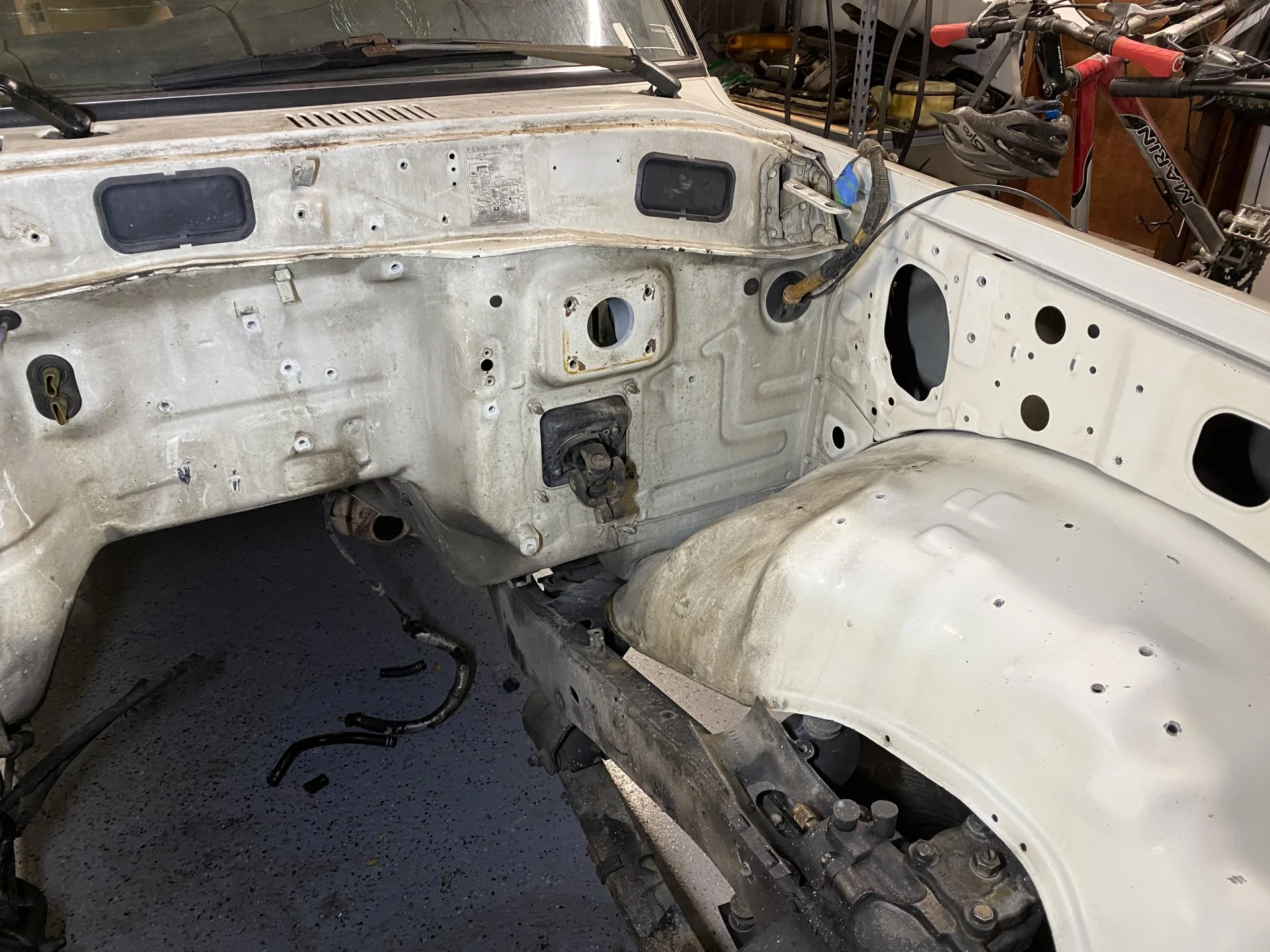

Small progress in the engine bay but takes way longer than you think to remove, bag and tag the hardware, etc
Everything but the plastic covers are removed from the engine bay. Might pull the steering box as it has some solid slop in it anyway.

Parts washer did a good job, with some paint stripper. About the best I can do without an abrasive cabinet and yellow zinc baths

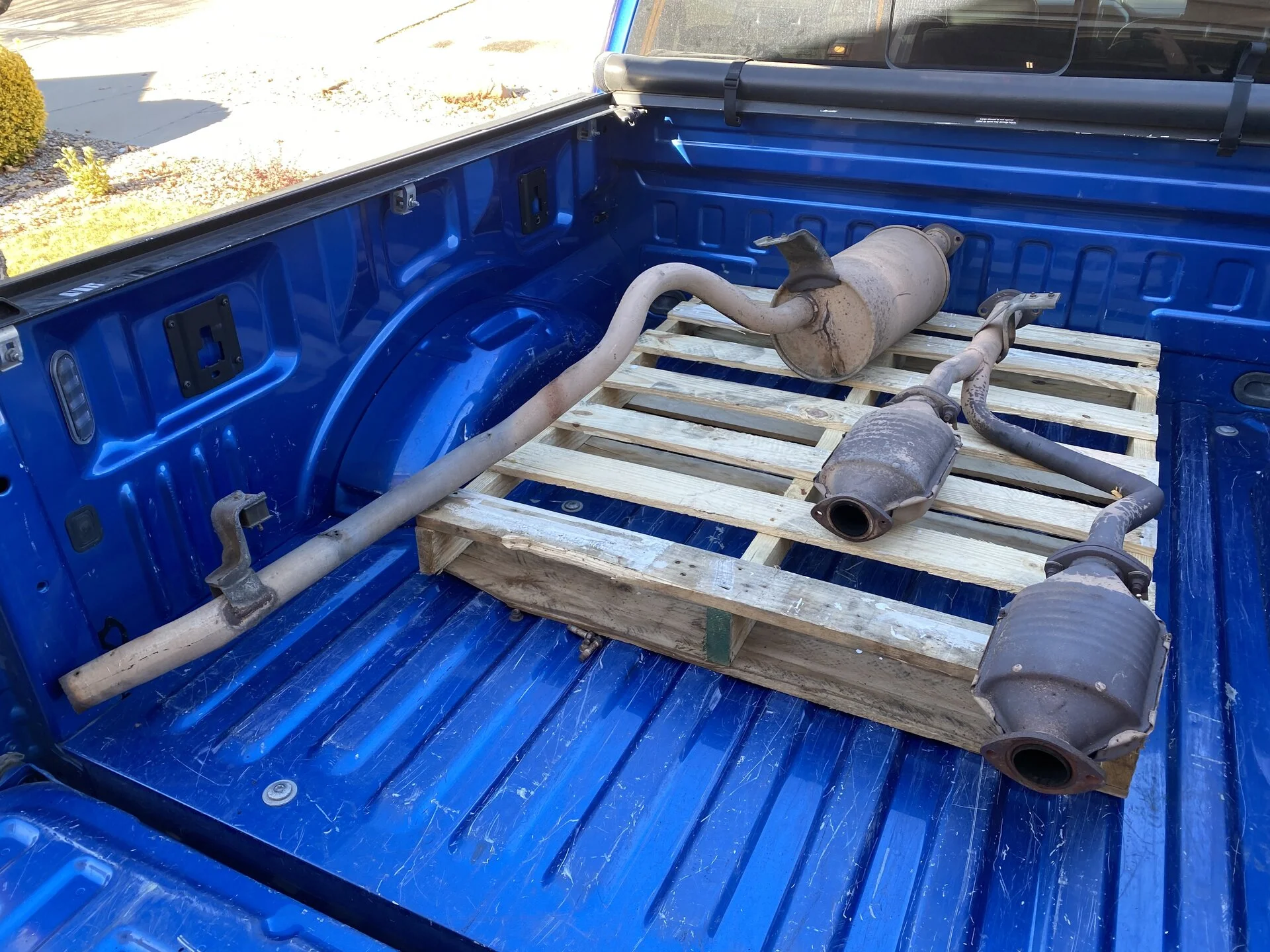

Today had to throw a bunch of crap to the dump/convenience center. Rest of the exhaust went with.

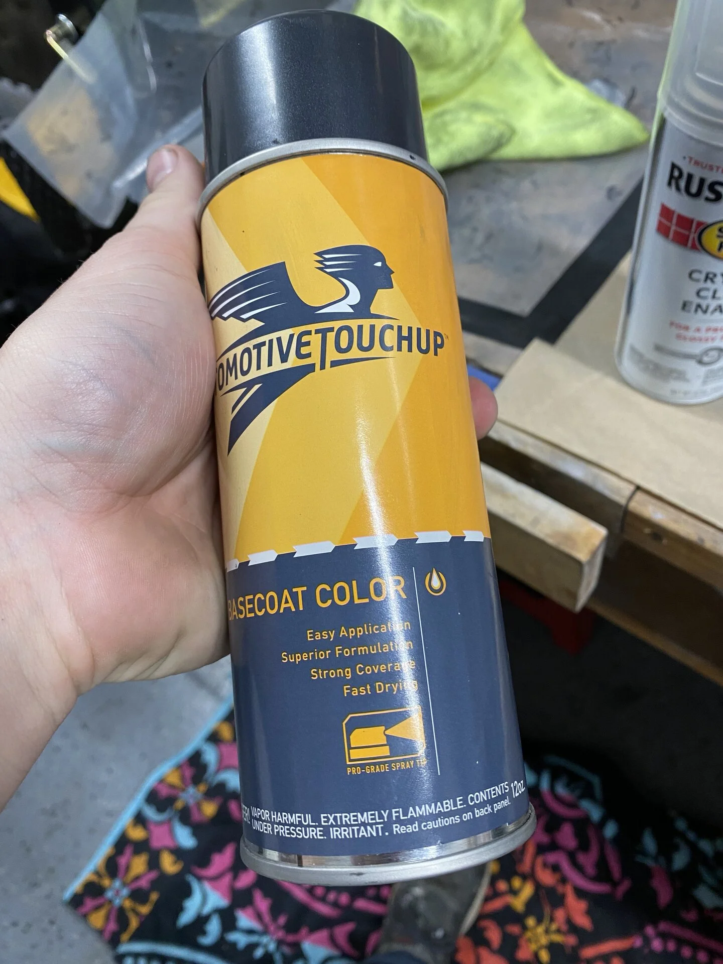

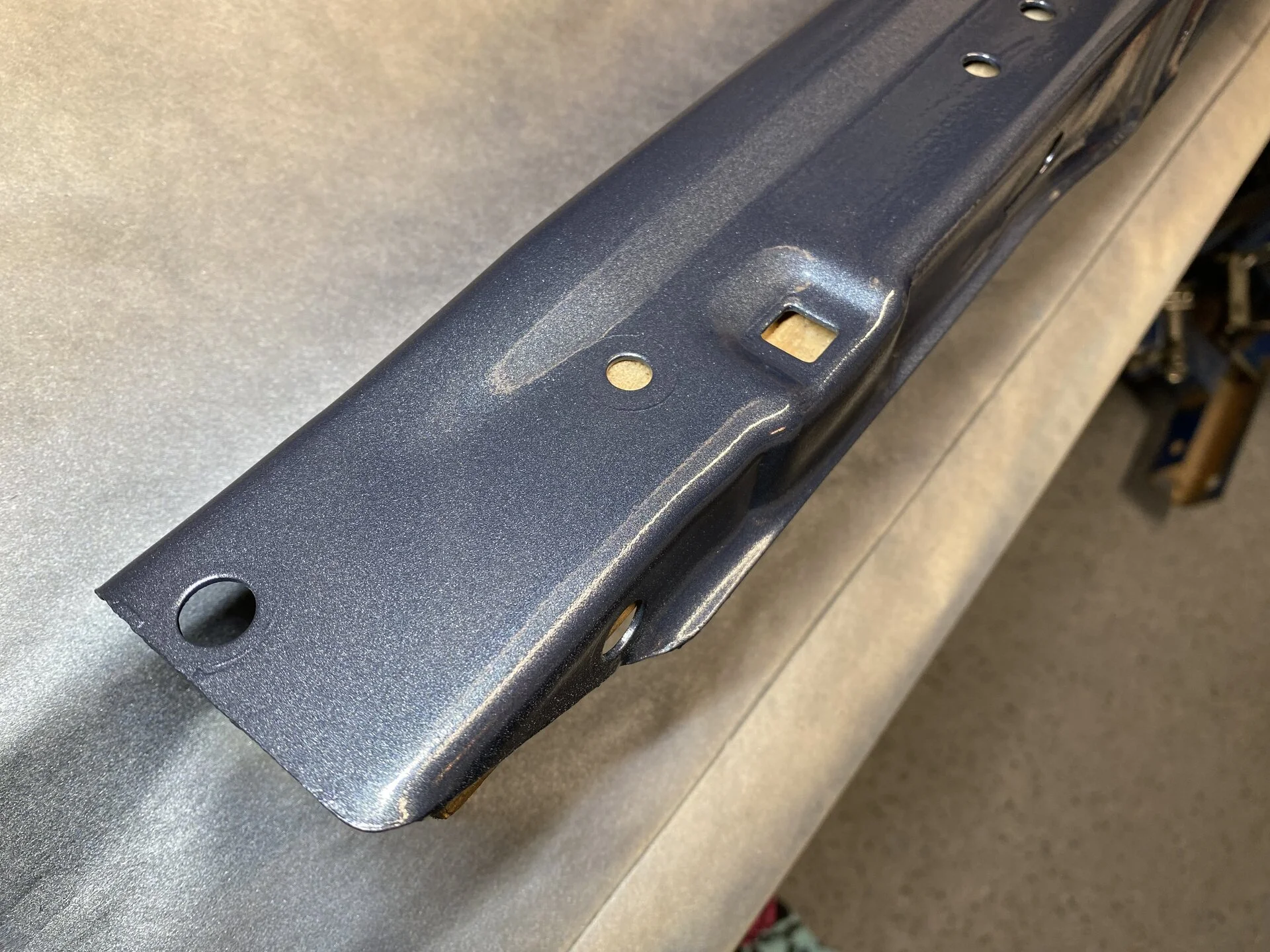

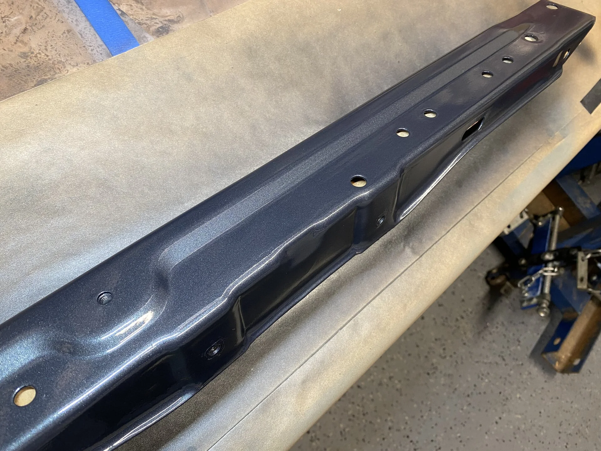

Decided to test out this paint i got from Automotive Touchup. Figured it would get me close to what I am hoping to paint the vehicle with. Color is Toyota Dark Grey Metallic 155. First I sanded with red scotch brite pads, and self-etching primer on the bare metal.
3 base coats, went on nice and smooth. Clear coat was this cheap stuff i had laying around. Ill ordered some 2k in the can, will wetsand and see if i get better results. Lots of orange peel as it stands.
Not half bad from a rattle can. 2K on order.
This was a quick and dirty test. Very good chance I sand most of it off, get the base material smoother and fill any holes.

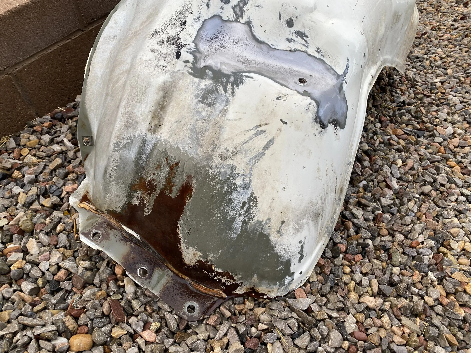

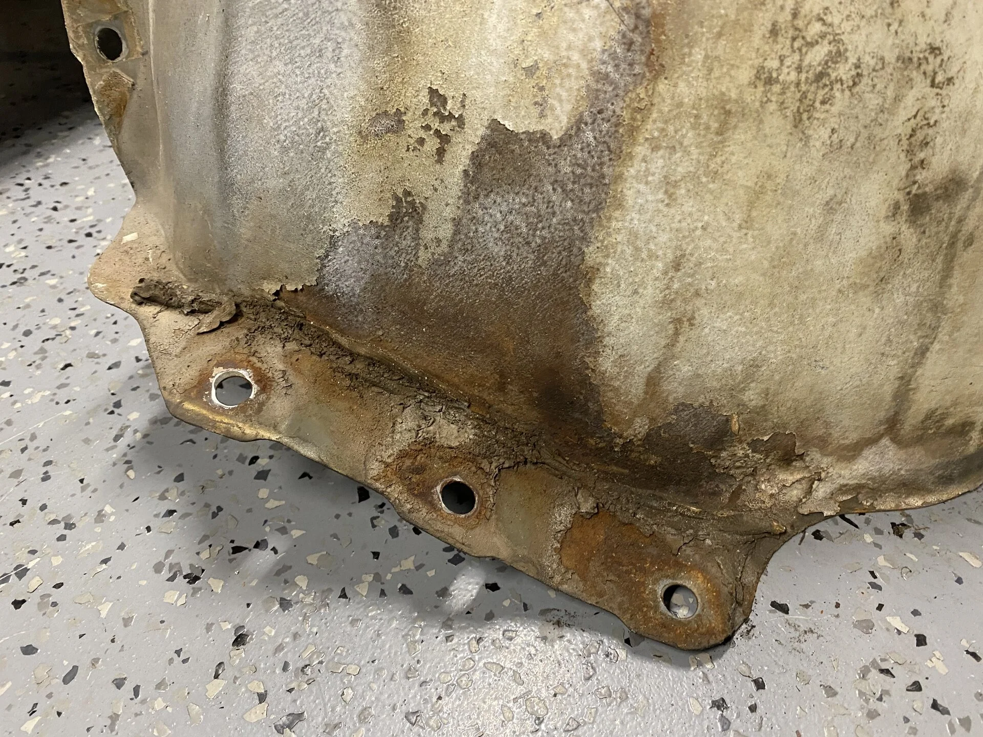

Had to remove the wheel well section as I couldnt get to the rust on the bolted area and above, with it in the vehicle.
Rust surrounding the seam sealer
Post pressure washing/oven cleaner
Scotch brite pads/sand paper brought me here. Next will be some rust remover, primer, and body filler.

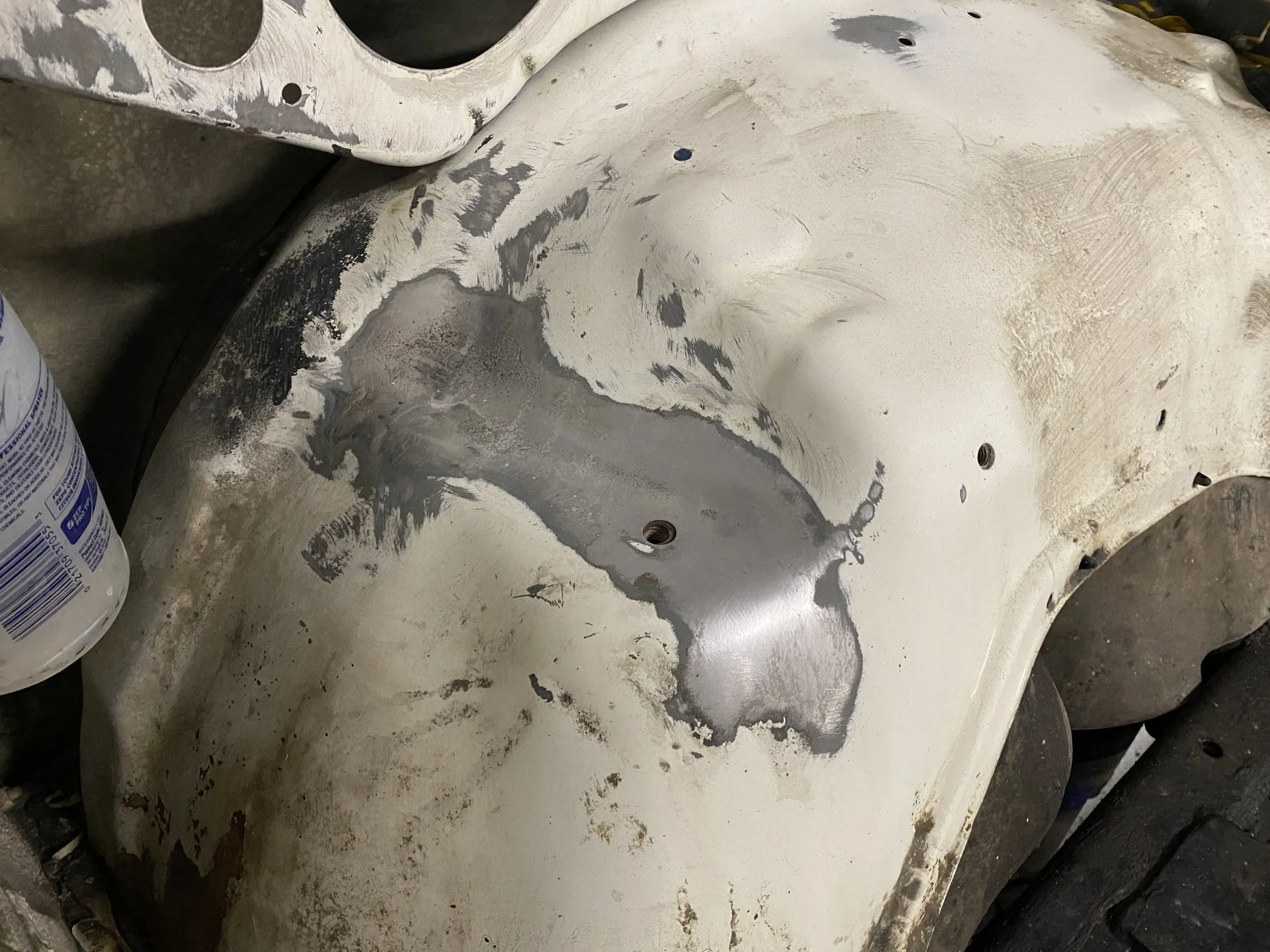

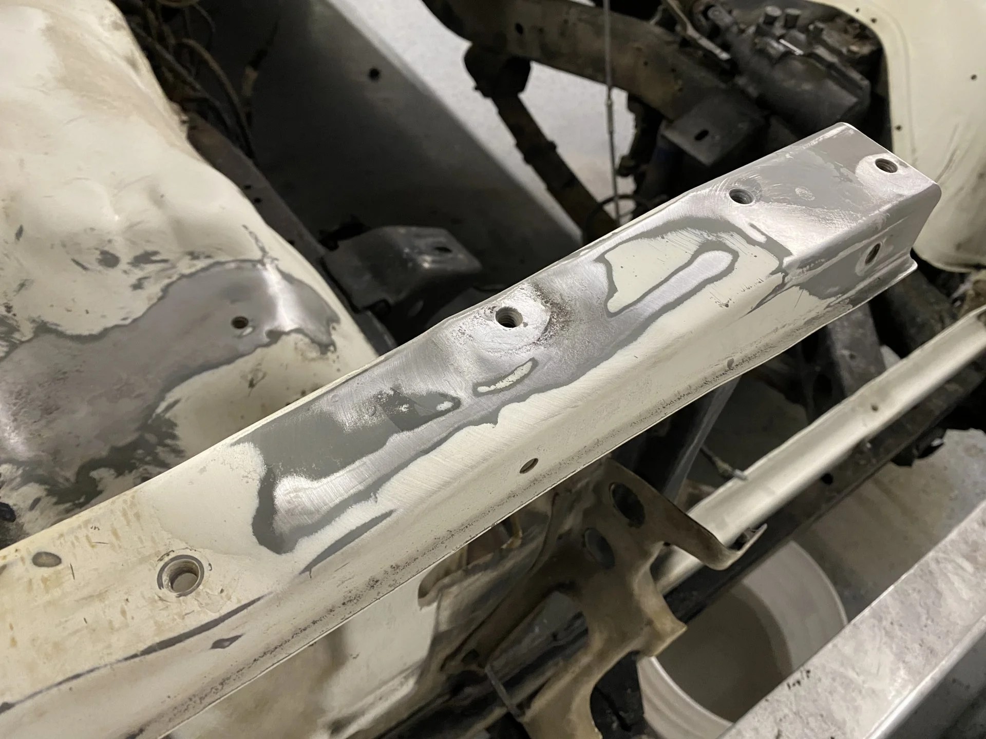

I am a newb to body work, so this is my guess with some research and the products I have available to me. Its also an engine bay. I did a bunch more sanding to get the panel to where i was happy-ish, used some rust remover to get all the rust as good as i could to bare metal.
Hit it with self etching primer (epoxy would be better, but my compressor and spray gun are tiny).
Sanded again, and figured I would try my hand at bondo for all the wrinkles and other issues with the stamping.
Slowly but surely, getting smoother each time. I have 2K high build epoxy primer coming for when i am done with this. Then the other wheel well will come off the truck to get similar treatment.
