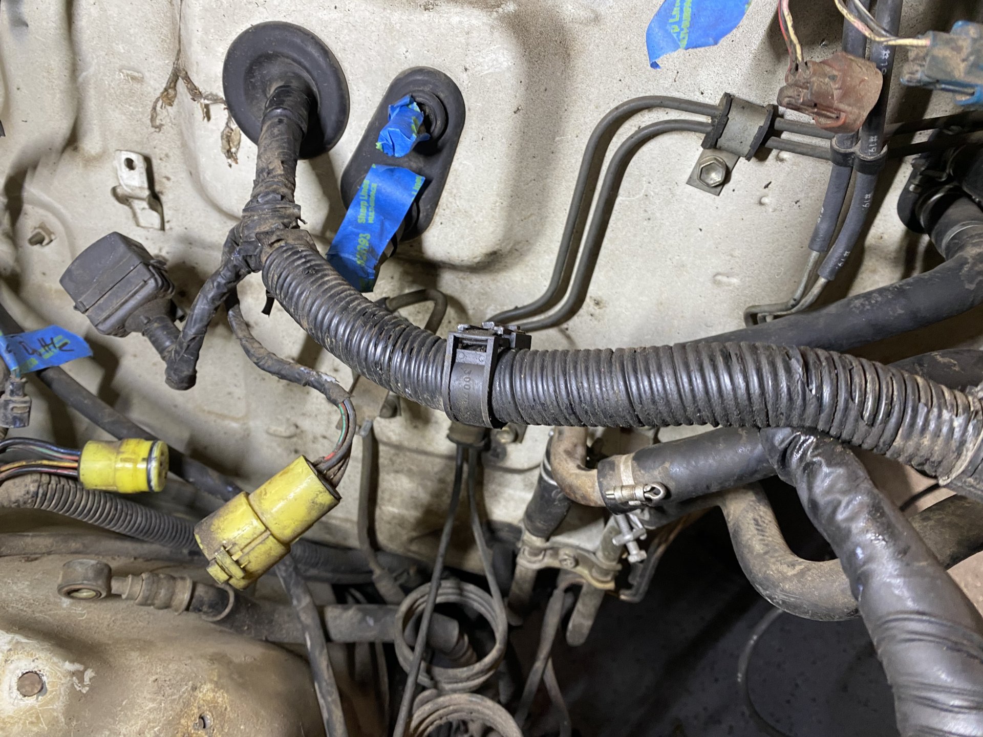

Roger that. Any visual aids or schematics on where the body harness vs GM harness intersect? Sounds like a deep dive

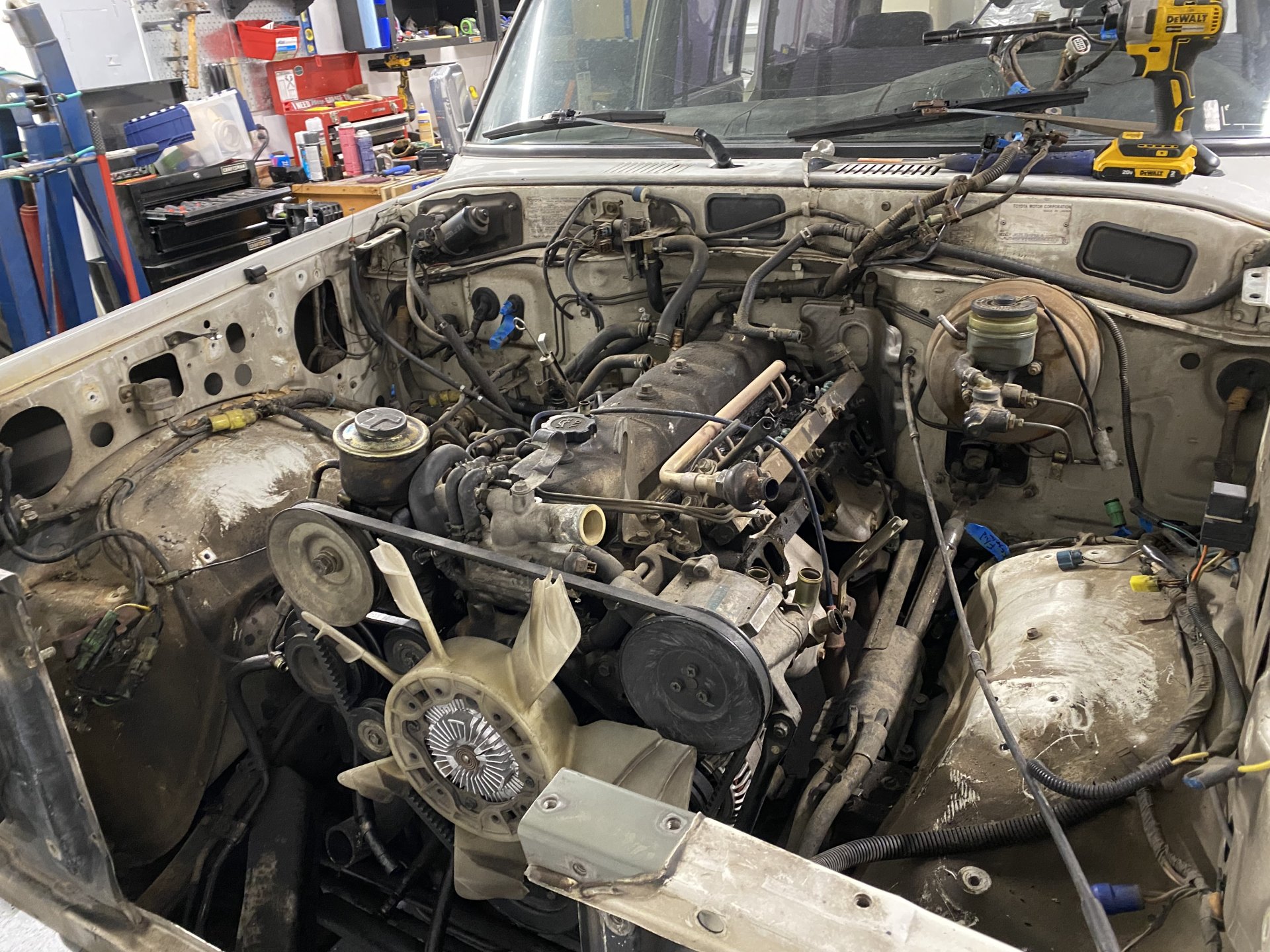

In more prep for removal, I continued with more harness saving (maybe unnecessary) and removed the intake airbus (hopefully reused) and the intake manifold since the wiring hardness is buried under there.
Anyone have a diagram of the firewall ports? There are a few vacuum hoses that I don’t get. Especially one from the distributor to the passenger firewall
Distributor to firewall is just a breather for the distributor cap. Cap the firewall.
Gm harness and Toyota should only really intersect where you get your key-on power for the injector/ignition relays and fuses. I plan on making a plug-in for this very shortly

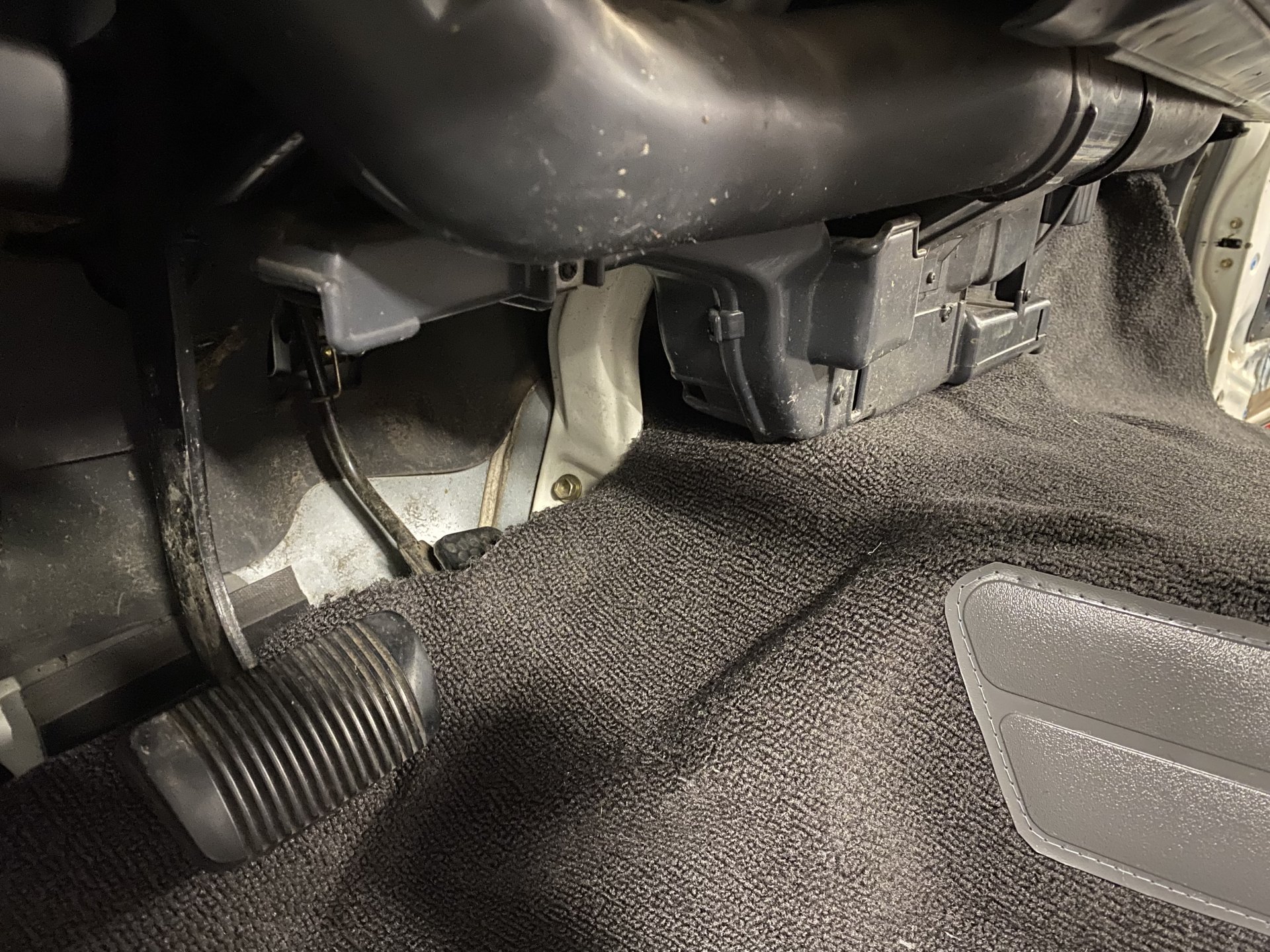

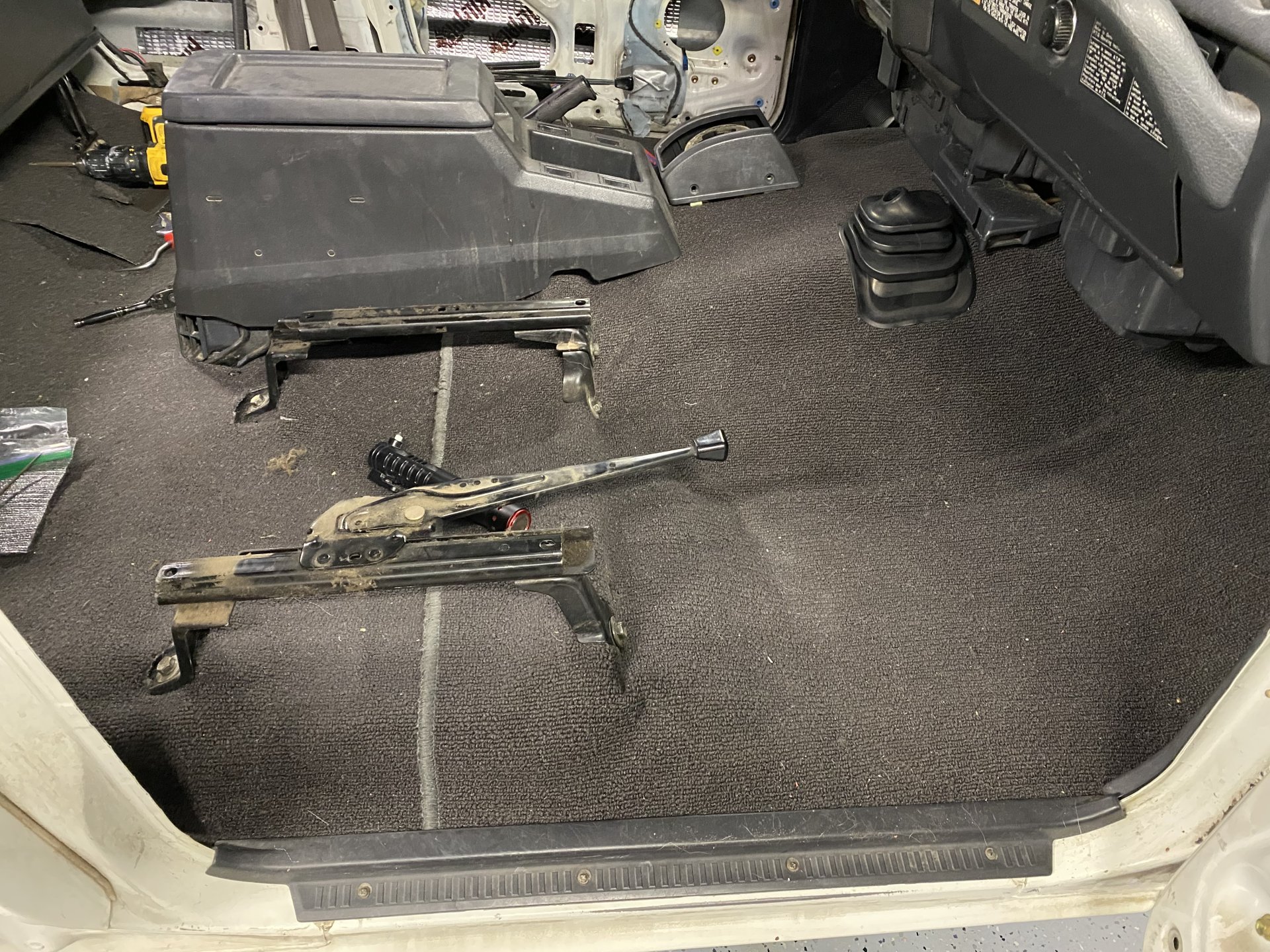

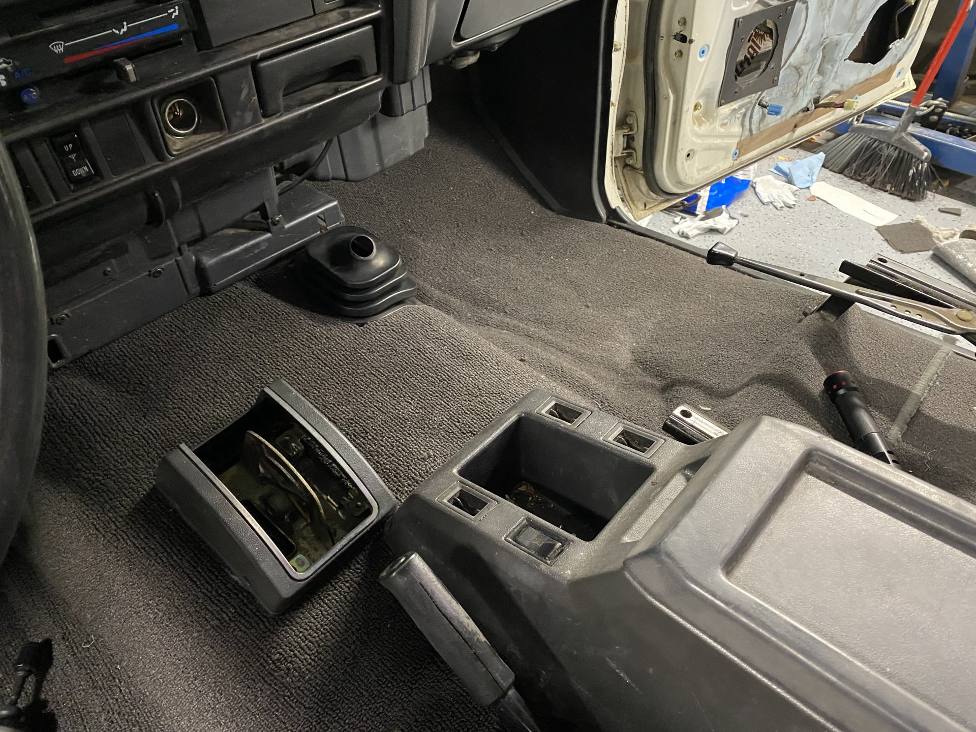

Finally wrapped up the carpet project. It was not without struggles or mistakes. Overall it was worthwhile but I will show the good and bad (mostly my install fault).
Carpet kit instructions from dnp are very useful and I should have read them more carefully. Very excellent insights.
The carpet is molded to the major body shapes of the body, but leaves a bit to be desired. I’ll be honest and say the addition of MLV definitely complicated this so no fault to the manufacture on this part.
First point of trouble, this white beam supports the dash frame ( I think) and requires very careful fitting and trimming. This is my first complaint of the kit, wayyyy to much overhanging material beyond the formed/molded areas. Seems like a easy manufacturing fix to update these borders.

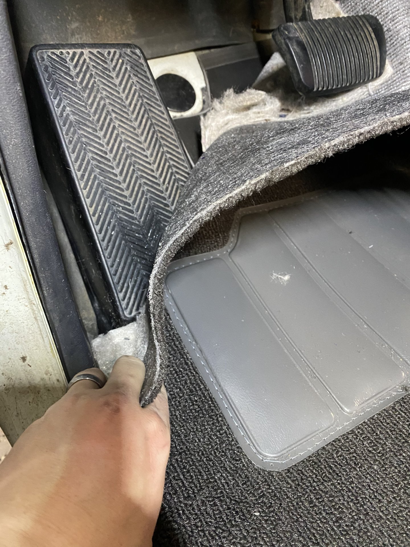

After trimming much of the center console area, the kick plate and dead pedal are next. The instructions say to cut around it but that looks bad in my opinion, carpet should be covered at the edges as default.

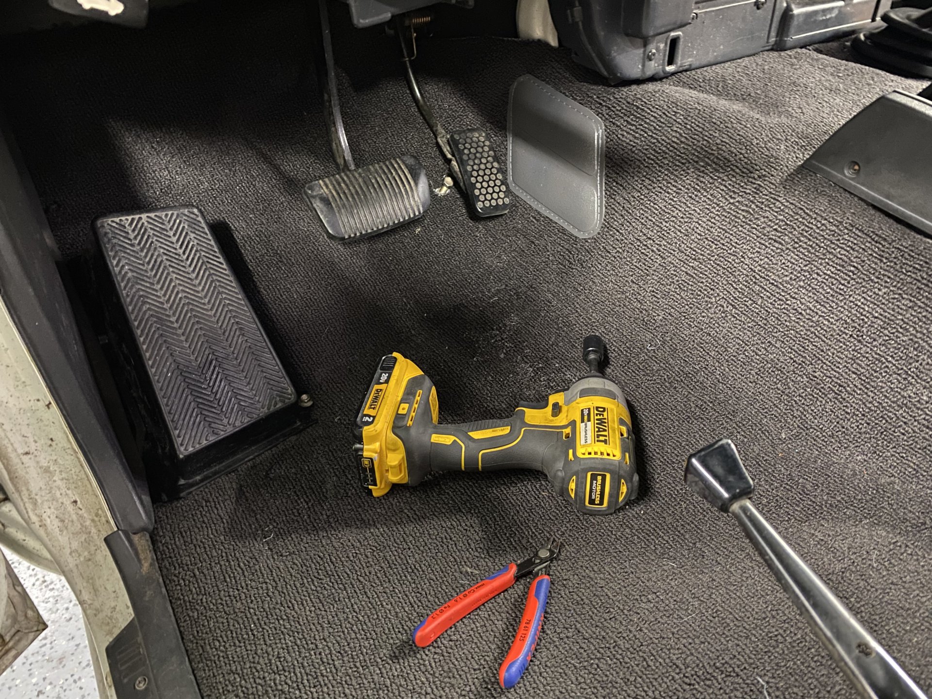

Second issue. The heel wear rubber/plastic interferes with the dead pedal (it would sit underneath it). Either you cut the plastic, or remove it.
Not sure if this is a manufacturer issue, an installer issue, or it’s for a 60. I plan to find some rubber mats anyway so this is workable, I cut the stitches and pulled it off.
My pops and I were able to screw the dead pedal over the carpet, so no exposed floor. We removed any MLV in this area.
Either way this leads to a 3rd and final issue, stitching quality. Its pretty average. The plastic wear plates are held on by single stitch and have somewhat poorly hand cut borders. The edges that do have seams, are ok, but can fray if you arent careful. A quick hit with a lighter fixes any of this.

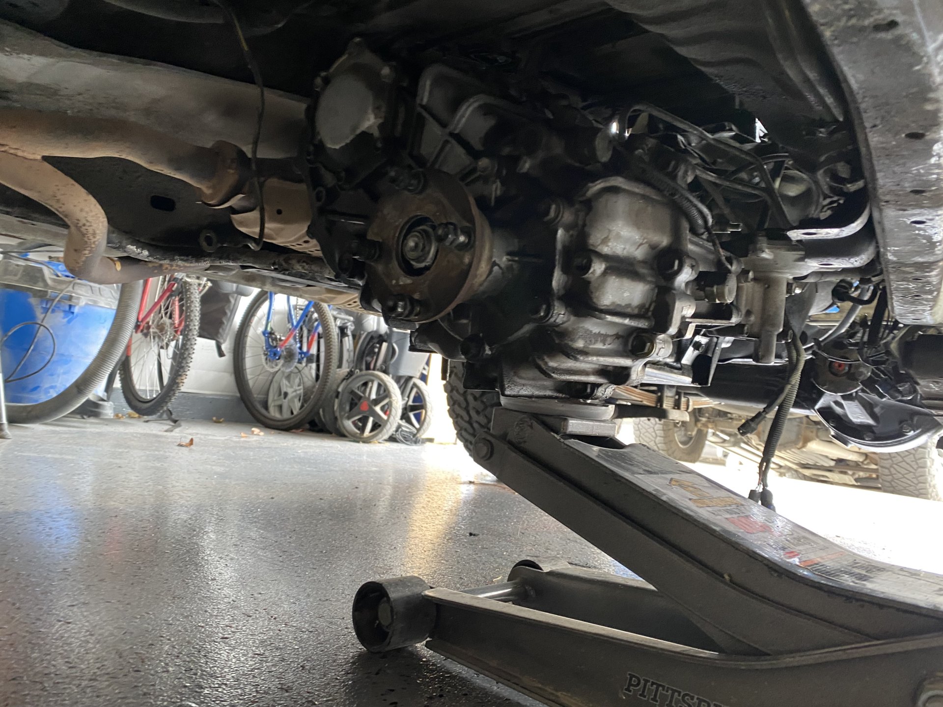

Today was more work removing anything holding the driver train into the body. Fuel filter and fuel lines disconnected, and then exhaust pipes and driveshafts.
Some heat persuasion was required. I also feel like every single possible oil joint leaks on this vehicle

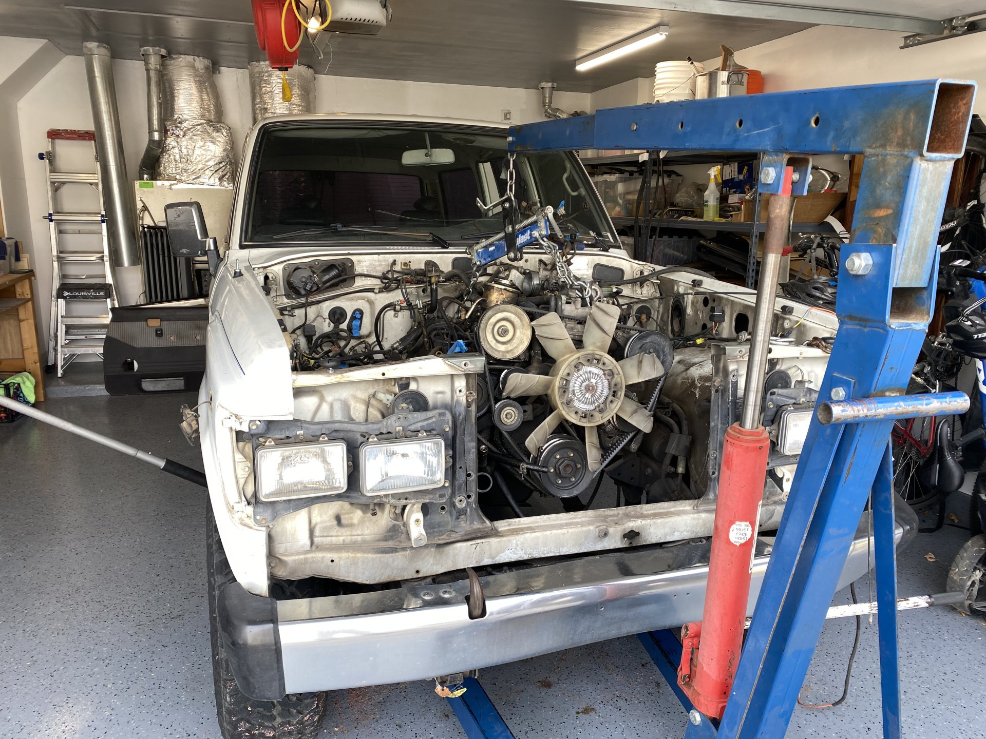

Today was a solid day, all the preparation work paid off. Started with removing the two 17mm transmission nuts, followed but a jack to hold the Tcase, then removing the 8x 14mm bolts holding the crossmember in place.
Few photos of the engine hoist setup. Its fairly secure but you feel on edge the whole time. Picked up this hoist and load leveler for $100 a month or so ago and it worked pretty damn good.
Slow and steady, up and forward, etc etc. Its not hard, just watch for wires you forgot. I only missed a ground wire from the body to the rear enigine bracket, and the ground from the body to the passenger mount.
Higher and higher she goes, until you hit the garage door with your hoist arm...
The garage steps down to the driveway about 1.5" so that was fun to deal with also
Careful zig zagging kept the front feet on the garage floor.

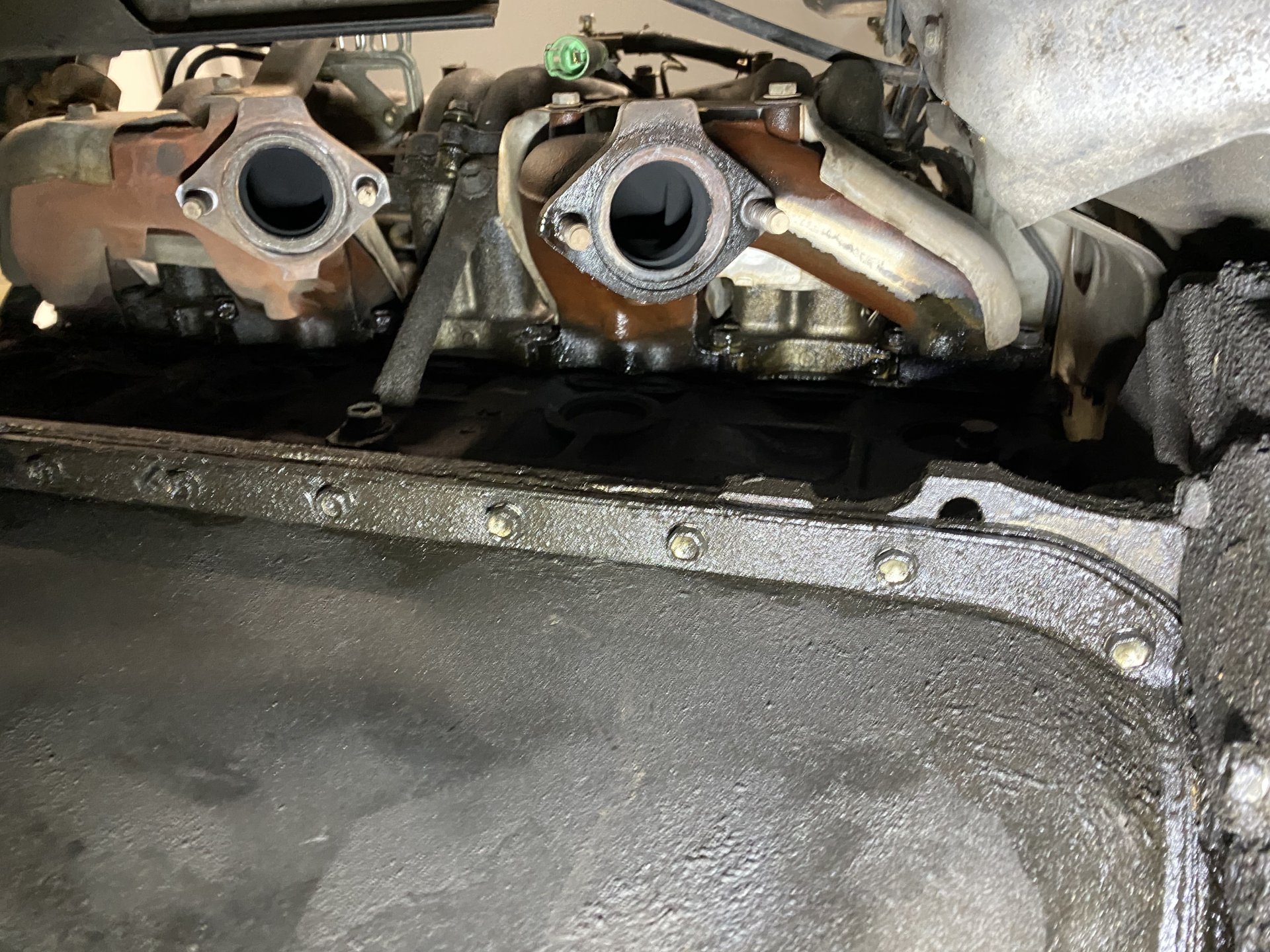

Successful but sketchy touchdown. Yes I know to be careful on the weight on the main pan, but this was about as good as it got. Jackstand under the header for rollover protection.
Open bay full of opportunity. Time for cleanup, tape and paint.

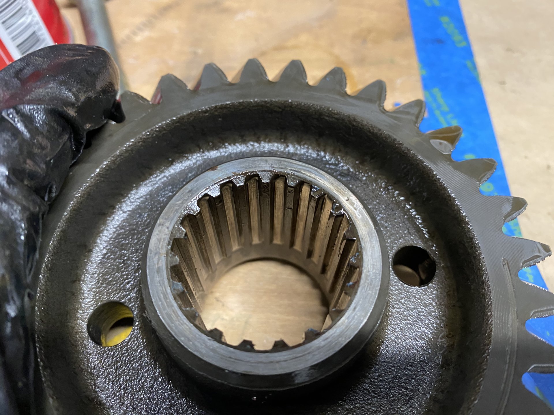

Looking at the idler shaft (think thats what we call it) and orientation of the thrust washers.

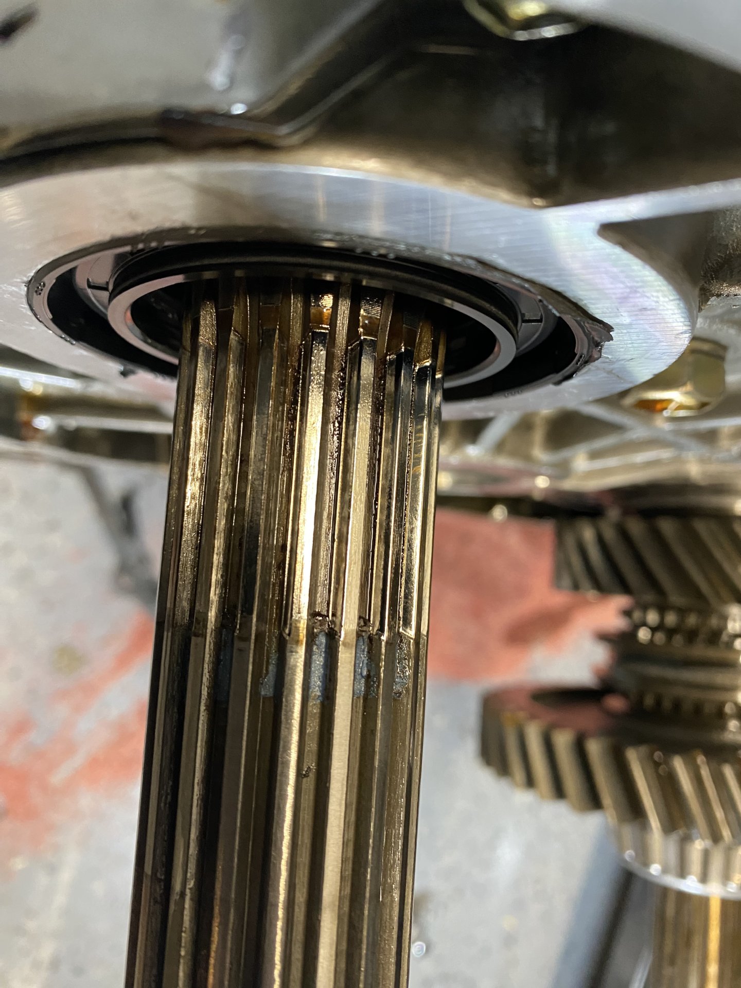

Input shaft condition
