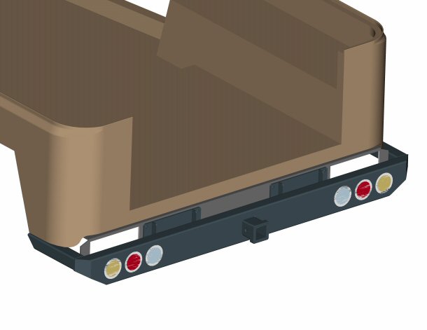

Bumper idea...critiques?

I've found some smaller diameter LED lights at Auto Safety House that may do the trick if I decide to forget about using stock lights. Whattya think about this?
I'll probably recess the lights into the bumper

i like it but r u planning on that much of a gap between new and old bumper? are you trying to avoid cutting the stock bumper?
mike
I'm not sure what you mean by old or stock bumper. :confused:
If it's the rear frame member you're referring to, then the gap is only an inch between them. Just enough to get hardware in there. And no I don't want to cut the frame. The height was established by bringing the top flush with bottom of the tub for corner protection.
Try flipping the center bar over, so the tapers are up, may look better with the tub lines and gain departure angle?
I tried this, it looked kinda "upsidedown" to me. I think I might try to split the difference and make it symmetrical from the side.
The departure angle will improve. But anything I make will be an improvement over the plow I have back there now. :D

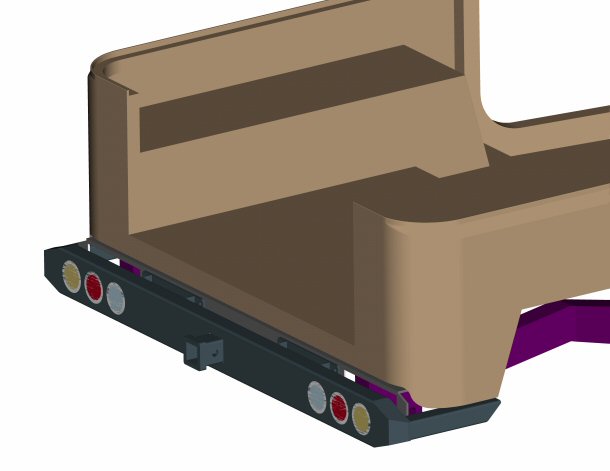

Later that evening.........
I went back to my virtual drawing board, how about this? I'm starting to like it better

Tools R Us said:
I like it Cliff, Rick's looks good too. I would move the receiver flush and pin it behind the bumper.
Good idea, I'll make that happen when I actually make parts. Rick's looks like you suggested. Now that I see it in real life it doesn't strike me as so upside down as my cad model did
