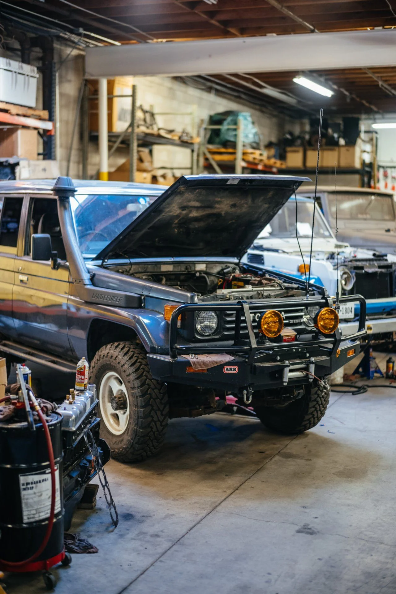

Well, about a week after getting to California, the HG decided to let go about 2 miles from home. Cranked the heaters and limped it back. Truck is now at Valley Hybrids for assessment and repair.
Short list of work to be done:
- HG repair, probably more associated things which need repair.
- Front/Rear axel rebuild (finally) with new rotors and drums/shoes
- Engine mounts
I may try to get a u-bolt flip kit out to Georg as well if I can source a kit.
Here she is waiting for her date to home coming:
- Engine mounts
