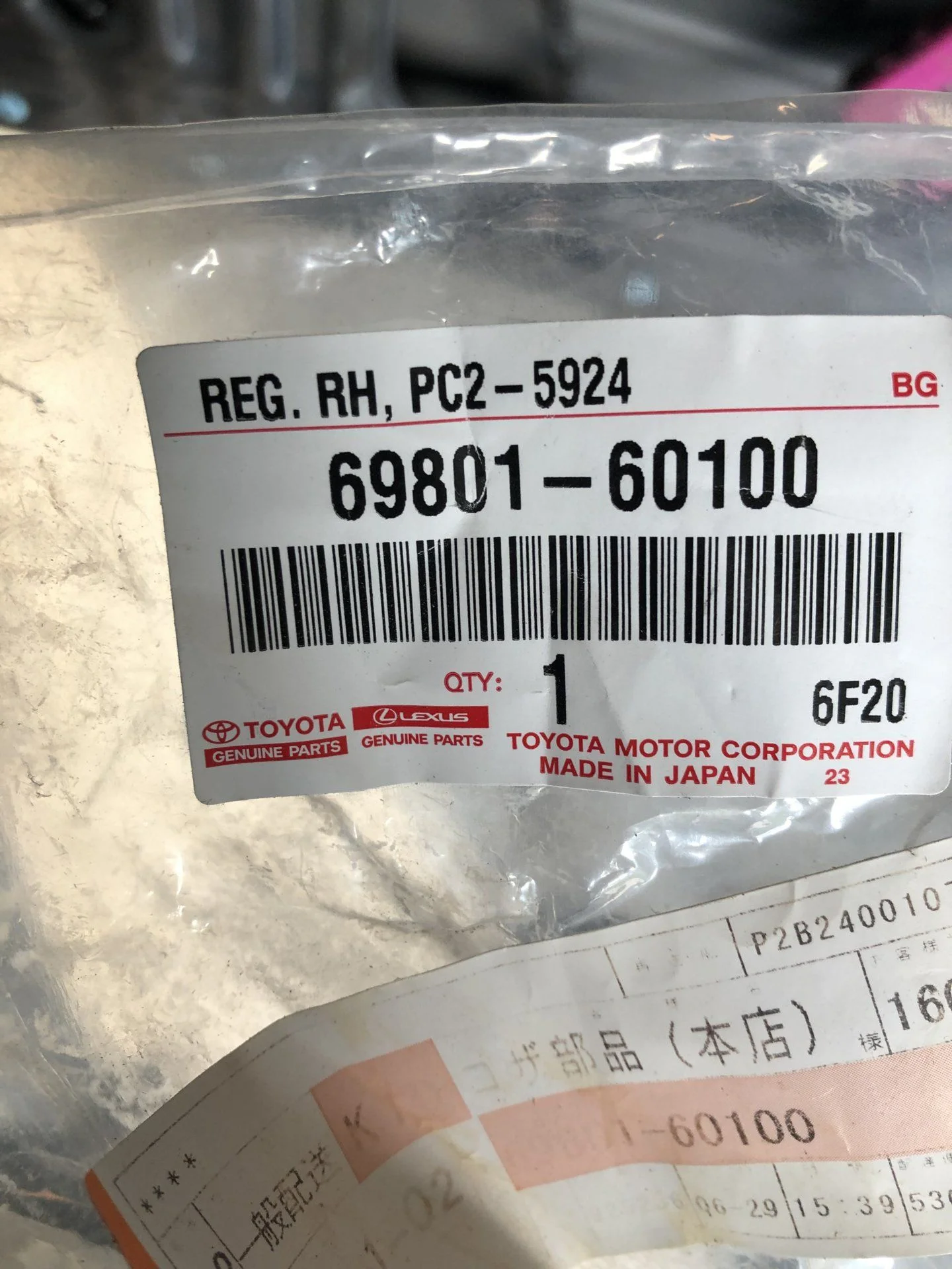

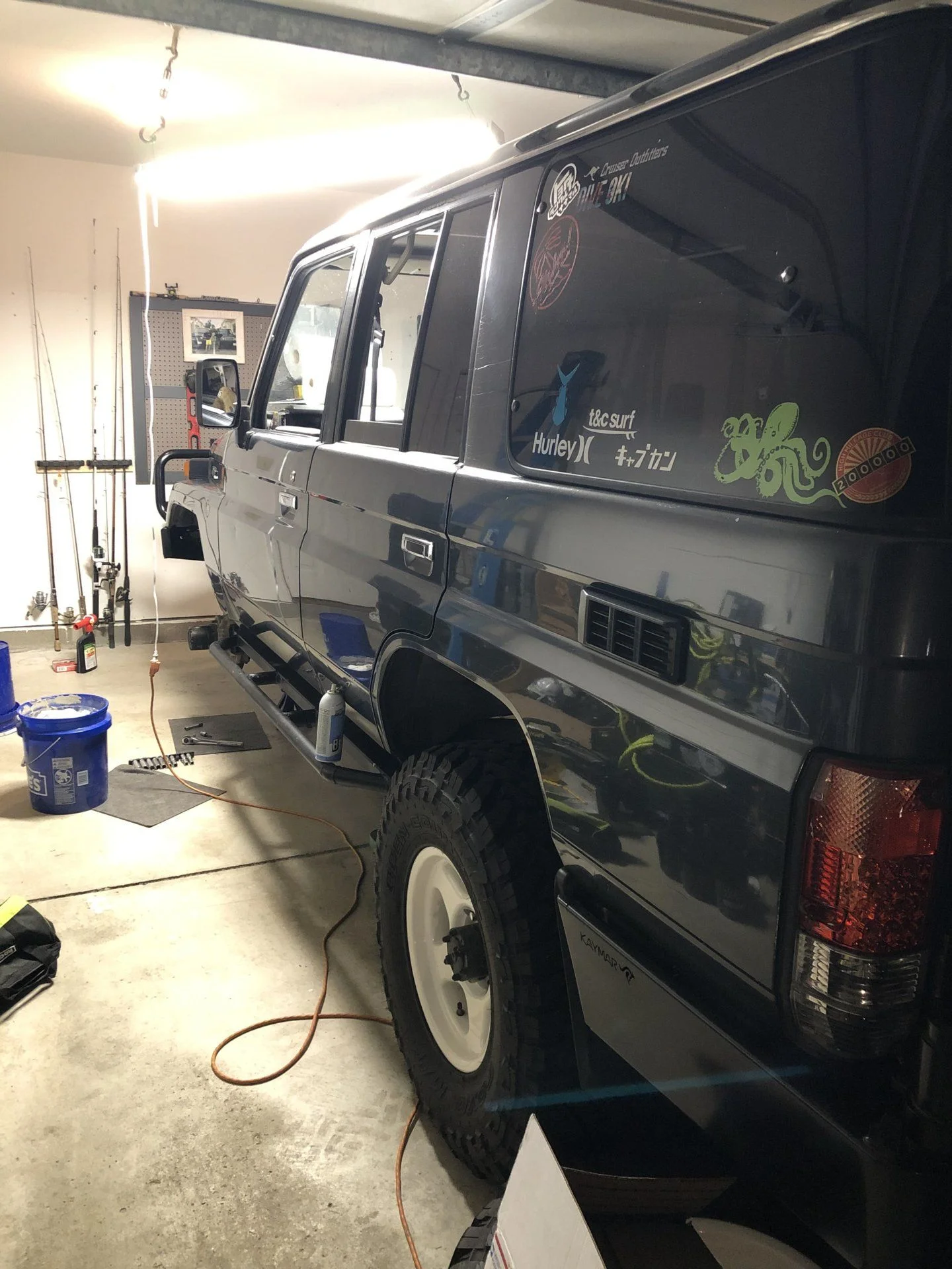

New outer weather strips at each door and window motor with regulator for the driver’s door.

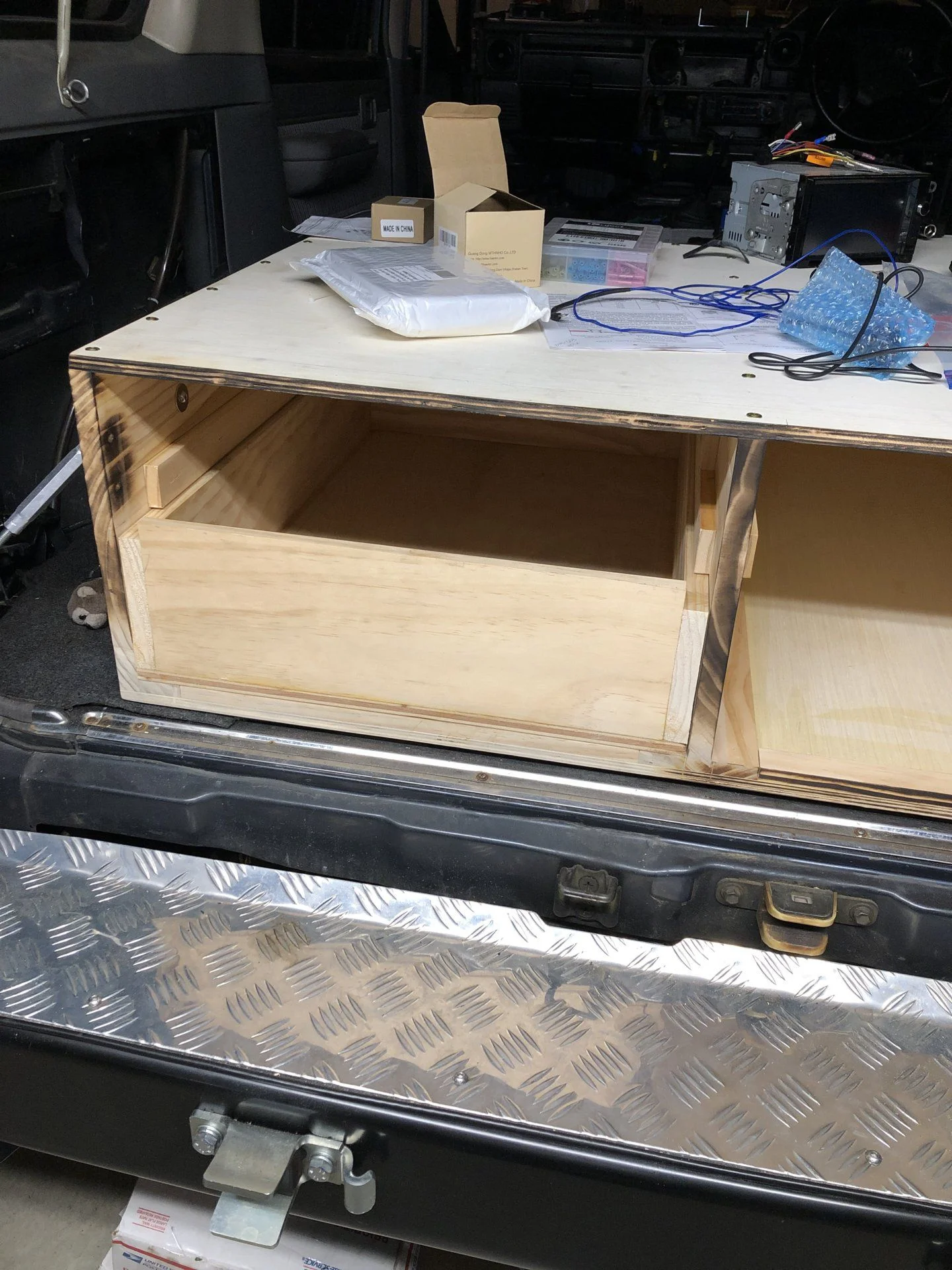

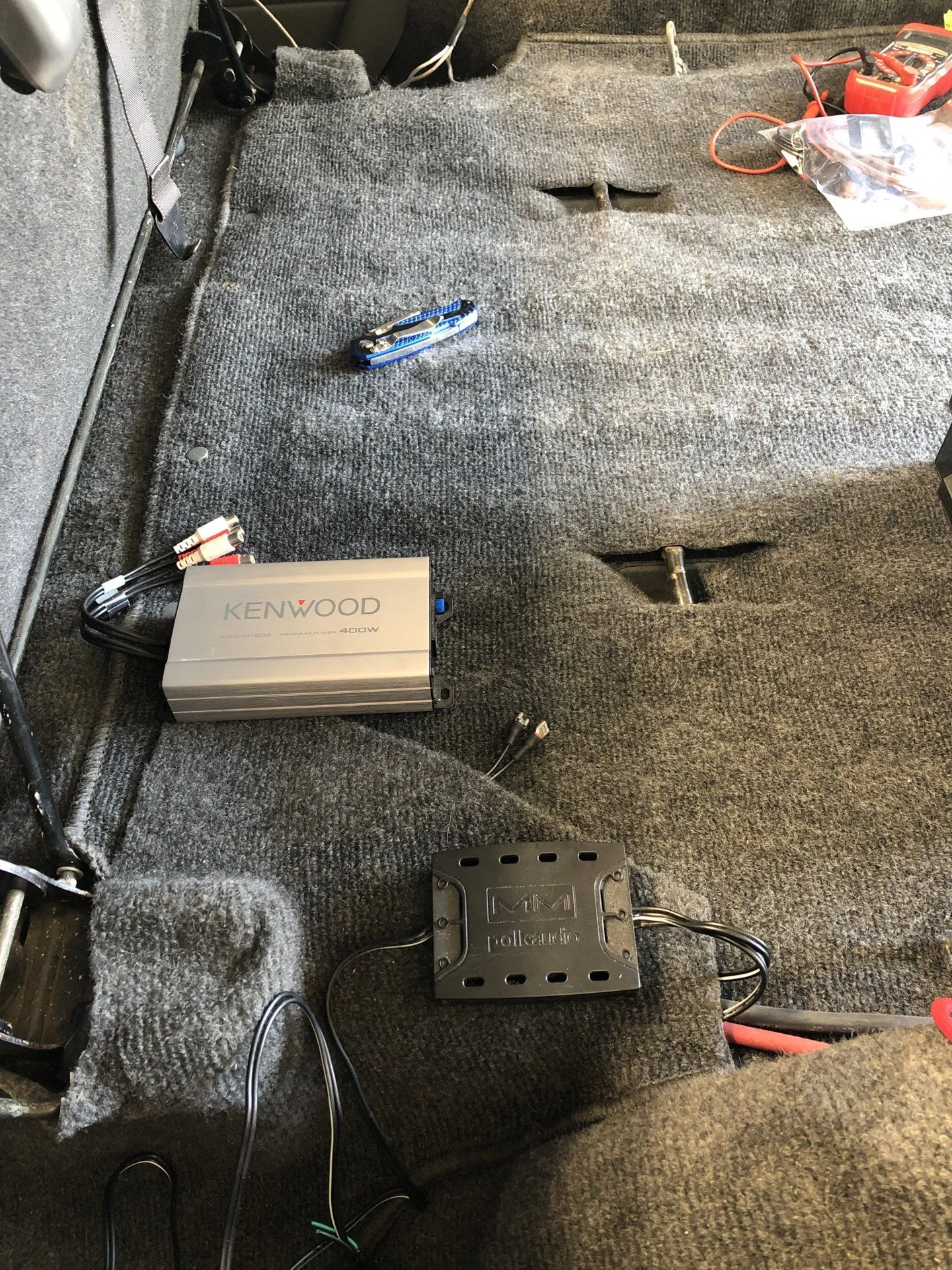

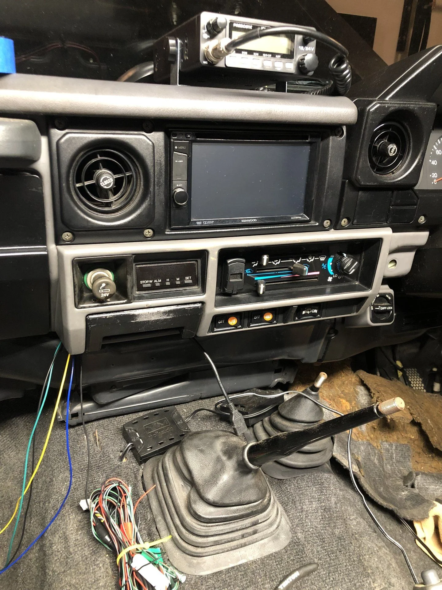

Been busy prepping for the meet and greet. My wife took the kids up to the grand parents for two weeks to leave me to my own devices. So far I’ve been able to soft wire; old head unit, door speakers, amp, redarc and third battery. Waiting for amazon to deliver tomorrow to finish everything off on that portion. Additionally, tomorrow will be a stop at the hardware store for material for drawers, and to finish my catch-can (getting creative with mounting).

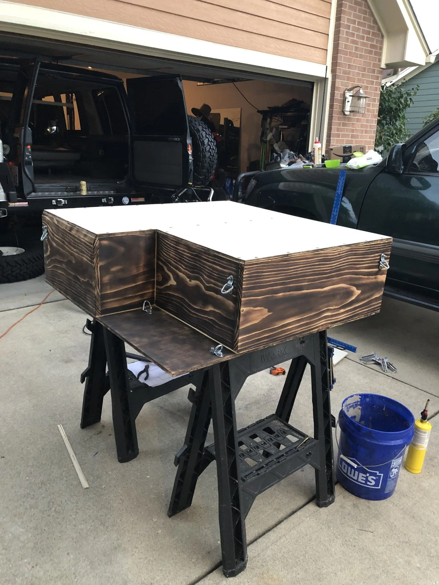

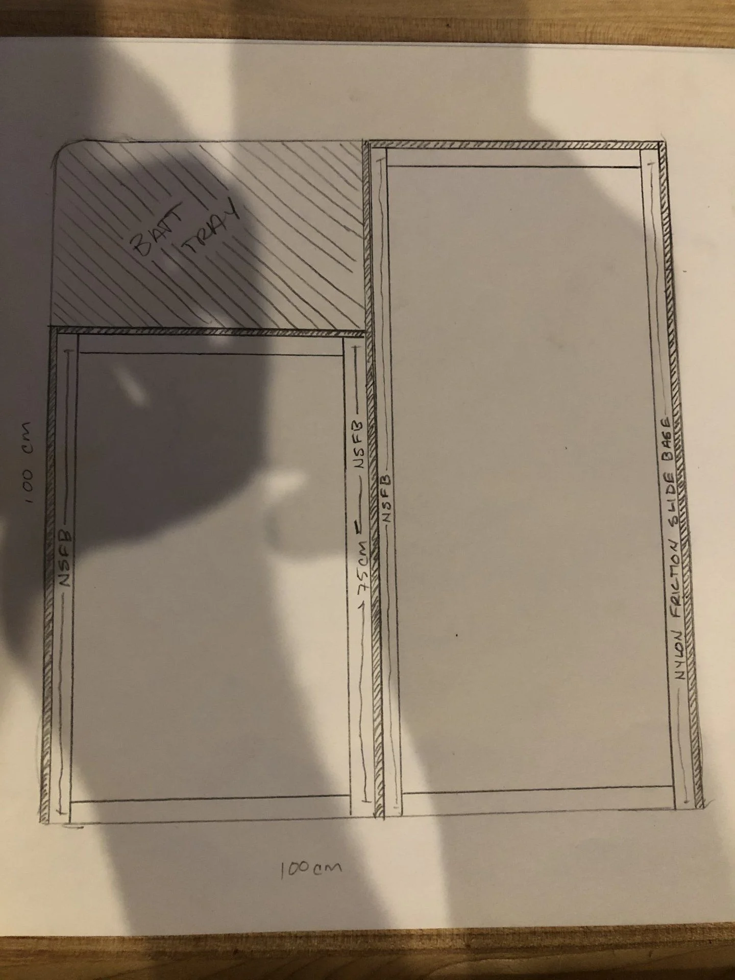

Rough print of what drawers will be. I’ll document the drawers in a stand-alone thread.

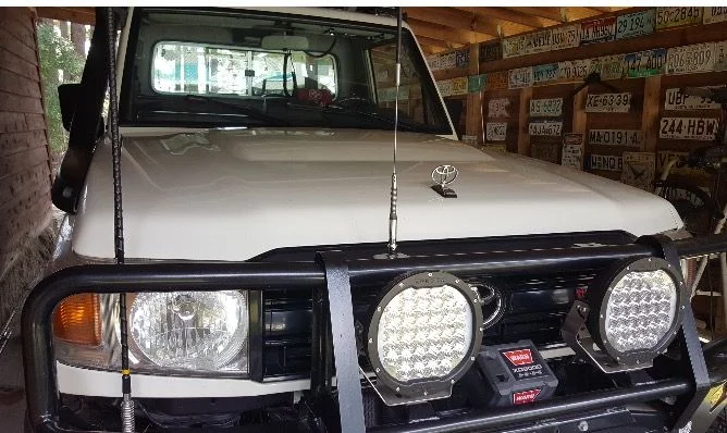

Interesting radio with the name President on it.
The only radios I have owned with the President name on them were the CB or 10M Export radios.
I will assume that radio is a Ham radio of some sort; possibly 144/430 Mhz.
I see it has a 12/24 volt selector; so its probably an Australian radio.
Could you provide me a little info on the radio;
I

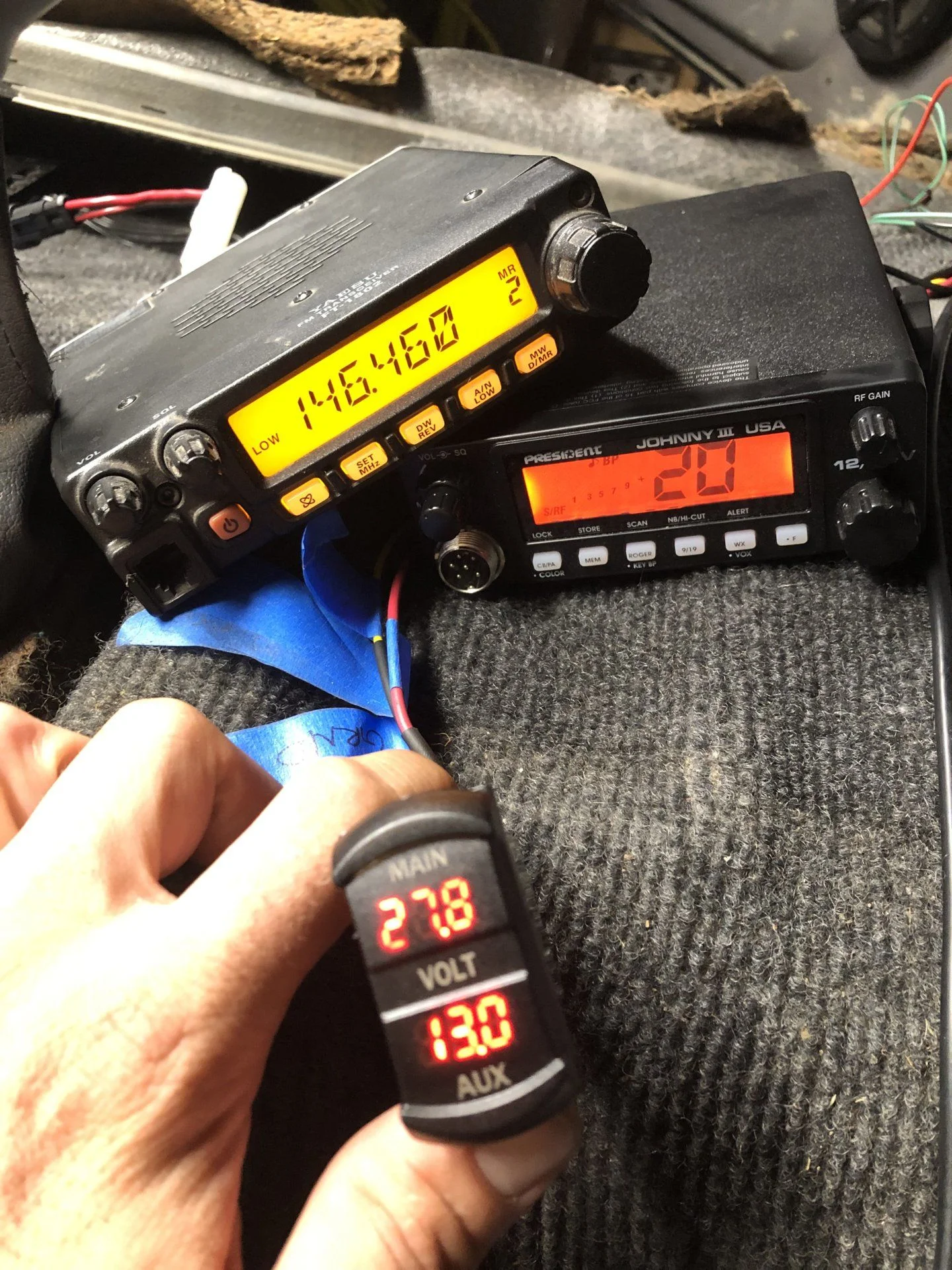

President Jonny 3 with a 4’ firestick. I installed it last year but forgot to tune it before the meet , so can’t give you my opinion on performance yet, but here is the amazon link
Amazon product ASIN B01EVONKGQ
The past 5+ years that I offroaded in Southern California and Moab, Utah before moving to the PI; the majority of the Jeep owners were changing over from the CB radio to the 2M radio for audio clarity and transmitting distance.
In my Jeep XJ I operated a Cobra 148 GTL SSB and a Yaesu FT1500.
On the trail I rarely powered up the Cobra unless there were several vehicles without 2M capability.
Thanks for the radio information.
Yeah a lot of people are switching to a lot of things. Once everything is done I’ll be running CB, Ham, and uhf and possibly gmrs. Let’s be honest, it’s just to look cool with a bunch of aerials hanging off the truck :rofl:
Indeed it does, not to mention it discourages low flying birds.

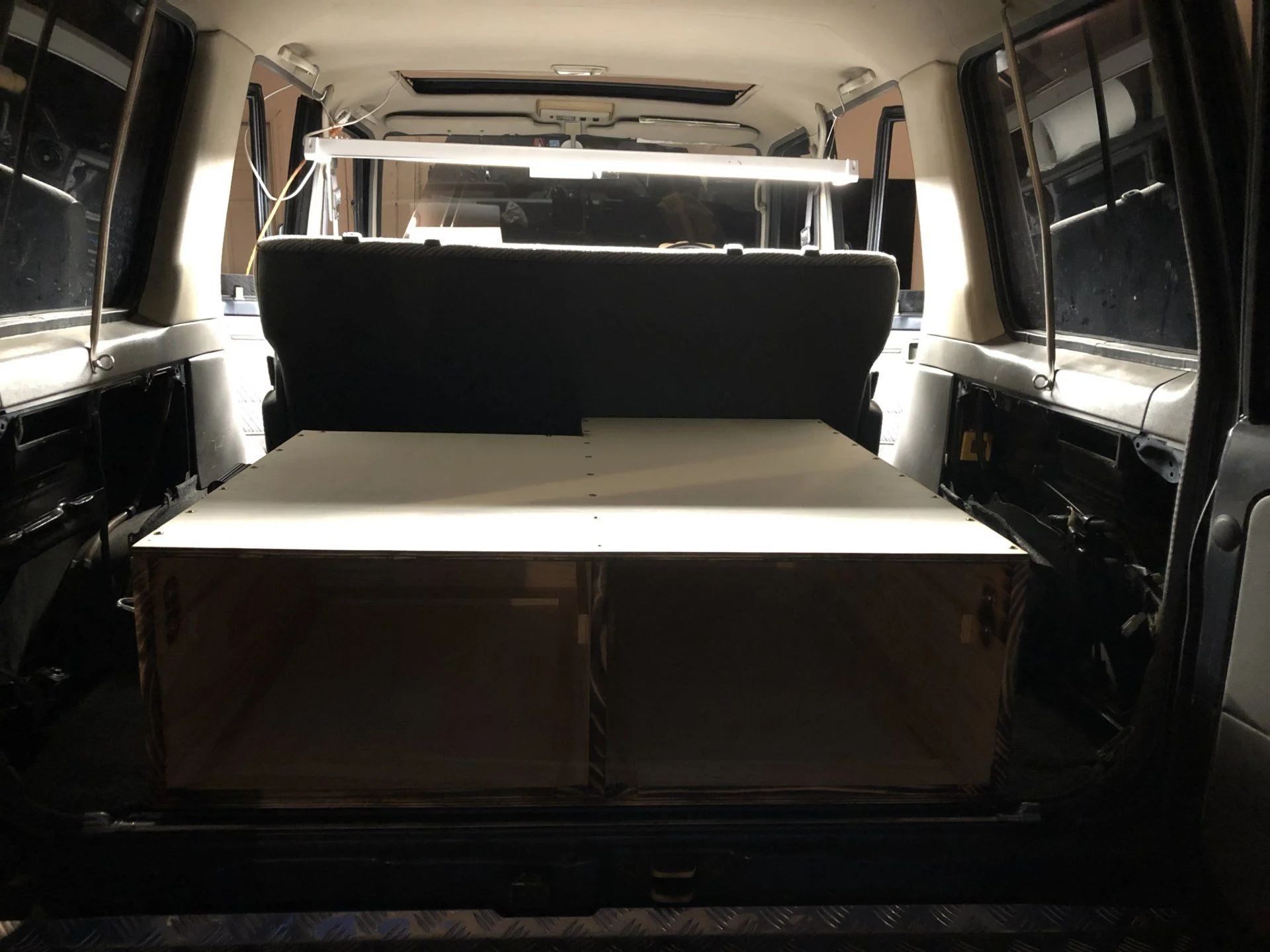

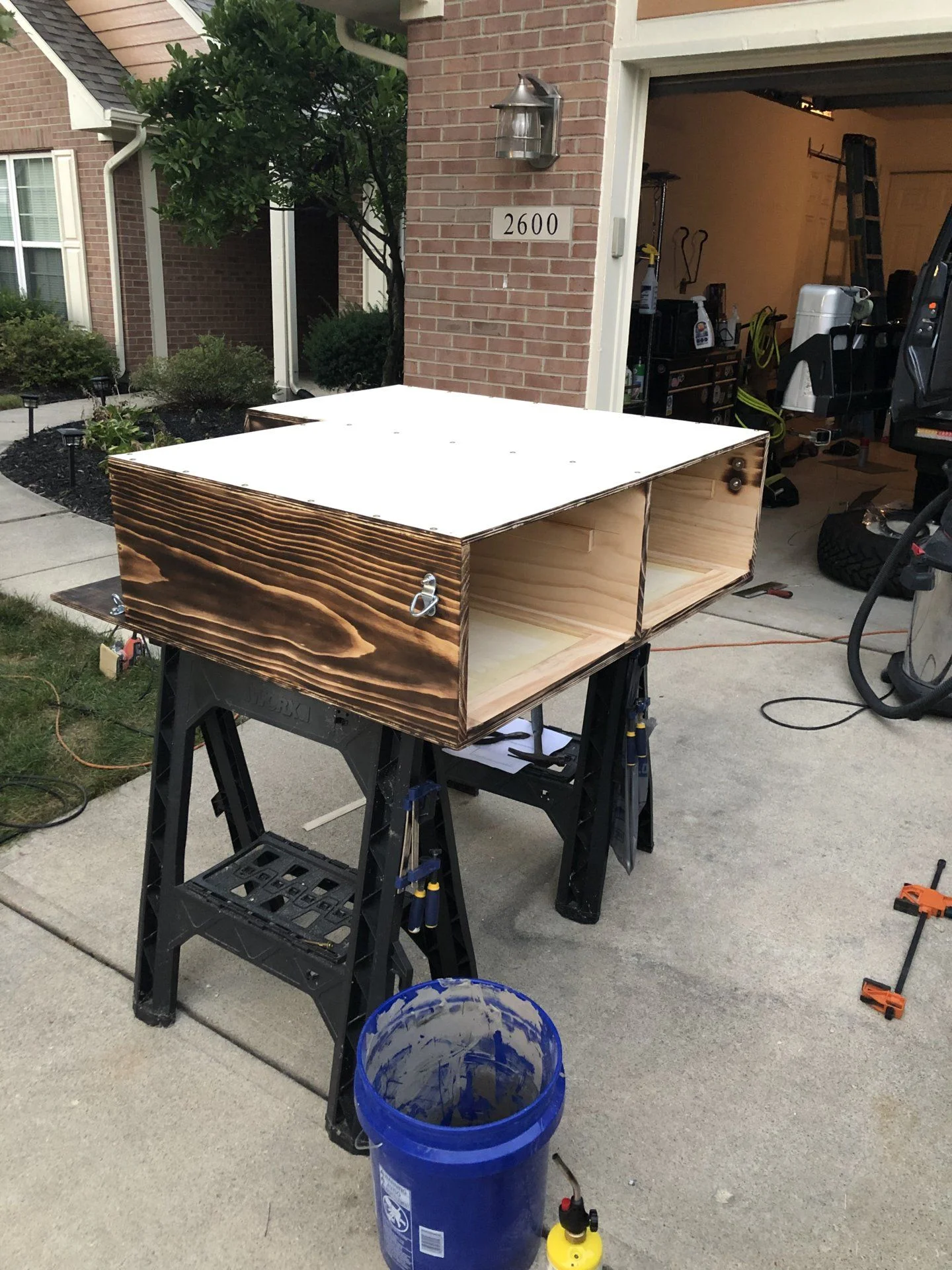

Phase 1 of the drawers is done. Probably won’t have time to go much further than this before the Meet N Greet. I will post a separate thread on the build process once it’s complete.
I keep running into supply shortages re-working my electrical accessories. This enabled me to be a bit more productive on the drawers while waiting on amazon.
Quick demo

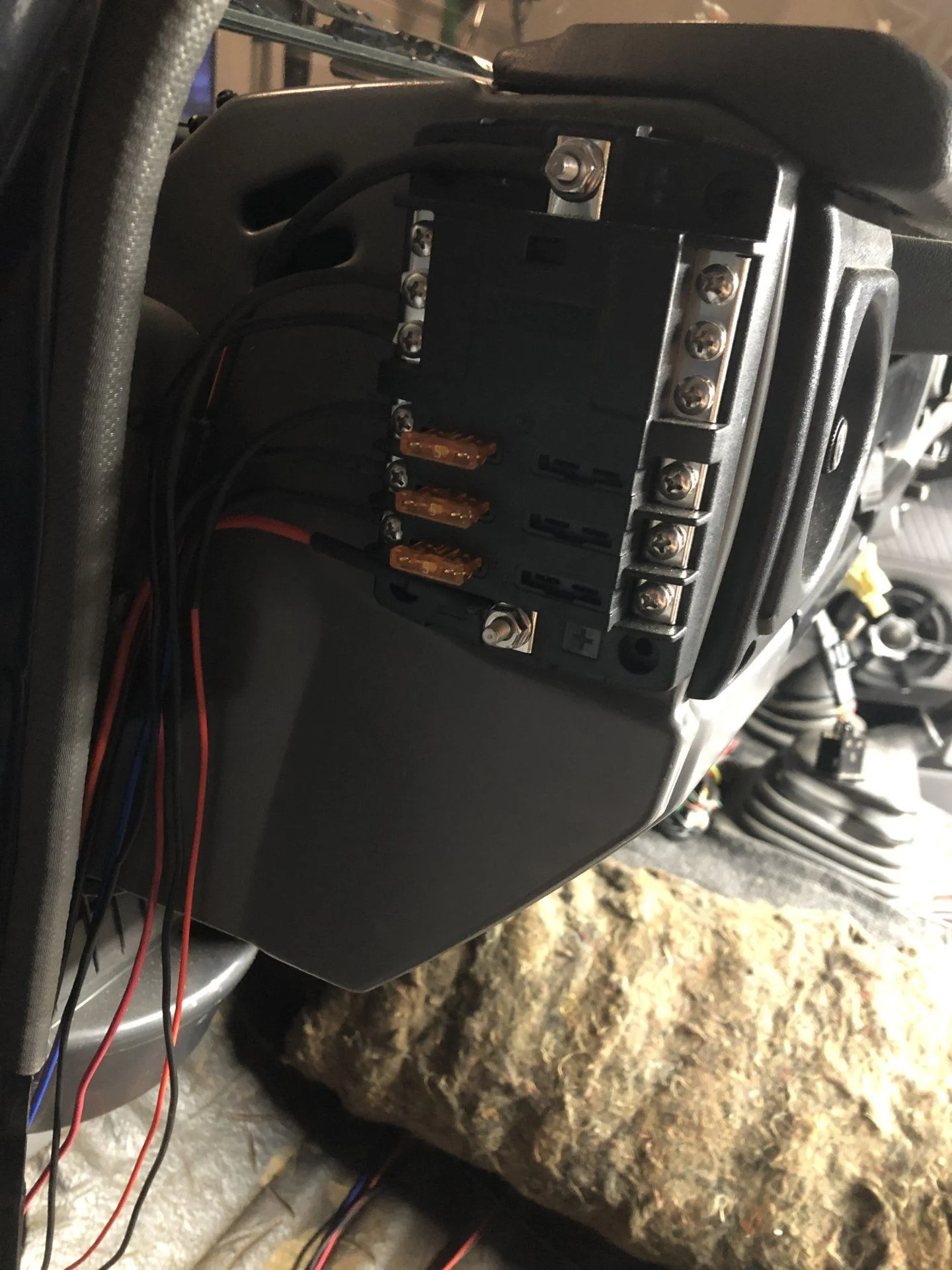

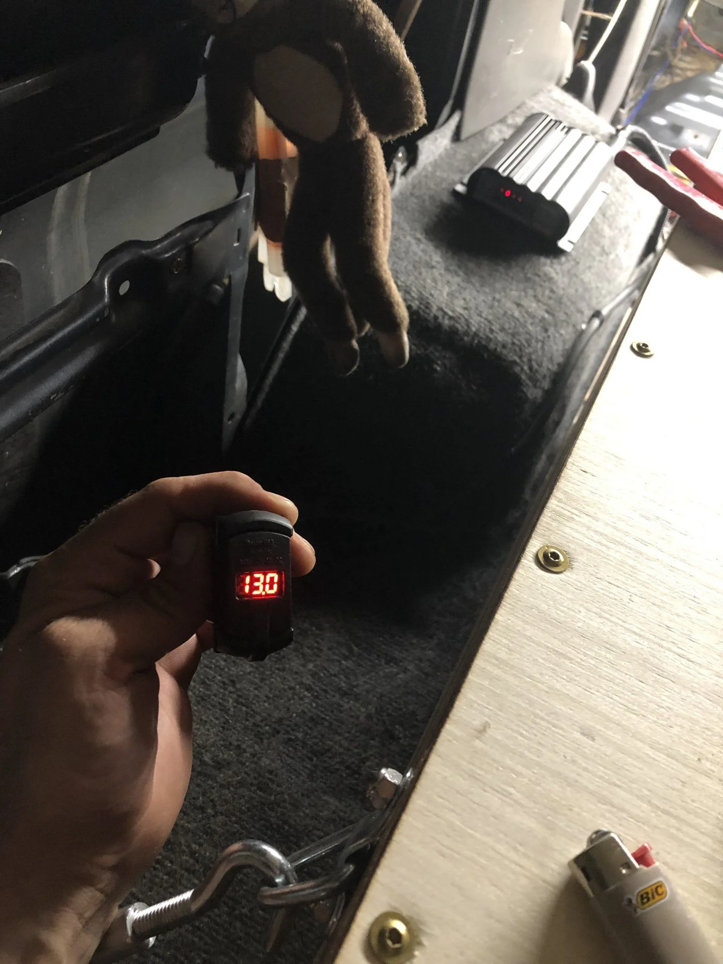

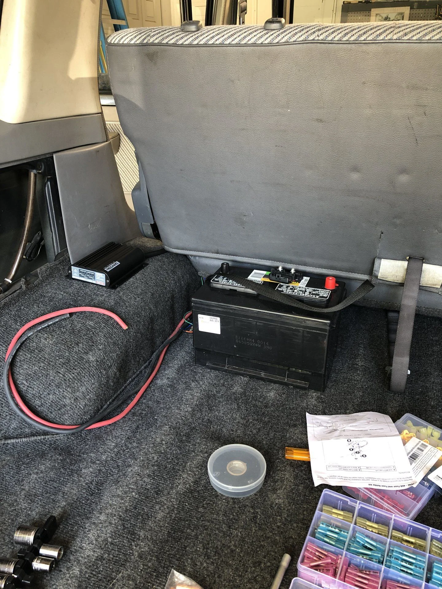

Additionally, I’ve got all my 24v accessories done. Went back through my previous work, eliminated chassis grounds and re wired by bluesea to serve as acc power supply.
Completed
- dual voltage reader
- dual usb charger
- cb
- ham (soft wired)
- reverse camera (soft wired)

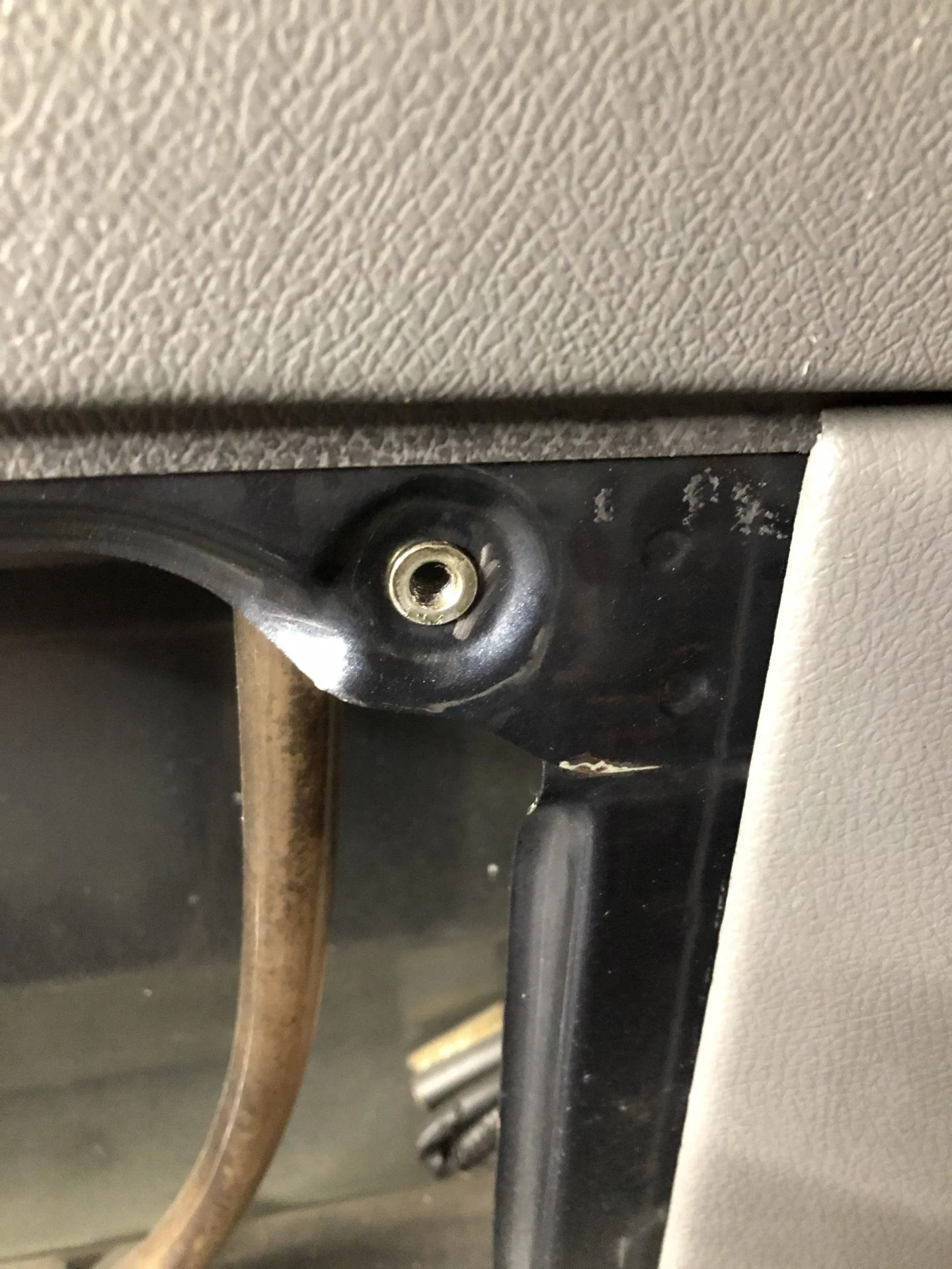

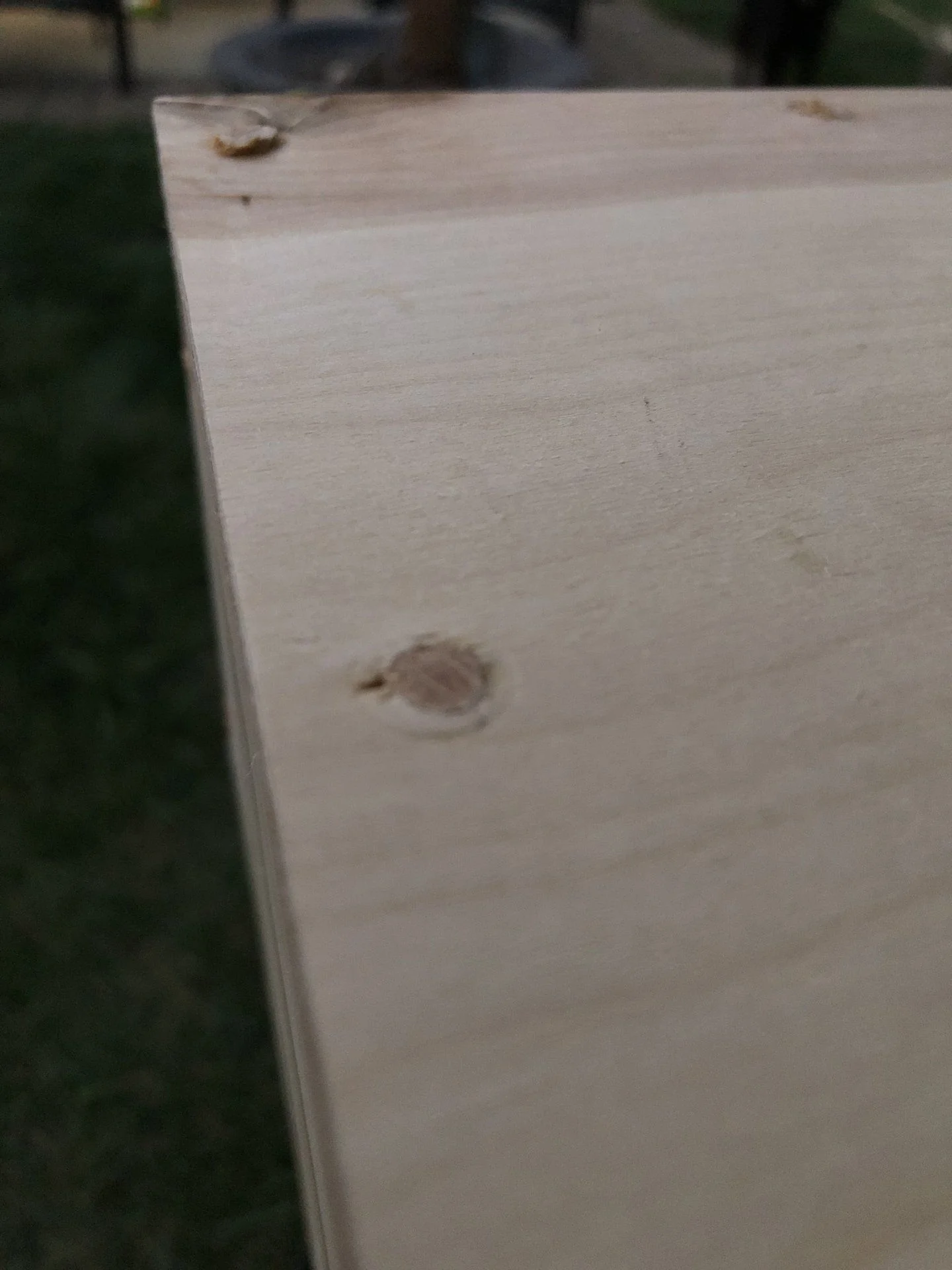

Worked a bit on the tool drawer, decided to add additional nylon tape to the center. Also added nutserts to replace the plastic retainers when I start building up the wings.
Making up “lava paddle boards because the grass is lava” for the kids with scrap.
This is the tool (left) drawer slides. I’ll likely do a similar spine for the kitchen.

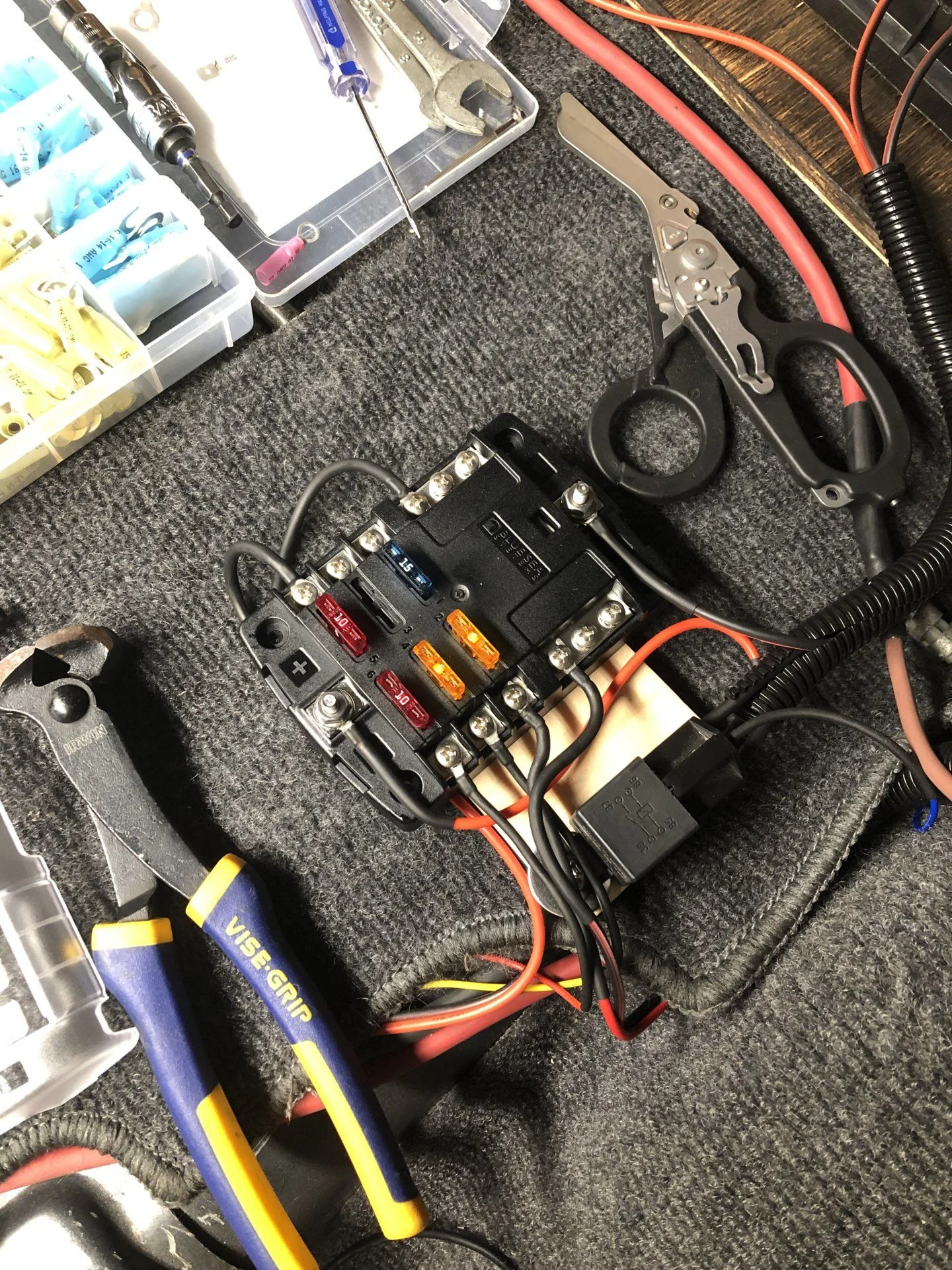

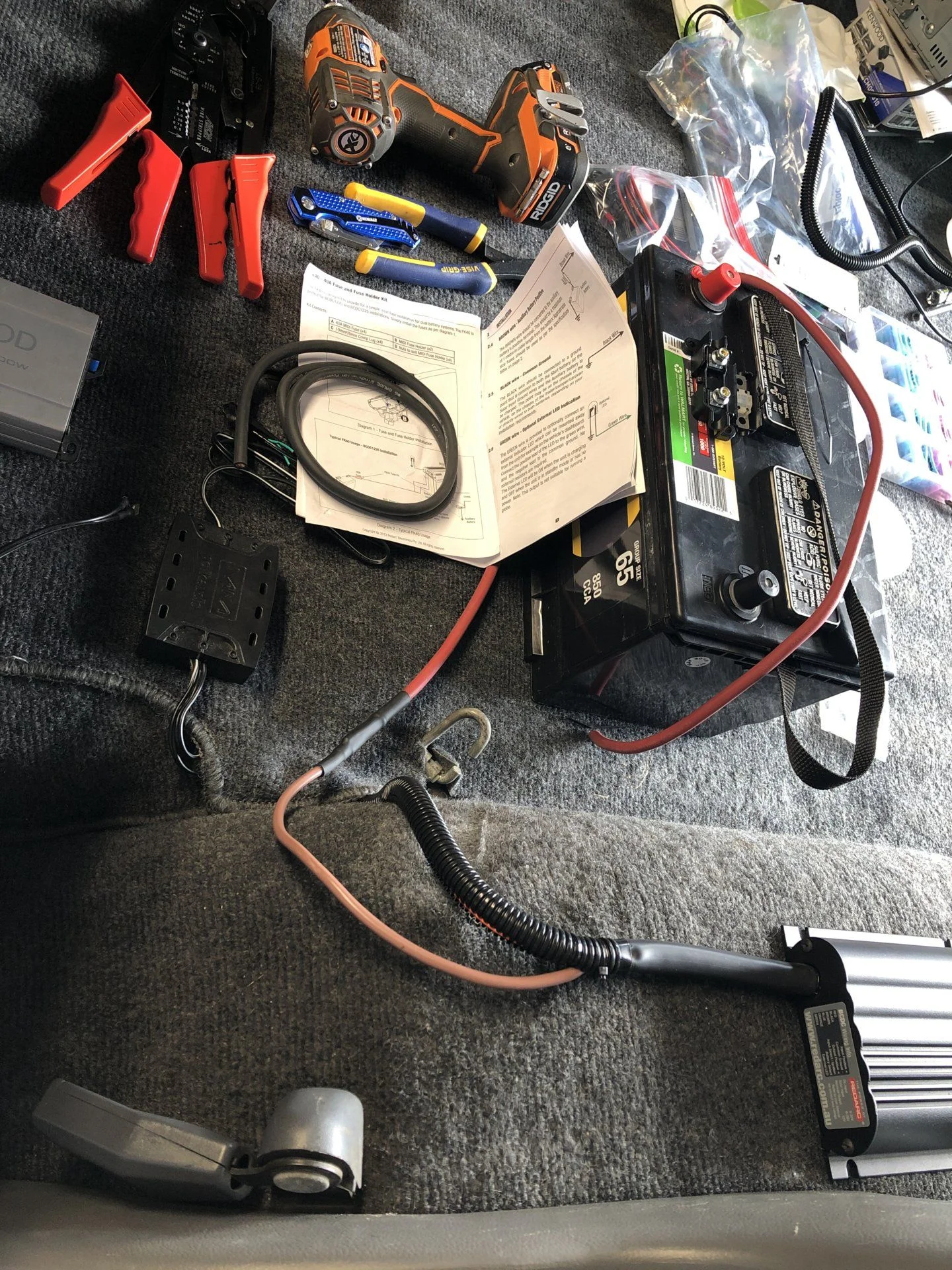

12v system wired up isolated by redarc bcdc1225. All accessories wired up and bench tested: main/aux voltmeter, front dual usb, rear usb with 12v (may connect for power constant with a switch), Ham 12v, cb on 24v, DRLs 24v, aux lights 24v

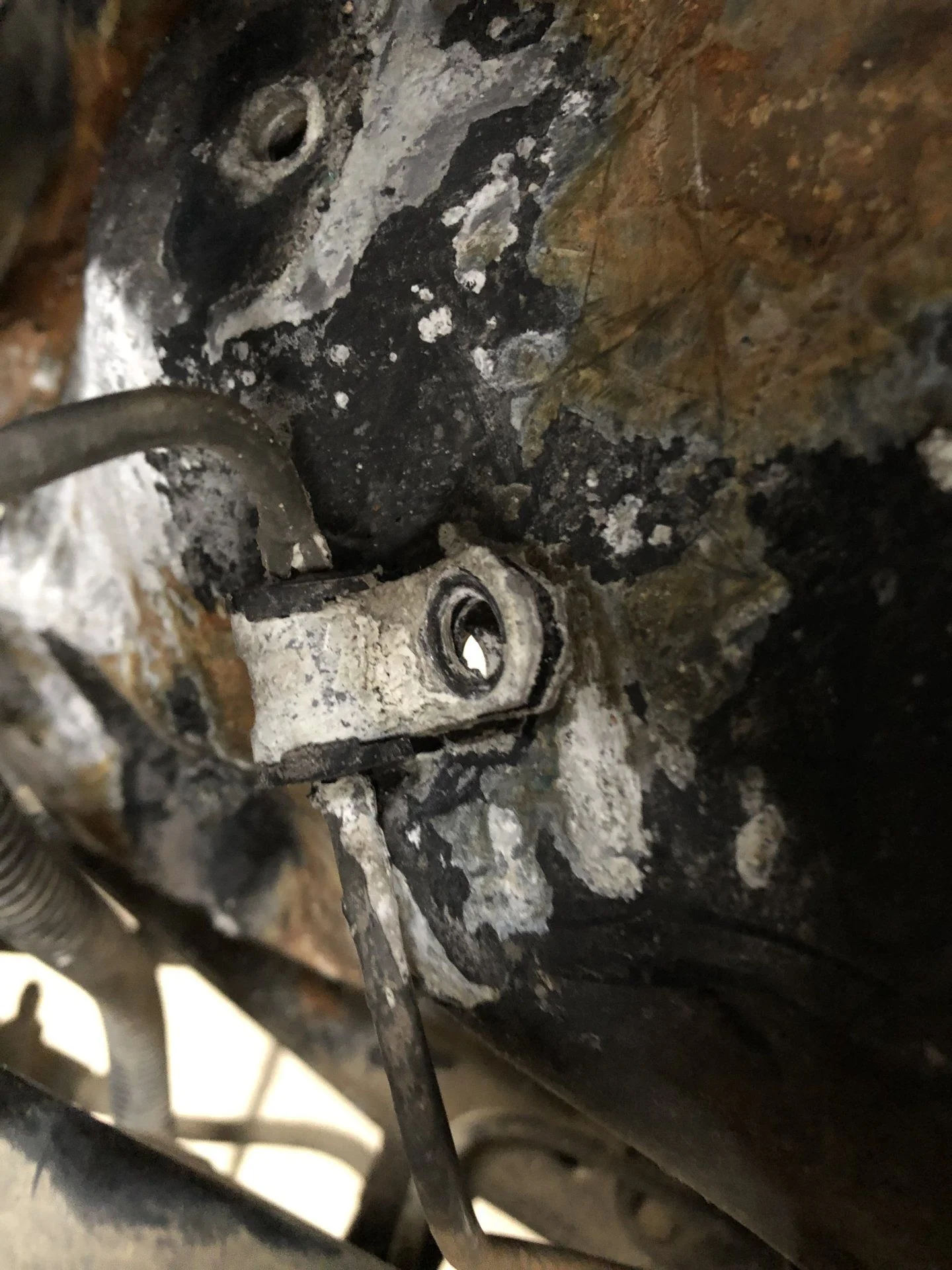

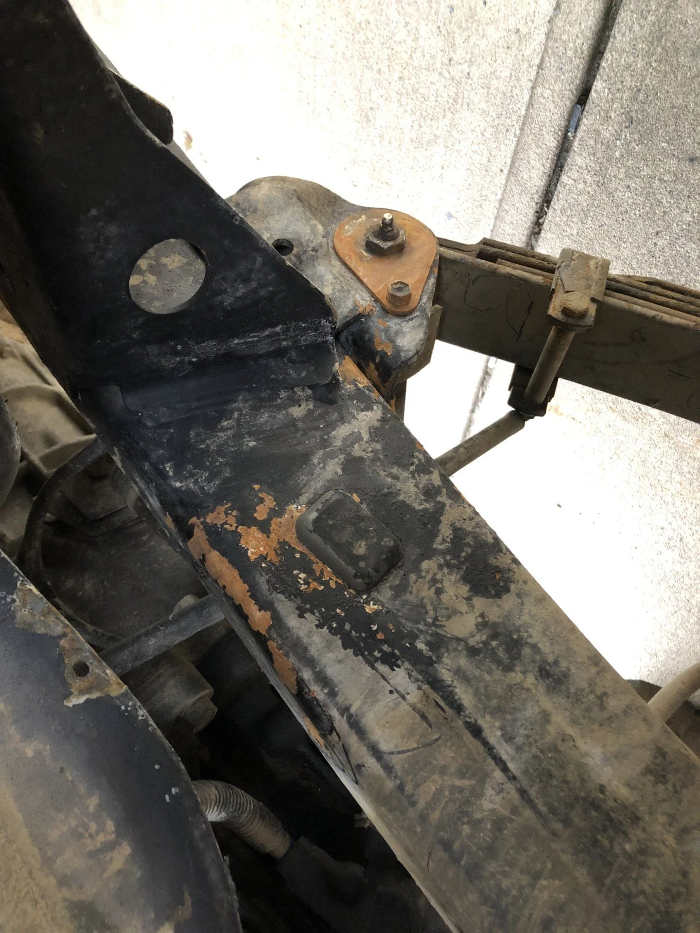

The result of a cracked battery:

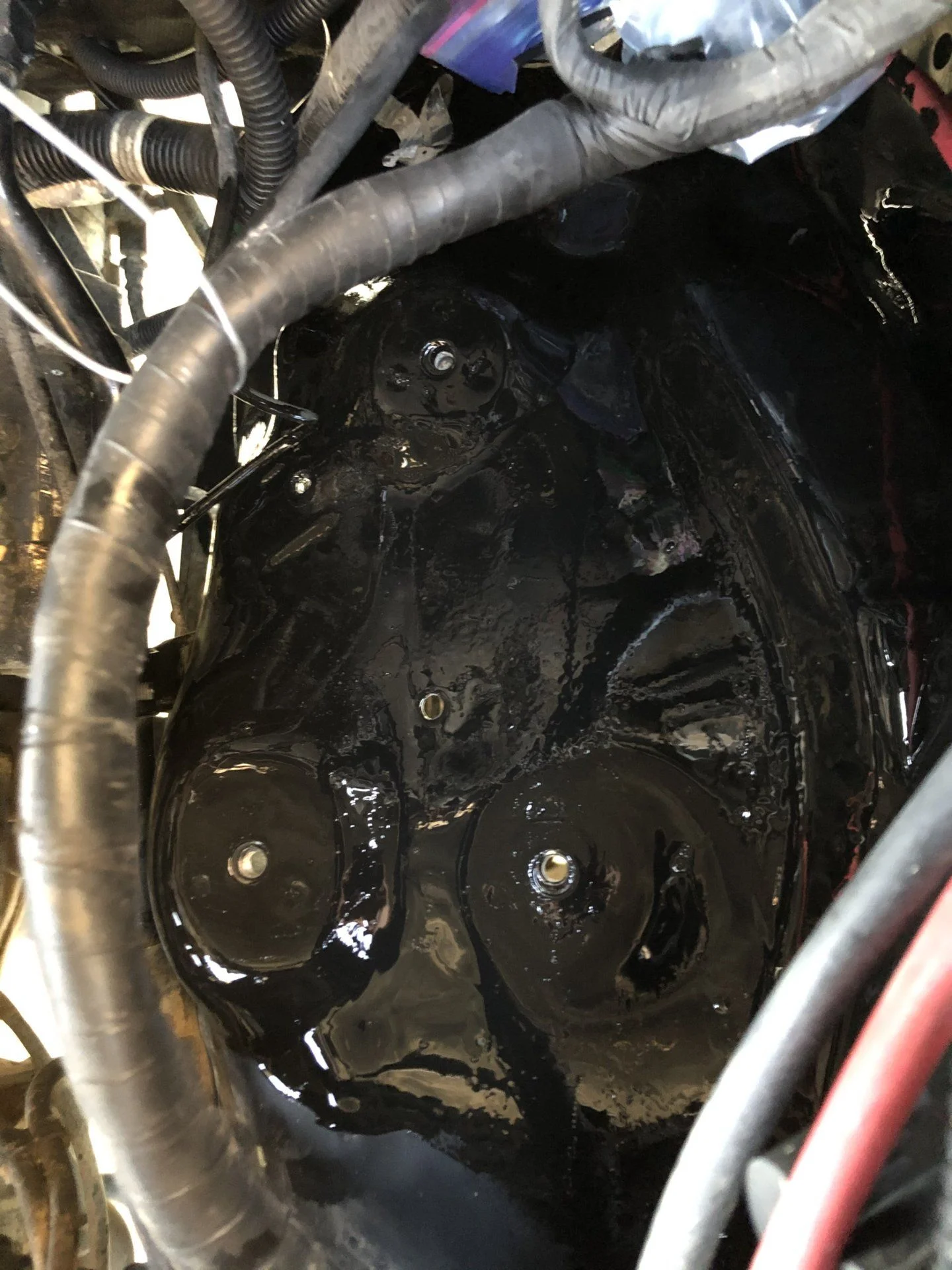

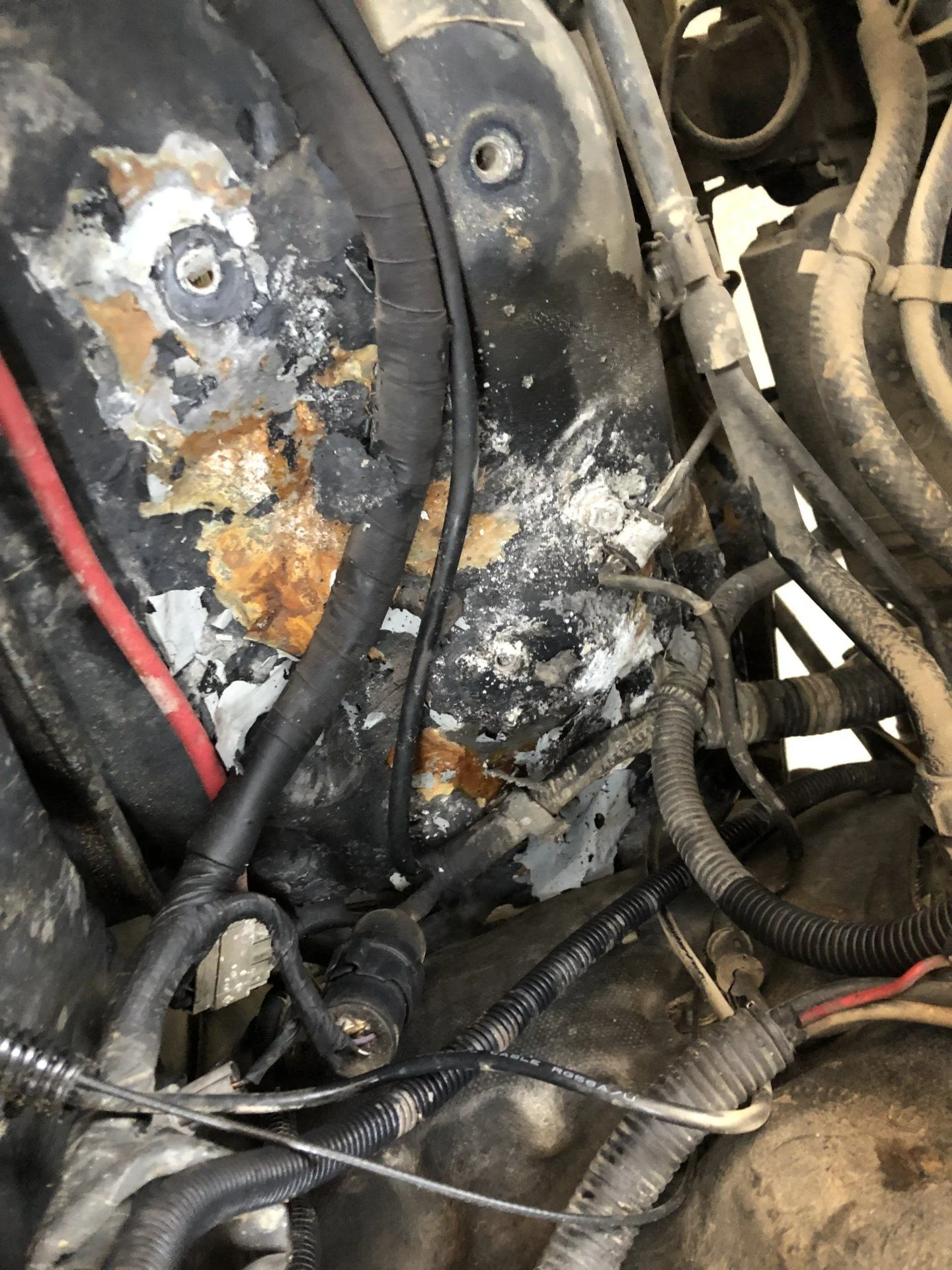

Spent a day on cleaning the area with concentrated simple green to neutralize the acid and debriding destroyed paint.
Used metal prep and applied liberal coats of por15. hopefully I don’t have to deal with this again.
Ordered some battery mats for all my trucks. As insurance.
