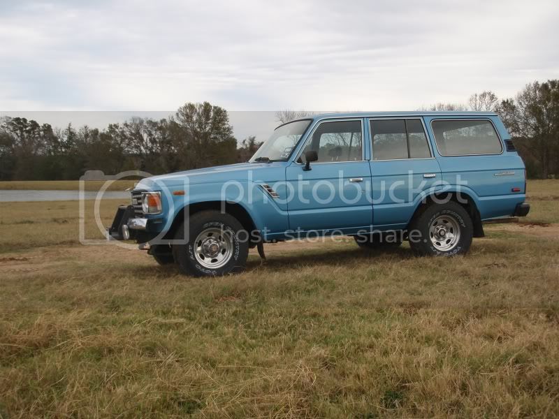

It was dark when I finished so no pictures tonight. I have attached a picture though of the truck as I got it on day one.

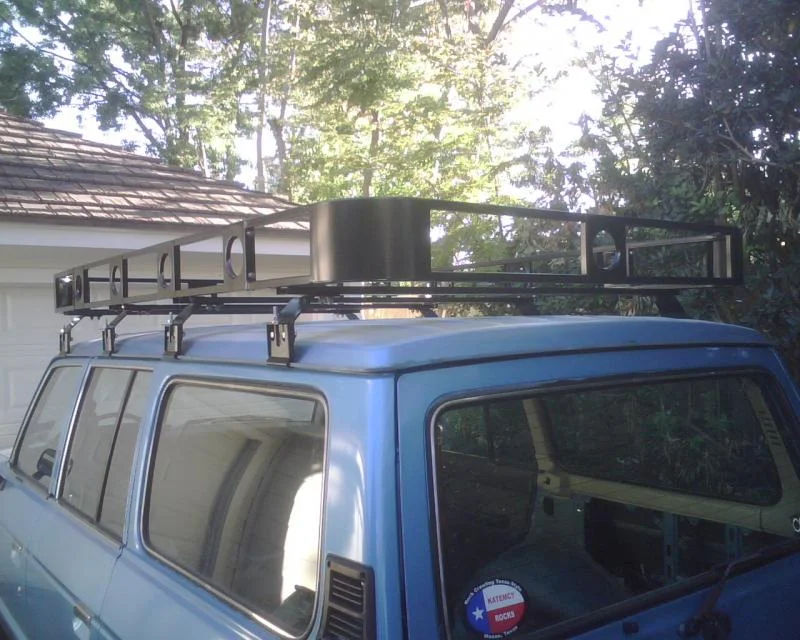

Well I got the interior out of the truck except for the rear heater. Rear cargo panels and tailgate mod from Kevin over at Wagon Gear should be along in a month or two. I took all the metal parts out of the interior and got them powder coated along with the roof rack. After trapper50 cal posted some pics for me I was able to rack on the truck. Not only has it been powder coated but also I replaced all the bolts, nuts, and washers with stainless steel. I did so because the zinc plated ones that were on there from the PO were almost all rusted out. My camera is charging and I snapped this one last night with my phone.
