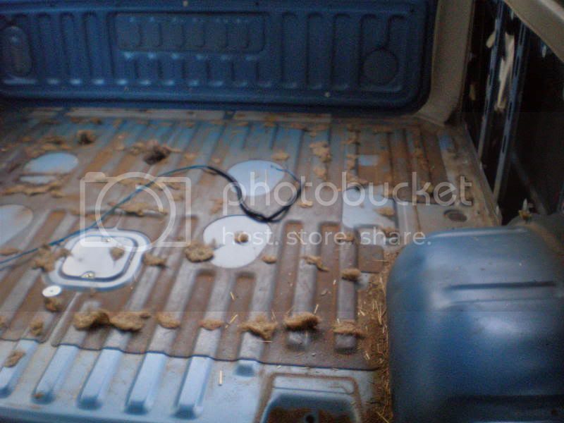

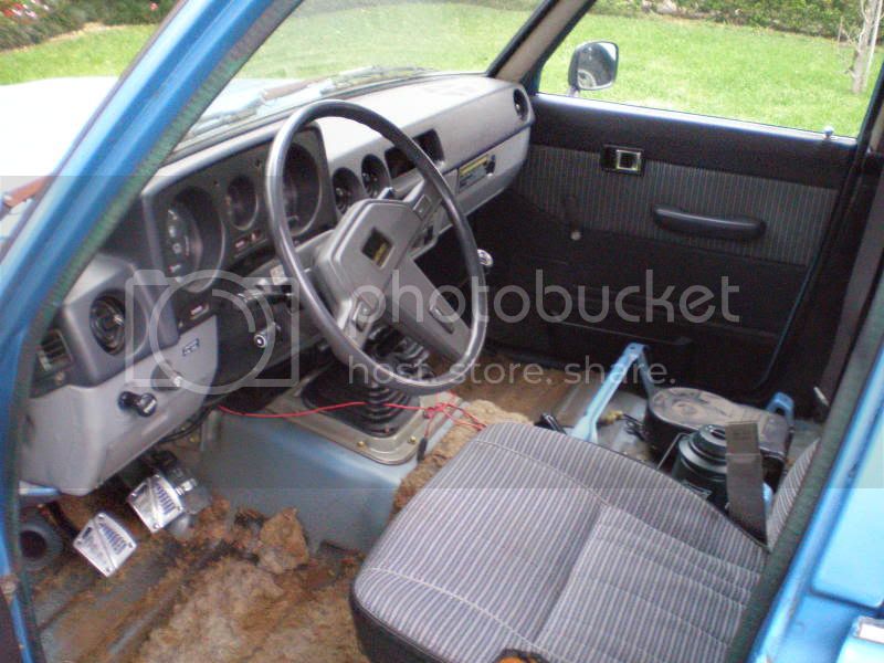

Hopefully if it stops pouring I'll be removing the fuzz tomorrow.
More fuzz to remove and still waiting on my panels from Wagon Gear!

You have a great build planned. How's the noise with the carpet removed? I pulled my tar mat before starting my damplifier install. Dry ice and a hammer might be easier than spraying over it (or fighting to get the jute off the tar mat).
If you have a compressor you can do the interior yourself w/ a liner gun (not very expensive - harbor freight). You could also look at lizard skin - my uncle says it's a great dampener/liner. Or for a bit more $ - second skin has their spectrum, but not sure how it compares with a true liner like line-x or herculiner.

I ordered some Vinyl flooring for the front and rear seating areas from Tru-Fit in Australia. I will let everyone know how that stuff looks. I also ordered some POR-15 Speed Liner for the rear cargo area. The current plan is to spray the floor, the back of the rear seat, and the side up to the headliner. I would also like to spray inside the panels where I will be storing gear. Kevin over at Wagon Gear got my storage panels done and I'm anxiously waiting for him to get back in the shop so he can send them out. I just have the two for the sides right now and I'm waiting for the tailgate one. I installed a dash that had less cracks then the one I had which was toast. It looks really good until you get really close and then you start seeing some small cracks here and there. Lets see I added the two outside air vents of my old dash to this new one and I also bought Pioneer with Ipod connection to install. I ordered a new rear view mirror for the inside as mine was deterioating. The one I got isn't too much better so at this point I'm not sure which direction I'm going to go with the rear view mirror. Finally I replaced the bulb harness for my gauge cluster as the I had was cracking at the connection points and the bulbs didn't want to stay in for the turn signals etc.
