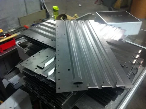

I've got video to process but here are some stills

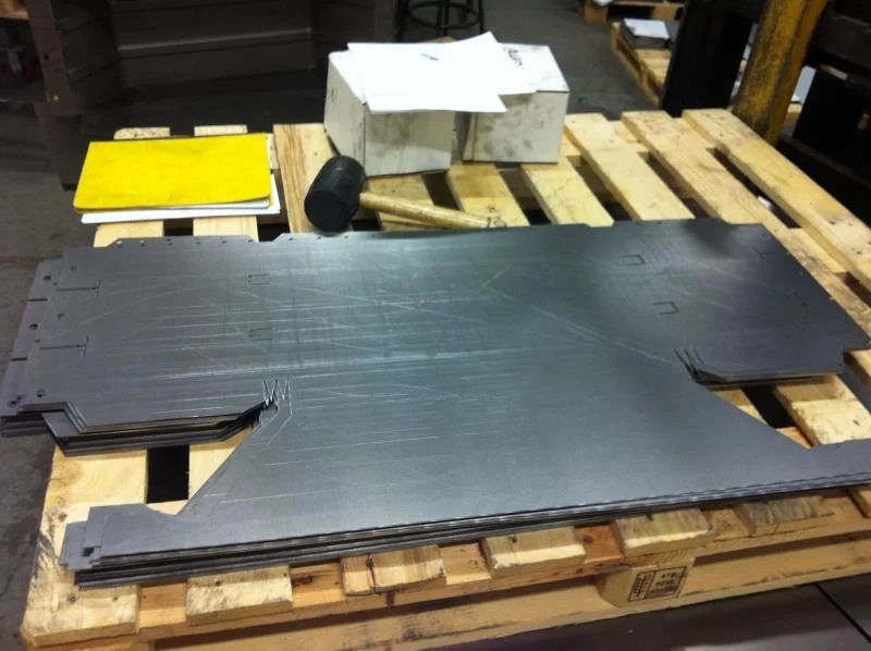

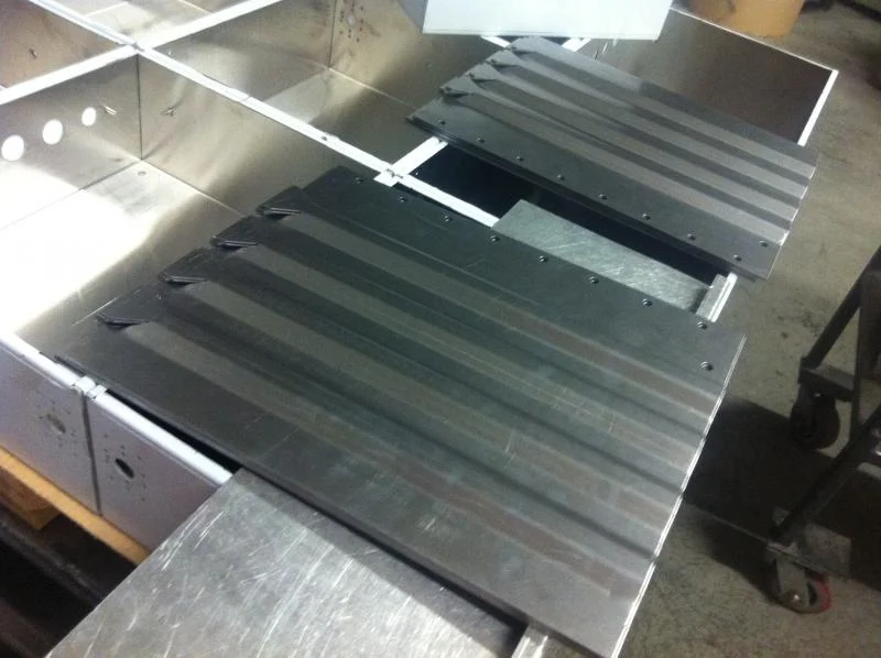

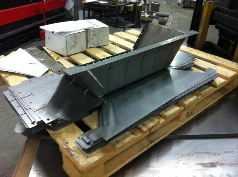

Bent all of the corner floor sections
front later model with the access opening
rear corner sections
front corner early style with no access

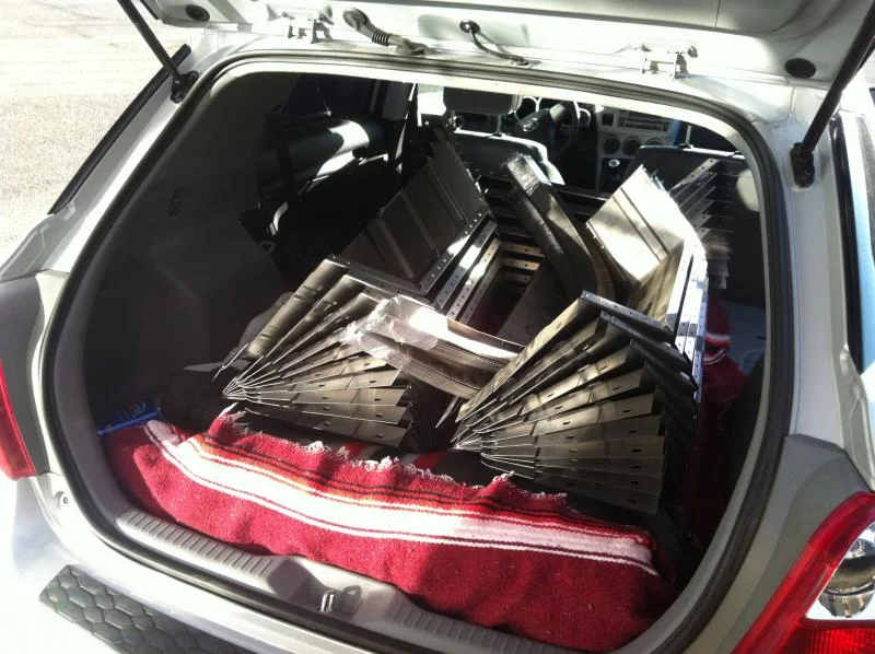

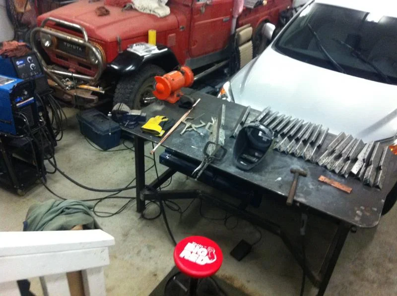

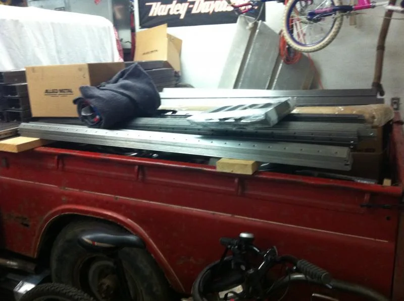

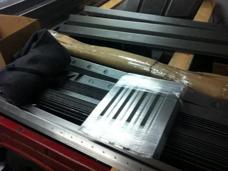

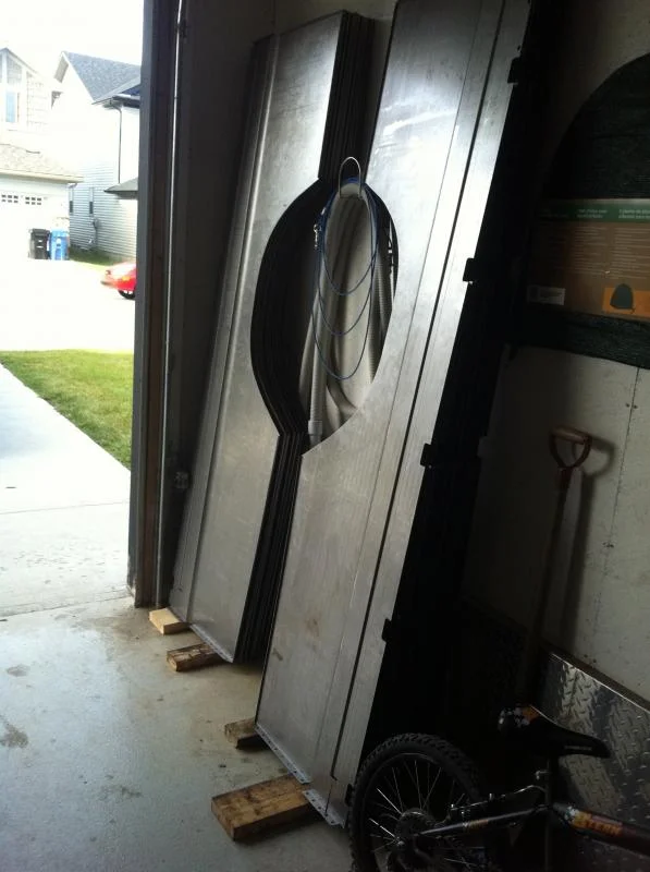

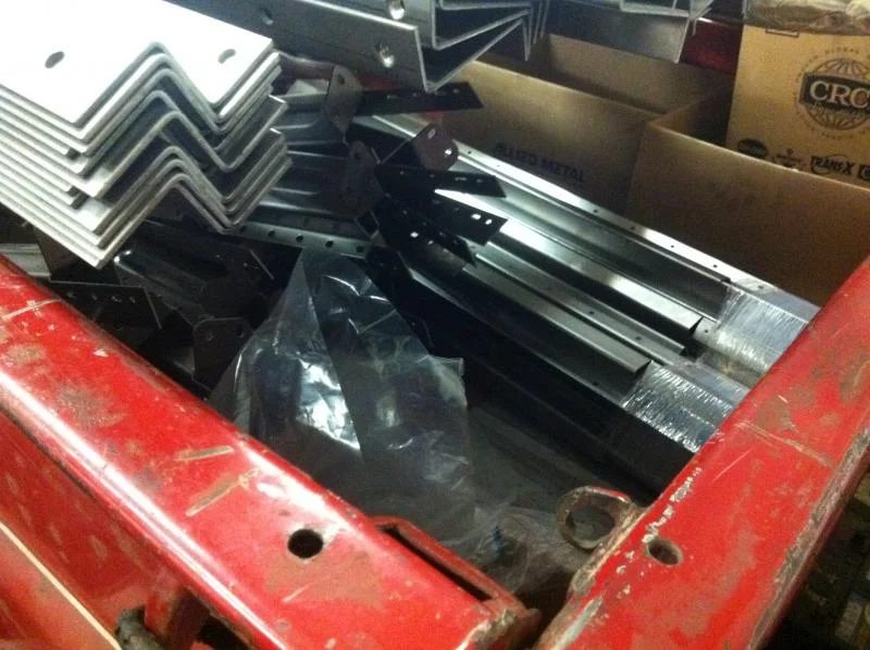

I set up a welding station in the garage by stuffing the 45 in the corner and loading it up with all the parts I have brought home so far. Now I can weld during the week in the evenings at home cuz there isn't enough time to get anything meaningful done at work after hours.
moved my table into the open so the larger pieces have room

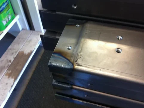

Started with the front corner posts - closed up the seam - not cleaned up yet in this shot.
All the parts in the 45 really weigh it down. Not on the bump stops yet but she's heavy.
More
even stuffed some underneath

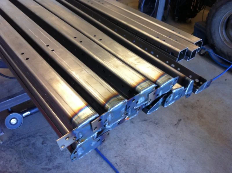

Put in three days this weekend - one at home welding and two at work bending.
Here are a few pics

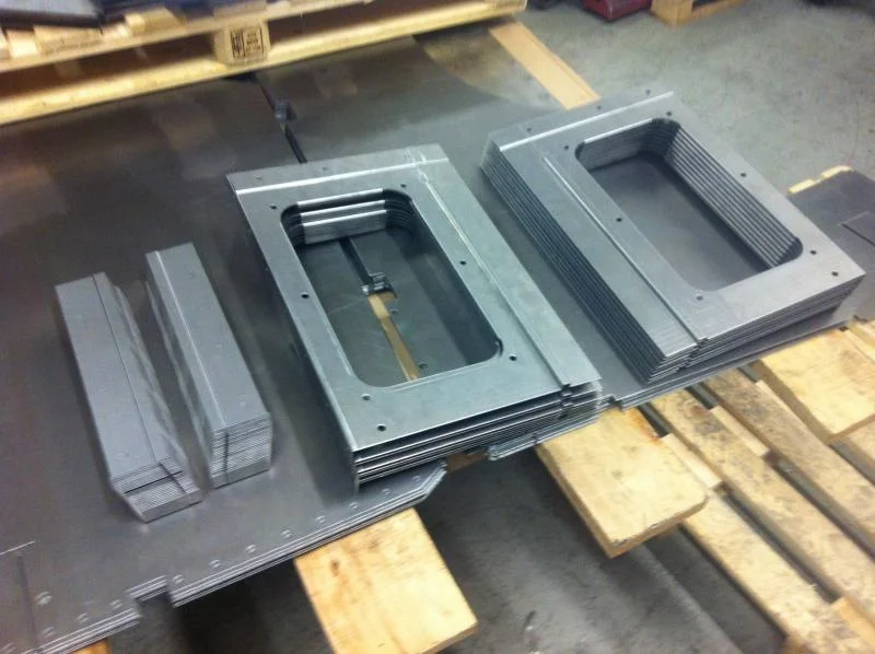

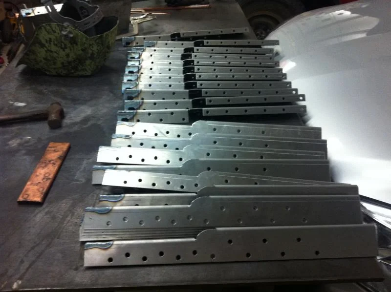

Welded rear valences
Welded bed rail ends

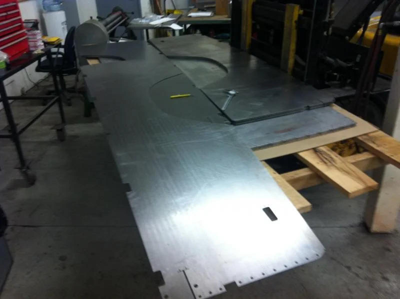

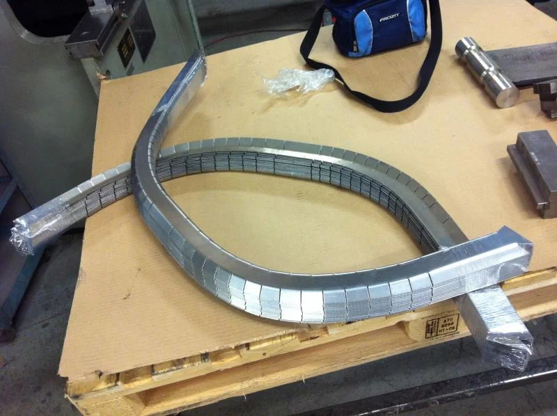

Formed wheel arches - 744 bends took me 4 hours!
Wheel humps
