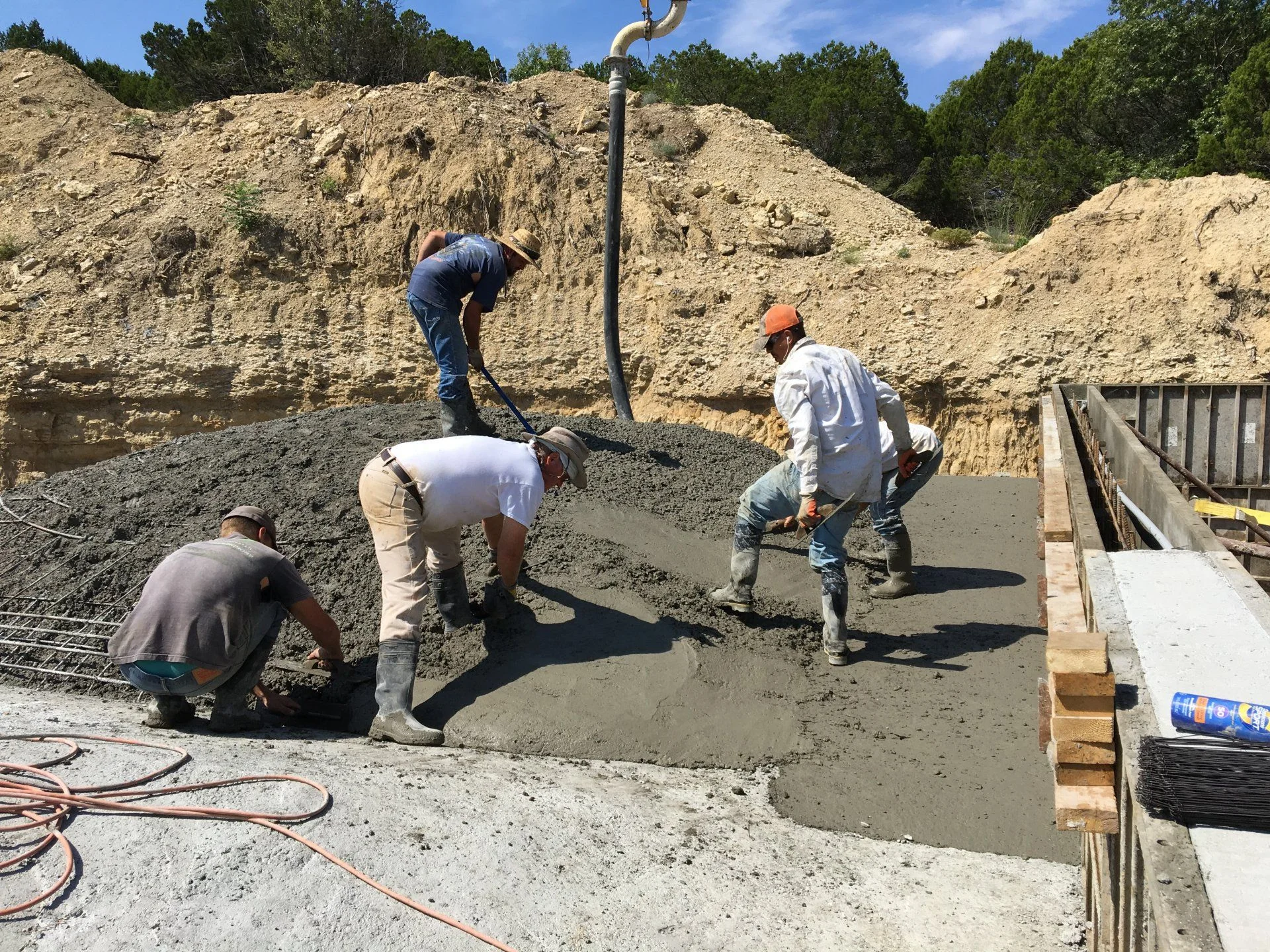

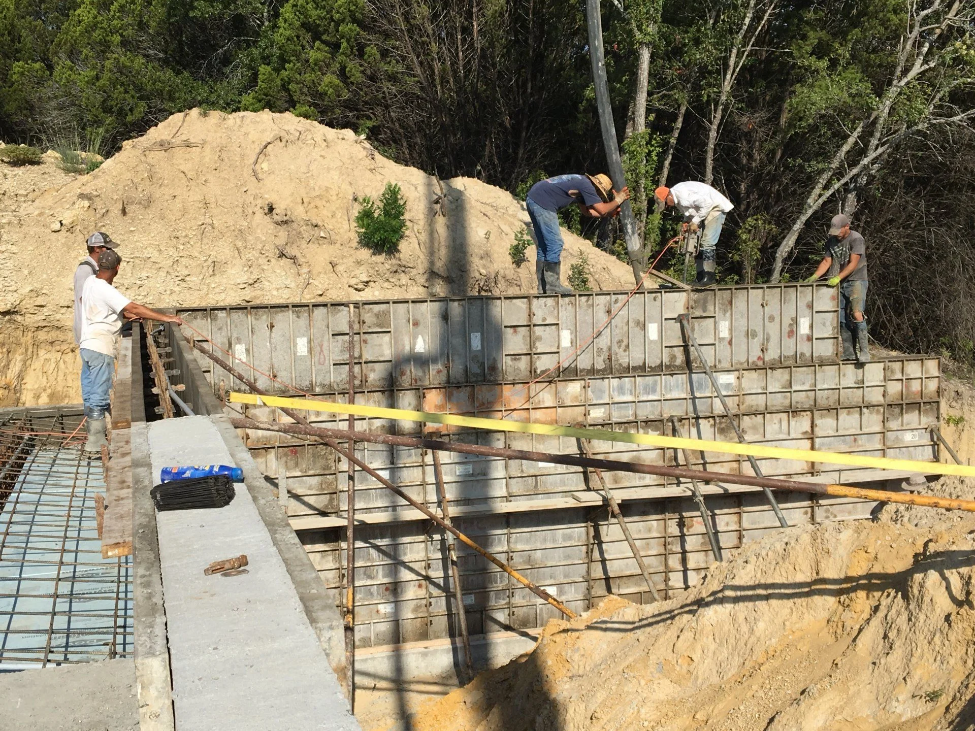

A few photos:
Pouring the 15'-high retaining wall. The guys walk along the top of the forms, which are 10" apart.
Pouring and troweling the actual dome. No vent stacks or anything on this one, it's only a garage.

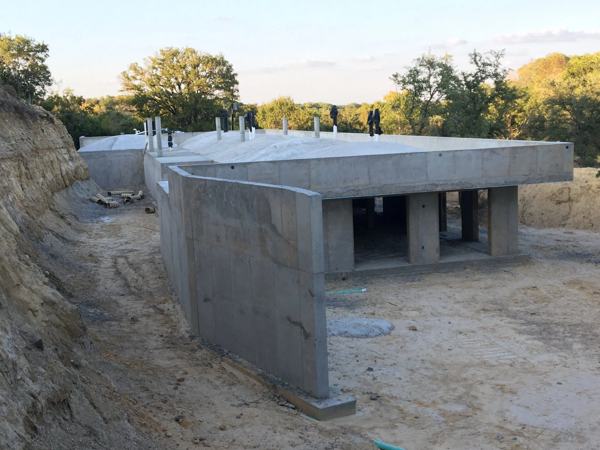

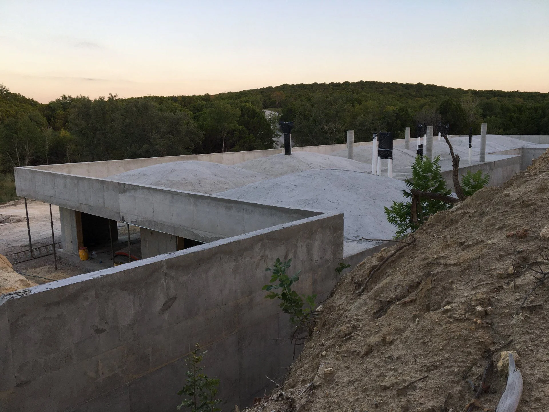

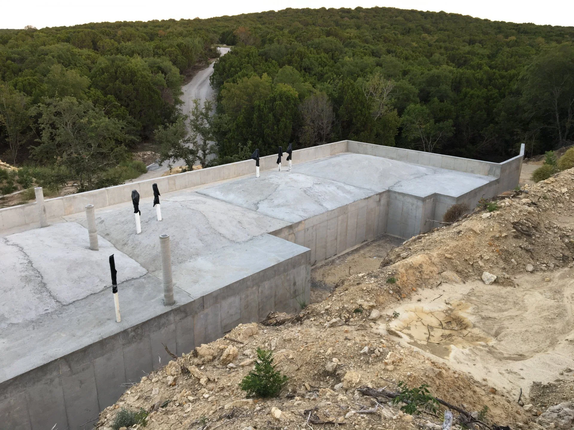

Some more photos of the completed shell. The problem is, the house is so long that (without a drone or similar) I can't get it all in a single photo - there are either trees or piles of excavated dirt from the hill in the way. Here are some bits and pieces anyway.

View of the southwest corner; you can see the other two master bedroom windows and the southern retaining wall for the hill:
View of the northwest corner; you can see some of the garage door openings and the northern retaining wall for the hill, and all seven domes:
Overhead view from the top of the hill; you can 4 of the 7 domes, most of the punch-out rooms, and the parapet wall all around the top:
