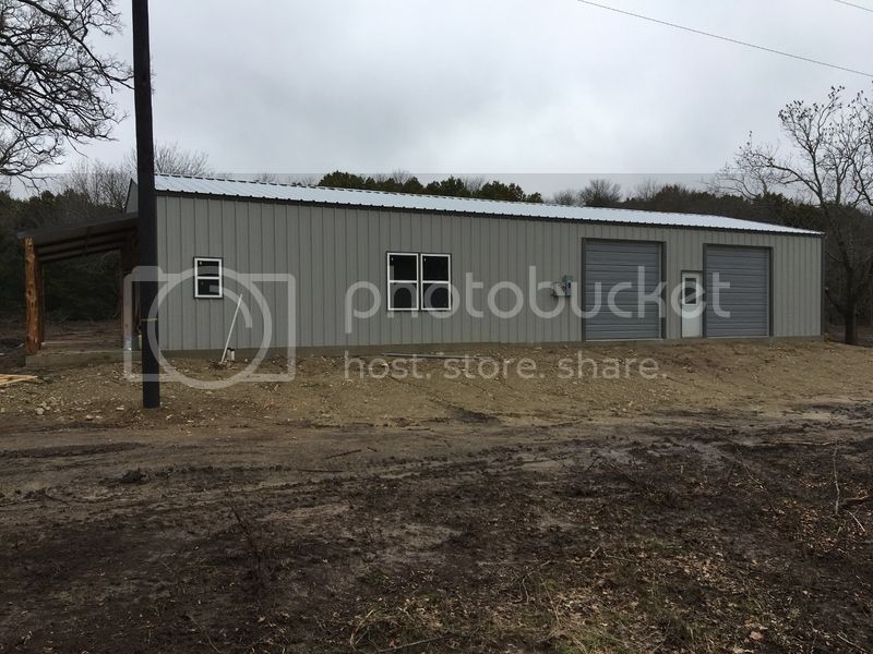

Progress; front porch and red cedar (juniper for you western folks) facade on the front of the apartment, framing going up for interior walls of the apartment (10' ceilings as per Mrs. 1911), and exterior cedar going on the well house.
Great facade on that shop, love it, it looks "old west". Insulation is so important, I have a 30 x 40 shop with R30+ in the walls and R50+ in the ceiling and it remains 10 degrees cooler in the summer and retains heat incredibly well in the winter.

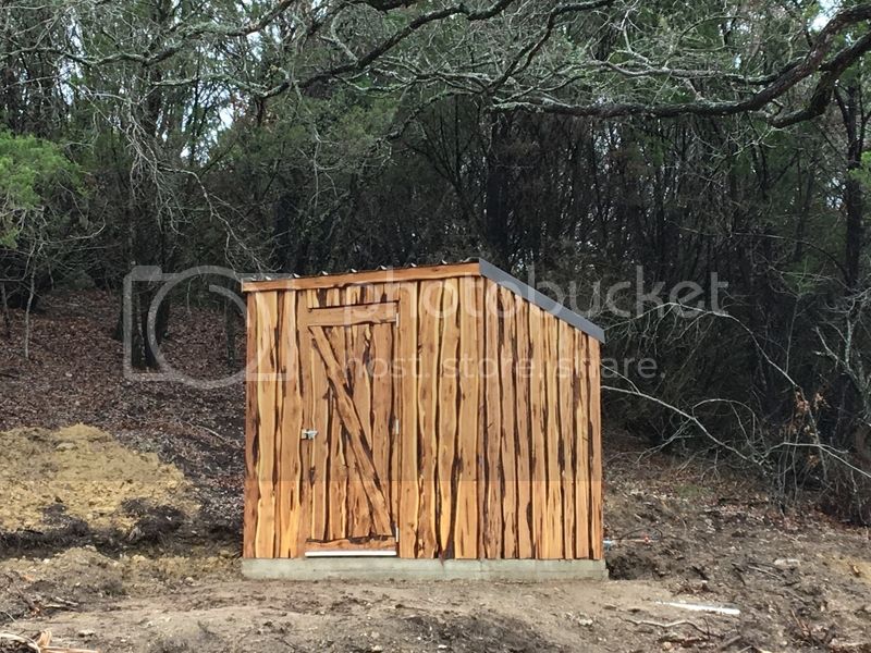

Sub'd. Very envious, that shop already looks amazing! Is the last pic the outhouse?

That last photo is the well house, where the pressure tank and equipment for the water well will go. Had them make it quite a bit larger than necessary so I could store garden/tree tools in there, without taking up space in the shop. I did think about putting a crescent moon on the door though. I'll post a photo of it finished later today, and some updated photos of the shop.
Most of the progress has been inside lately; framing for the apartment and shop bathroom finished, shop is completely wired with 110 and 220, apartment currently being wired and plumbed.

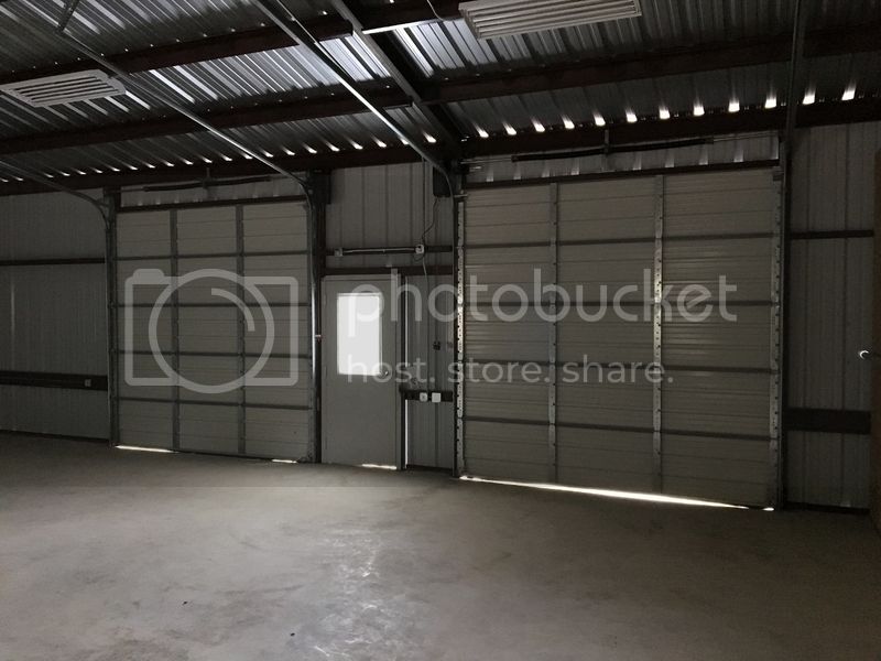

Shop bay doors and commercial openers are in. You can also see some of the overhead lighting banks:
Well/pump house is finished:

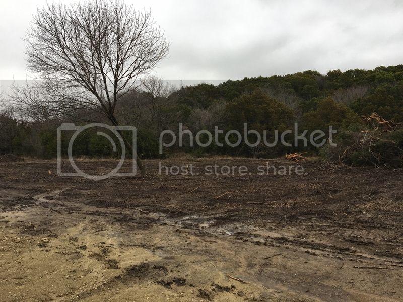

Clearing trees for the septic leach/drain field:
