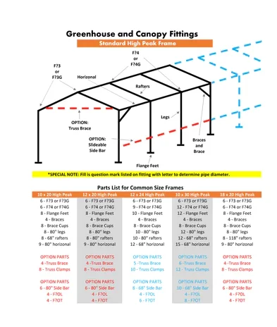

Found this one today and I like what I'm seeing. As of now, I'm leaning toward 1 3/8" pipe size and my snow load doesn't exceed more than four or five inches during a snow storm.
I'll go for the standard high peak carport 12x24 and may end up buying the fittings from this outfit and purchase the fence piping locally to save on shipping.

I need to unfurl the vinyl on my driveway this weekend and figuire out the dimensions and if the back side is completely one color. I've never even opened it up after purchasing it few years back. Once I get an idea of the dimensions, I'll pull the trigger on either a 12x20 or 12x24 metal structure. Check out the costs below for 1 3/8 and 1 5/8 fittings.
Got this email from Mark, from Swaseys.com (up above)
Ali,
Not sure what town in New Mexico you are, but our 1-3/8" is good to 6-8" of heavy California snow,
Rocky Mountain snow is much lighter, however you have much more wind than we do. So 1-5/8"
is probably the best choice for you. Usually what we do is sell people the fittings and parts needed
and then have you buy the pipe locally, it's a lot cheaper that way with shipping and damage.
All the parts less pipe for 10 x 20 in 1-3/8" would be $311 plus shipping, for 1-5/8" it would be $442 plus shipping.
Hope that helps, Mark @ Swasey's
