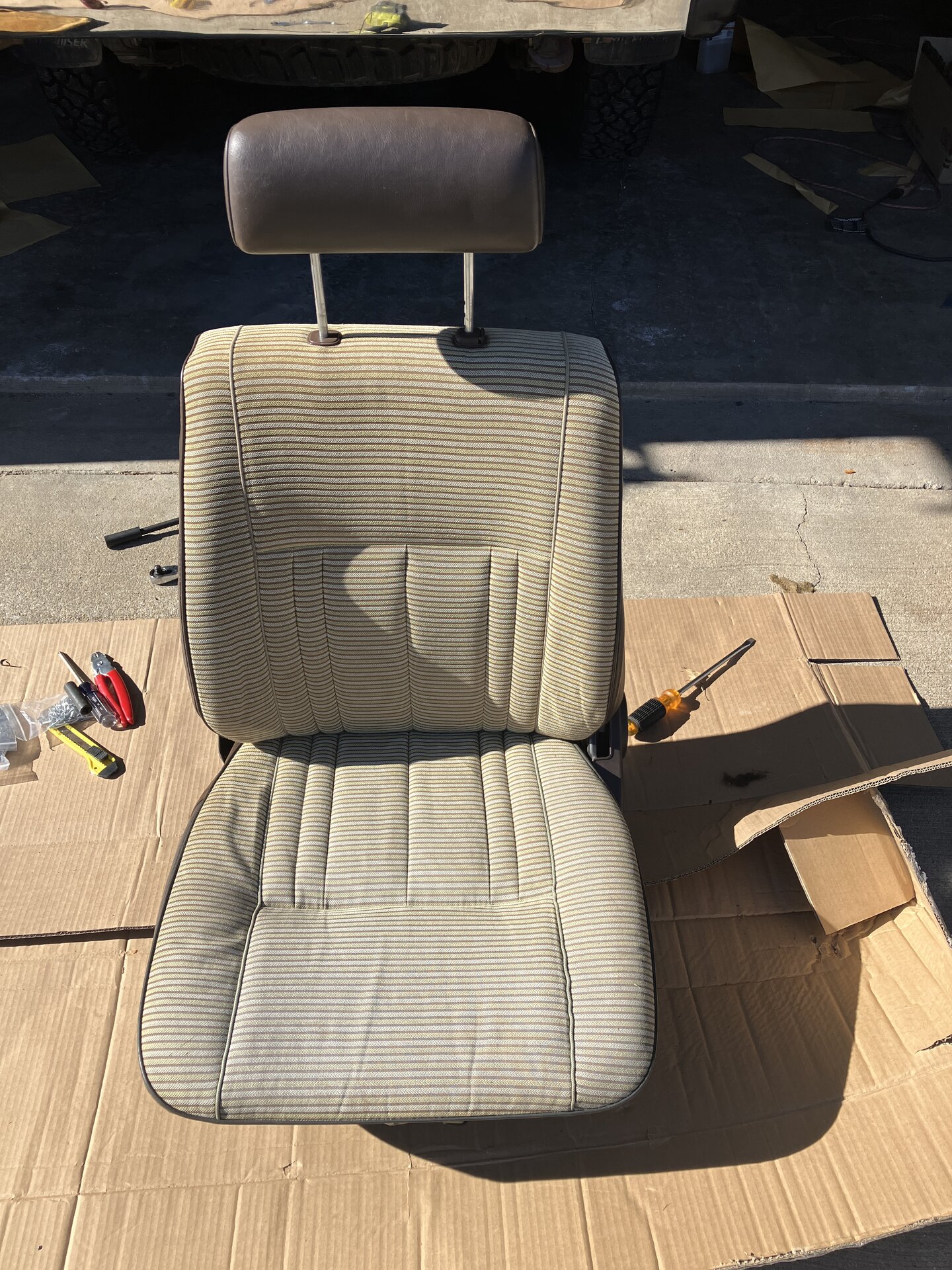

I've spent a lot of time on the inside of the Cruiser. I've put sound dampening material in the entire floor, side panels (inner body panels) and front doors. I haven't had to take the rear door panels off, but it's on my list of things to do. While pulling the front carpet out, something in the padding triggered a really bad allergic reaction. My wife insisted I throw the carpet away and order a new kit, which I did this week. I got a used, passenger front seat cover and cushion and swapped out of ripped driver's seat cover and broken down cushion. I also installed the HFABUSA tailgate storage door. I had something similar on my 80 series and it was very useful for the random gear I want to carry. I had an aftermarket Bosch starter that gave out and replaced it with a Toyota reman. I also replaced the thermostat to see if I could get the engine to warm up faster.

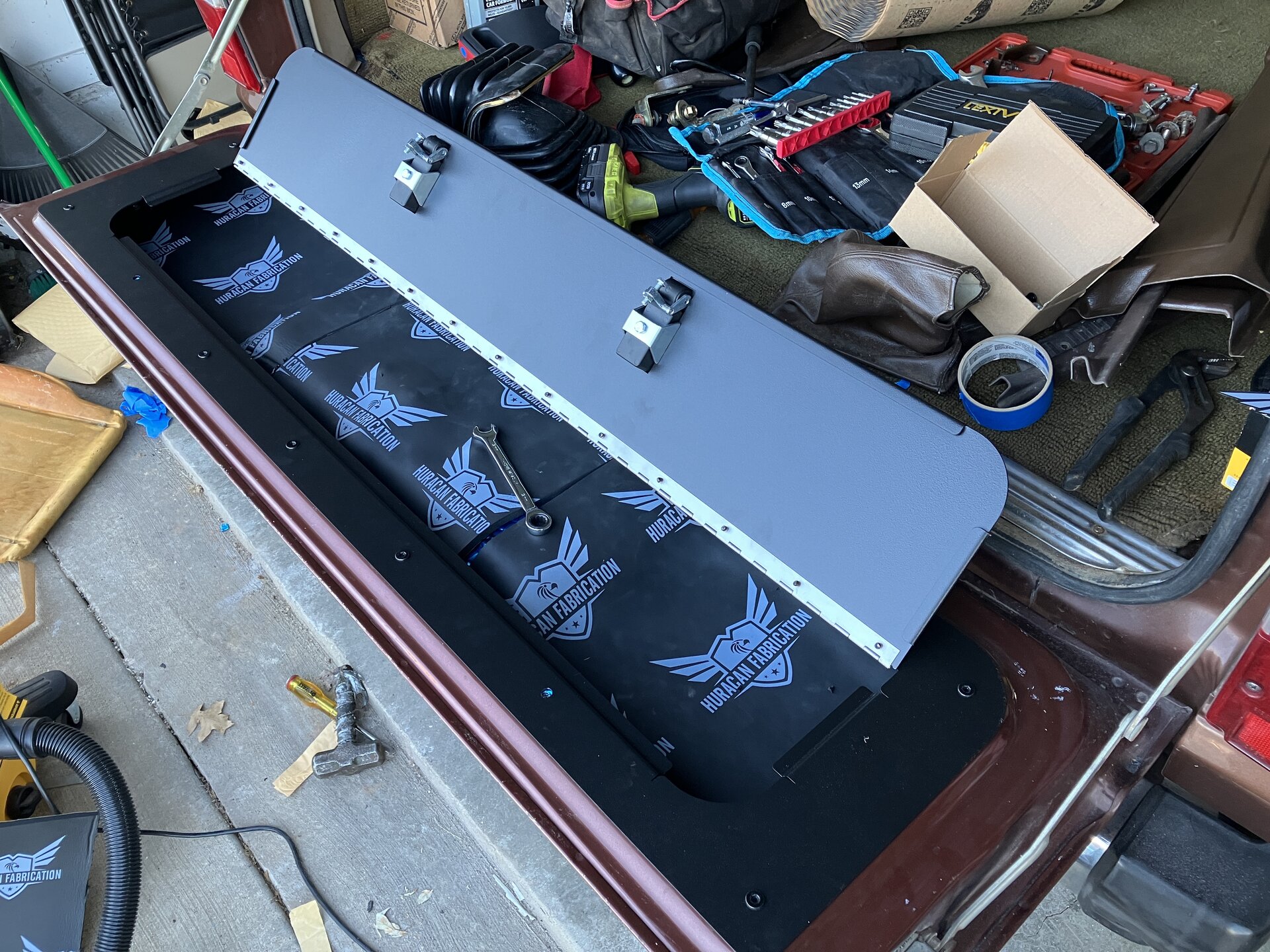

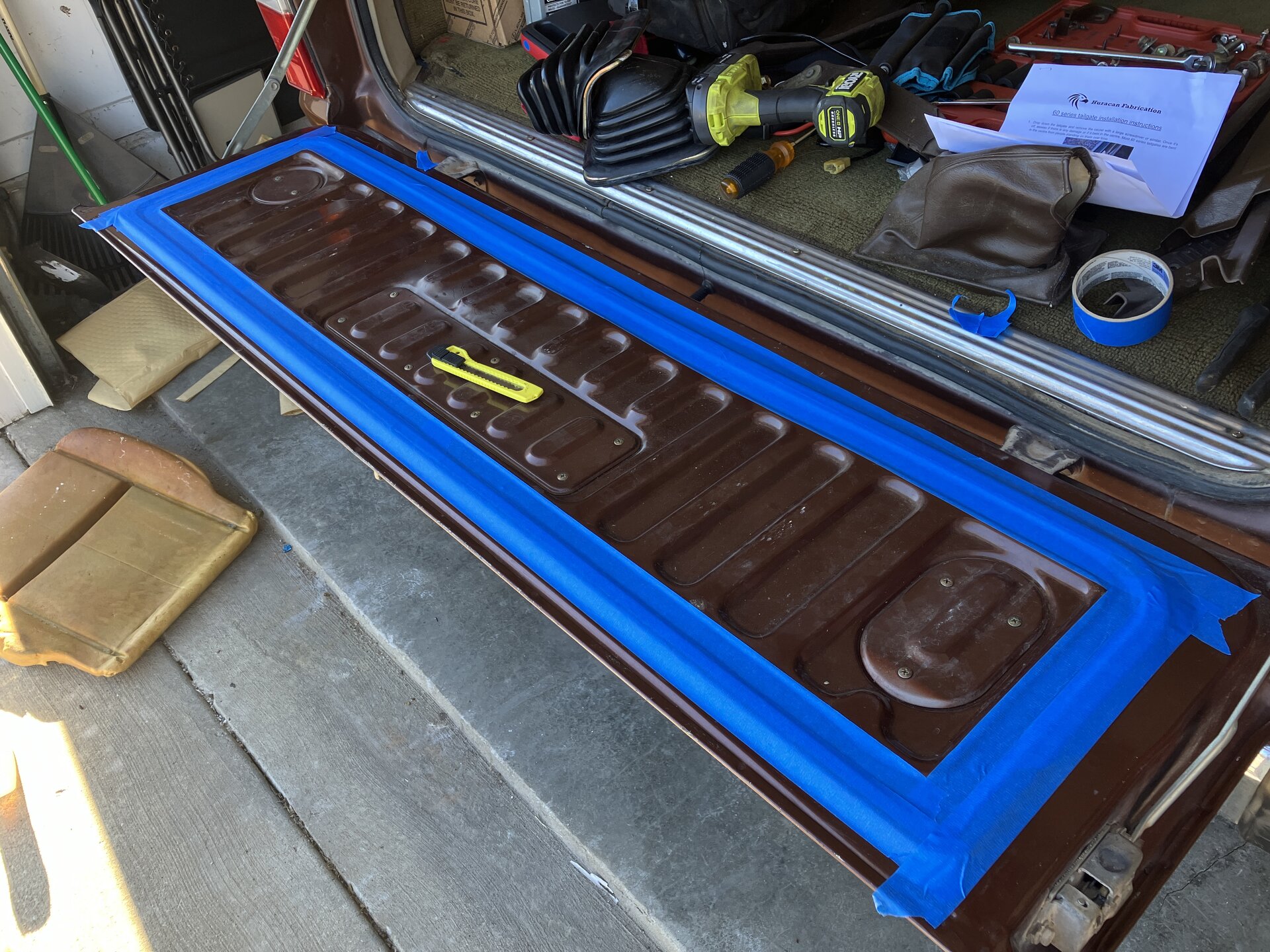

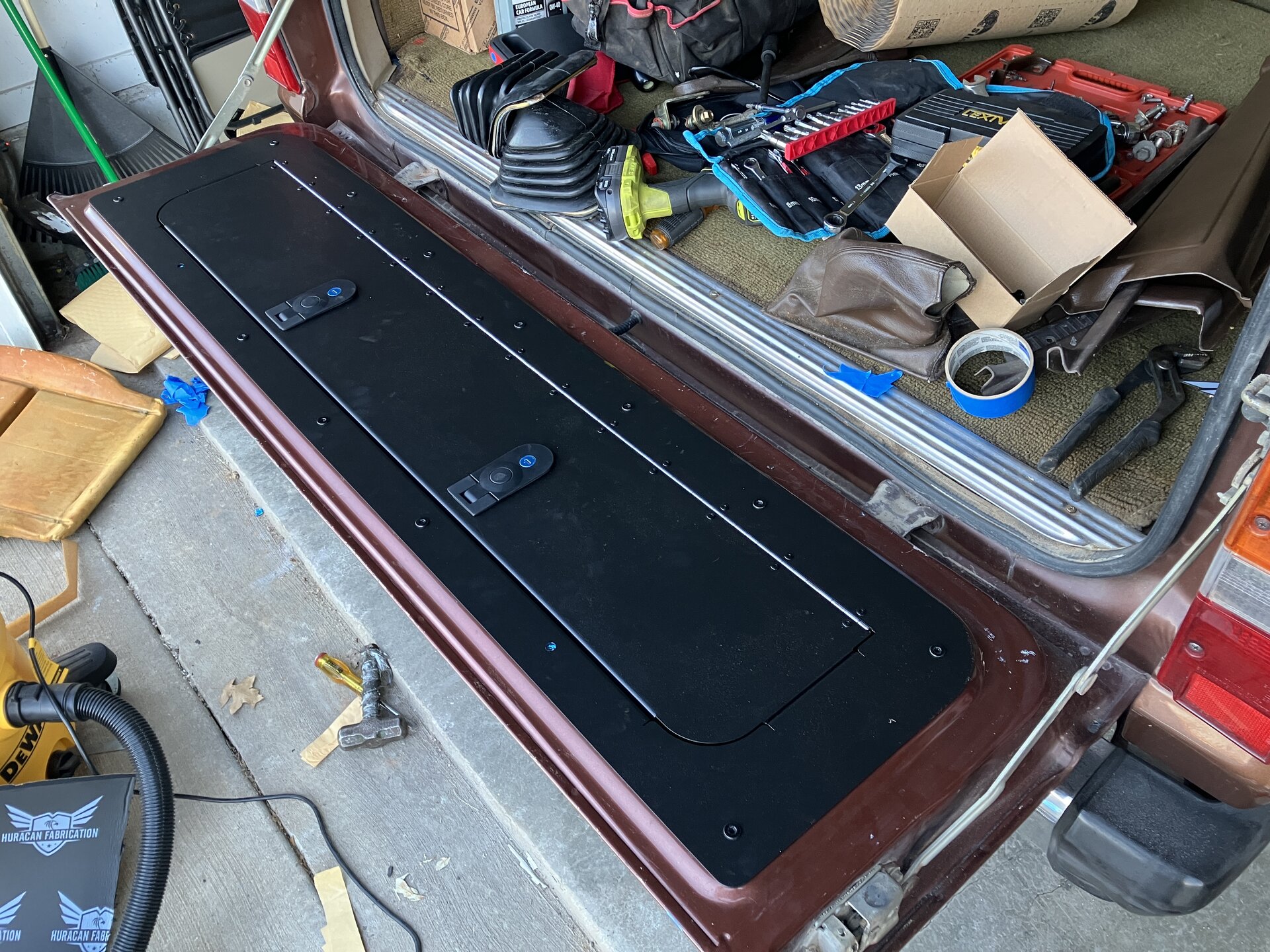

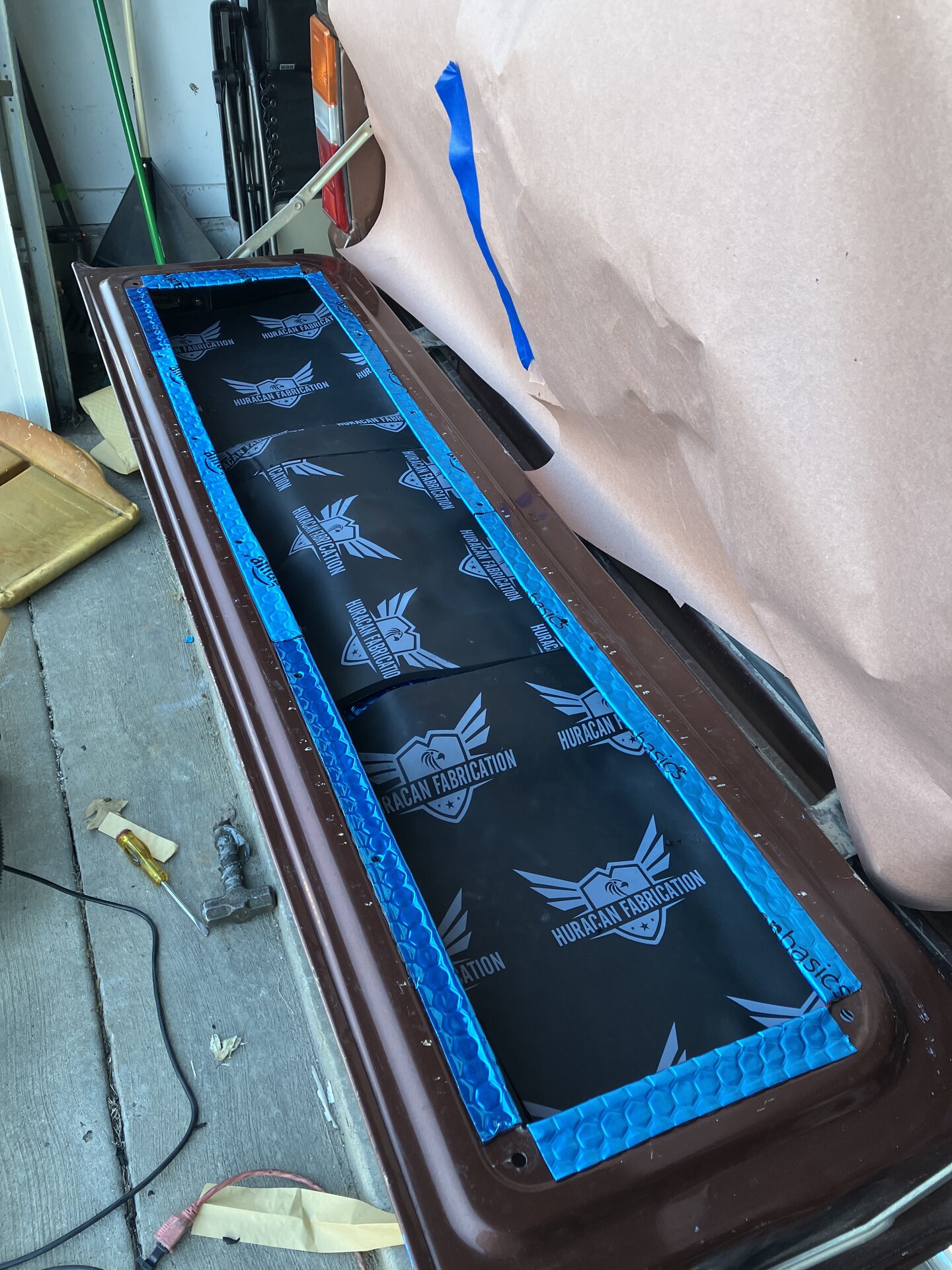

What is the blue tape under the tailgate hatch? I have a Huracán kit on the shelf but don’t remember that stuff in it
It's sound dampening material. I used it around all the edges so there wouldn't be any sharp edges. I also put it inside the tailgate.
