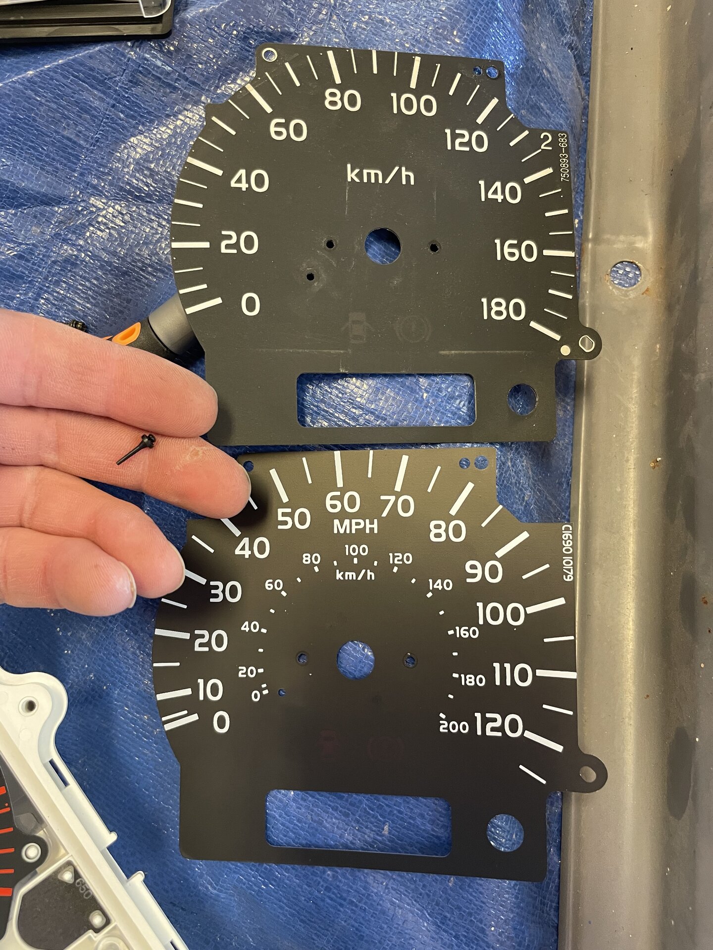

@coldtaco, @davegonz, and @Mr Cimarron came over today and made me grow a set and just pop the speedo STOP PIN out of the plastic speedometer gauge face.
It’s a little wobbly but nothing a little super glue won’t fix.
One step closer to done.
Yes... My question is is it difficult to pull off the kilometer face and add in the miles per hour face. Given that putting one on top of the other will result in terrible illumination.
I understand the pin is a separate problem.
pulling the face is sooo simple, however the speedo pointer is a different story, as bottombracket said thats the hard part and we have yet to see if he did it well (fingers crossed). if there is any, and i mean ANY bending of that tiny little shaft you get a bouncy speedo needle.
having said that, if your asking about your Troopy, i'm pretty sure you have the metal face, which can be replaced also from Lockwood, or you can find a magnetic overlay, no need to pull the needle for the latter.

I made an error above and went back to edit it… It was the stop pin that I removed from the kilometers per hour face. Pulling the speedometer needle off of the gauge, certainly scary, but the needle seems to move smoothly and without wobble….seems is the operative word here.
sorry, i dont mean to give you any kind of 'gina,,,, chances are good you did well since you pried from both sides equally
edit, not sure about your error but i am referring to the needle, not the stop pin.
put a drill motor to the drive input, just a phillips bit will spin it fine, rev'r up and see if that needle is smooth

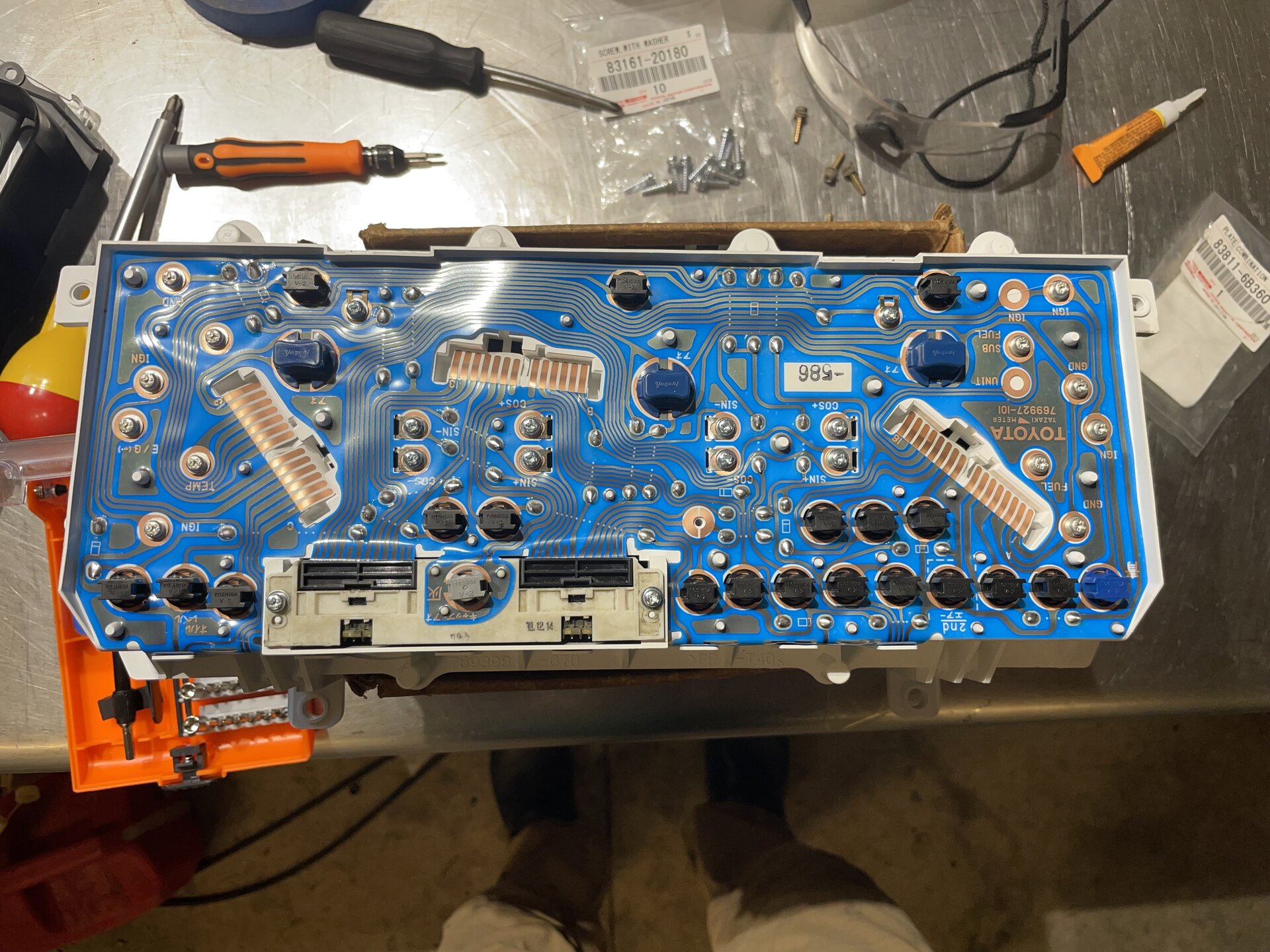

The last pieces of the puzzle arrived…the ground strap from tachometer (also the odometer) to circuit trace. Yes, I could’ve made one, but if I am this far in, why not wait and get the correct OEM part?
I glued the stop pin in place VERY carefully with a single drop of glue.

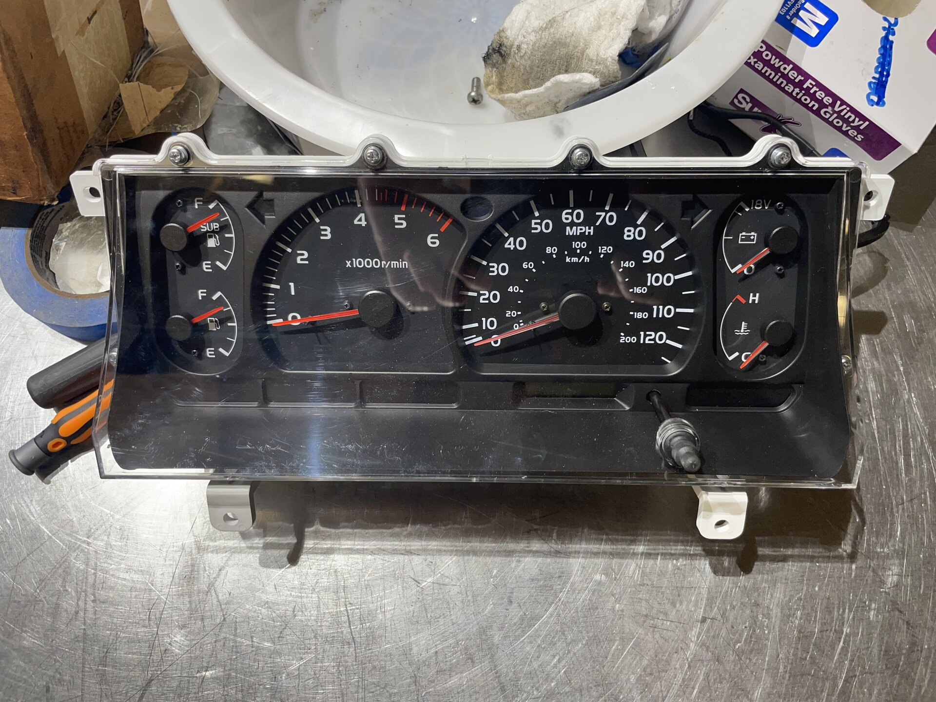

And reassembled with new cover screws. Because…shiny.
Done and ready for installation.
