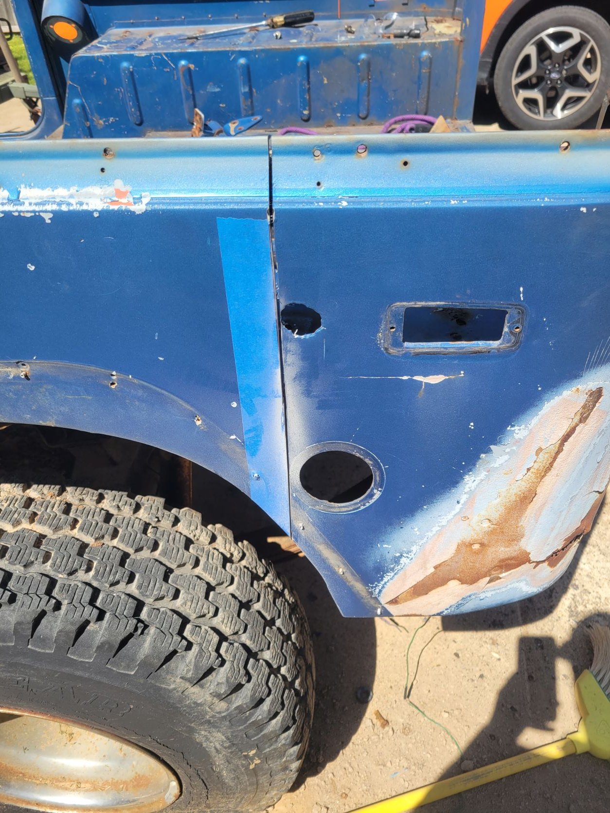

Turns out this 40 spent lots of its life driving back and forth between Arkansas and California for summer trips. She was ridden hard and put away dirty. Original engine had long since been replaced with a SBC, which had blown sometime in the 90s, when this was last parked. Looks like a tree had fallen on its roof at some point, a hole cut out in the floor for the battery, gallons and gallons of bondo used even when unnecessary, and almost every fastener replaced with something found in a parts bin.
She's got extra holes. And not the good kind.

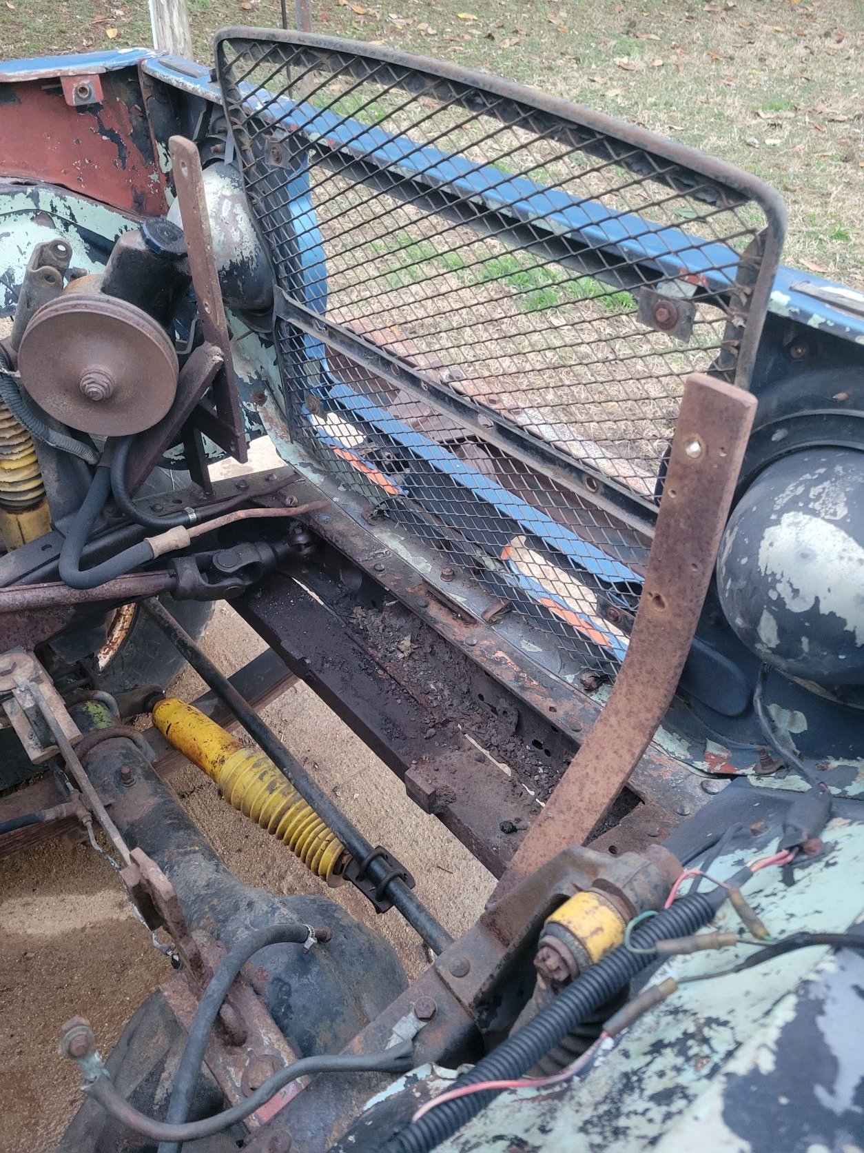

I started disassembly right away. Got the fender, heater fan, front clip, hood all off. Whoever modified this did it with farm tools all the way. Oxy torch to the frame, Huge C-channel front bumper welded together with some leftover stainless rod, metal stakes chopped up and welded back on to use as radiator supports, etc.

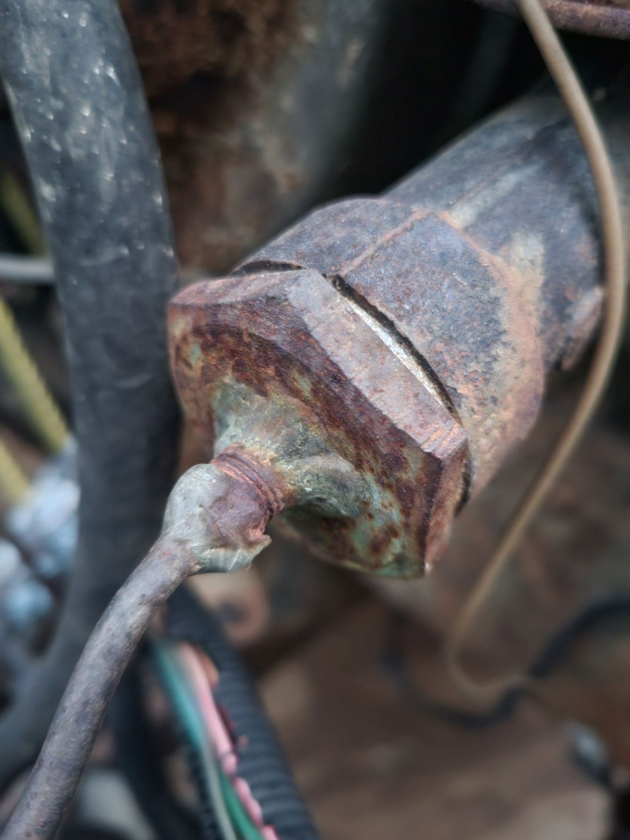

This looks interesting.
So does this.

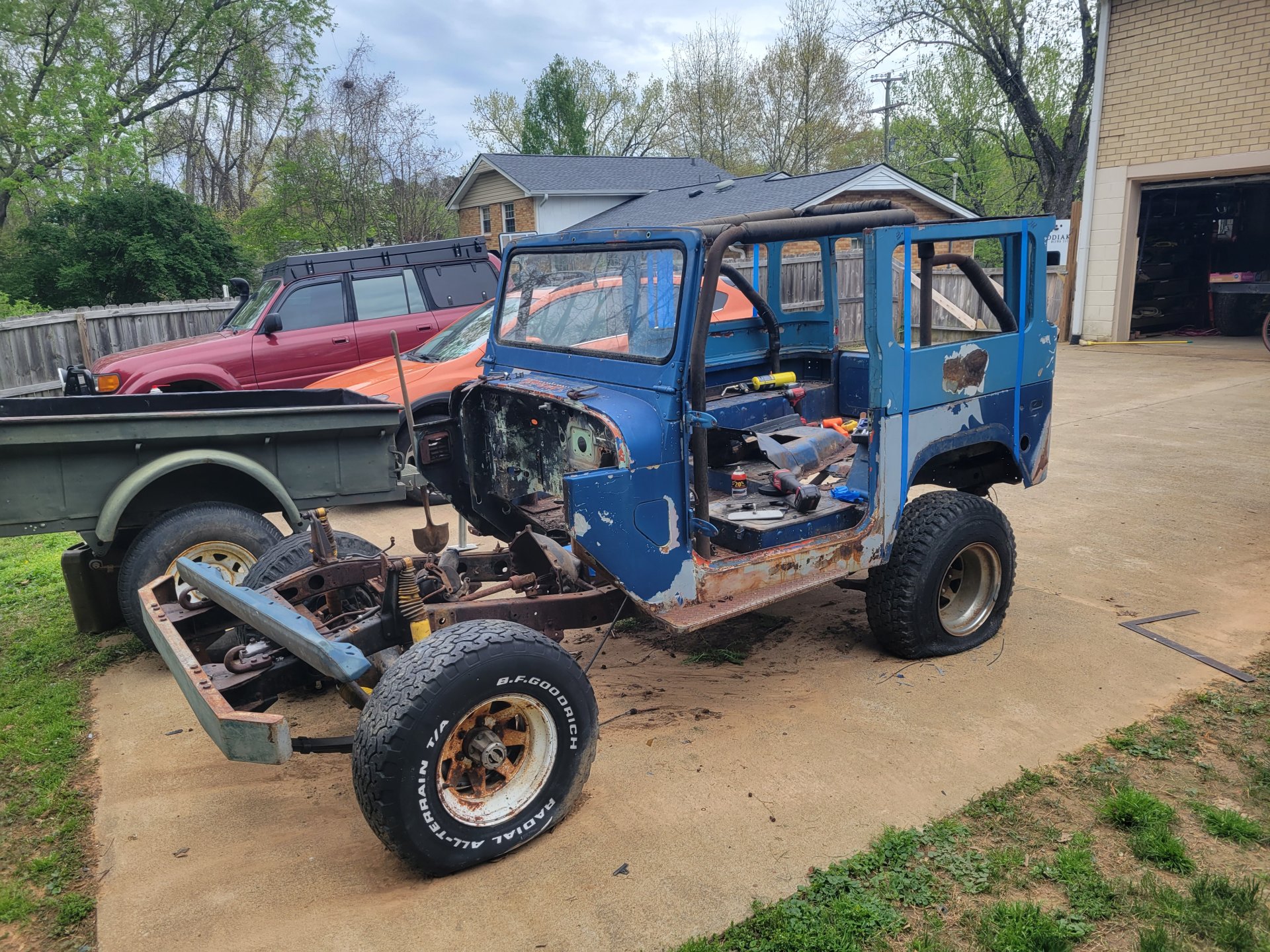

Took off the doors, surprisingly little rust, will only need a bit of repair. Passenger door has a huge dent in the side so its pretty mangled. It came with a spare, so I'll likely use that.
Another shining example of the fine craftsmanship of the previous owner. These were the various shims used to hold the steering wheel column to the firewall rib. Oof.
Started working on the dash to get all the mess removed. We're starting from scratch!
Working on removing the top. Rear glass was shattered so removed that oh-so-carefully. With a 2-lb sledge. EVERY bolt is rusted. 80% of the bolts have snapped off. No amount of oil penetrant or heat is gonna help with this one.

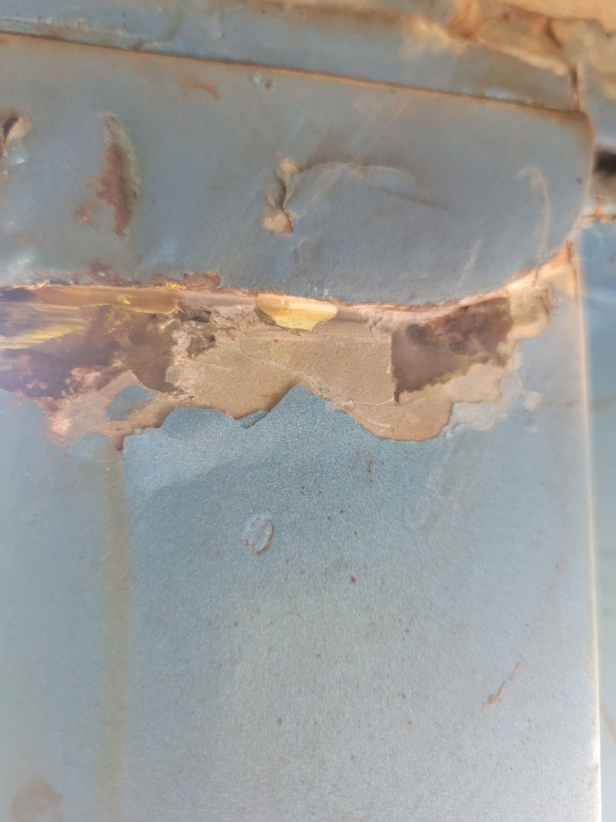

He liked to braze. Leak won't stop? Braze it.
Top won't stay on? Braze it. (Then bondo the ever living crap out of it)

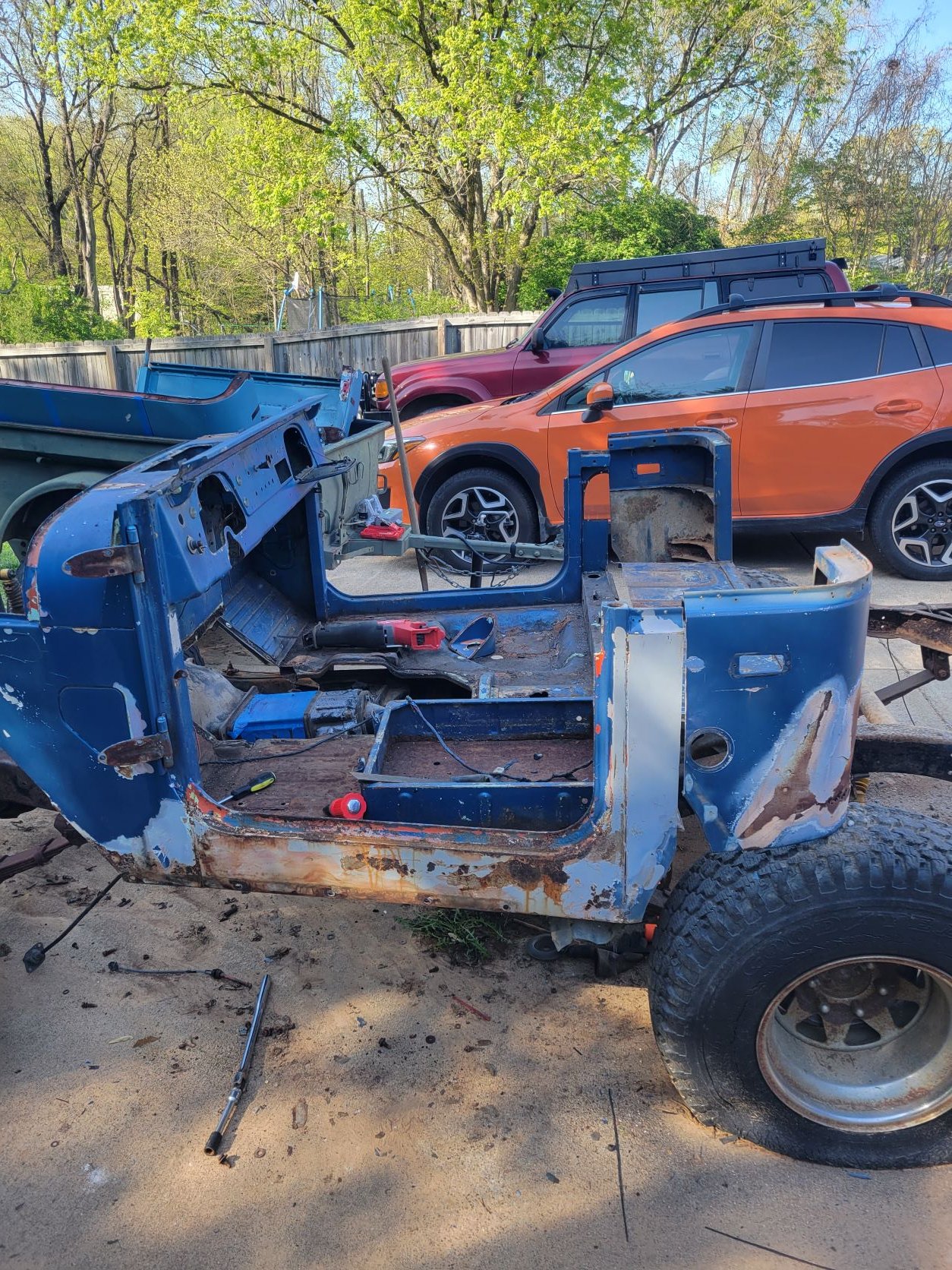

Top and sides were removed without too much trouble.
Pulled the roll cage (For sale!) and started cutting with the grinder. Some spots are tricky and can't get in there tight enough with the angle grinder, so had to switch to sawzall occasionally.
I wanted to save the fenderwells for potential re-use, so I was careful to cut those out as intact as I could.
No turning back now!

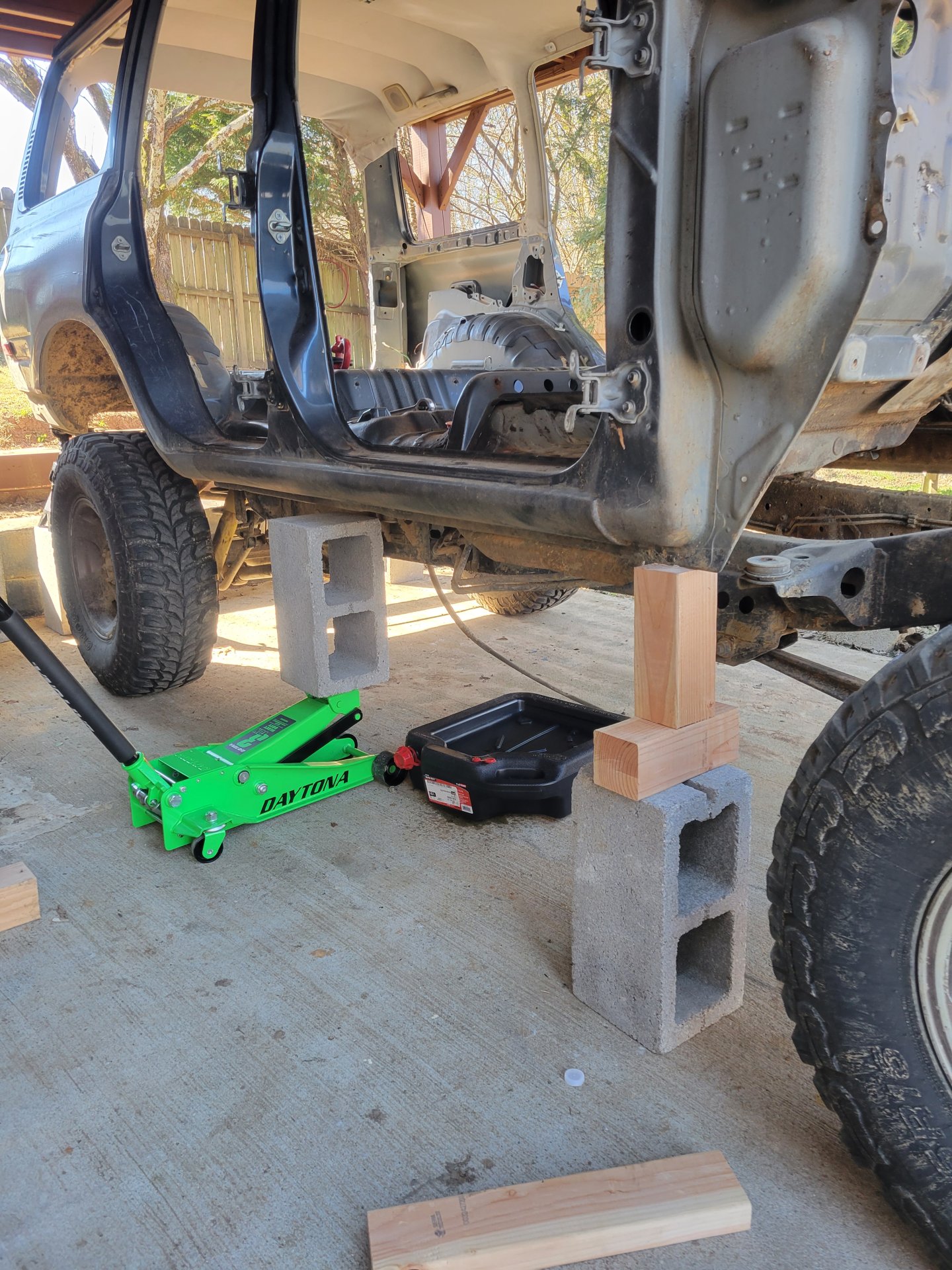

Got Dumpster Fire all stripped down. Anyone want a rust-free 80 shell??
Time to do some sketchy sh*t, doo dah, doo dah..........
Had to remove the rear wheels to slide the frame out from underneath.
30 years of dirt came off pretty easily with a pressure washer. Not a speck of rust in sight.
