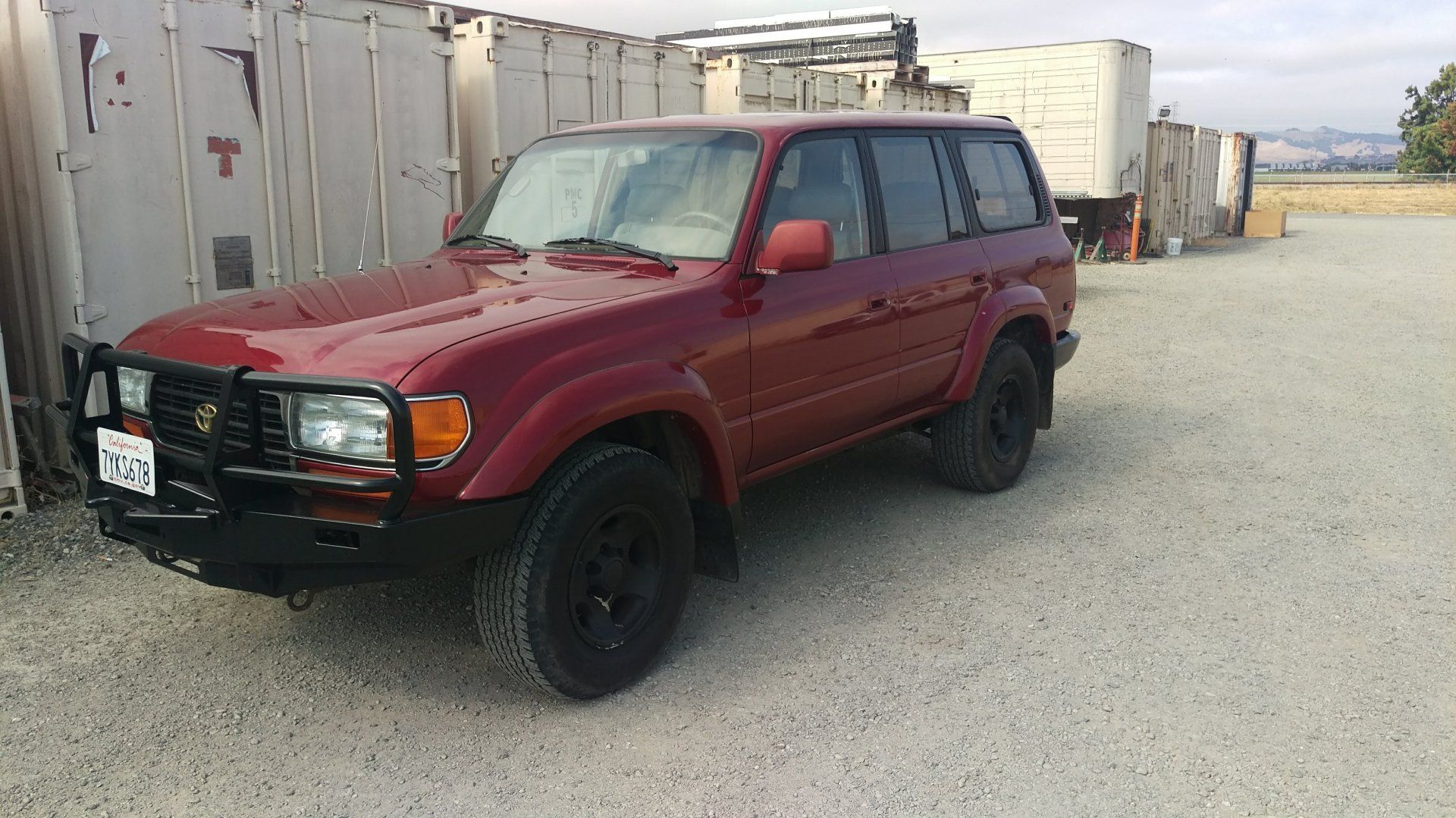

This cruiser, heretofore known as ‘Elmo,’ was an un-locked, unmolested, California non-GMO, vegan, free-range raised and rust-free cruiser with 140k miles on it.
As she sat on my first day of ownership, July 2017.
I couldn’t stop smiling all the way back to my place, even after it overheated for the third time in 105F deg heat with the heater on full and windows rolled down.
I will write and post pictures as I slowly update to how it sits present day.

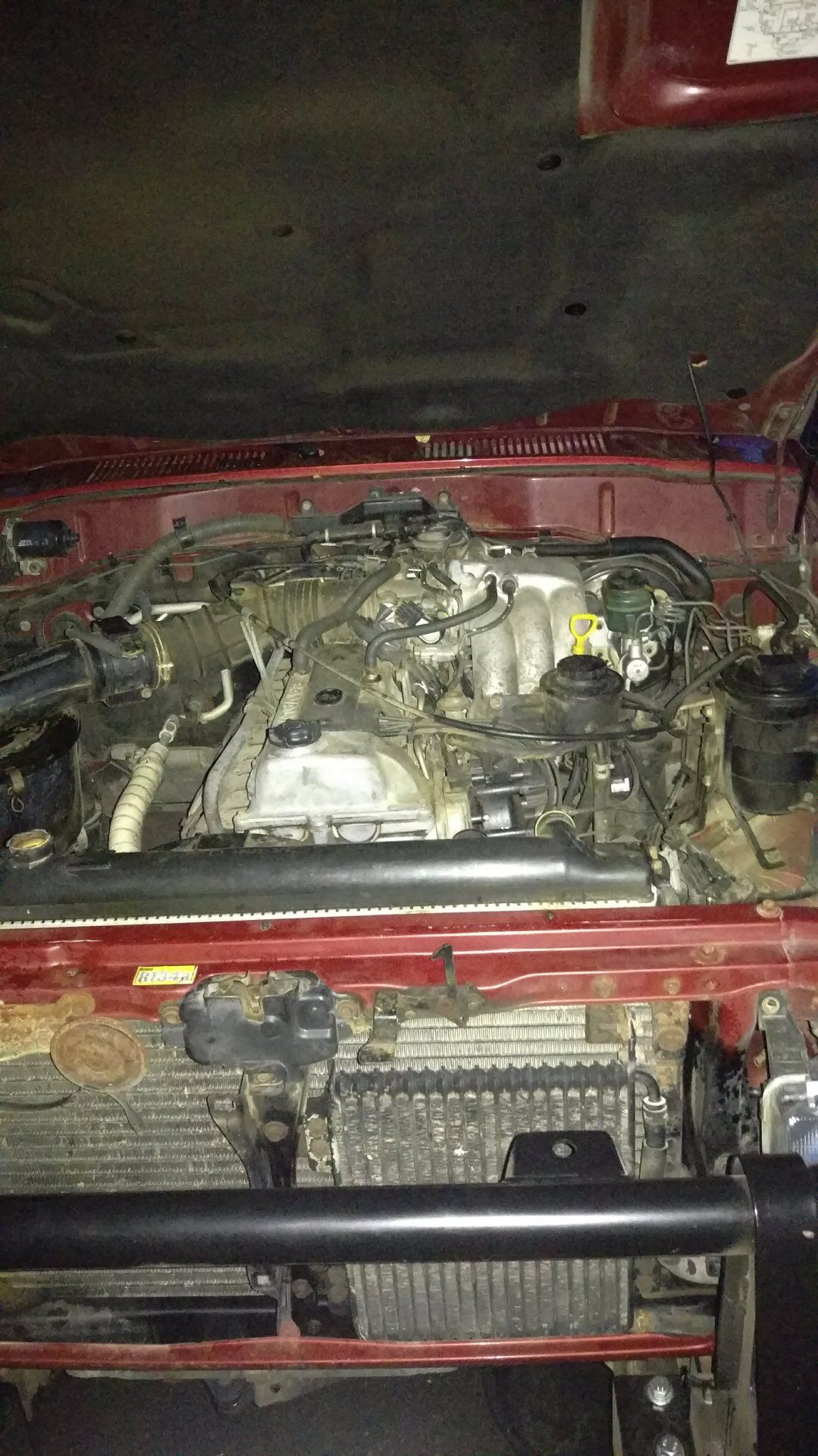

After assessing and researching typical overheating issues and performing a compression check that all check out OK, I headed to the stealership. I highly recommend making friends with your local Toyota Parts counter guy (assuming gender based on metrics alone) because more often than not, they're car guys too. A little bit of shop talk, ask 'em what they drive, feign interest if it isn't a 4wd, hike your skirt, flutter your eyelashes and bam, you'd be surprised with how much markup they can knock off your tab. I purchased a new OEM radiator, fan clutch, thermostat, and a bunch of new hoses and drive belts at significant discount this way, and I didn't even have to put out! This solved the overheating issue (for now) and installed an UltraGauge to keep a closer eye on temps in the future. I moved the OBDII port from its mount and just shoved it behind the dash and ran the wire to the UG where it sits right in the bottom middle portion of the gauge cluster. That way I don't have to look at my seat belt light and if I angle it just right, I get to block the ever-present check engine light from sight completely. Win!

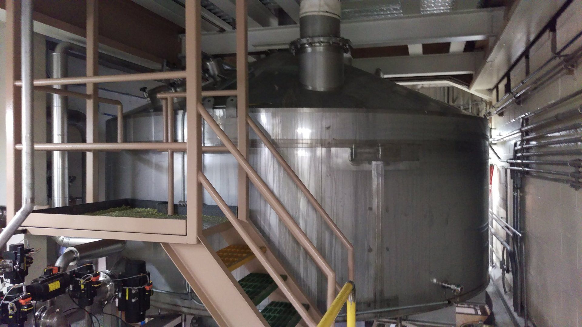

Around October we completed the new Hopback process installation at Anheuser-Busch. As some may know, AB is owned by mega uber international corporation InBev, which had recently purchased rights to many smaller craft breweries like Goose Island, Ten Barrel Ale, Elysian, etc. The smaller brewery locations would still exist, but AB would be able to use their own larger facilities, after a few upgrades, to brew the microbrews. The ethics of such a large corporation owning so many smaller, local breweries are questionable, though the end result is better, stronger, hoppier beer able to be sold at cheaper, more mass produced prices, so it's really not all bad. The AB plant in Fairfield was to produce several of these hoppy craft beers en masse, but their systems were designed to produce vast quantities of beer flavored water (i.e. Bud-Light, Michelob, Natural Light, Rolling Rock, etc) in short periods of time at minimal cost. In comes the Hopback system, which allows the hops to be reintroduced after the boil which usually knocks the hop aromas out. This makes a beer with a much more floral hoppy flavor and aroma, without all the bitterness. The install of that equipment was my reasoning for being there, so once that project was complete, I could contentedly leave the facility knowing that I left it better than I found it. Hoppy beer>light beer. That's right, I said it. Beer snobs unite!
The Hopback. This room smelled like heaven and hops. But had more cockroaches than Joe's Apartment.
