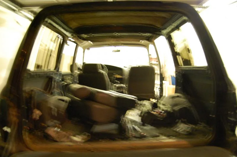

After a few years of denting quarter panels, busting glass, tearing up the body, and talking myself out of doing some trails, I have decided to turn the 80 into a tubed buggy. Really the straw that broke the camels back was when I went as a passenger up to Windrock in TN. While up there I noticed that a lot of the trails I would have wanted to go on, my 80 would of had some serious body damage. So after debating over trying to sell the 80 and getting a mini or a gen 1 4runner VS just cutting up the 80 and making it a buggy out if it. This just seemed like the best option, because first off I already have the truck. Beyond that, it has lockers, coils, and already stronger axles. So the transformation begins...

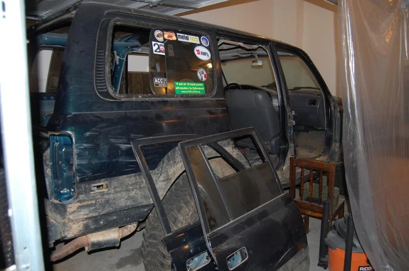

The stripping has begun...

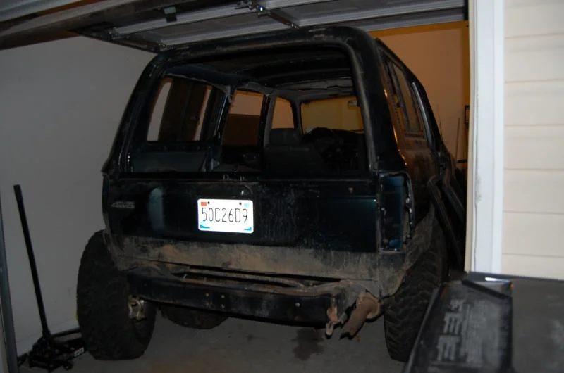

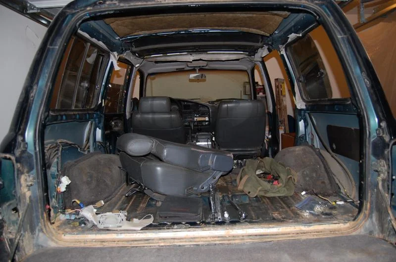

few more...
Nick, what's the plan with this? 2 or 4 seater? Keep or lose the windshield? Reuse the sliders we made for you?
Plan on keeping the windshield and starting the cage from there back. I want to keep it so I still have some protection from limbs and what not while on the trail, plus wipers. Im planning on getting 2 suspension seats like yours for the front and that is it for the seats for now. Later down the road I plan to add 1 seat in the middle of the back so it would be a 3 seater. I dont want to put 4 in, because I want to have room for storage, CO2 tank, etc. After bobbing it in to being flush with the rear tires, its gonna get rid of a lot of the storage area I have now in the truck. With the cage, I want to attach it to the existing sliders and create it similiar halfass, but where I can attach a spare tire on the back without it blocking too much. On the sides I want to weld sheet metal similar to the formula toys so it will kinda be like half doors.

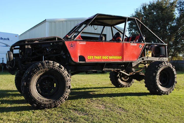

sheet metal similar to this but wrapped all the way around...
They used a fast disconnect that is used is race car bodies. I can not think of the name. On the cheap you could use rivets.
