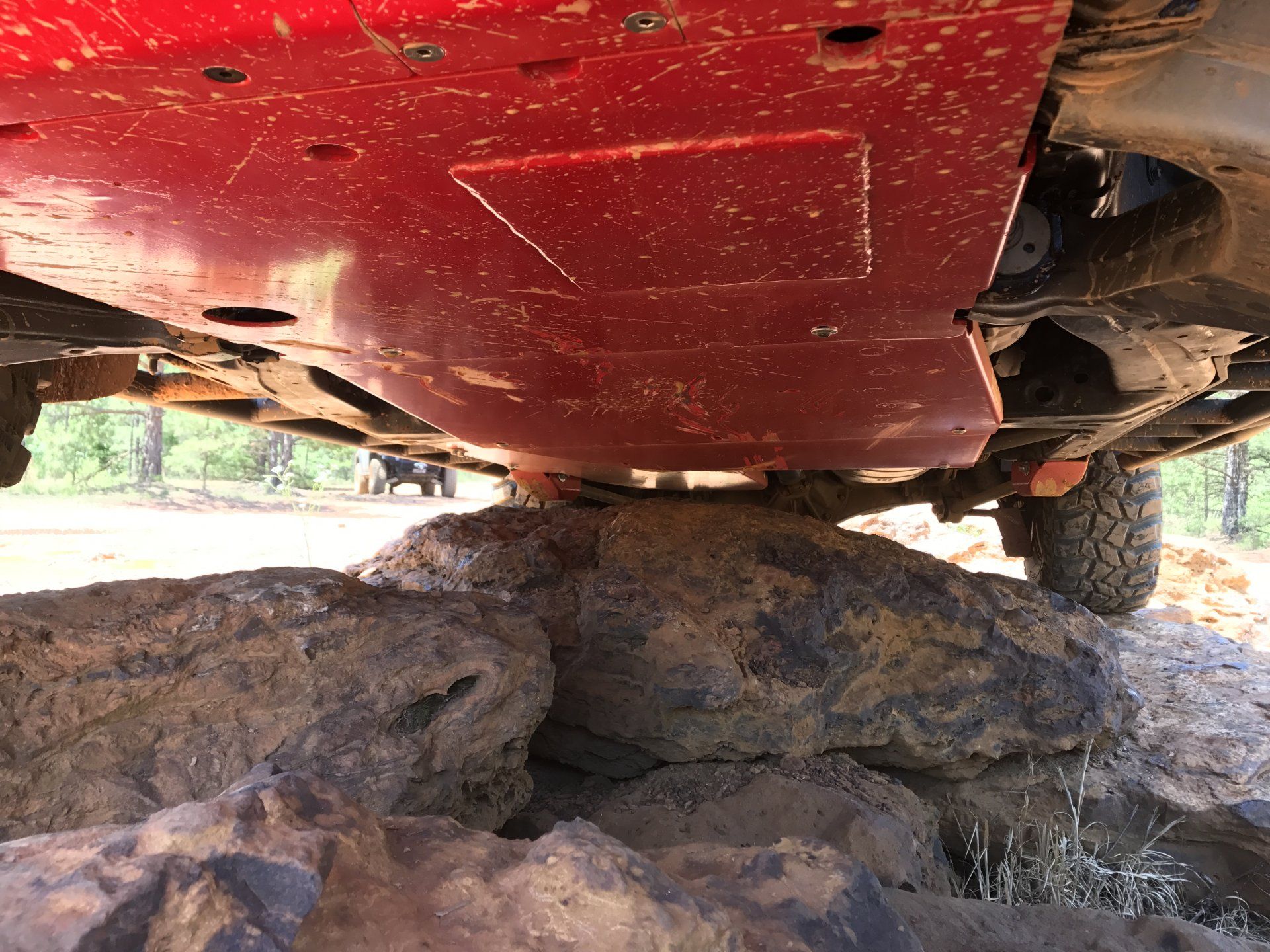

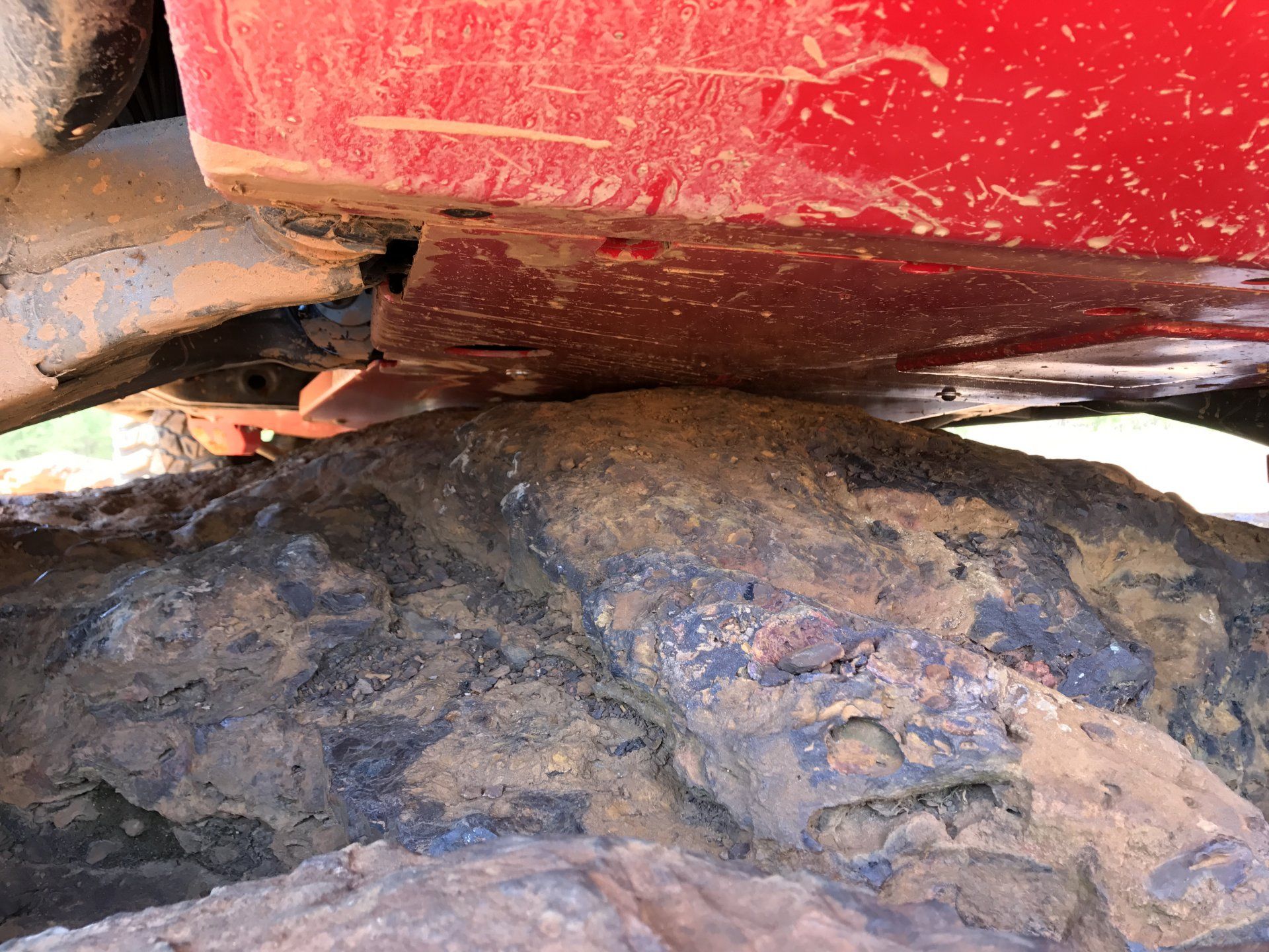

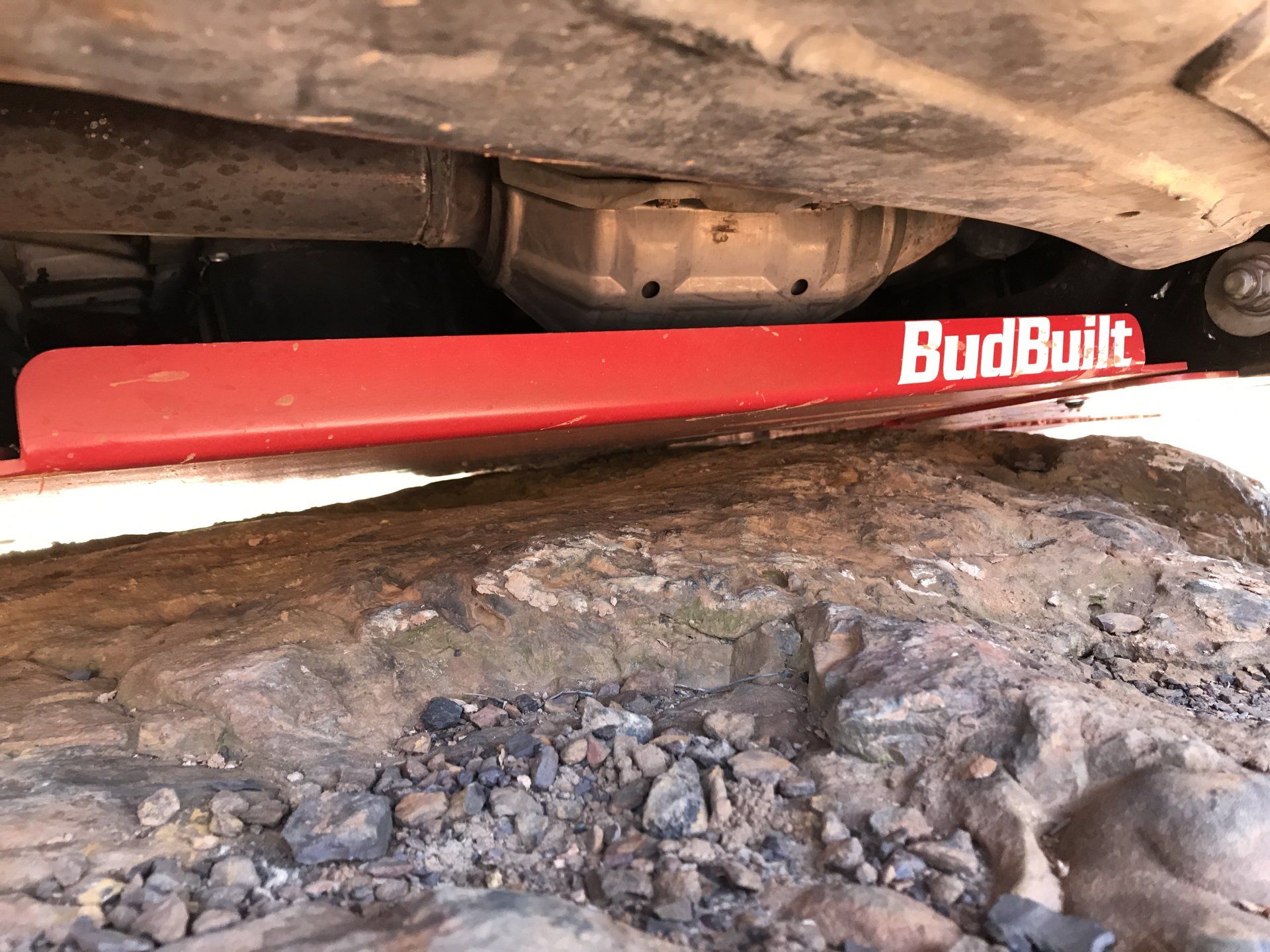

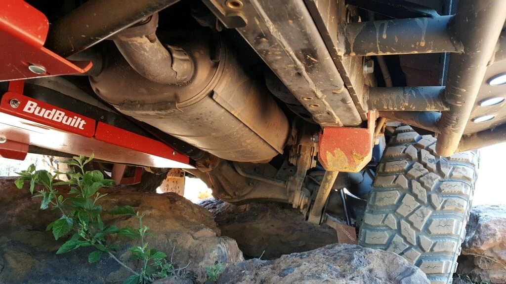

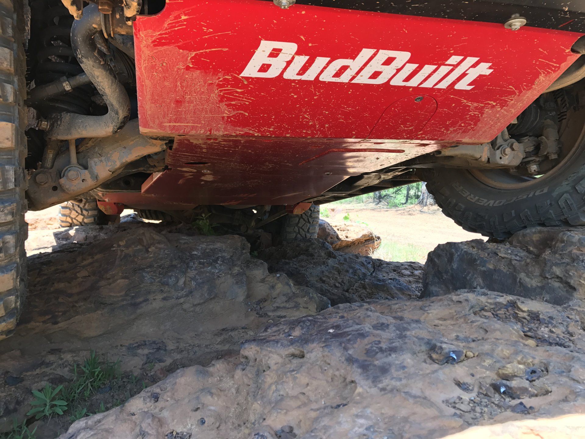

Testing complete. Everything handled it great. That control arm guard took two HARD hits, no deforming. They work with Slee sliders or any other slider, or without sliders at all.

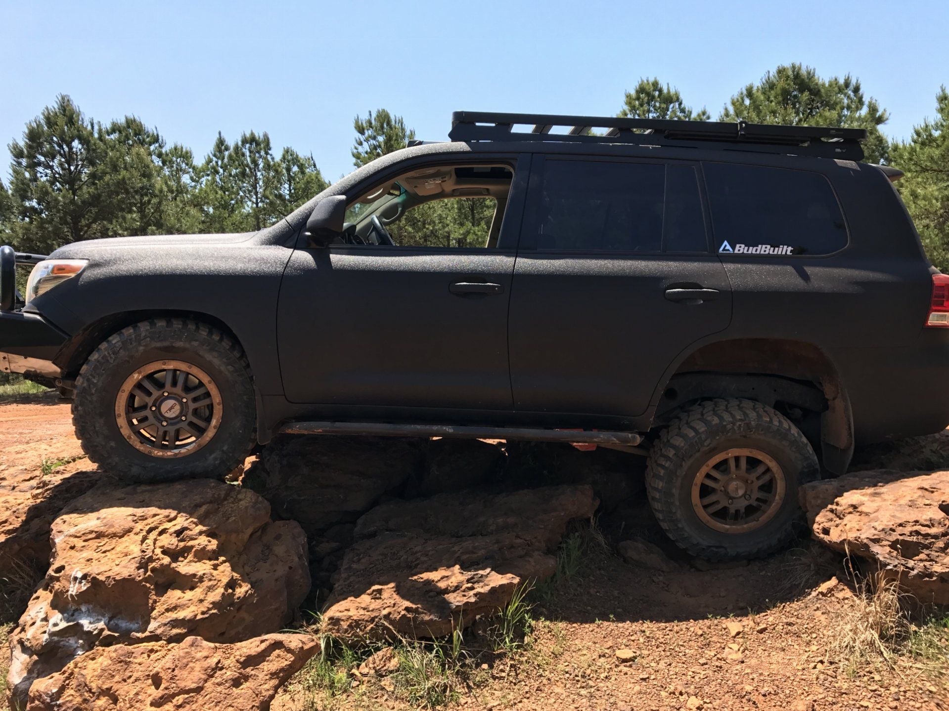

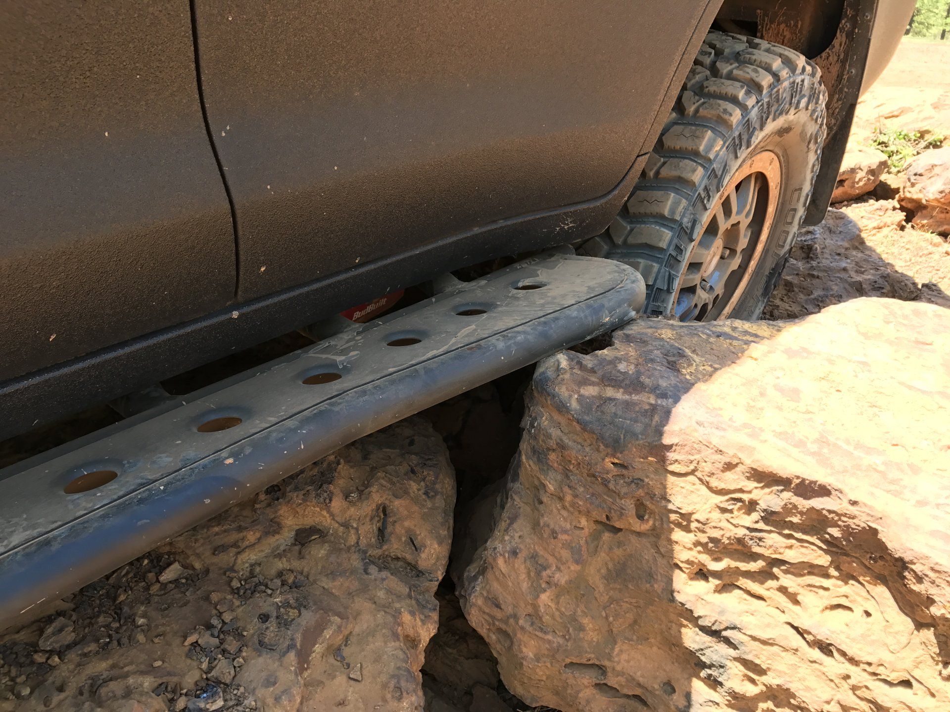

Notice the BudBuilt sliders, triangulated leg arrangement creates enormous strength over normal sliders. @BTUMAN and I had a good talk about them while on a fun trail.
This stuff will have a couple small changes, really things that give a hair more clearance. The plates are so solid, they don't need as much clearance from drivetrain components, and that can translate to even more clearance.

The sliders attach with massive 5/8" bolts to lollipop threaded plates on both the inside of the frame (like the front leg of a Slee slider) and through the entire frame, to the back side with more threaded plates. The plates are very large to provide a ton of surface area to distribute load. The slider sits on a single 1/4" plate with legs that are much further to the ends than normal, which helps minimizes deflection.
We were hitting these sliders hard and couldn't bend them. There was another companies sliders out at this event, and those bent into that 200s rocker panel permanently.

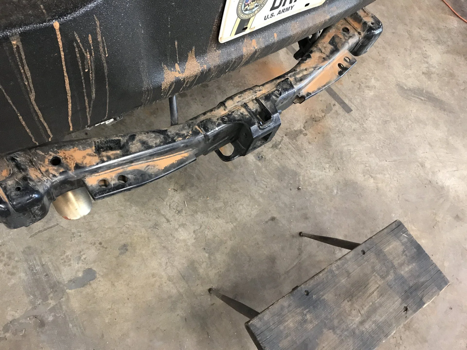

You see that... that little thing right there that if it wasn't there could make the rear end of a 200 have a serious rock crawler rear end?
I'm talking surgery folks, with Bud, Dillon, Chip, and I. We are going to redesign the rear crossmember! This will yield a true high clearance bumper. Taking the tummy tuck design pioneered by Bud, this is a limosuction of the back end. I just figured that a steel rear bar doesn't really gain much other than strength, but with these guys, one improvement isn't good enough, why not have strength and ground clearance? I'm leaving the 200 again in Bud's hands, I'm pretty pumped.
This will be at the Appalachian Toyota Roundup end of August/beginning of September.
