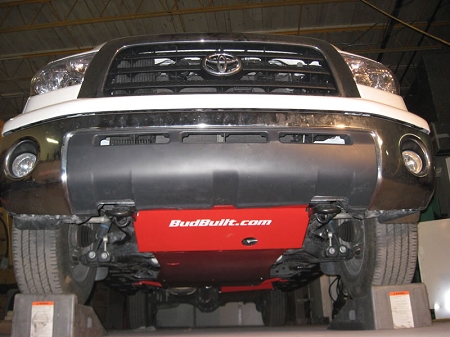

Well, the off-road gods smiled upon me and I got time off of work and will be going with Bud to the Lone Star Toyota Jamboree. I'll take a bunch of pictures of the sliders and skid plates and frame and suspension armor for everyone.
This is also the real world test to make sure everything is good. I think we might paint them red for this event just so they are easier to see. My set is all stainless steel.
All the items in red are the "test set." Real world testing, I think, is not only fun and rewarding, but the only way to know if a product is actually ready to handle abuse.
The inside of these has some engineered reinforcement thing that Bud does (I don't know, he's the automotive and industrial engineer, I'm just a guy who can add metal till I think it is strong), it took about double to pressure from the press in a crush test verses a skid that is just simple plate steel with some attachment points to the frame. Also, one of those skids will change again.
The gas tank skid, transfer case mounting system, shock guards (which are really weird, they are very different, and Bud is going to paint those black to not draw attention. They are experimental, and out of context, they could be perceived wrongly)
Umm, what else. Control arm skids that don't require removing the control arm bolt or drilling. Rear diff armor is on the truck also.
Oh, so Bud's front skid actually offers more clearance than the stock skid. It may be a 1/32", but hey I'll take it.
