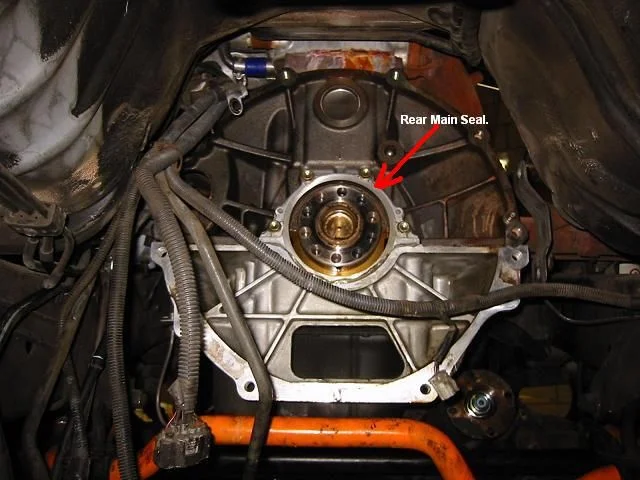

I see you mentioned replacing the rear main seal, do you currently have a slow leak and how bad is it? I have a leak originating from what I believe to be the rear main seal and while it's not anything major it will leave about a drop of engine oil on the ground every couple weeks.
Yep. That’s a rear main seal leak. Mine look the same but not enough to leave a drop yet. The entire tranny has to come out. :(
I took the cover off and cleaned it all with Gunk, but leak came back. Will be letting mechanic handle this job for sure.

I've done a lot of research on this since I first discovered it about a year ago and from what I understand its anywhere from a 7-10hr job at whatever labor rate the mechanic you choose charges. It does require you to pull the trans. Dealers will be higher than indy's (generally). Here's a pic for reference of just how deep the seal is and how hard it would be to get to, and this is after you've already removed the flywheel. It has been advised to replace the rear main bearing as well as the front transmission seal and bearing as well since you are already in there. I could see this repair easily exceeding $1500:( But as @paflytyer stated in another thread concerning this topic, I don't plan on touching it until oil begins dripping out so much it hits my exhaust/cats and begins to stink up the cab.
(Picture courtesy of @LX_TREME from the 80 section)
attachment.php
attachment.php
