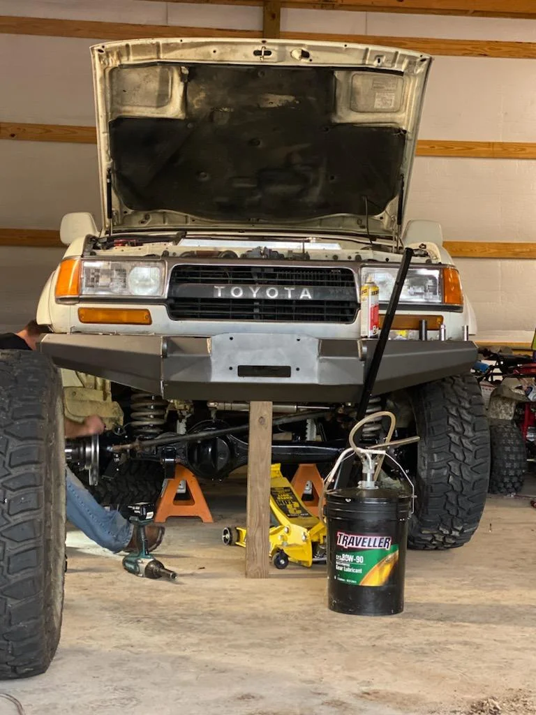

Started the morning taking the front axle around to the truck bay for final installation.

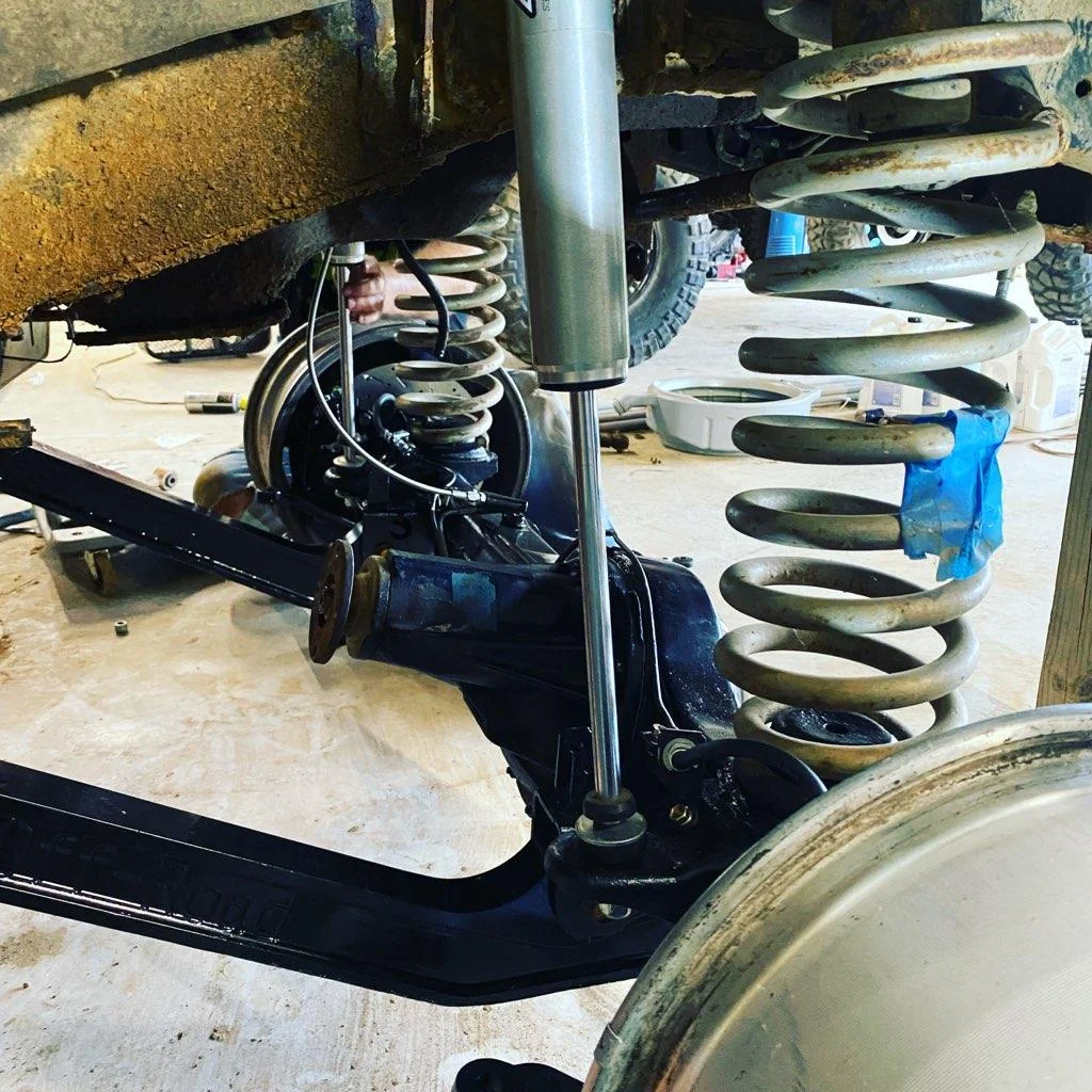

Bolted the radius arms on and started lifting the axle back under. Installed springs and front shocks.
Then tightened up the hardware and installed the driveshaft, tightened the brake lines and started gravity bleeding the new front brakes while I was fiddling with some misc stuff. Then I tightened up the hub nuts and thru on the brand new @cruiseroutfit hubs.

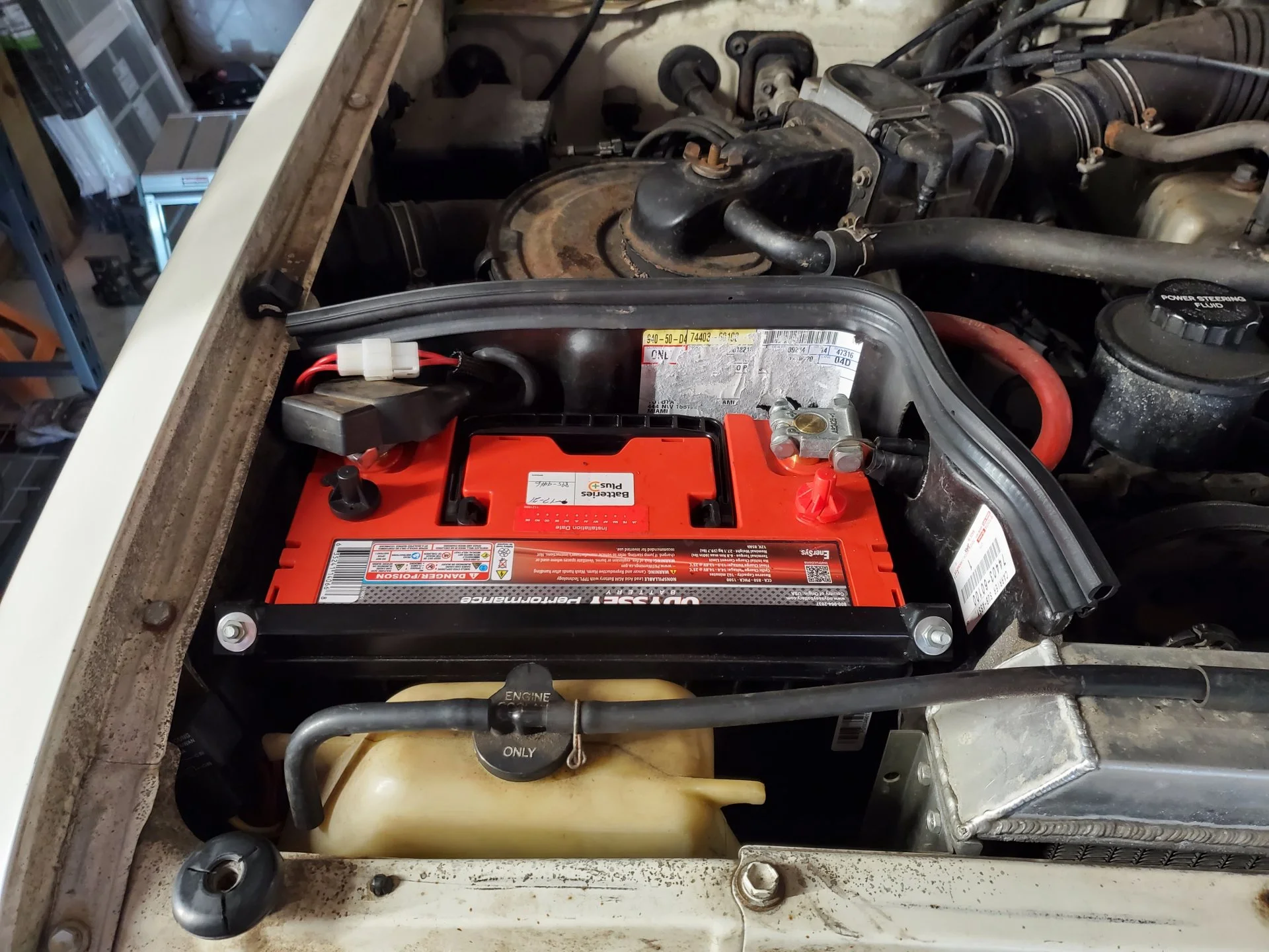

And while I was fiddling with the axle @Mrsjynx was working on the battery situation. Out came the old busted box, the optima box and some other misc stuff and in went a brand new OE box, new bolts, bar and a fresh Odessy 27M.
I still need to tweak it a little, but it's in and solid.

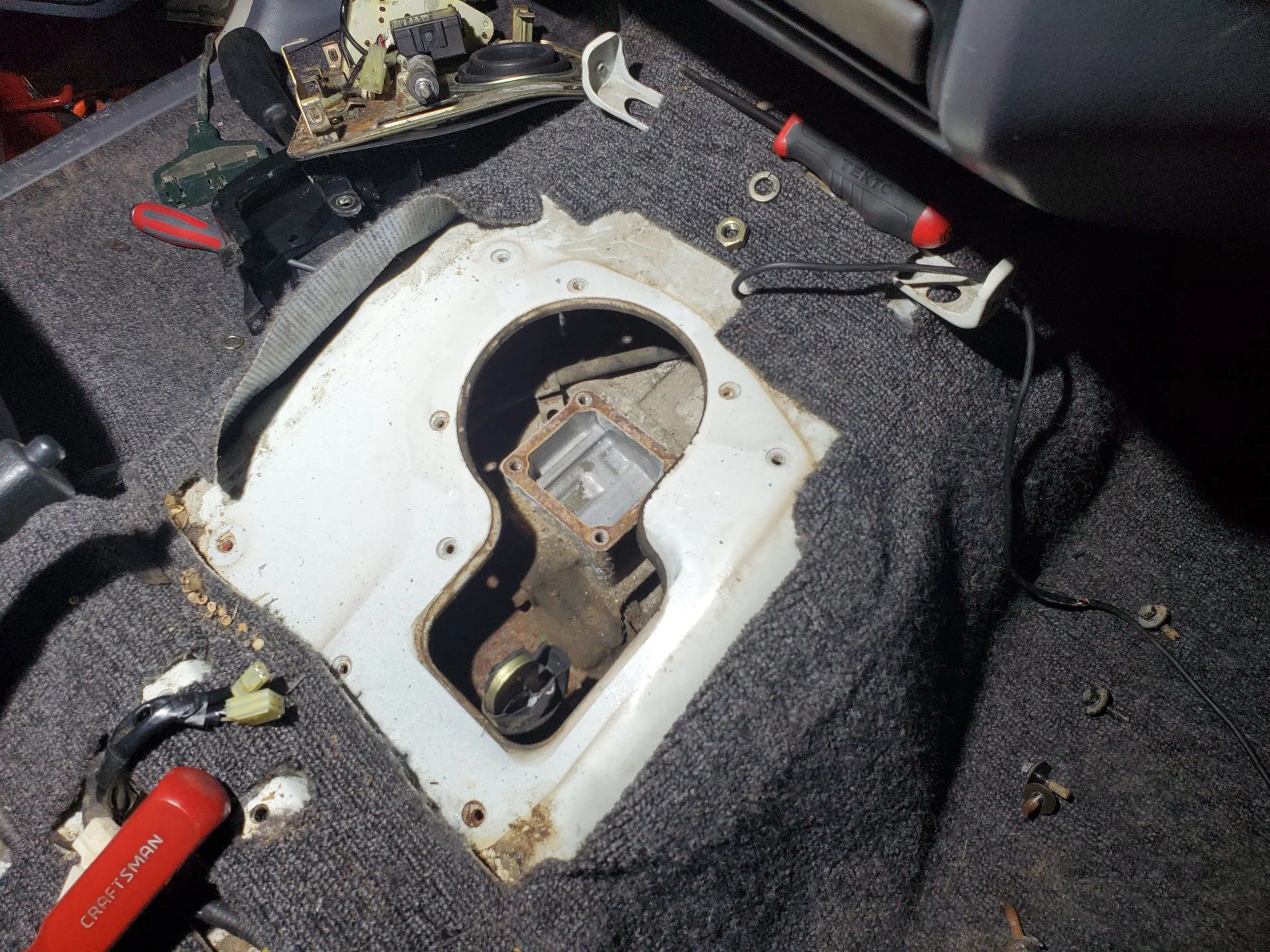

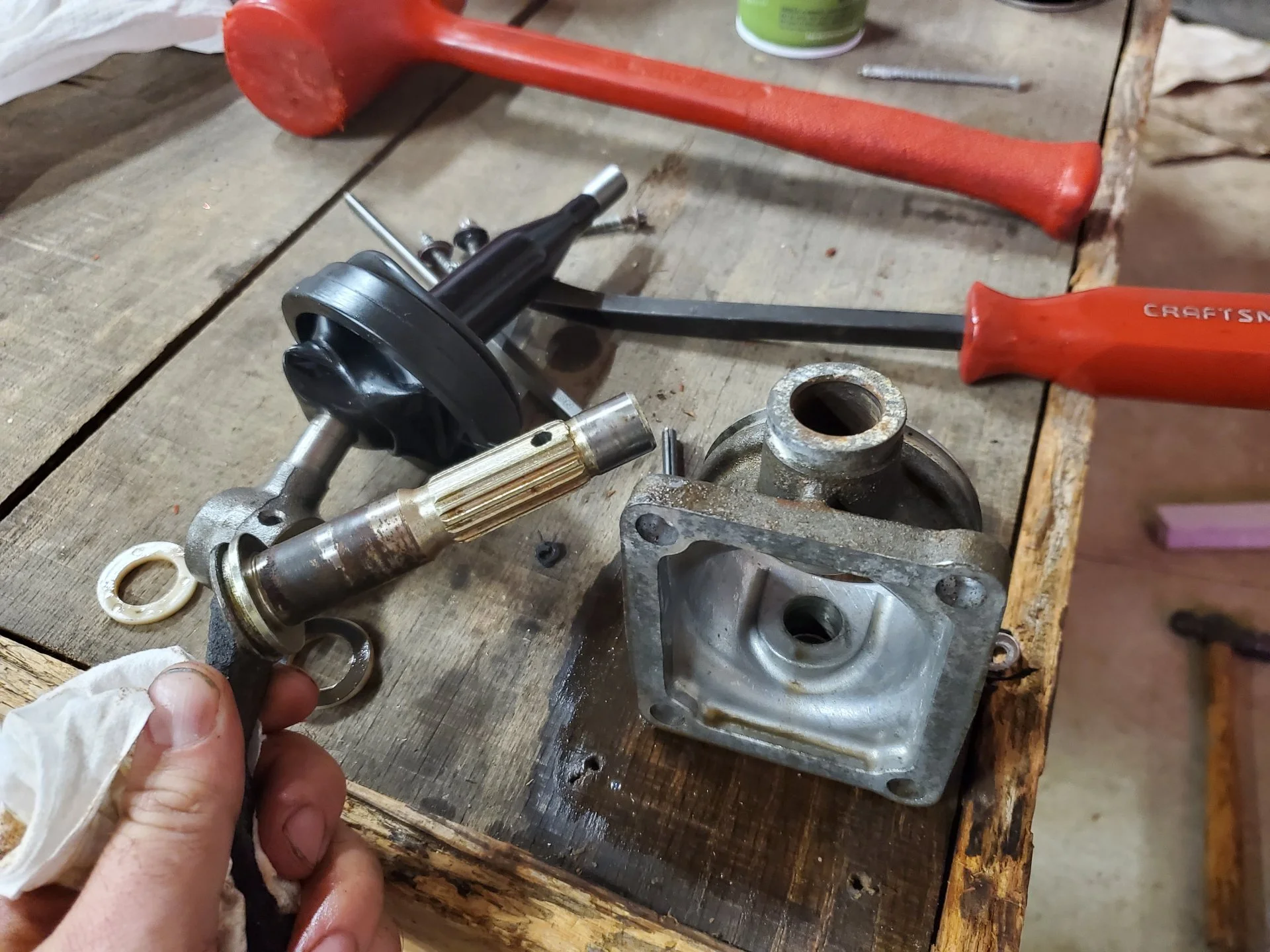

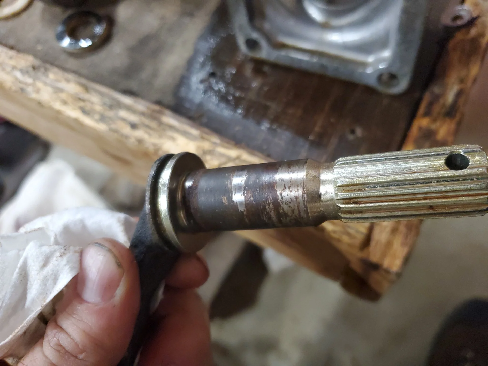

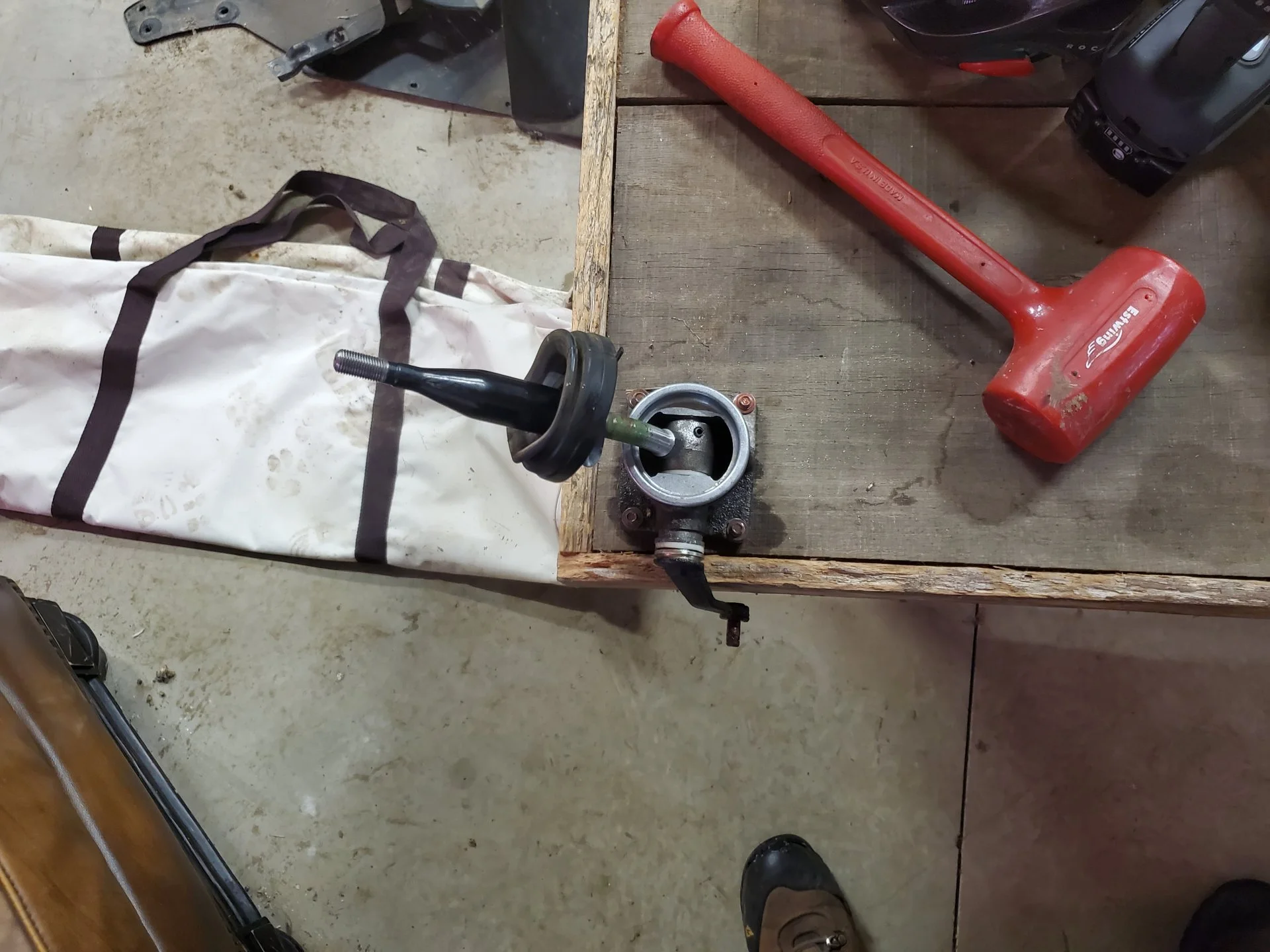

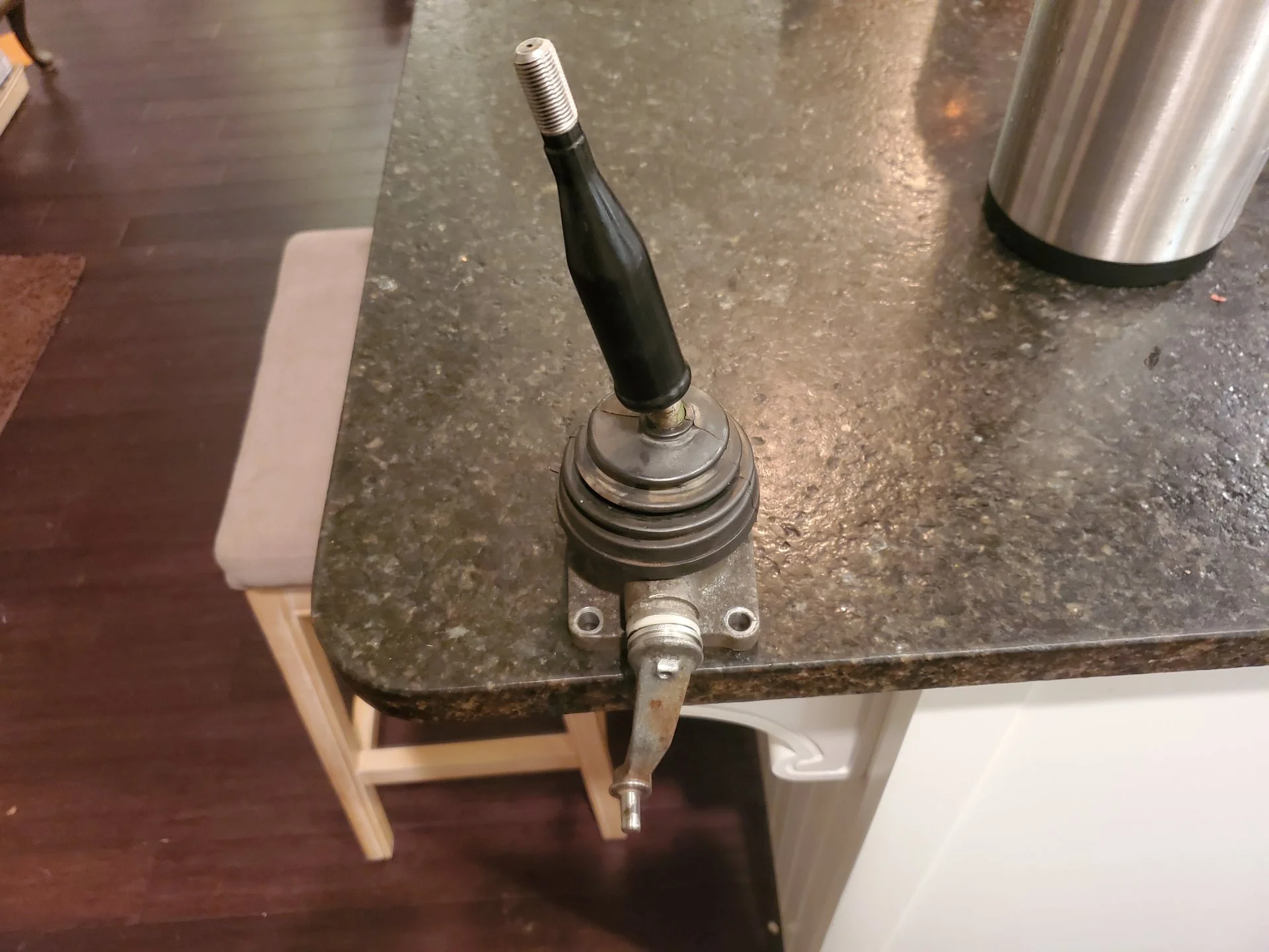

First had to pull the cover plate off the floor to access the linkages. Unhooked the t-case shift rod and the damn handle was stuck and would not budge. So 4 bolts and out it came.
I read online a guy put his in a vise and beat the hell out of it to loosen it up, In the absence of a vise, I screwed it to a wood top table and proceeded to use the red deadblow to beat the loving piss out of it.
I got it moving back and forth a little so I could drive out the roll pin, then after a lot of PB Blaster, a little heat, some pry bar persuasion and more deadblow action, I was able to work the crank out of the shift lever.
The steel shaft was corroded in the aluminum and had seized inside the housing.
So I wire wheeled the loose stuff off, then 220 grit and a scotchbrite to clean it up. Then I worked a green scotchbrite into the housing, tightened down the drill chuck on it and worked it over good. Cleaned everything good, hit all the bits with some moly grease and reassembled.
It moved better now than I think it ever has.
So with that done, and with a little prayer said, I took it out and bolted it back down and hooked up the linkage and BAM! clicked thru H-N-L like it just rolled off the line, maybe even better.
Some antiseize on the connections and I have to find a new clip since I mangled the old one removing it and then put the console back together and we are in business.

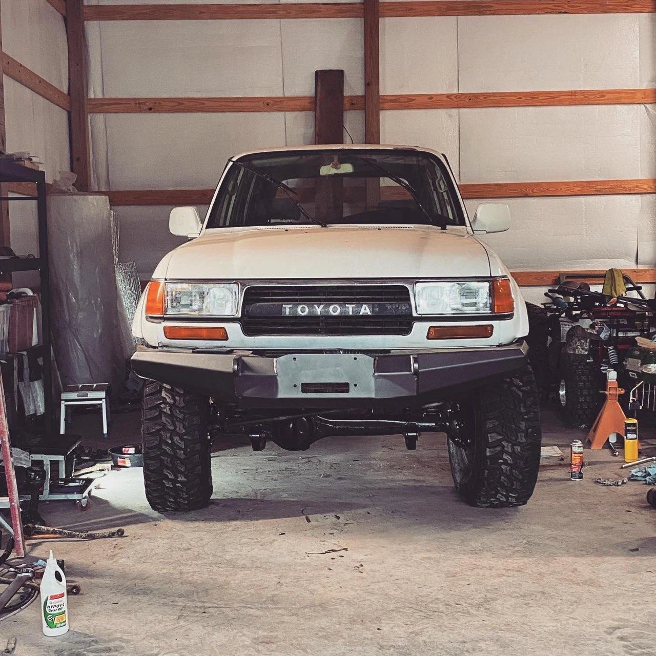

wow, the truck is looking great. That front bumper is awesome, too
Thanks Joel. It's amazing how my gearing changes when Erin sets a deadline...
The bumper is from Cruisin' off-road and is set up to hold an 8274 if I can ever line one up for it.

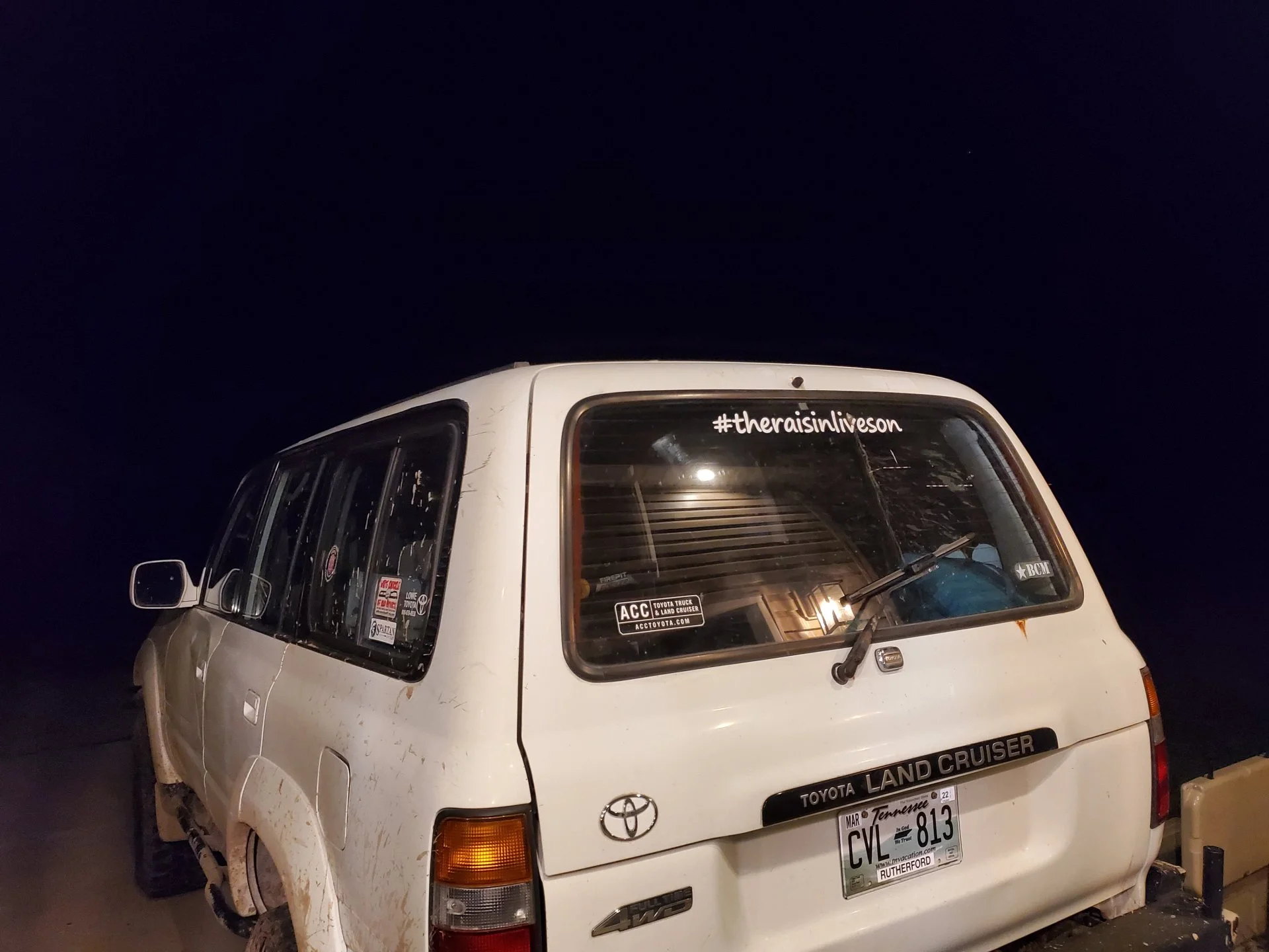

Put about 150 miles on Bruce today. Came home with everything I left with. Best I can figure I got between 12 and 14 mpg. Speedo is way off, like showing 85 running 68 off. And an exhaust is the next major thing it needs.
Full trip report to follow. Made it home, roughly 200 miles and 36 hours in the truck, 4 highway, 10 trail, 7 sleeping, the rest parked in a killer camping spot.

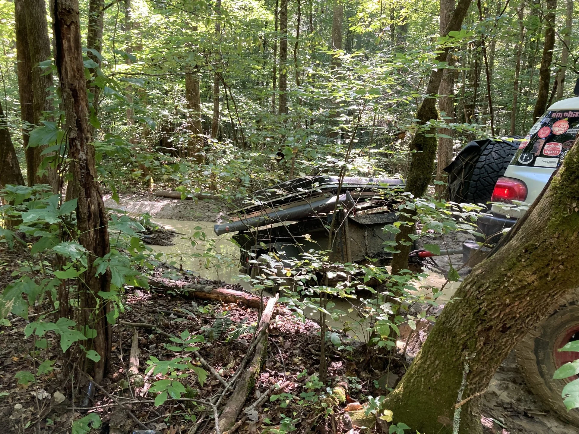

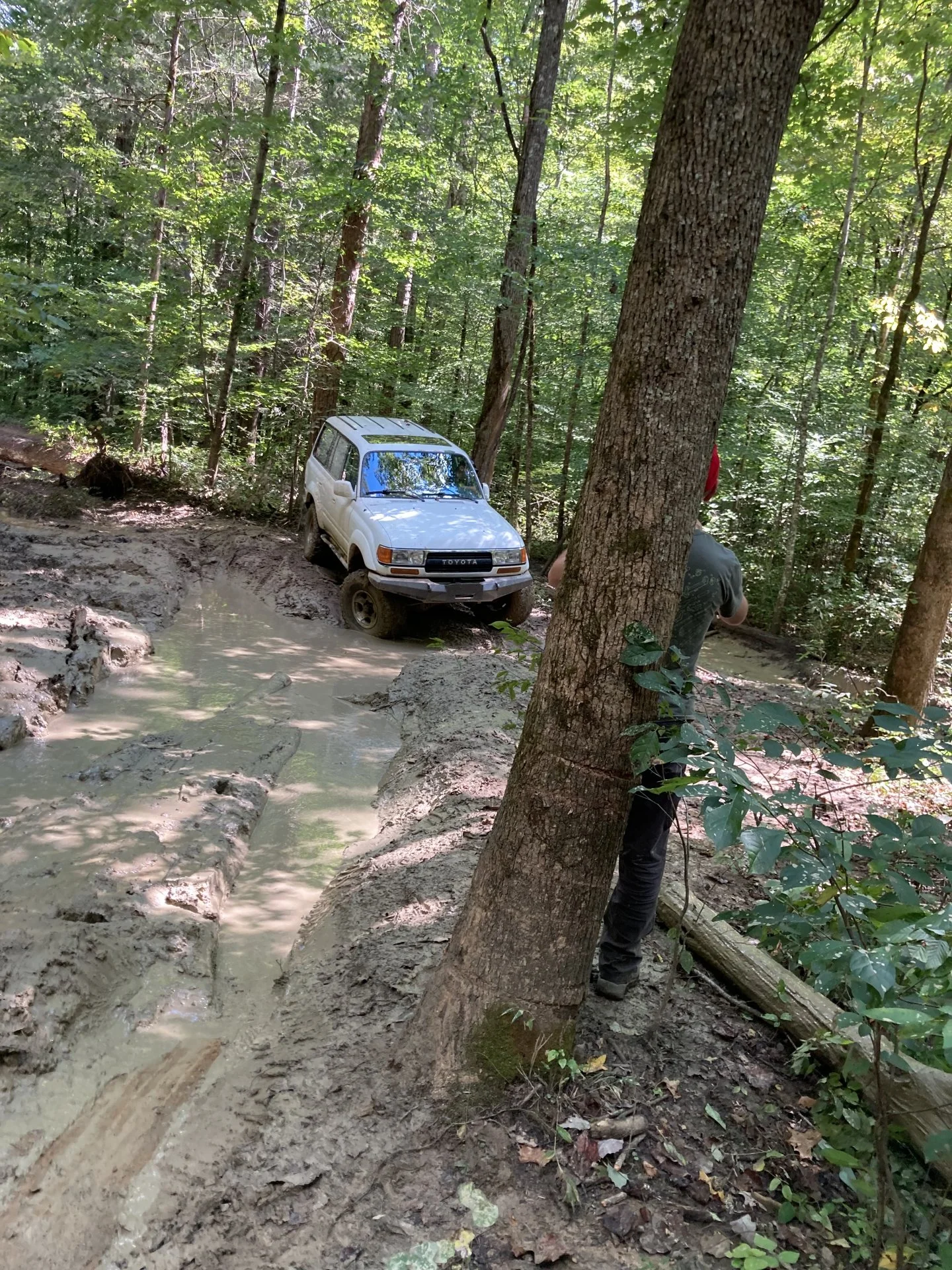

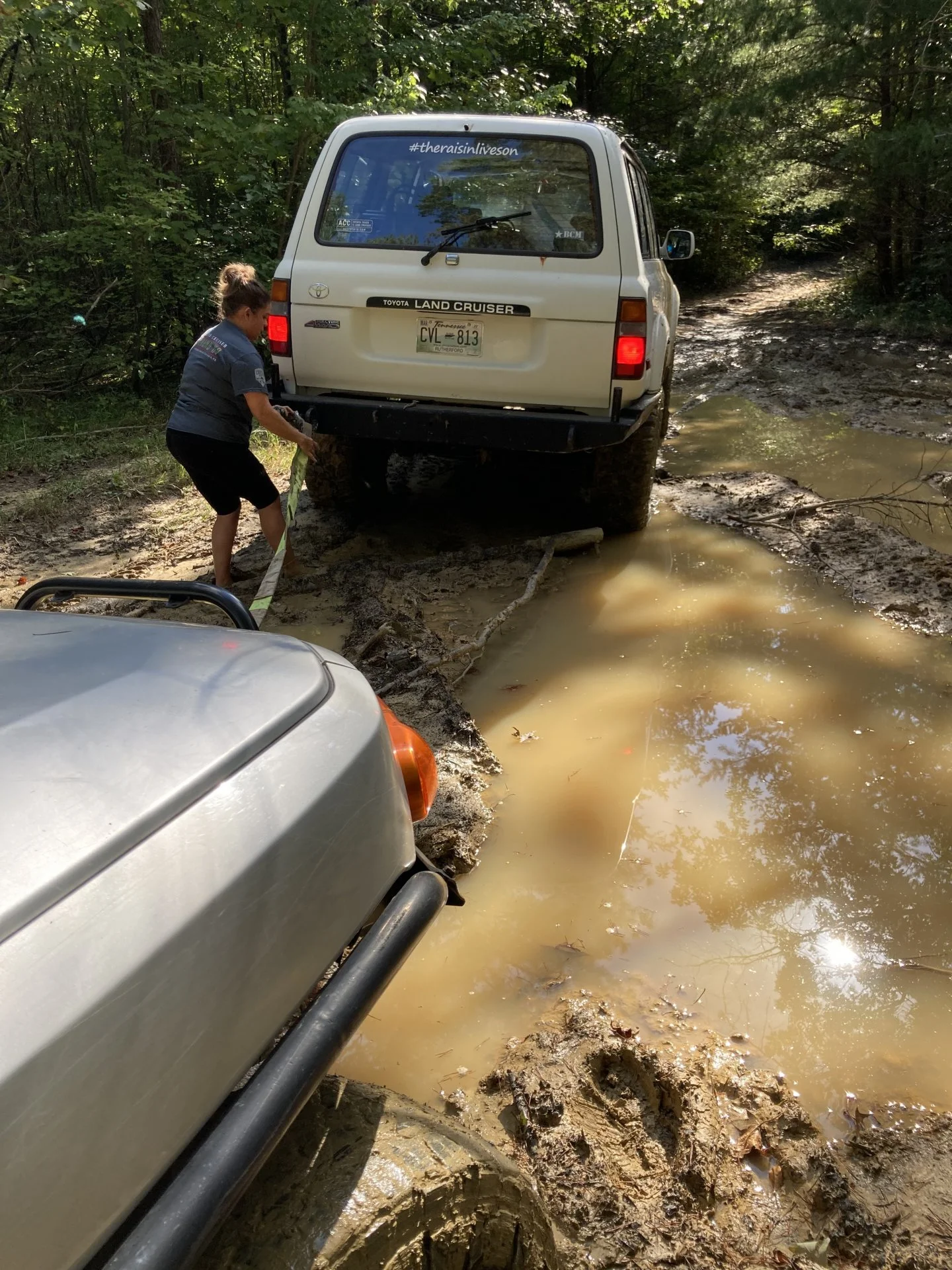

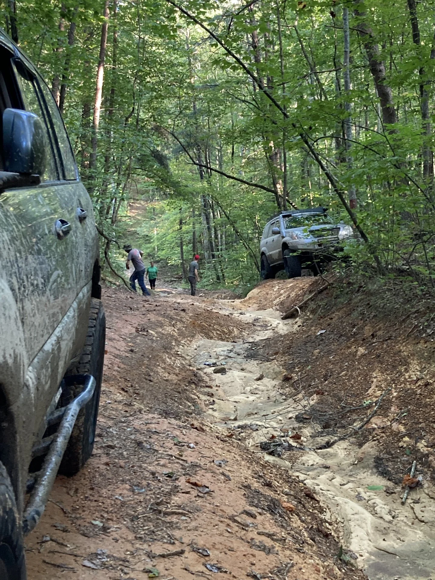

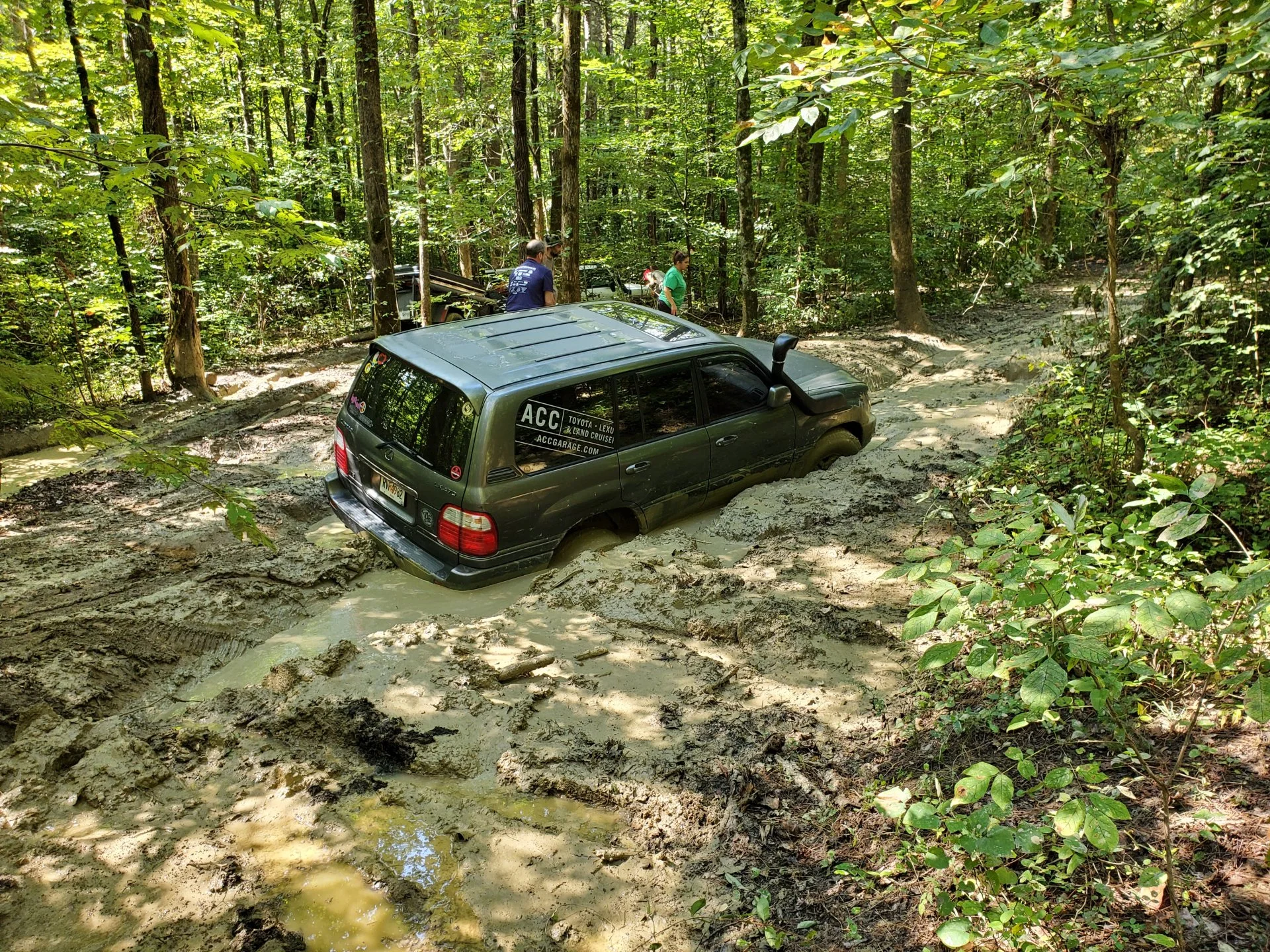

So Rick picks the alternate line and...
So Rick pulls line and drags himself and that giant log out of the hole. With him thru, Dugan makes a run, and pulls cable. Then Brian pulled Towers out. So then I tried to avoid those holes, but put a giant dent in the drivers door, so not stuck, but dented door. Think I should've just took the cable.

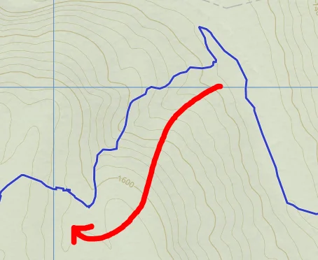

So out of that mess, we eased along watching Gaia like a hawk. We had to cut some fallen trees and finally got to the split, only to miss the first turn, but just barely. I wish I had gotten a picture of all the random paths that the SxS crowds have cut thru the woods. It is maddening to be honest. Anyway we found the way and made our way thru to the church. At the church the map makes it look like there is a road out, never tried it, no logs on it, but it looks like it's there, so ready to get out of the woods we gave it a shot... IT IS NOT A ROAD... for the record. Might have been, but it ain't no MO. So after turning 4 trucks around about 3/4 way up the side of a mountain, we were back at the church and on our way out. Again, SxS bypasses, highcentering a log and a jack-knifed trailer which busted a tail light got us off trail. A little jockeying and we got back on the path. Then there was the next mud-hole checker game. We hit a stretch where it was about 10 holes in a row, just had to chose your line and make a run for it. Fortunately we all rolled thru and after a little while we were at the base of the climb out. Just as we made the turn to start up I glanced down only to notice my temp is pegged in the red.

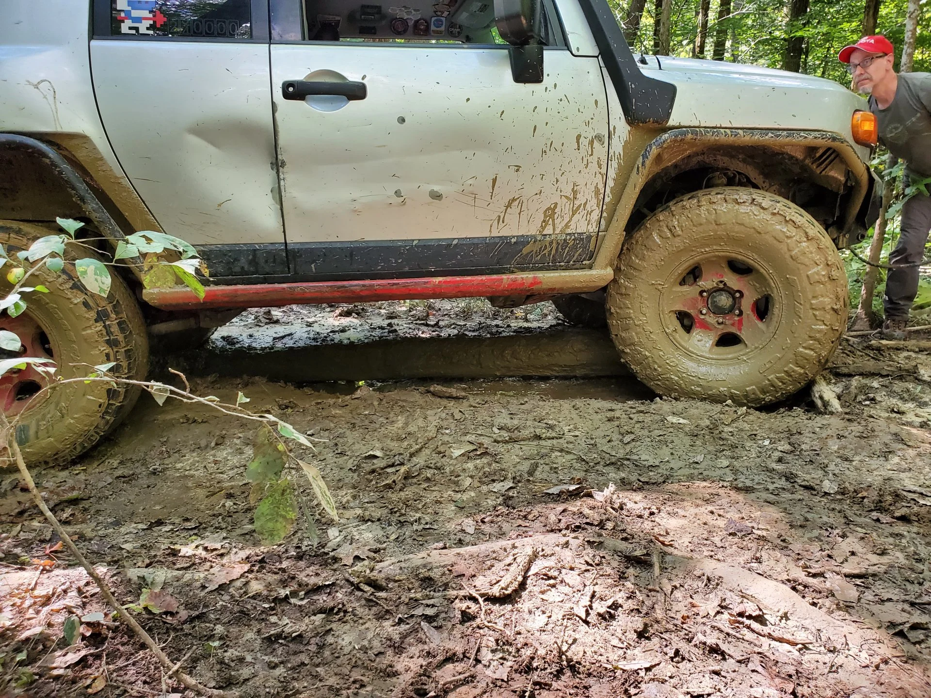

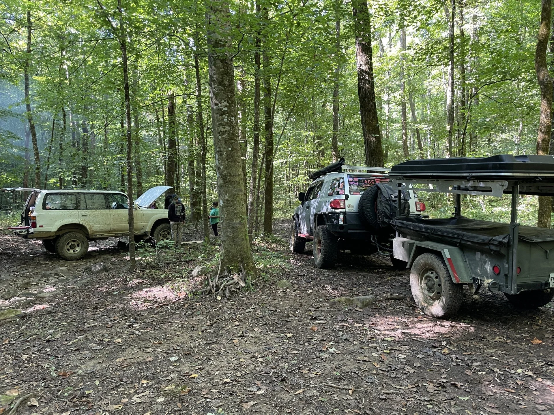

So remember when I said my motor mount was bad and letting the fan contact the shroud, well it moved enough that it basically wedged the fan between the rad and shroud, so no air moving equals over heating. So in order to get it free I basically had to take a pair of pliers and destroy the top of the shroud... I'll have to get a pic of that carnage, and I hope I can find another shroud. So with that, Temps started down and we start the long climb out.

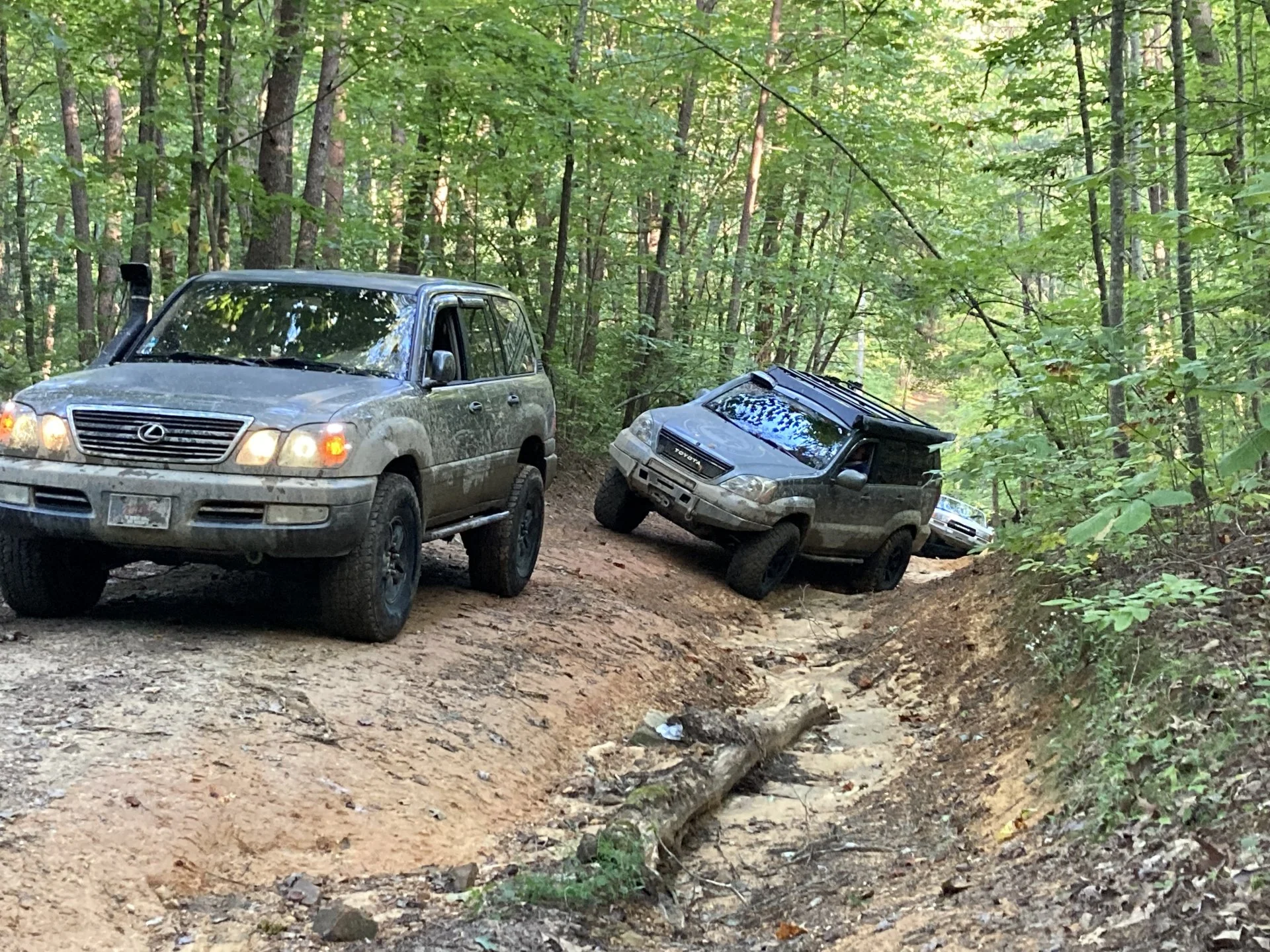

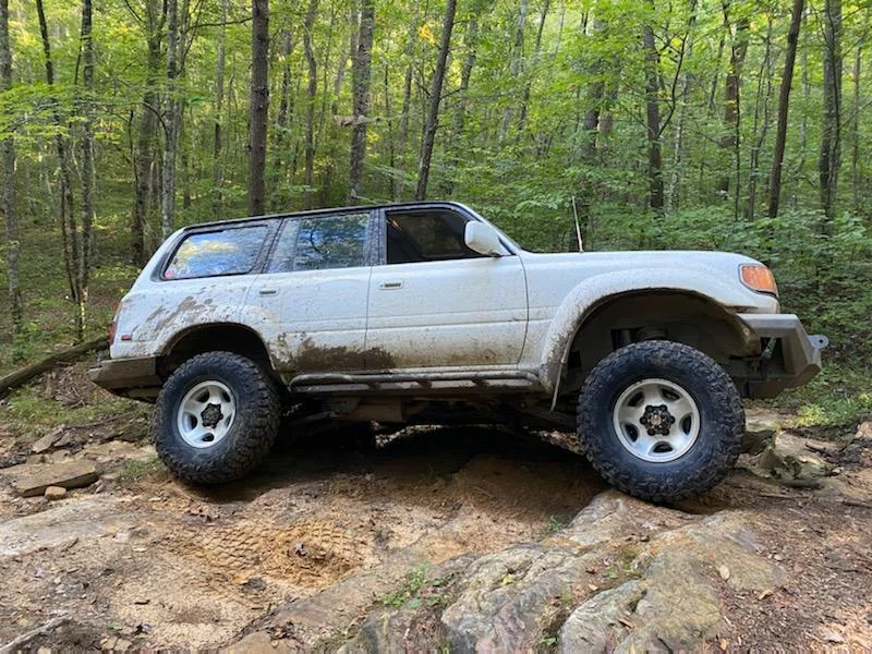

Then on a ledge, the truck walked and this happened.
The picture doesn't do it justice. I felt like I was about to flop, but the rear diff was planted on the ledge and I was turtled. Brian turned around and with a little smittybuilt assistance I was up. Then it was just the Slow chug to the top. 2nd gear low range for what felt like ages. We hit the gravel at around 5:30ish. We left camp at around 10ish. So roughly 8 hours of plugging and chugging.

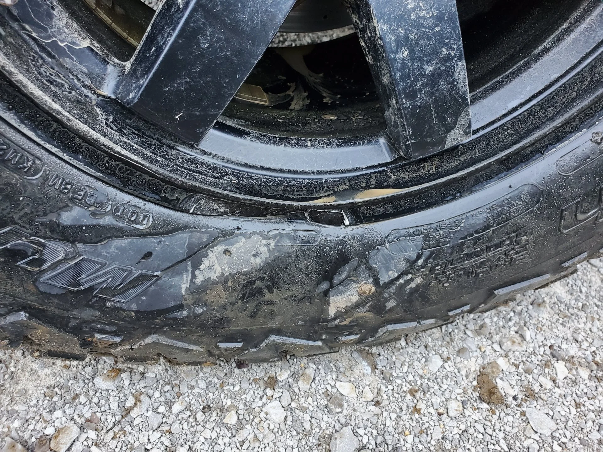

Then while airing up Brian discovers this,
Something managed to basically break about 4" of the lip off his front drivers wheel. Quick change to the spare. It was amazing that it was still holding air. Towers also found half a log wedged in his front Passenger wheel so he swapped to his spare as well. And with everyone aired up we said our good-byes and everyone made a bee-line for home.

I kind of feel bad. When I seen the old fan and shroud l started to mention you probably have a broken motor mount. Ran into the same fan and shroud issue on my 40 years ago. Makes a heck of a noise.

Funny thing is, I was pretty sure it was a motor mount when it blew out originally, but I took a chance on it. New mounts and a new shroud are being ordered this week.

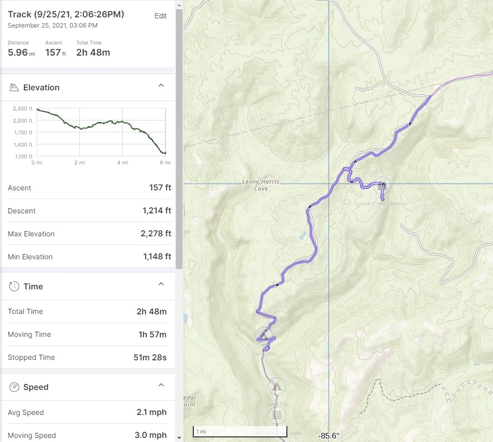

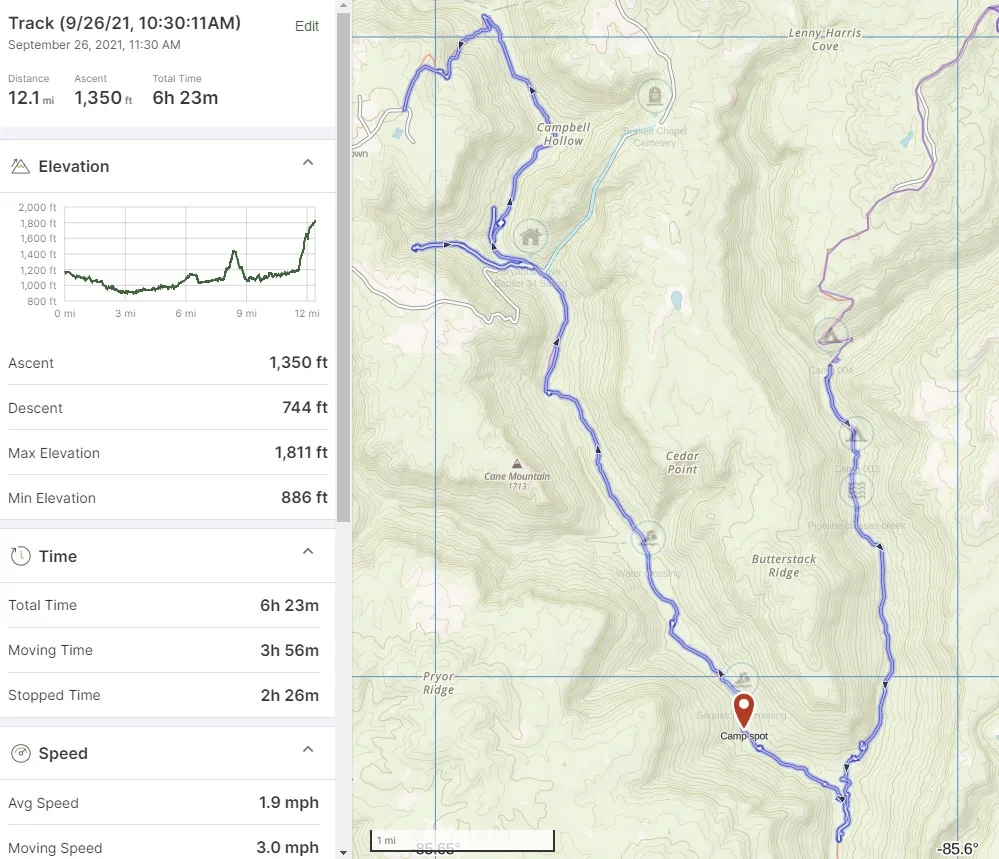

Here's what ground we covered in the two days (18 miles total and <6 hours of moving time!)
Day two:

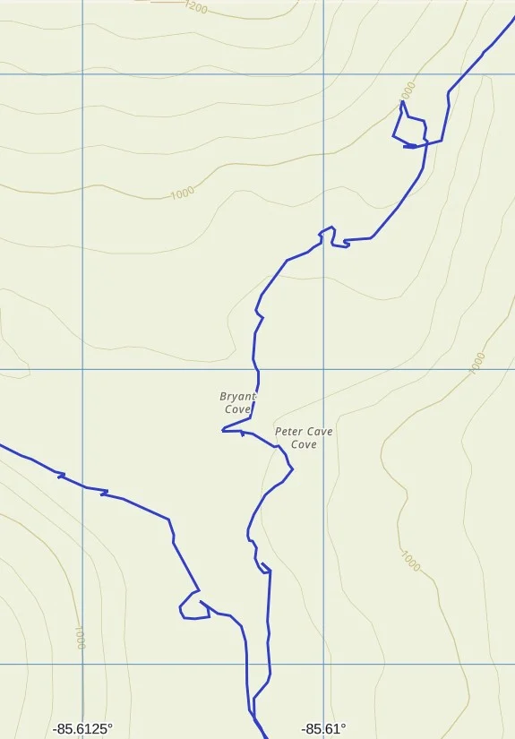

And here's what some of those tracks look like zoomed in on day two, negotiating mudholes, going around trees, dead ends explored. . .

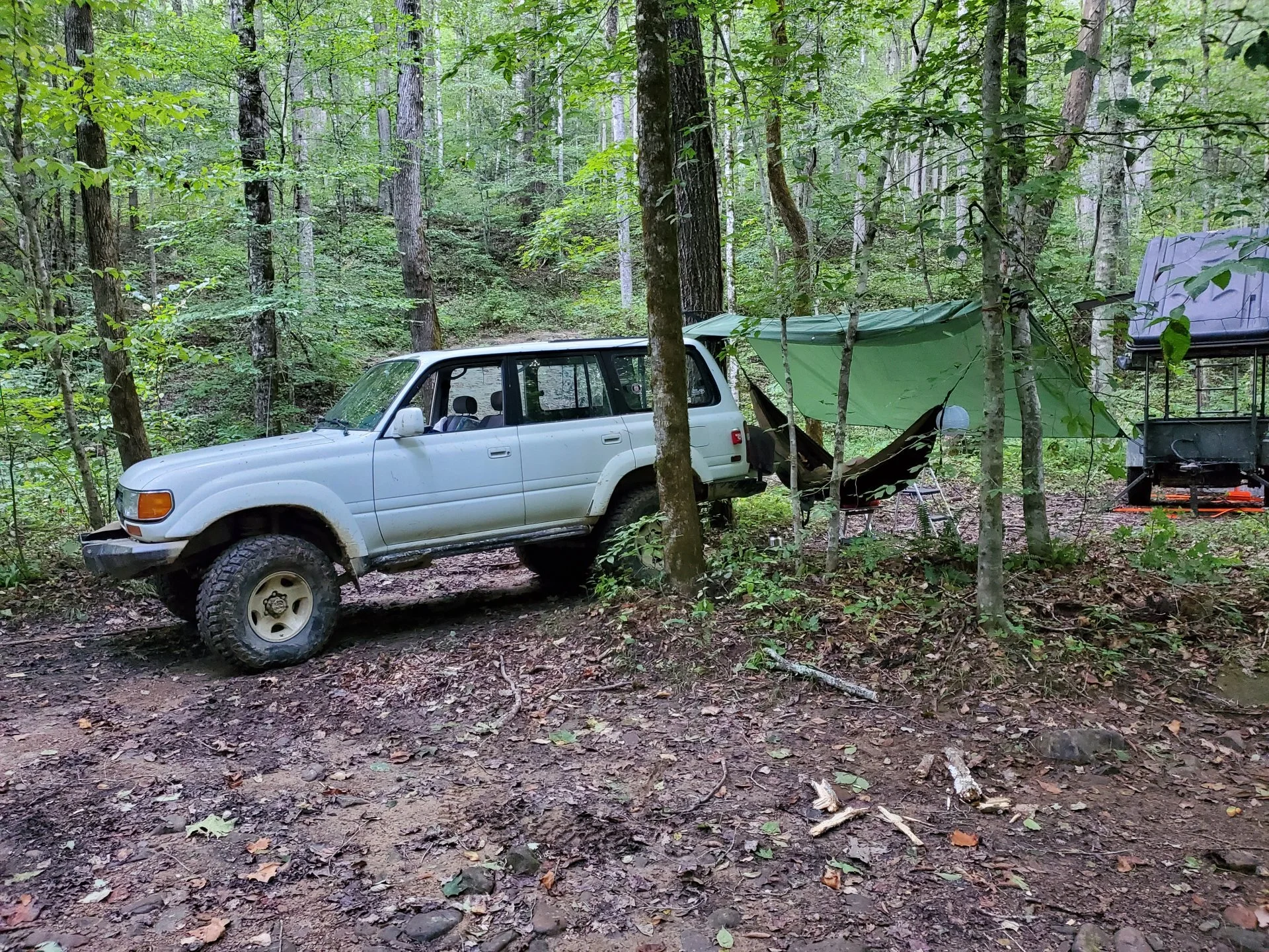

Our camp near a creek was spacious and temperate.

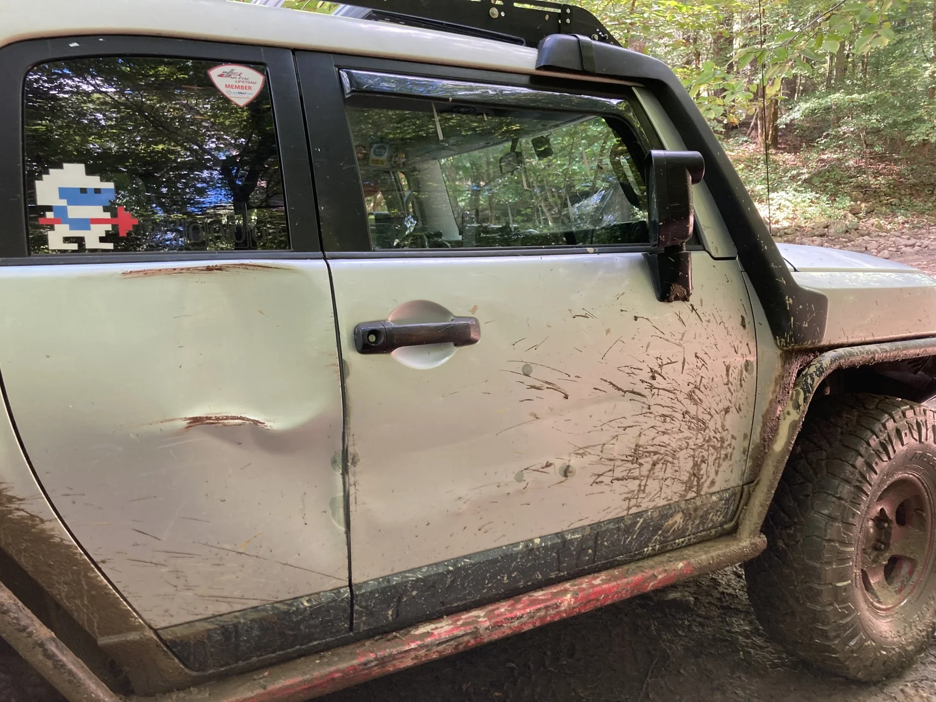

I took some damage on the suicide door, squeezing by a tree.

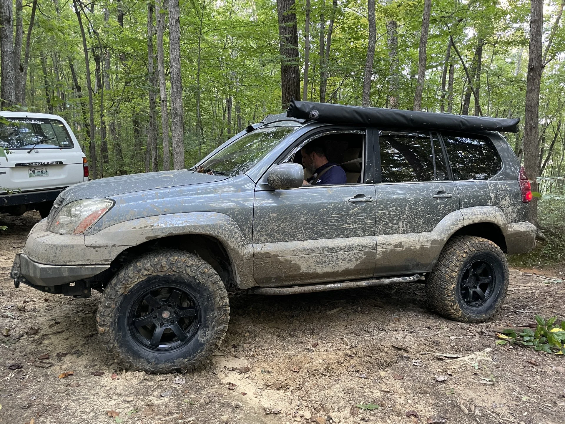

Took a sharp right turn down a slippery mudhole and the trailer mounted awning kissed my rear tail lens. I also took out the front blinker assembly trying to - you guessed it - squeeze by a tree.

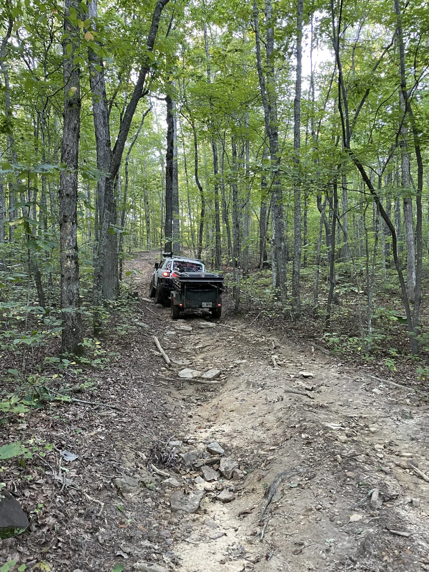

I'm pretty sure it happened on the last big hill climb before it levels out a bit and you got hung on that ledge. I reviewed some video of us getting through the last of the mudholes (when Towers inadvertently took lead) and Dugan's wheel was fine at that time.
That hill climb is super rocky and steep enough that you just want to maintain speed and keep rolling through whatever is in your way. We climbed about 500-600 ft in elevation in less than 1/2 mile.
