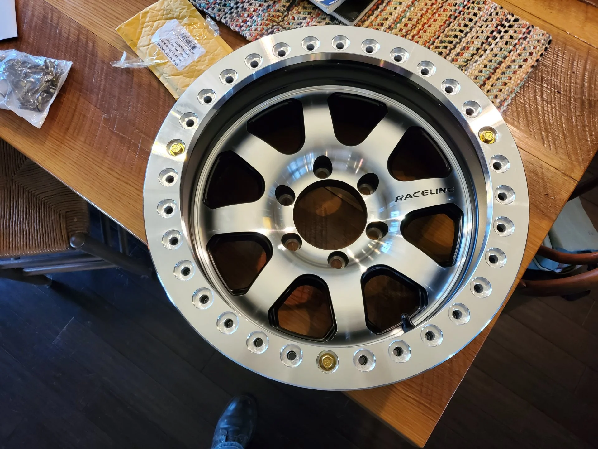

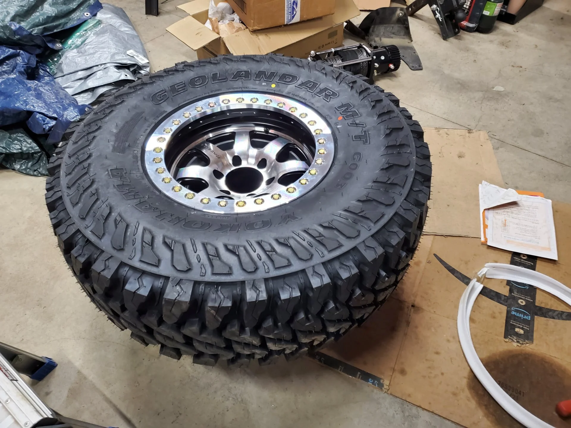

Not gonna lie, beadlocks are sexy...
They also spendy, so I just got one for the spare to start. I need a full size spare and I ordered a tire, so got a wheel. I plan to get the other 4 the first of next year, at least that's the budget timeline currently. I plan to get it mounted tomorrow and then see about a spot to store it.

nice looking wheels, are those true bead locks ? how many banana job to mount tires ?
True bead lock. I needed a spare wheel for my 5th tire. Plan is to order the other 4 to complete the set around the end of the year.
Soap up the bead and the face of the wheel and just a little persuasion. The fun part the 32 bolts that must be tightened down in a pattern in multiple stages.... overall it's a one banana job, but block out some time. A set of 4 will probably take an hour or 2. Probably get faster as you get the pattern down.

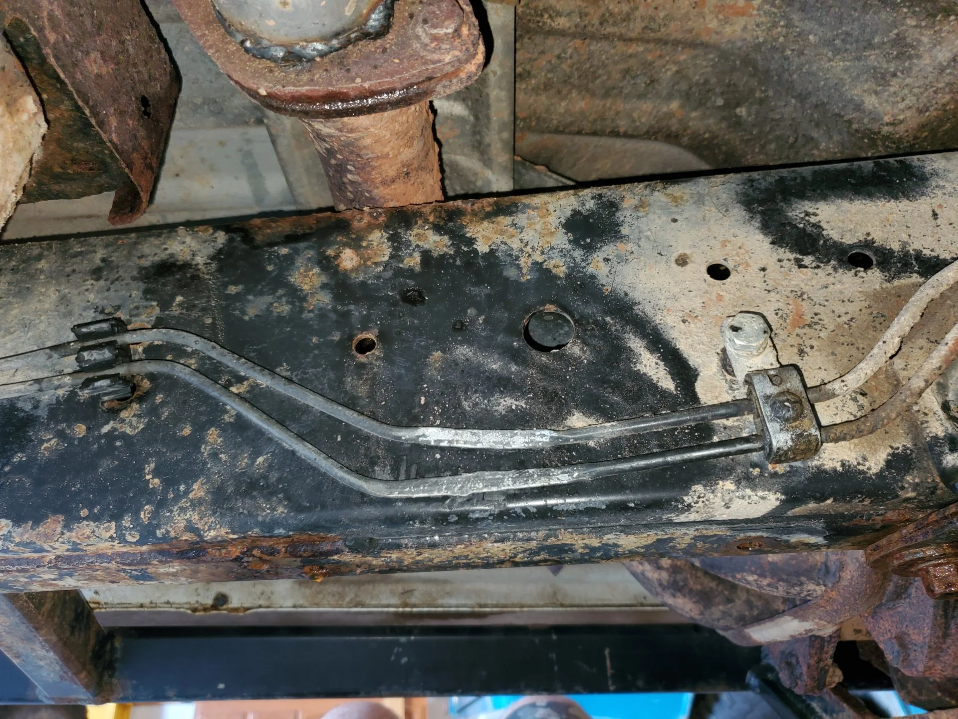

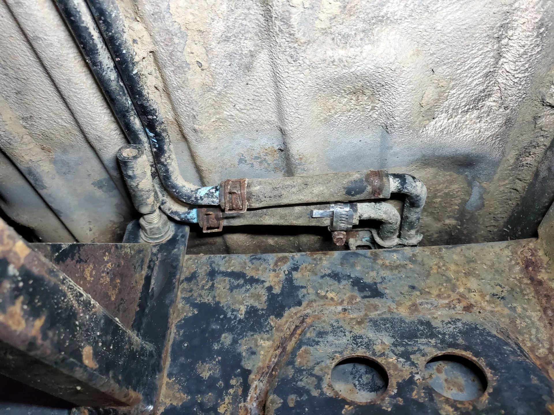

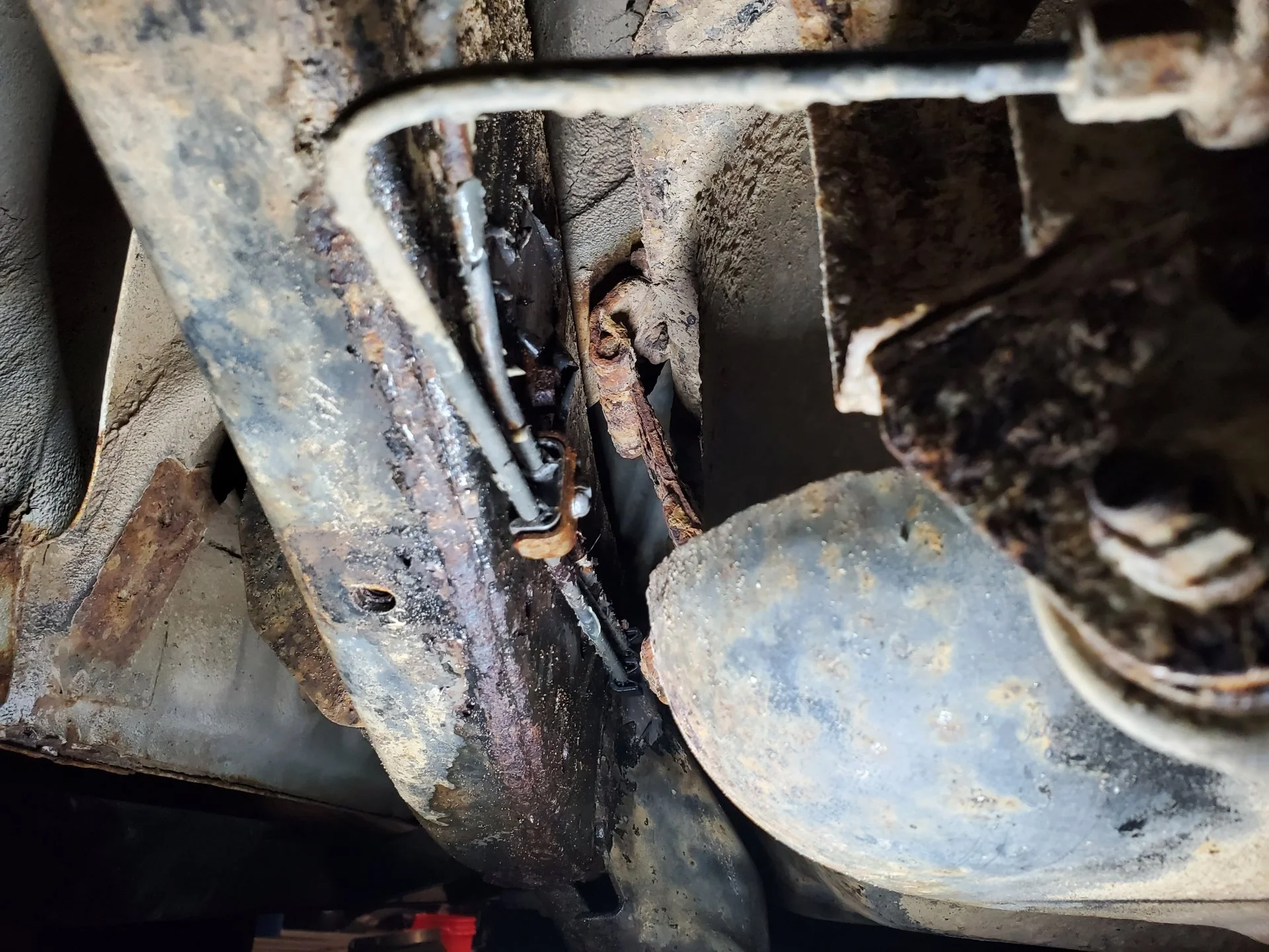

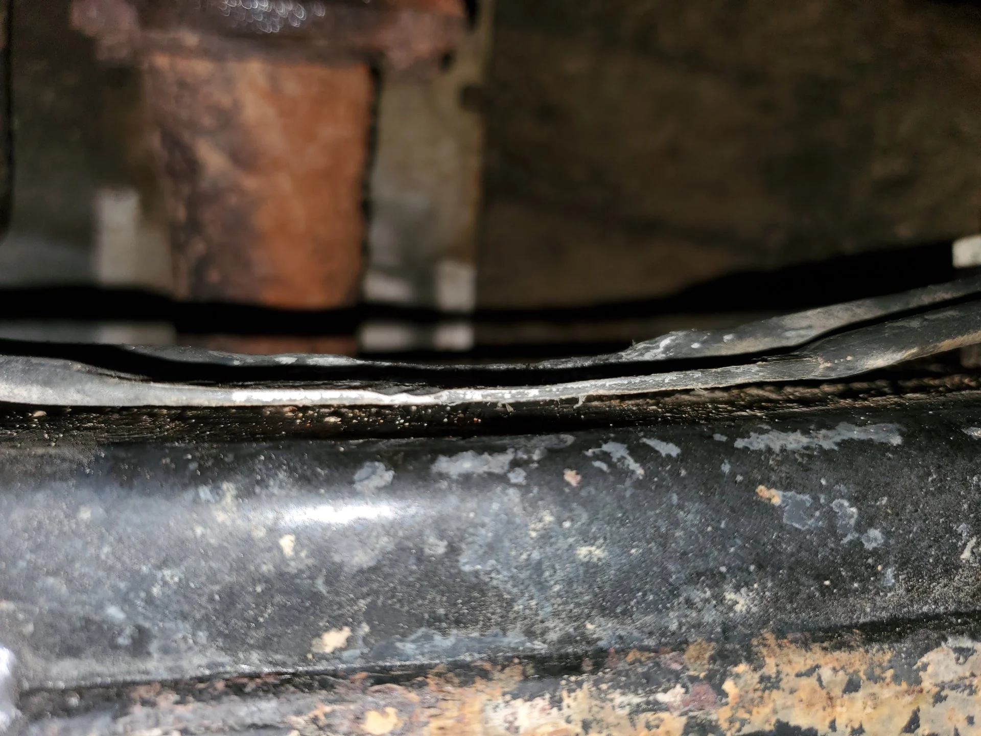

But as with every trip, particularly in the cove, we got home a little worse for wear. I've jammed on the brakes pretty regular before trips because I've been waiting for another section of line to take a dump. We about half way thru the trip in on Saturday the pedal started getting soft. Not gone, but soft. While there was some winching going on, I got under the truck and discovered the culprit. The rear line had started letting go just above the frame mount for the LCAs.
The trucks past caught up to it. The main frame lines look good except in a few spots. This is one of those spots.
So after vice grips, channel locks, lineman pliers, all trying to pinch it off without having to cut them off, @BMThiker handed me his 3lb sledge and I proceeded to use the frame section as an anvil and just smashed the 2 lines into oblivion. They are flat and I was able to run the rest of the weekend and make it back home on the fronts only.
So, home, unloaded, pressure washed and in the shop for a once over and to start planning the replumb of the hard lines. After all this, I'm just going to go ahead and plan to replumb the whole circuit. Got to do some research on eliminating the lspv.

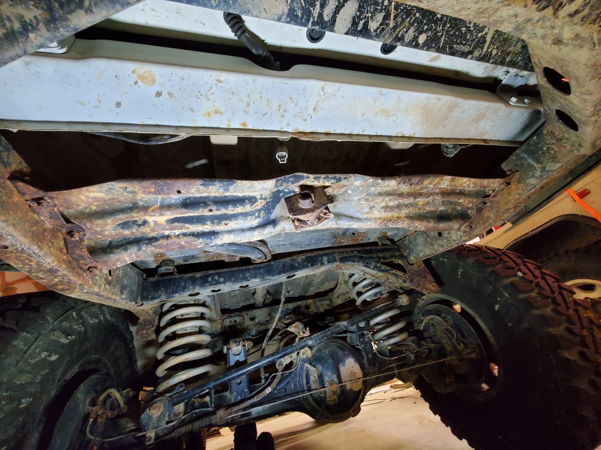

So I took stock on a few facets this weekend. Got a plan for the warpig, got some parts to order foe the 40 and decided to crawl around and take a look under the 80...

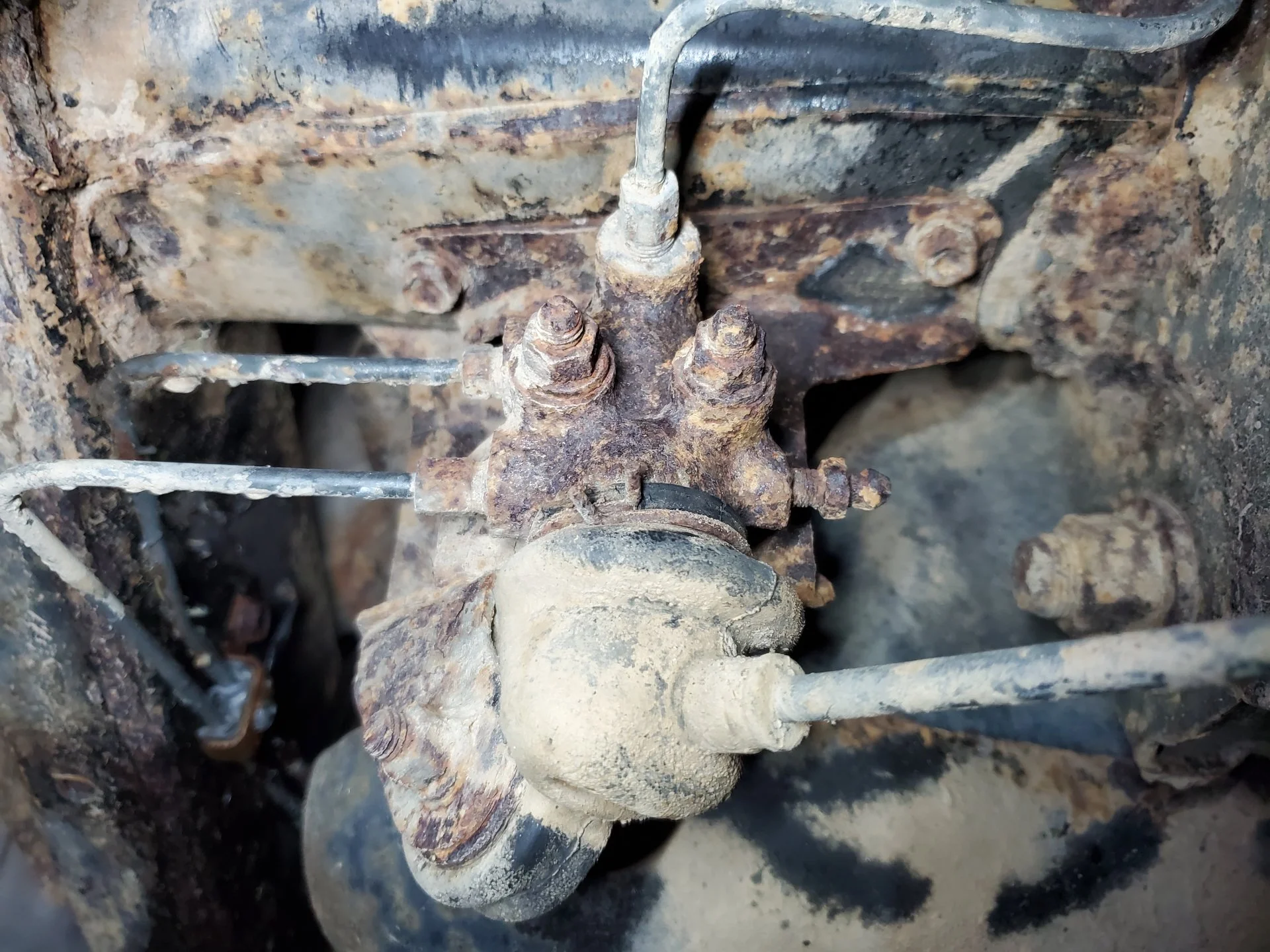

Basically need to replumb everything. Non-abs master to match the 97 front and rear brakes. Should have done that a long time ago. New lines and, on good advice, replacing the lspv with a oem unit.

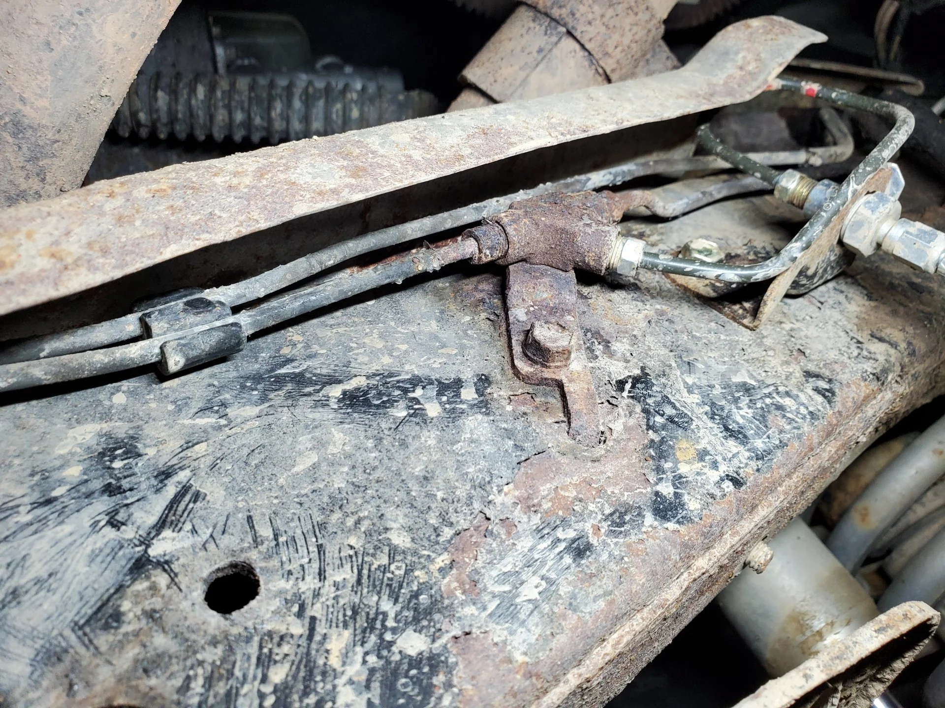

So now the fun starts... how do it get this monstrosity off without breaking every single bolt off...
Here is a better shot of where they failed.
And then getting lines out of this "Y"
From the looks of the routing, likely will have to drop the tank to get access to everything, so that's awesome.

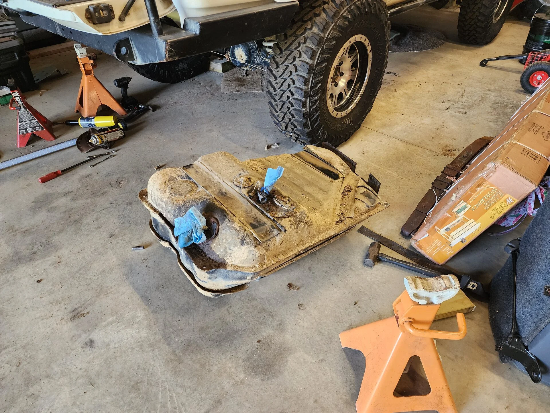

I didnt want to, but had to pull the tank to be able to get to the lspv bracket and get to the hard lines behind the tank.
Fawk a bunch of that. Pulling the driveshaft would have made me hate life less, but one of the diff bolts would not come out and I couldn't break any of the t-case flange bolts loose, so I jsut had to wrestle it out. Thankfully the trans jack was there to help, but I was swearing alot before it finally hit the concrete.
Now I can get to the lspv bracket and also see all the brake lines that need to come out.
Bright side is the bottom of the cab is is really good shape. Wasn't sure how it was going to look. Hopefully tomorrow I can get the brake lines out and new ones made and get all the lspv bits out. And maybe drain the tank and inspect it while I've got it out.

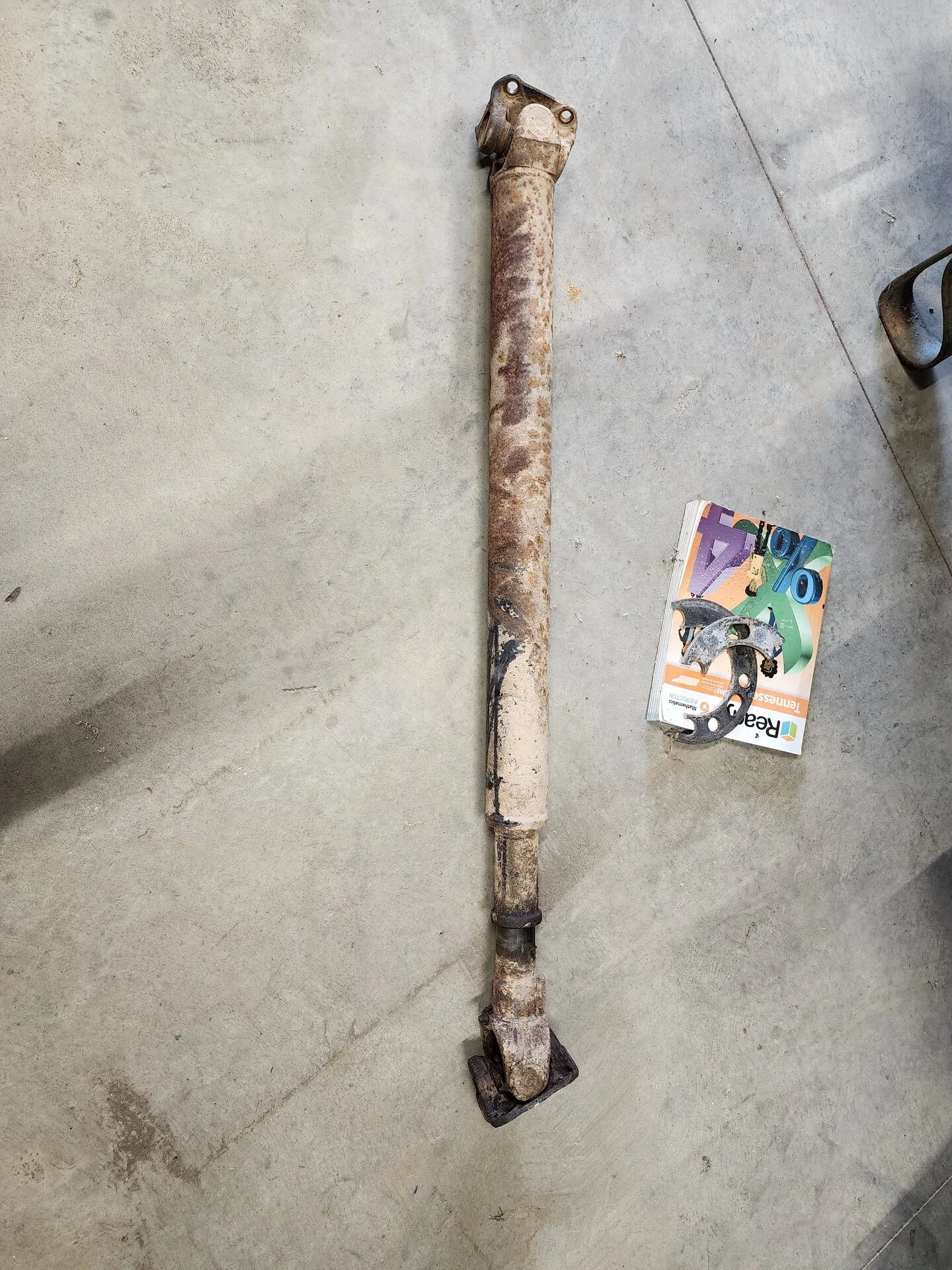

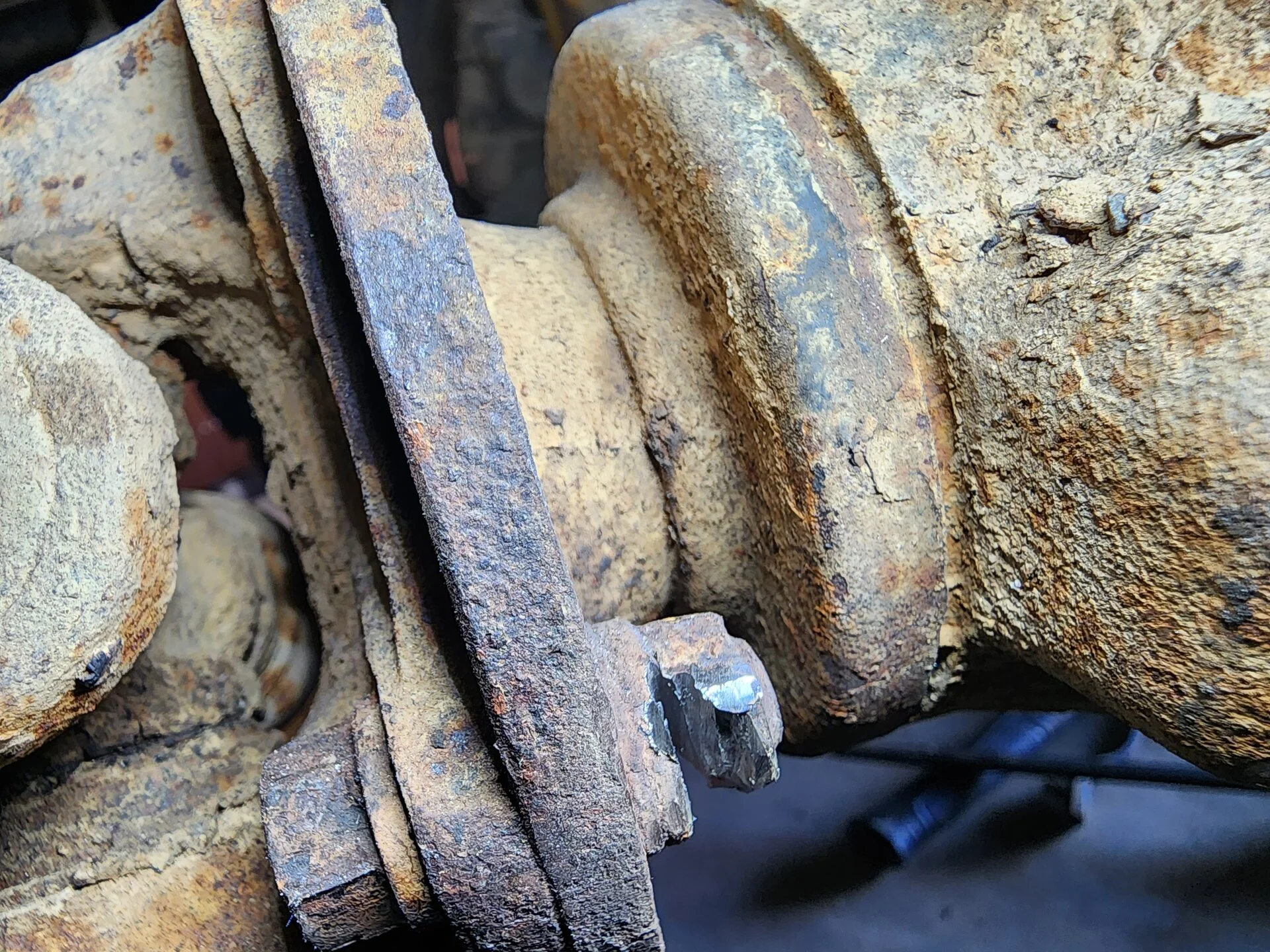

Bruce and I are having a bit of a disagreement regarding the removal of the rear driveshaft. I think it should come out, he does not... I will win
Had to stop mid grind, but I'll finish it up tomorrow.
Just one bolt holding on. There's always one hold out, and you usually have to kill him to convince him otherwise...
Well, after I finished cutting the nut off, I was able to persuade the rest out of the flange. Then a combination of heat, impact, BFH, pry bar and whatever else I had within arms reach, I got the 4 nuts off the t-case flange. And it's out.
I've got some u-joints hiding out somewhere I'm gonna throw in there. And since I've got this much out, I think I'll pull the spooled and geared t-case out of the barn and see if I can't wedge that up in there too.
What's up with the math book and broken wheel spacer?

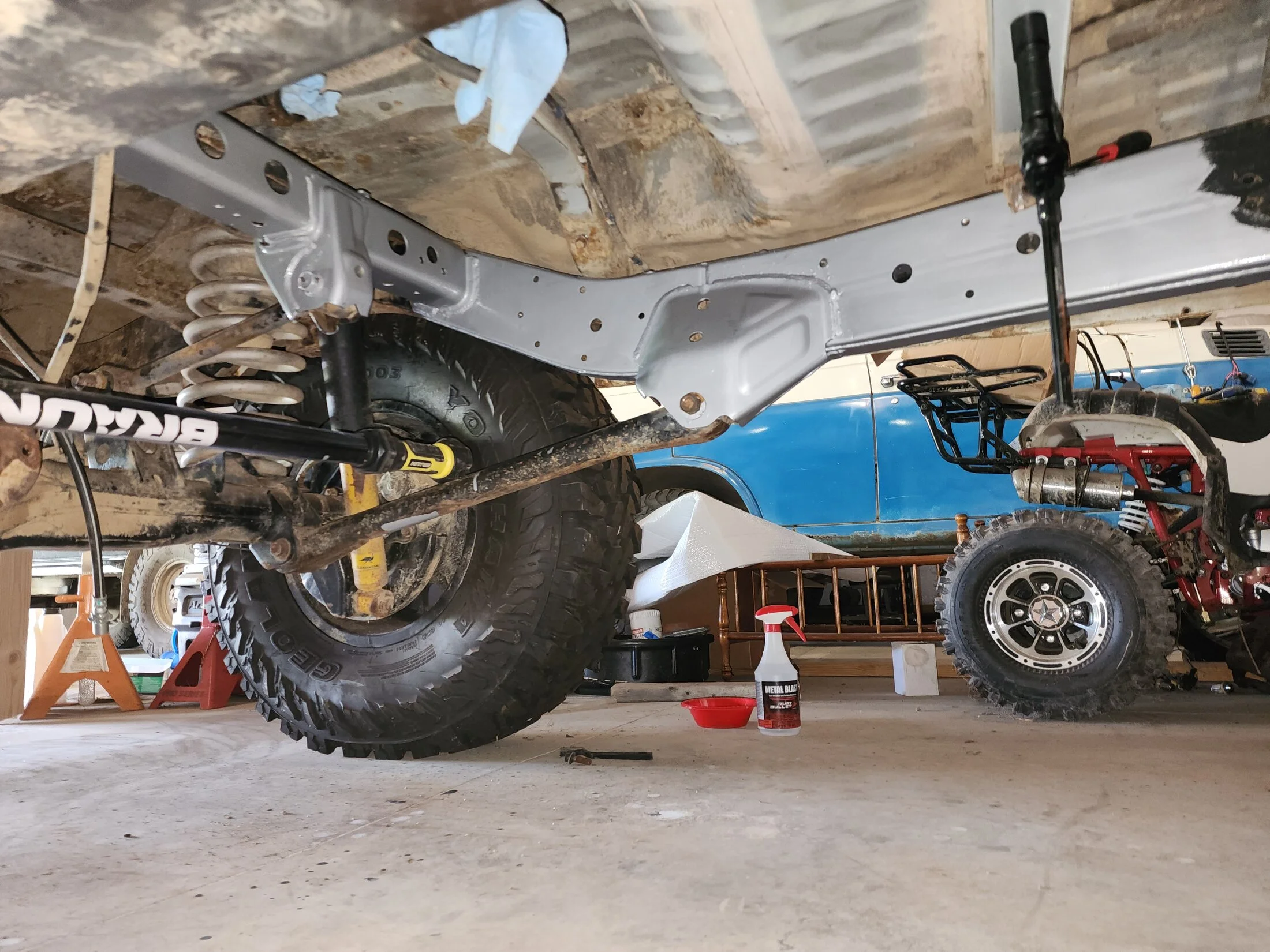

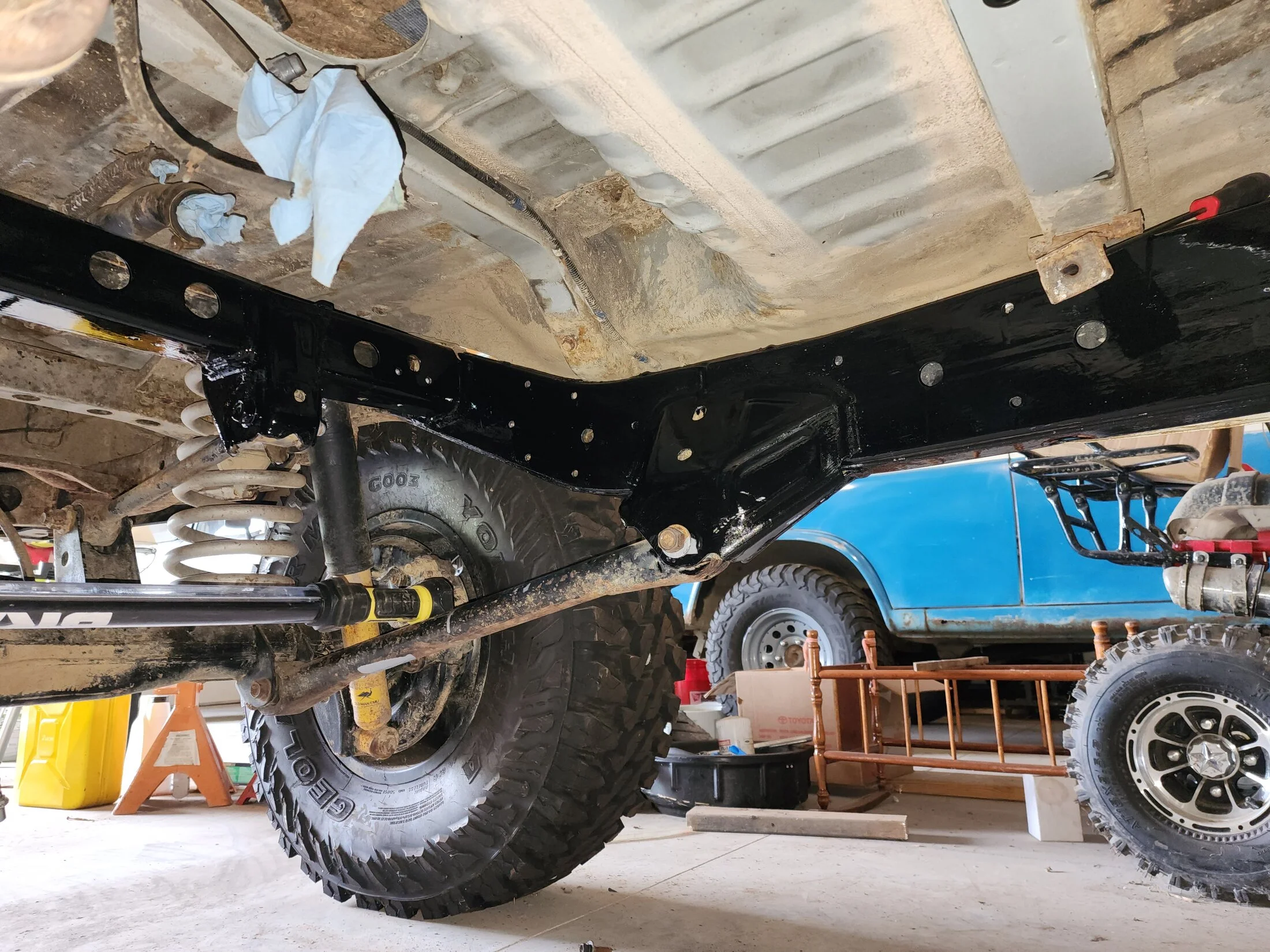

So let's go back a few months and I spent a lot of quality time cleaning the frame up. After a recommendation from @Hugh Heifer I ordered up some rust bullet.
Cleaned and prepped and first coat on.
The kit I ordered had a gloss black top coats so I waited the allotted time and put on a coat of that.

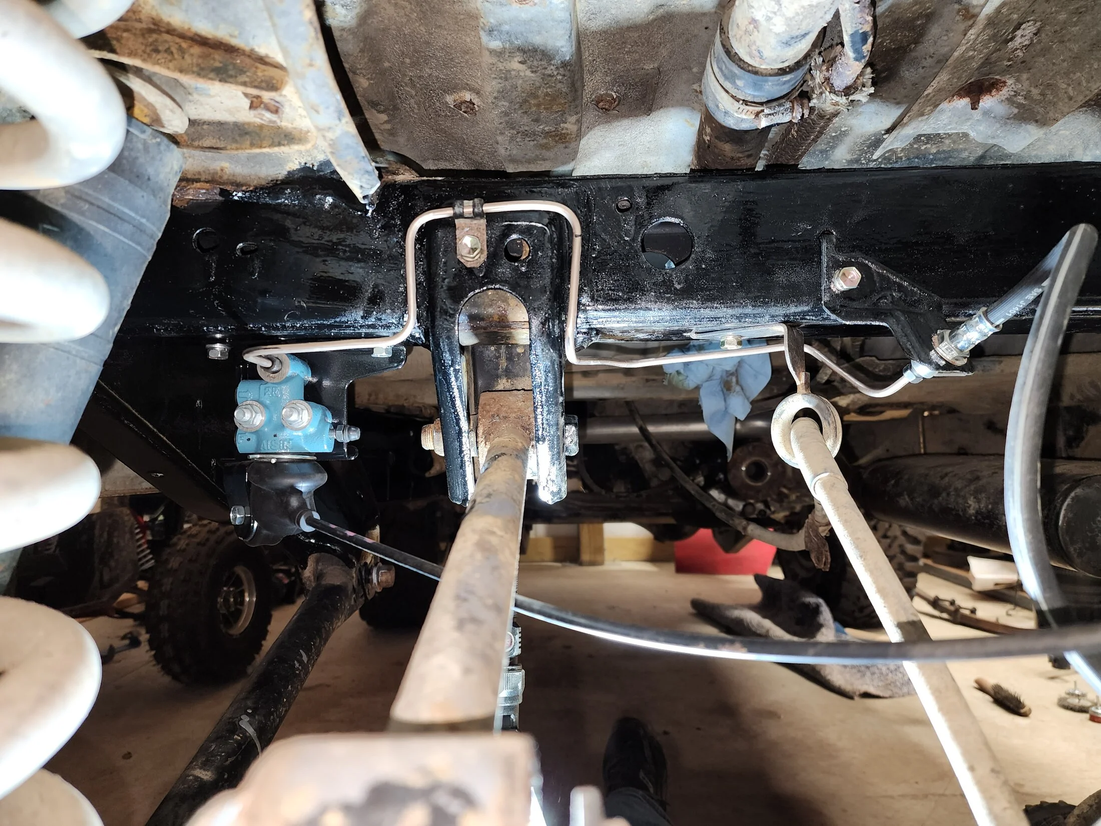

And then once that dried I had to order some new clips and then I bent up all new hard line for the rear circuit along with installing a new lspv.

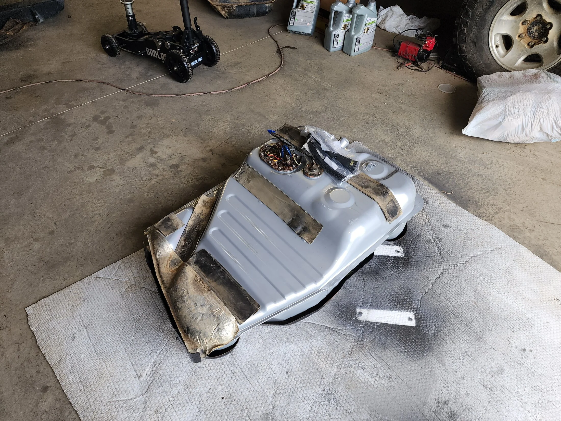

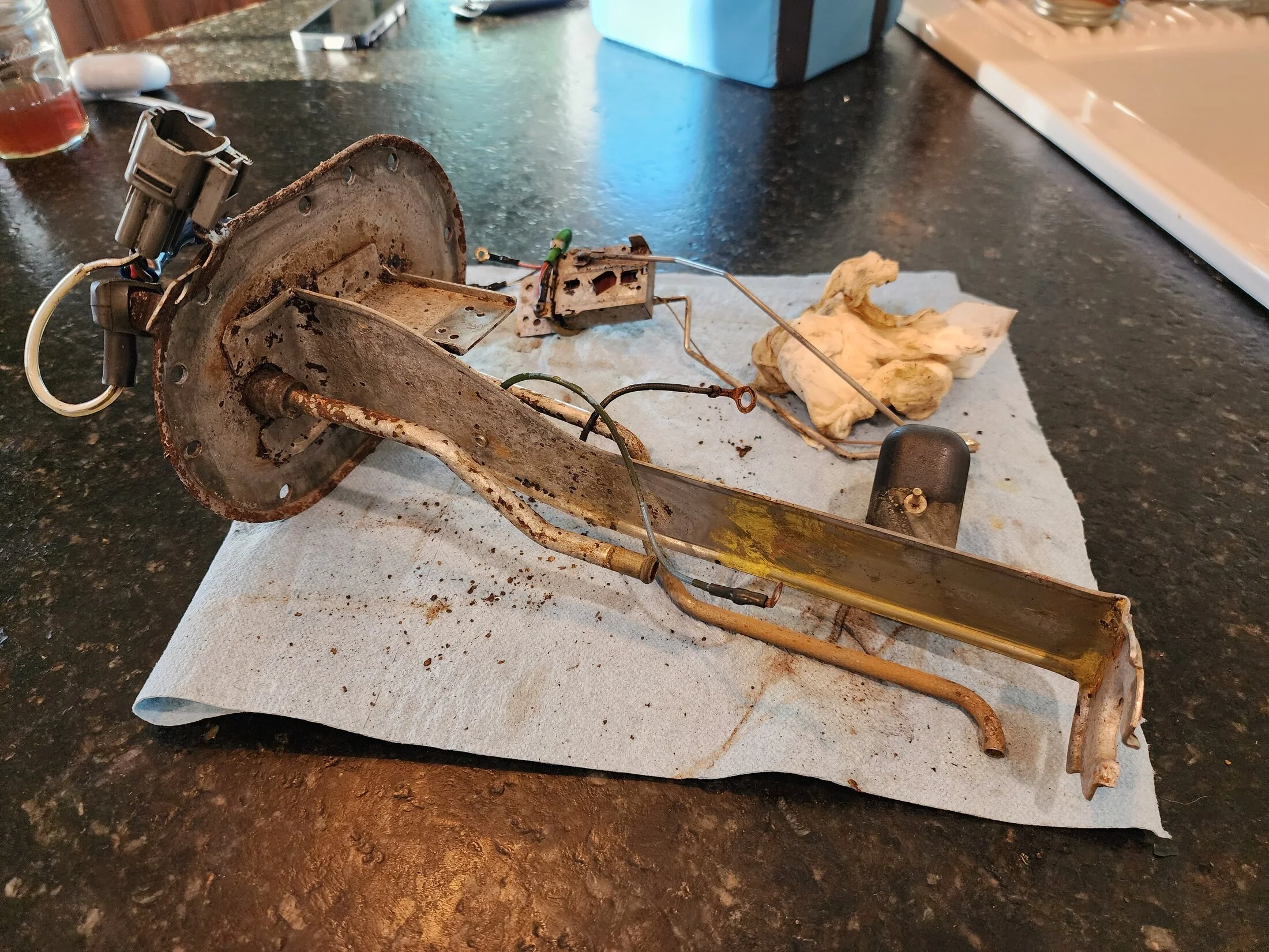

Once I had all that sorted I figured I get onto what I thought was gonna be the easy part, replacing the fuel pump.

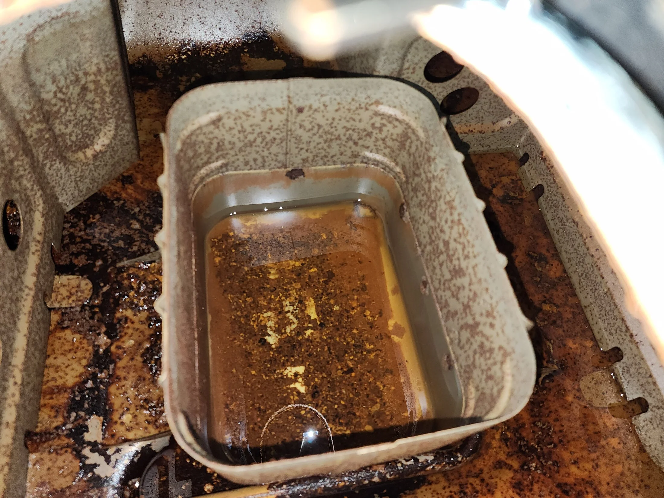

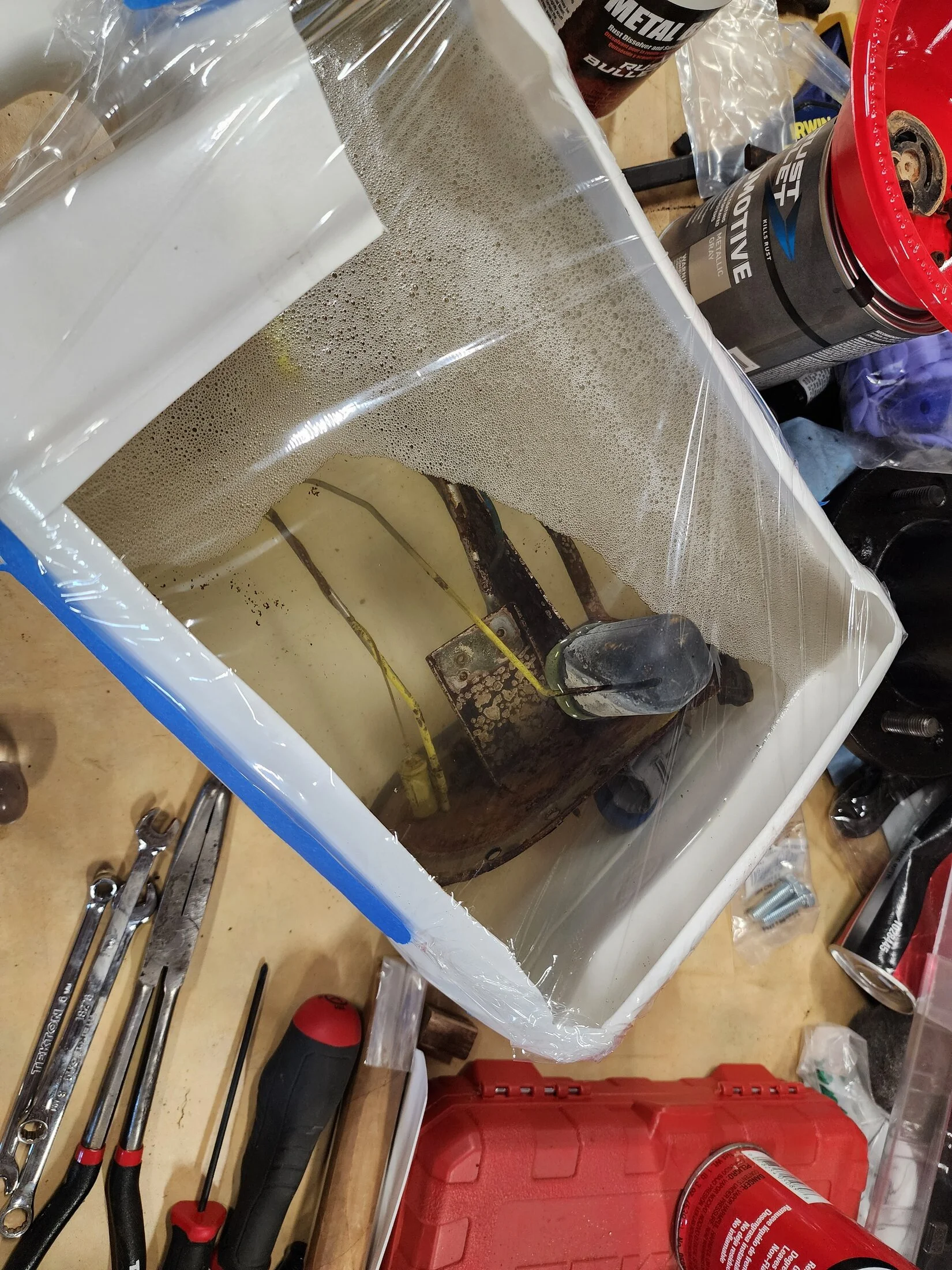

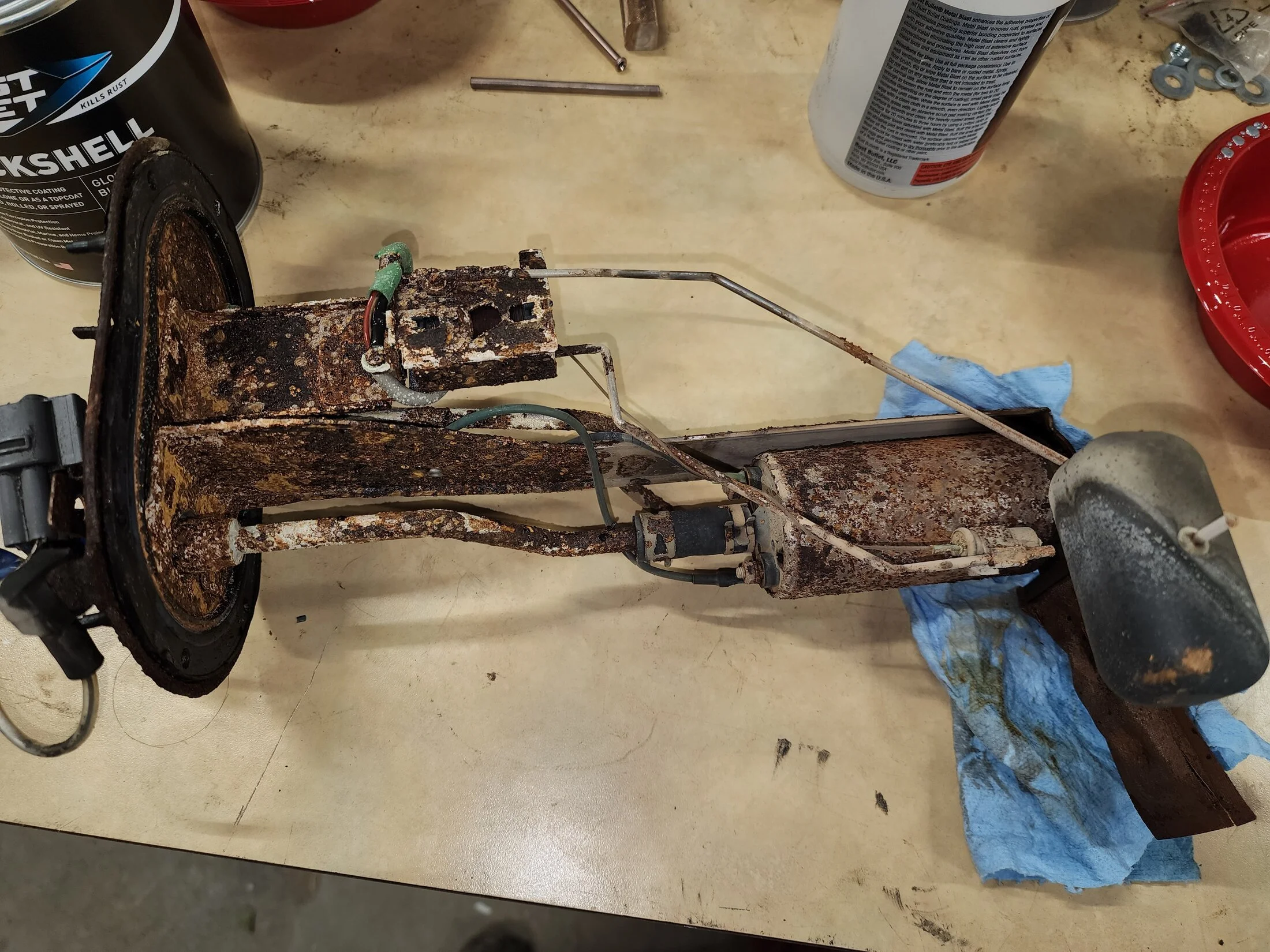

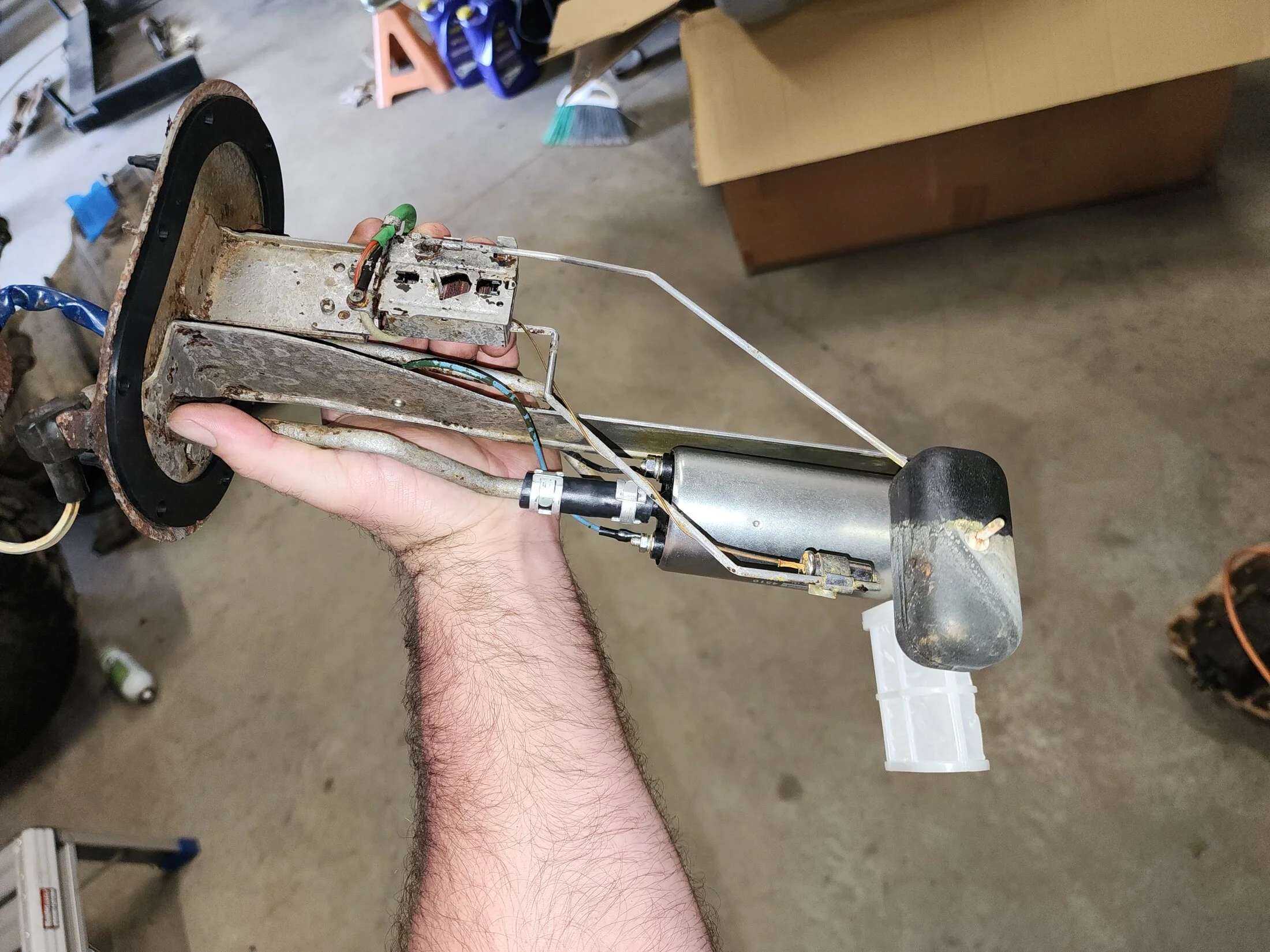

Catching up. So after I got the brake lines sorted I pulled the pump out of the tank and found this...
And inside the tank
Now the truck had always started and ran with no issue and I had zero idea that this was what was awaiting me. So this caused a bit of panic as I was trying to get ready for a trip to the annual ACC Family Reunion in less than 2 weeks, so after some scrambl8ng and calling around we ordered a new tank from RockAuto and I got a couple gallons of evaporust to try and clean up the pump bracket since it is NLA.
I got to say, I was impressed with how well it worked. 24 hours later
And after a little wire brushing and a new pump:
I was impressed with the results.
Swapped all the rubber bits over and dropped in the pump and it was ready to go back under the truck.
With that, I primed the pump and much to my delight, fired right up on the first turn.

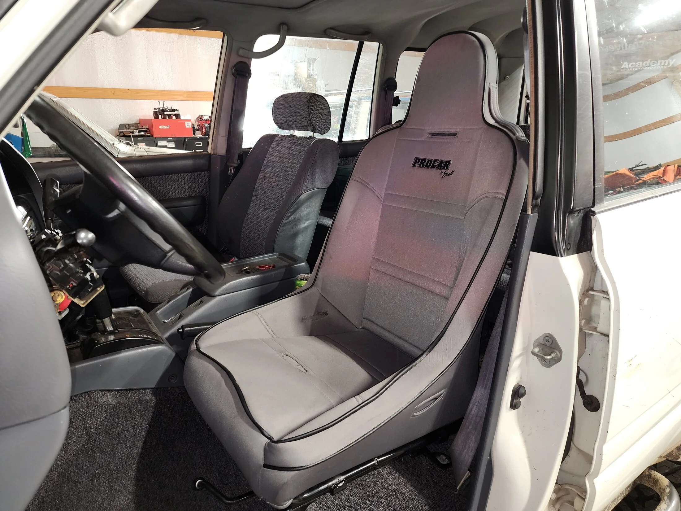

First thing was a new driver seat. The factory seat is wore out. Bottom foam is all but gone, cover is pretty badly worn, so I did some googling and settled on a procar seat. The width is the same as the factory slide. Just had to drill a couple holes and bolted right in.
I did loose the last few clicks on the slide backwards due to the bolt locations, but I don't ride that far back, so no worries for me.

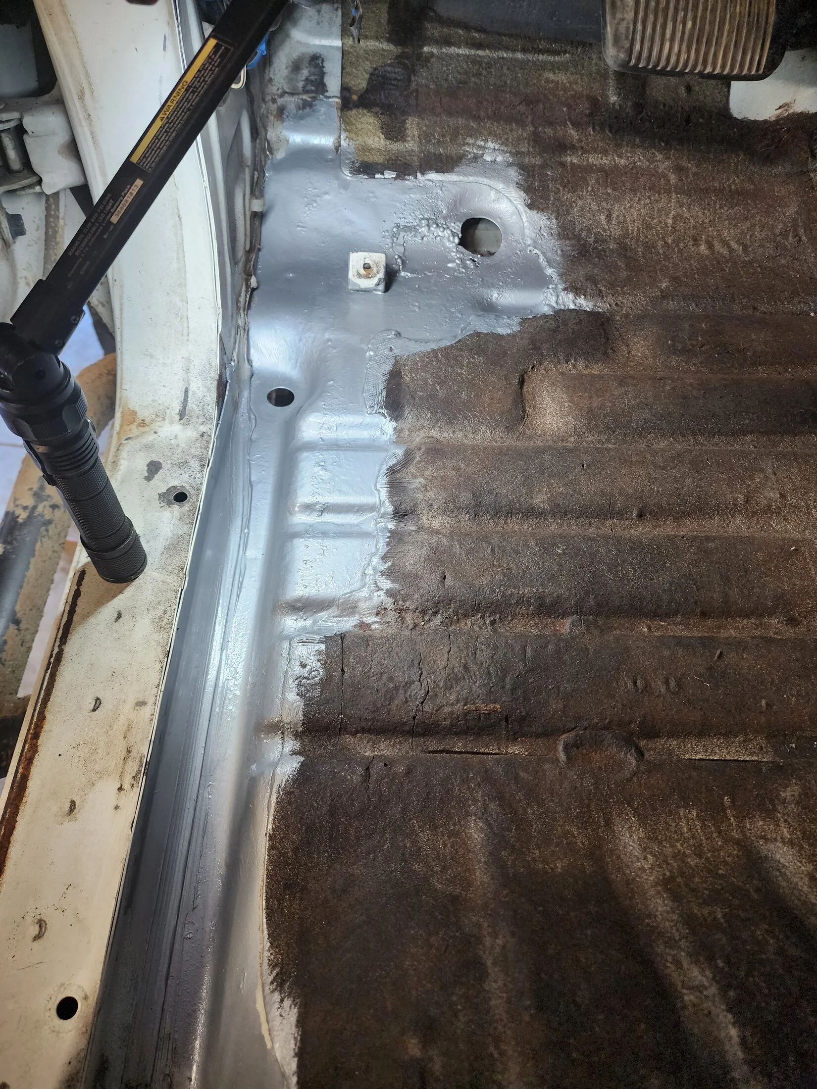

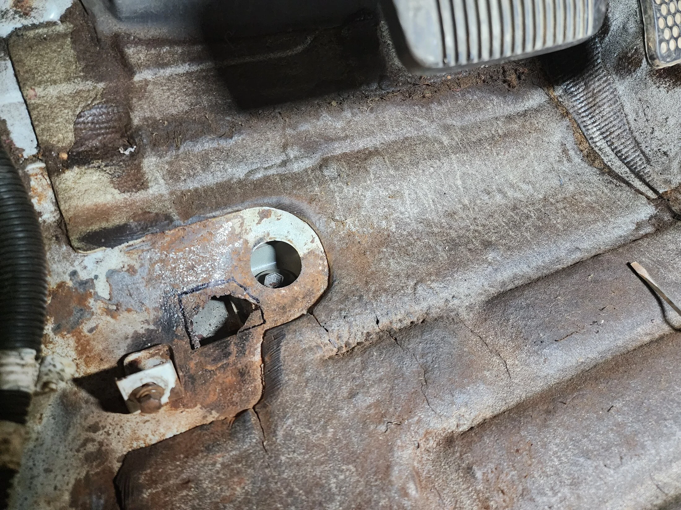

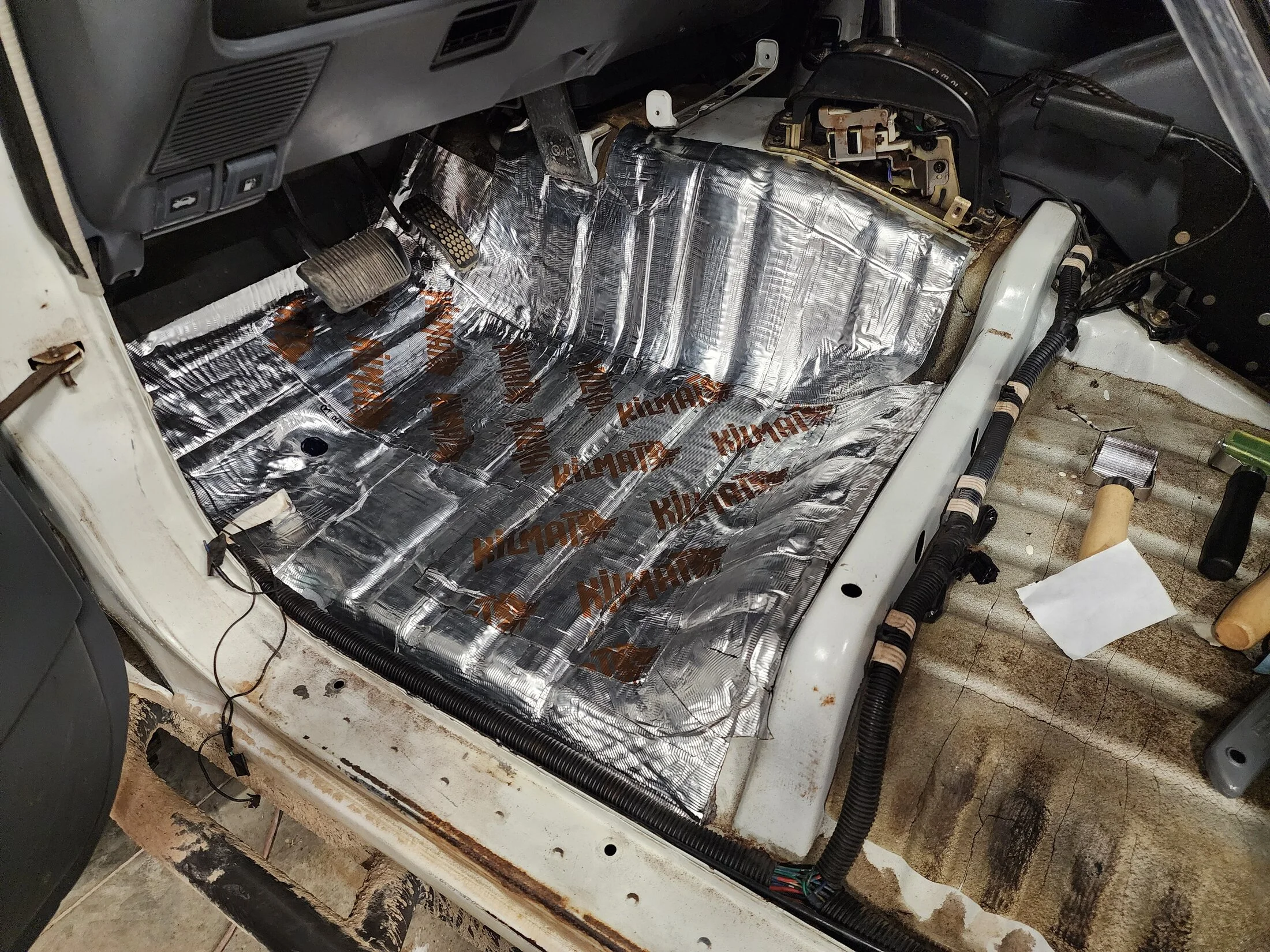

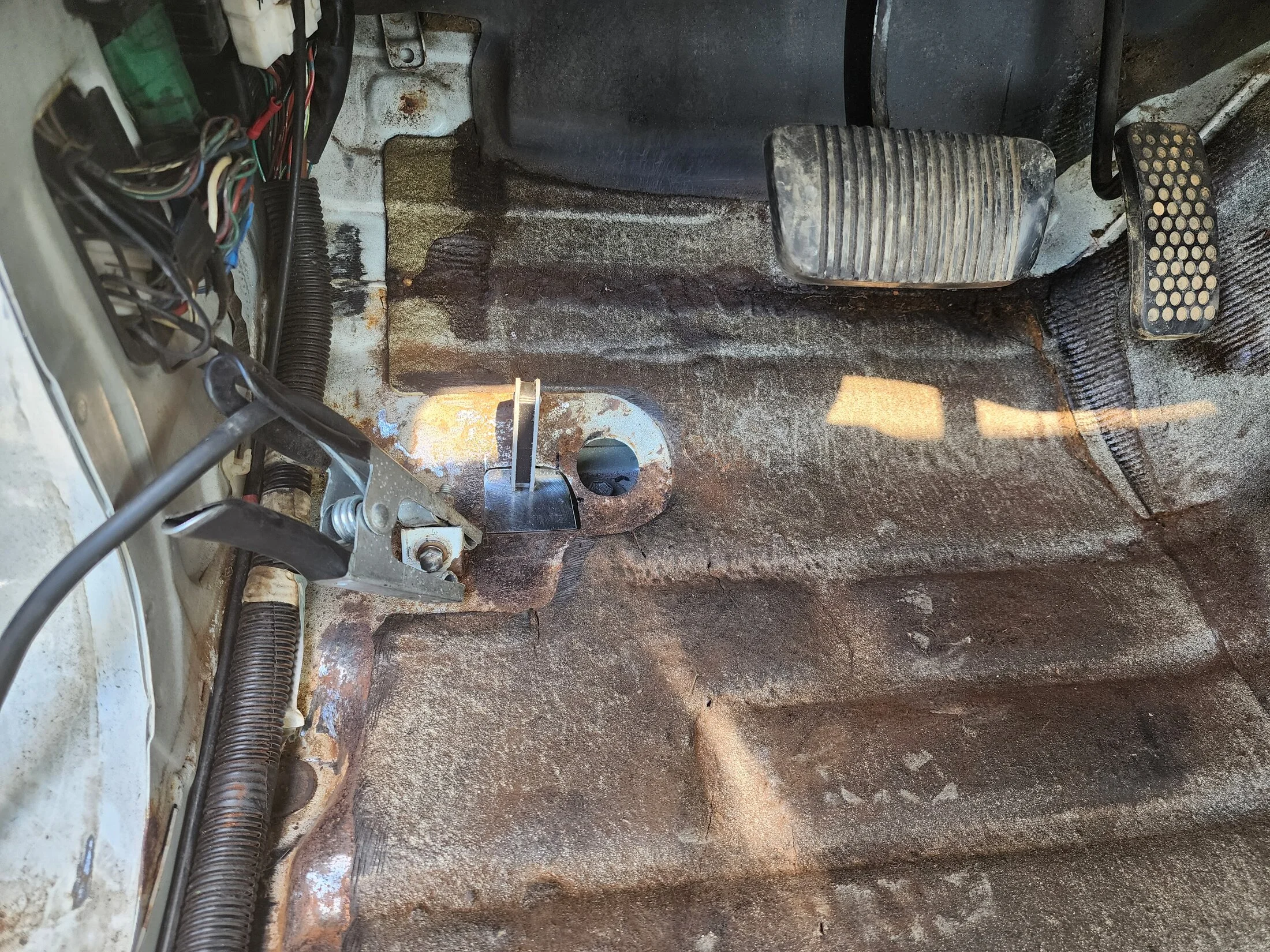

Next I yanked the interior to work in some heat and sound. Drivers side footwell gets very warm since the cats are right under your feet and while doing some prep I found a little trouble.
Cut it out and welded in a patch.

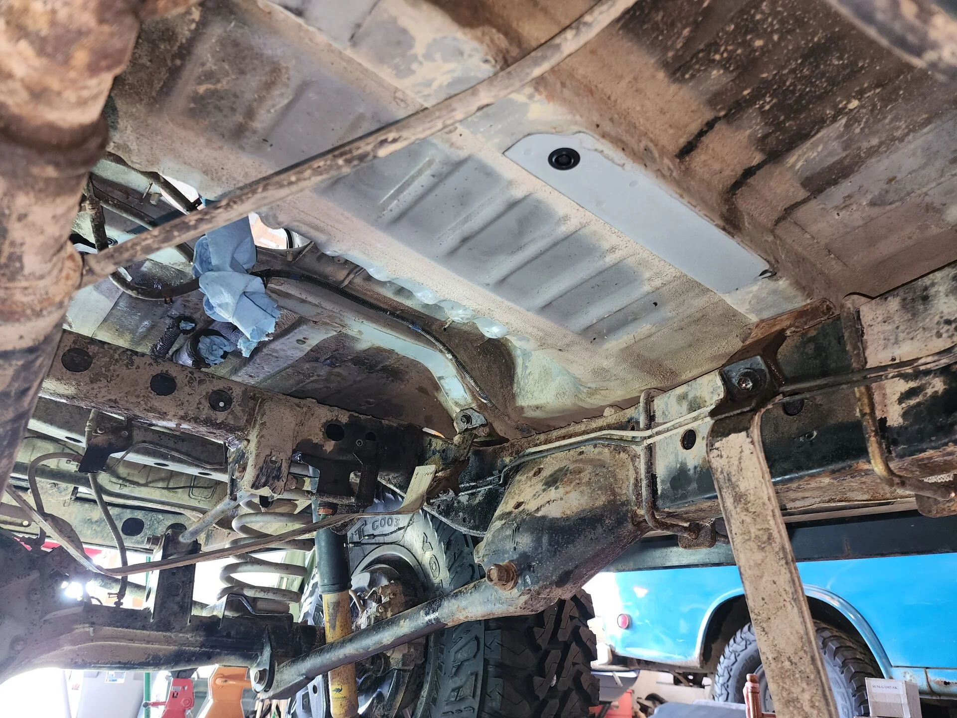

After that I cleaned up the area and hit the Floorplan with some rust bullet.
Then I cleaned up the crusty stuff and put down a layer of peal and seal and some Kilmat

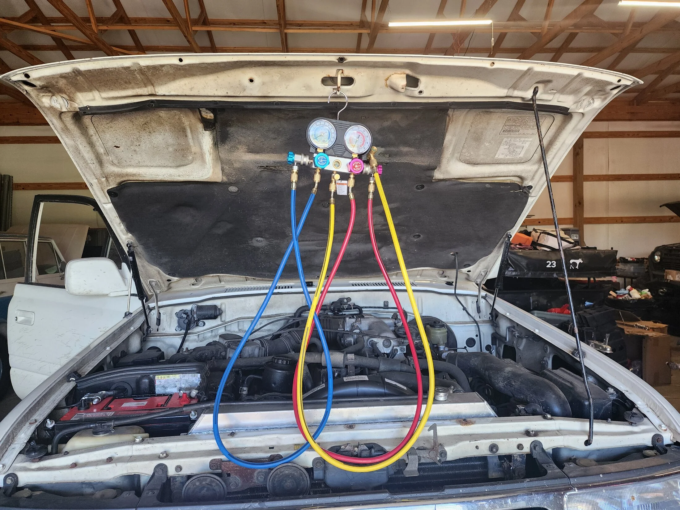

And while all that was going on I started fiddling with the AC. I believe it is low on freon, so tried my hand at checking and adding.
Still trying to sort that all out, but I think im on the right track.
