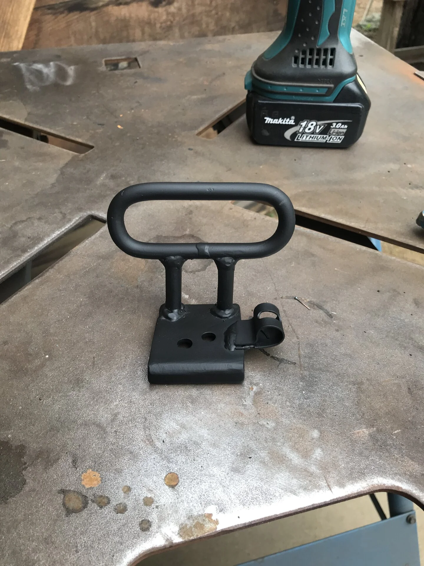

I pulled it off and welded like a mad man this after noon, and added the gussets to the frame braces.
iadkQInkHsgNVwT-r1fbKBHtOO1nHHdDV24R0DaAA8hDAg7miW_M7ojWWoz3LToaPgRJ9KLY2PscdWewPc8p98TaZCm_onu9K1tZ5a2rZK21AltH2u3Ek-_6182kT6hw7wKbQtc8V8XndPkYBKb-53If5qfQ9Fr1KxgdQ33mOjXW92-YDTbPl2KU_QBneY6W7Lbm2v2z832v5XlAfXEj08RF85LHdxu6J5KJ9BU4fft3qqtFIM6novMdE0Zw5KgXFDdb5dlObmaaxtF9WVOBGD3w5lYWxQIqOcrOzx9IfYIElWXXPXM4q1siiCAUE8BTXBTUzk_zyozGKxnRSQE3QvkdHNZHrfmGWS9bM3u8Zv1sxR9e6MUt8bkiEFVQEEAoTHuiWPGF6cUF3DSxk03waYdiMPuHUoD9-9oRc-kGlsfwQtHylsQXOZO6Ip-z9izvdbvFfwvWkpz6OSZ_g64NjMU2CWHcIYbA84zPxgDvfRSdUpBLumn3md0S4R7Wqi110Yklyl3Xby27WXMd0dwub8D67EoHgMd_WzIPjdigK0YrjekDULNowoRgcok487WOwy2O10ke7FJKF1JW1qe3G1k_2QW7ZgP0jYzVtALow2cj3hUiLuBLVzfhgsxyUOZd4757WQ5wGNPYmkE6GBAyqy5CFy7rFPdCn4fKeILpgLLx5ZzIfvyy7Chu7BL3LzDA5Czr9ygUQ02ql_CkPmCtdea_m8CoIqbGq-SWeSpgDIkWxUGOx2FOFe40qX2kMyaexgBT9vzBPpgLhqhojl_7YKGXVLhYpI3zzlUu3penqD2w4q0OwzIPMrPz_gm3PXViaXKlrsg1eun376f0fNveagN7IpzAAcvLxG3yJgJZjaJi83Di3BkOGXXoMTKP0Ze_JG07lbNFE35ScHXDqg5XWMBSLYS84RTE_35JshcSOBD_pDGqcw=w1252-h939-s-no
The old brace had a smaller plate no gusset and was 1.5" tube

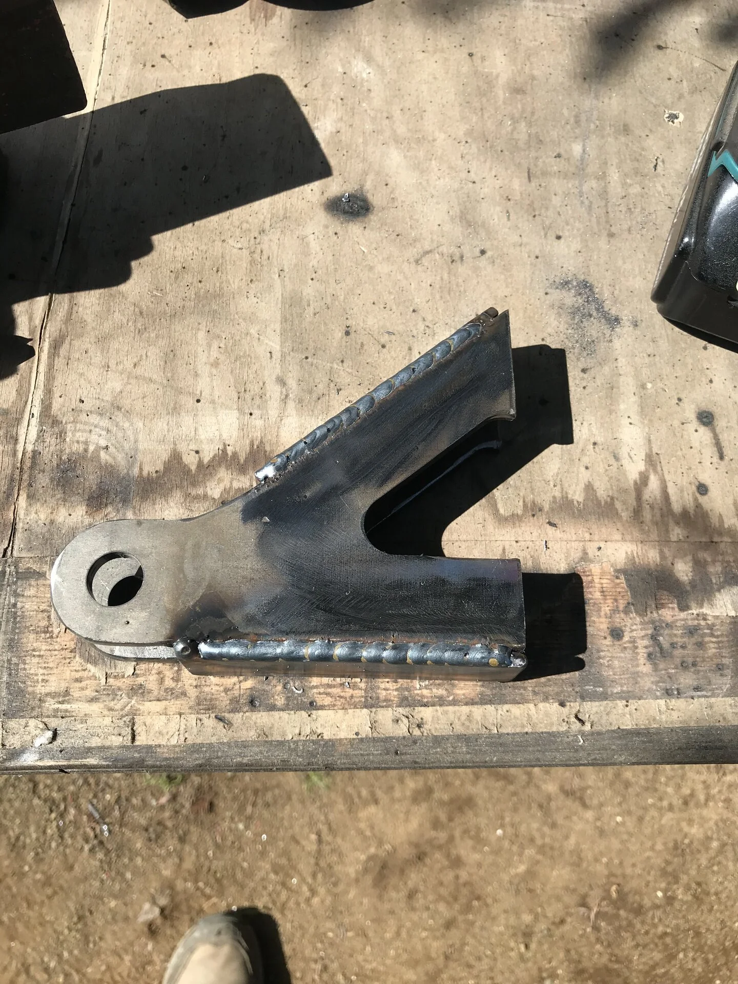

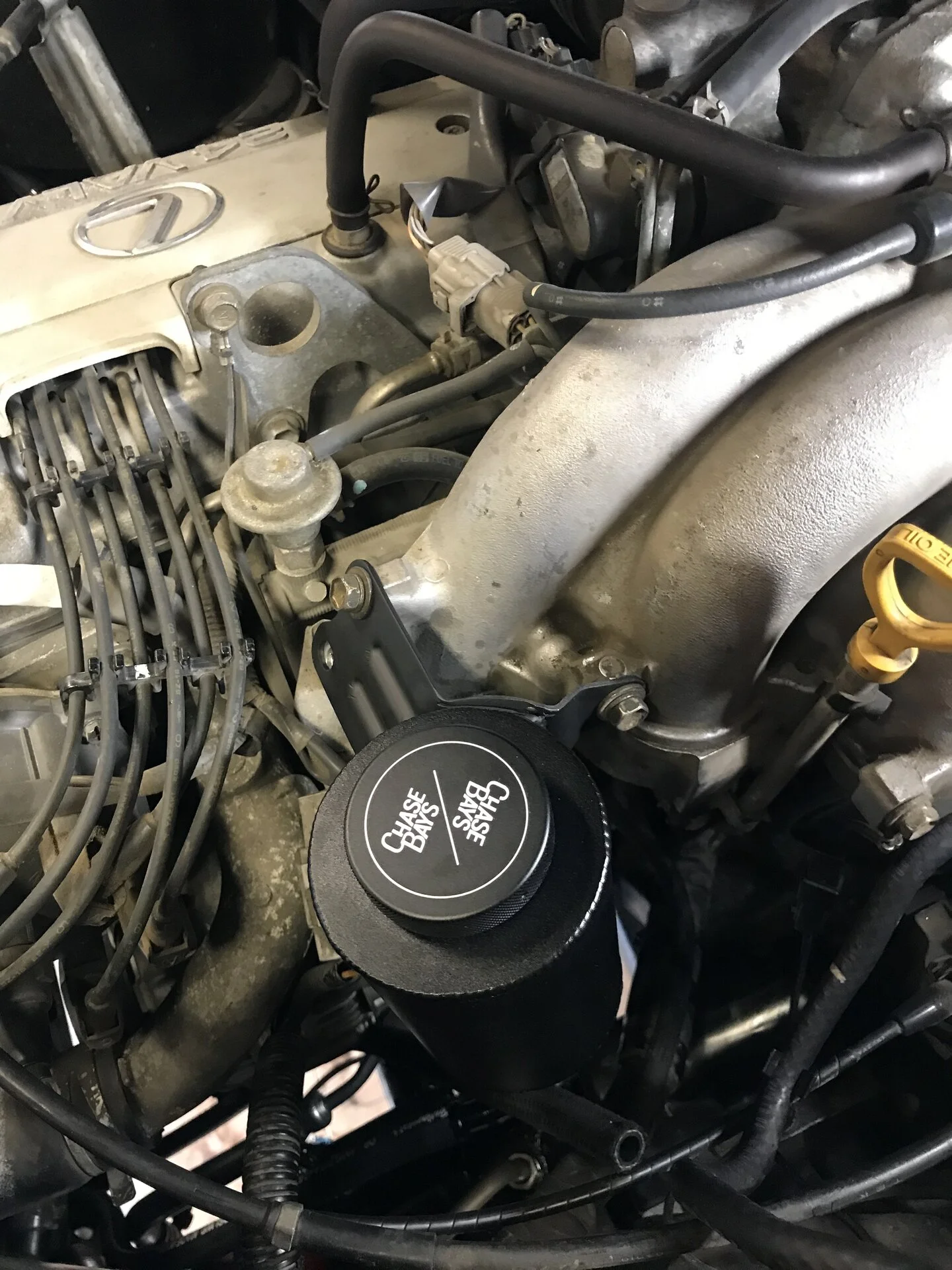

My friend Ron @Road Apple came down last weekend and we did a complete make over on his steering System.

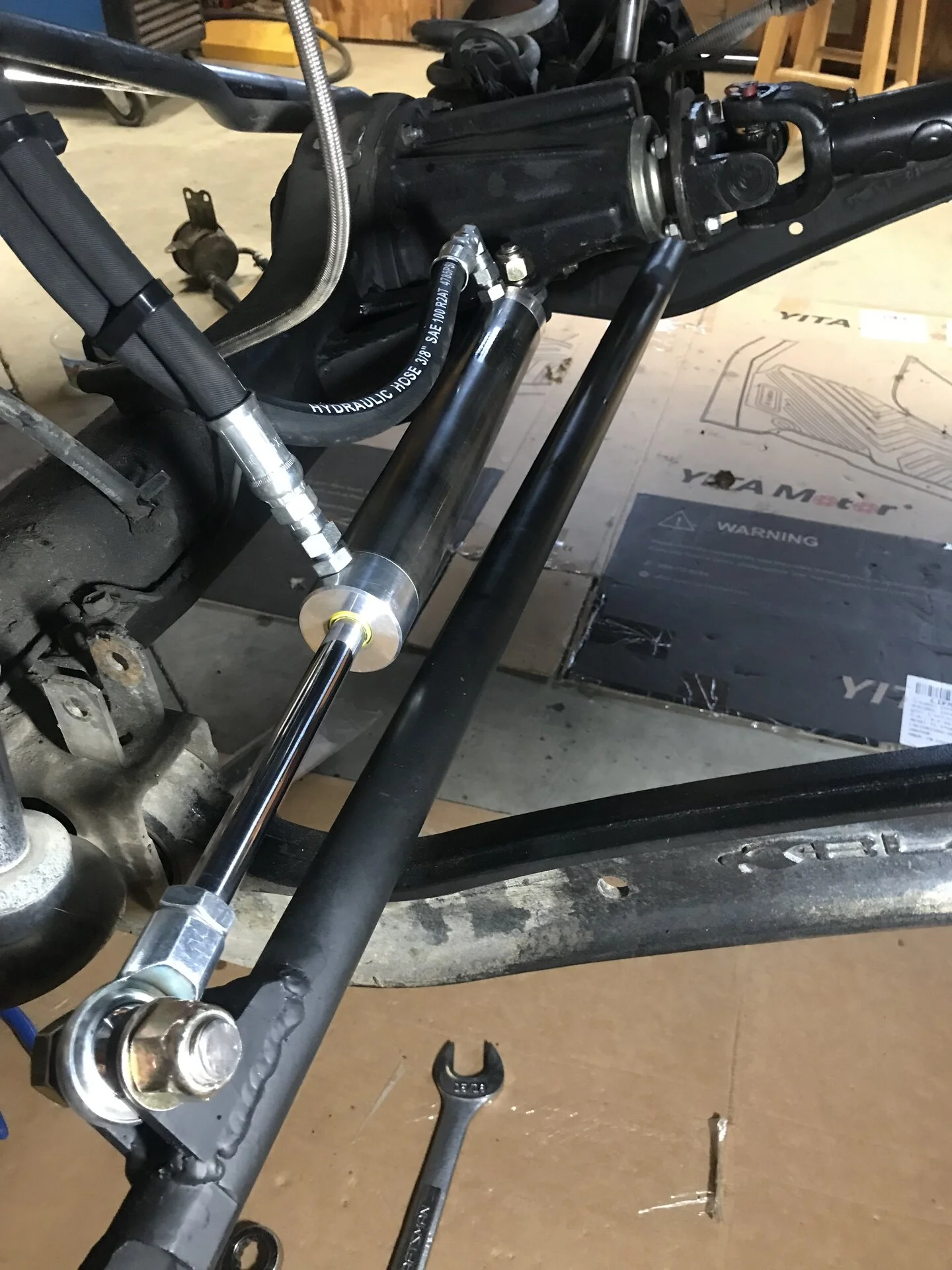

Including hydro assist, newly rebuilt RedHead steering box with a 105 kit, Chase Bay reservoir, 10” ram from RedNeck Ram, Witt’s Ends cooler and all new hoses.

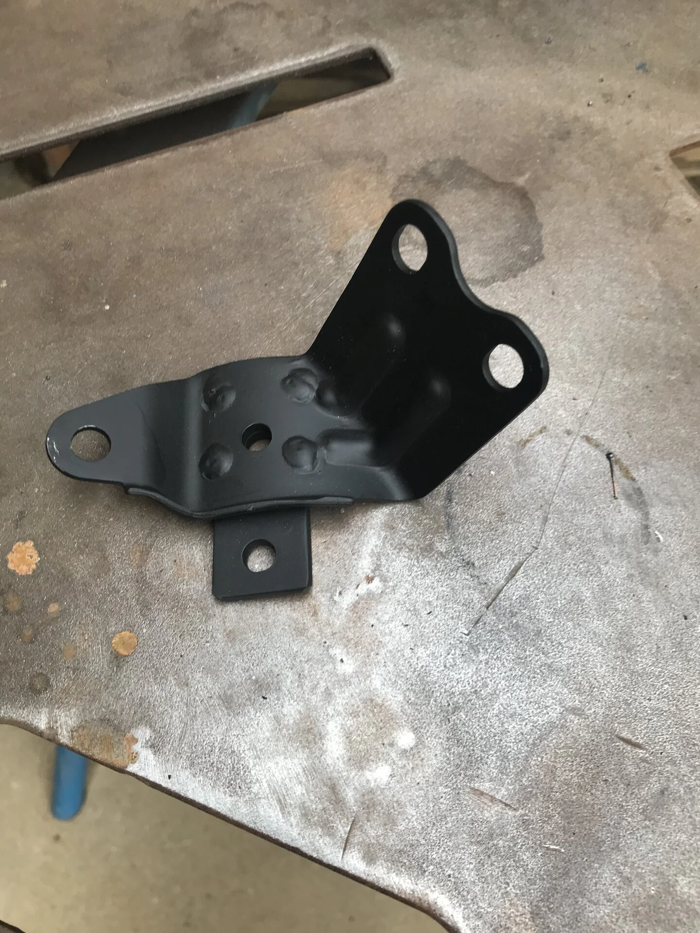

We made the reservoir mount utilizing the mount off the OEM reservoir.

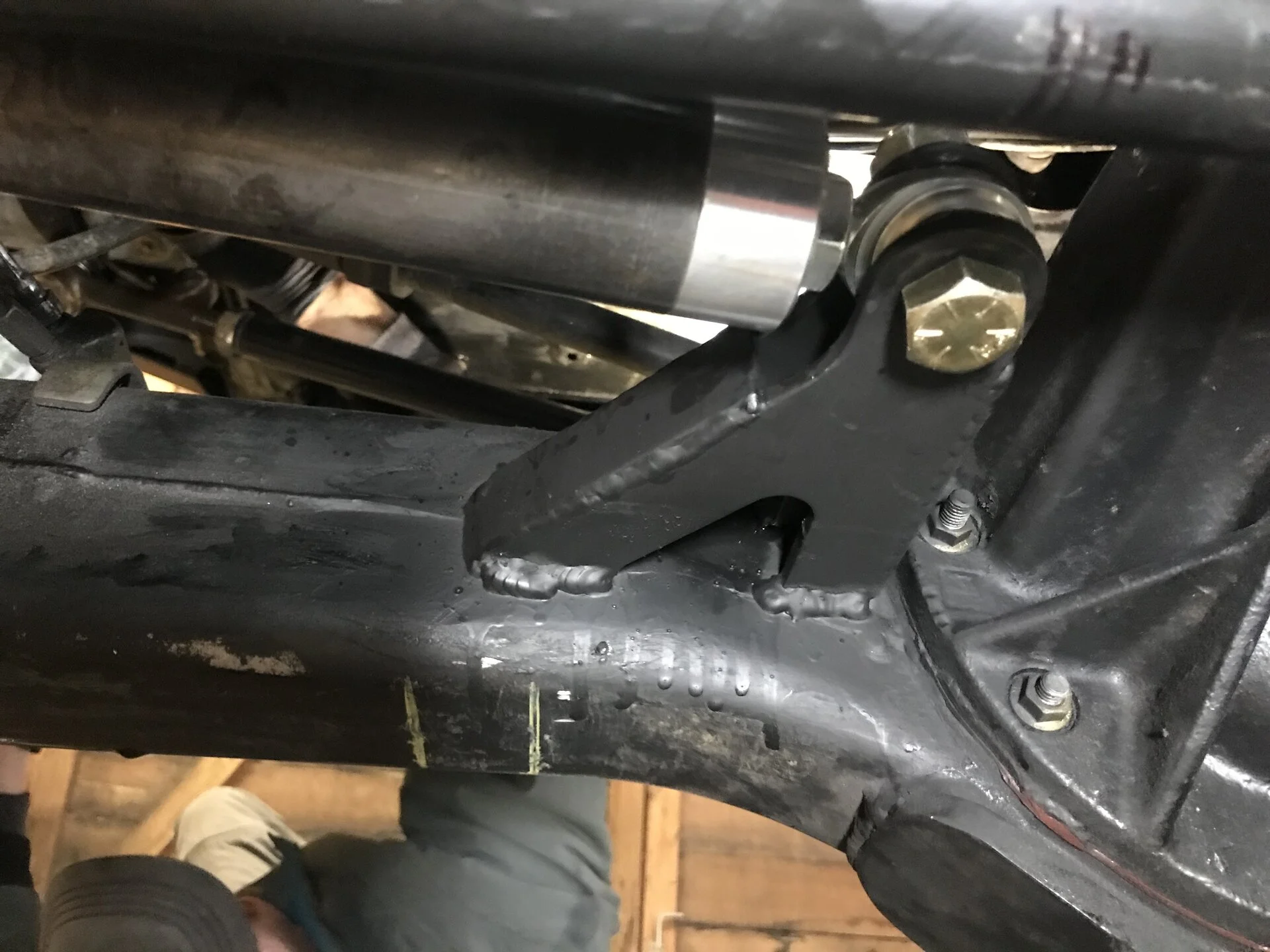

Modify the ram mount
And welded it to the axle.
Tabs were modified and welded to the tie rod.

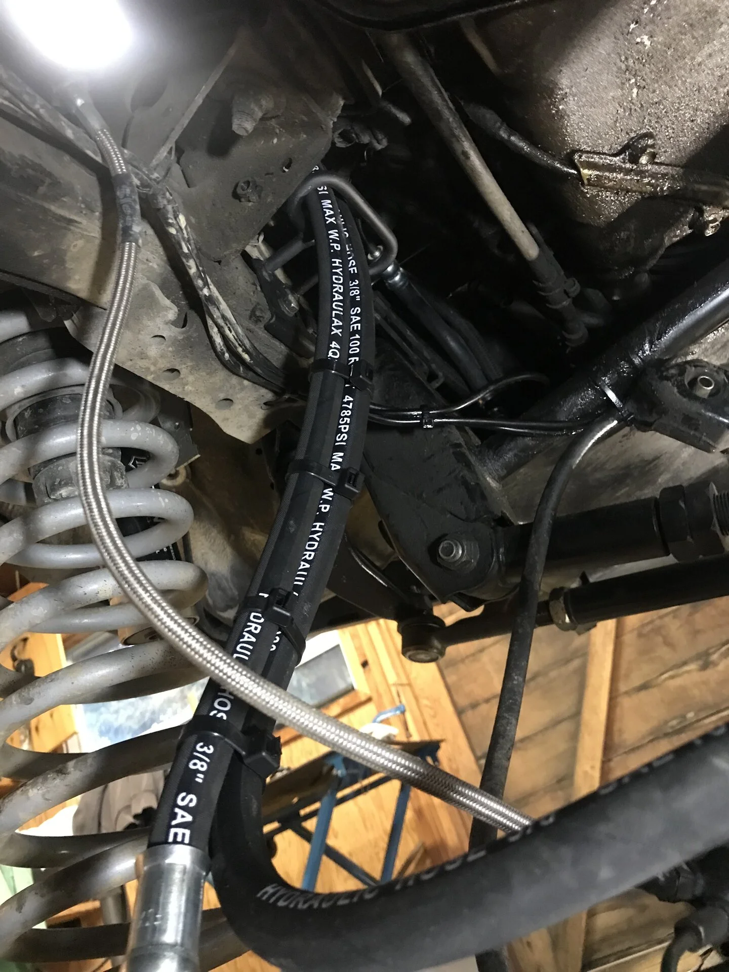

Made this to keep the hoses contained and away from the motor.

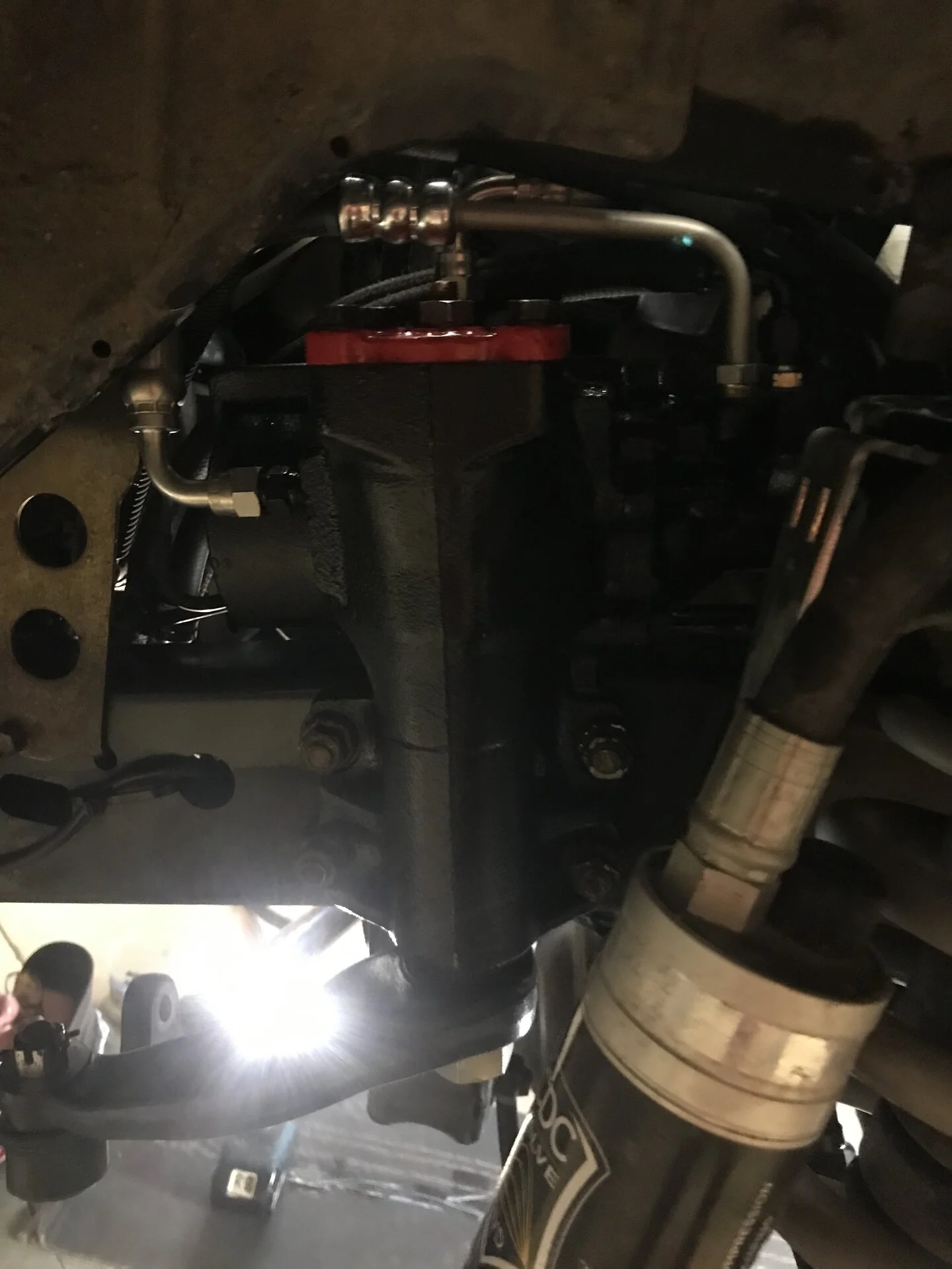

Installed the new steering box, oil cooler and all the new holes

Ram size?
1.5”x10”
We adjusted the steering stops to have a full 5” of stroke each way. 🤨
Careful checking the truck had 4 13/16” each way or a total of 9 5/8” stroke same as my Rig and a few other I have checked.
Others have shimmed the ram down to the 9 5/8”
When I set mine up years ago I used a
1.50x9” ram based what I read here and what RedNeck Ram recommended losing 5/16” of stroke each way.
Over the years this has really bothered me and I well be changing it out of a 10” Ram I have setting on the shelf along with a 105 kit and a bigger cooler.
This won’t happen until after Cruise Moab.
I plan to open the stroke to the full 10” same as we did to Ron’s
I wouldn’t recommend this unless your running RCV shaft’s which we both are.
