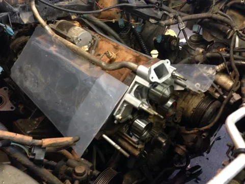

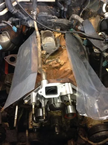

Aside from the broken timing belt there appears to be no further damage at this time. Heads look good and the belt broke due to timing tensioner failure... Tensioner failed most likely due to my own fault of wheeling the crap out of the Cruiser for many years. Here's a few engine bay shots after heads were pulled (showroom condition right?! - haha)...

Tensioner failed most likely due to my own fault of wheeling the **** out of the Cruiser for many years.
Not likely. If that were the case then every gasser middle east and OZ LC would have broken belts. Heck, Nick would have gone through three broken belts by now! Engine load shouldn't affect the belt life. Or do you mean prolonged water exposure? Any chance your cover plate was left off on a previous t-belt job?
And by 'tensioner failed' do you mean it developed slop or that it over-tightened? Trying to figure out how it could be the latter?
Lastly, we have two cases now where a broken belt had no collateral damage. How sure are we that this is an interference motor?
