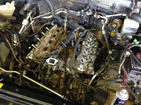

Here's a couple more pictures with heads back on. I think I forgot to mention the head gaskets did blow on both sides after belt broke but they would've been replaced anyway.
I normally replace as much as possible when tearing this deep into a project. I really thought the tensioner was done at the time the first timing belt was done but it was not after further investigation.

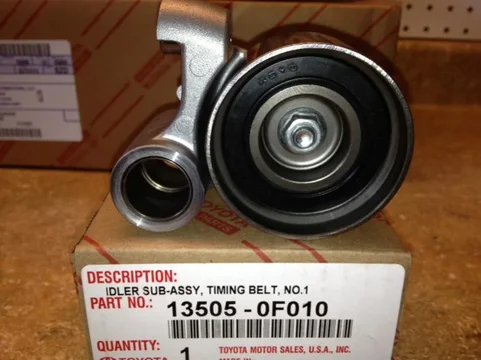

The TB tensioner is a spring device, not hydraulic, or at least it was for the '99 model year.
Interesting that the two cases of TB failure resulted in no collateral damage consistent with interference valve geometry.
Jgray: Notice that the cams and valve trains were removed from the heads. Did you have the heads skimmed, or other head work done?
It's hydraulically dampened internally. Prevents the spring from picking up harmonics and creating a wave in the belt. This is why you have to slowly compress the plunger, avoids blowing the seals.
Good point. Had the thing in my hands and didn't realize that. Thanks.
For those who don't do their own work, this is what they look like and where they're installed.

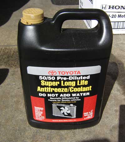

Are you flushing with distilled and then filling with SLLC? The current stuff at the dealer is pre-mixed.
I flush with 3 gal Distilled, then mix 100% red with distilled 50/50. I look for -34f IIRC.
Are you using this
or this?
My dealer doesn't even carry the LLC any more. And its too expensive to ship. Too bad because it would be more economical to mix in the field as you do. IIRC $25/gal for the SLCC and it takes 4 gals to get a complete drain/refill.
Those coolants are NOT interchangeable.
