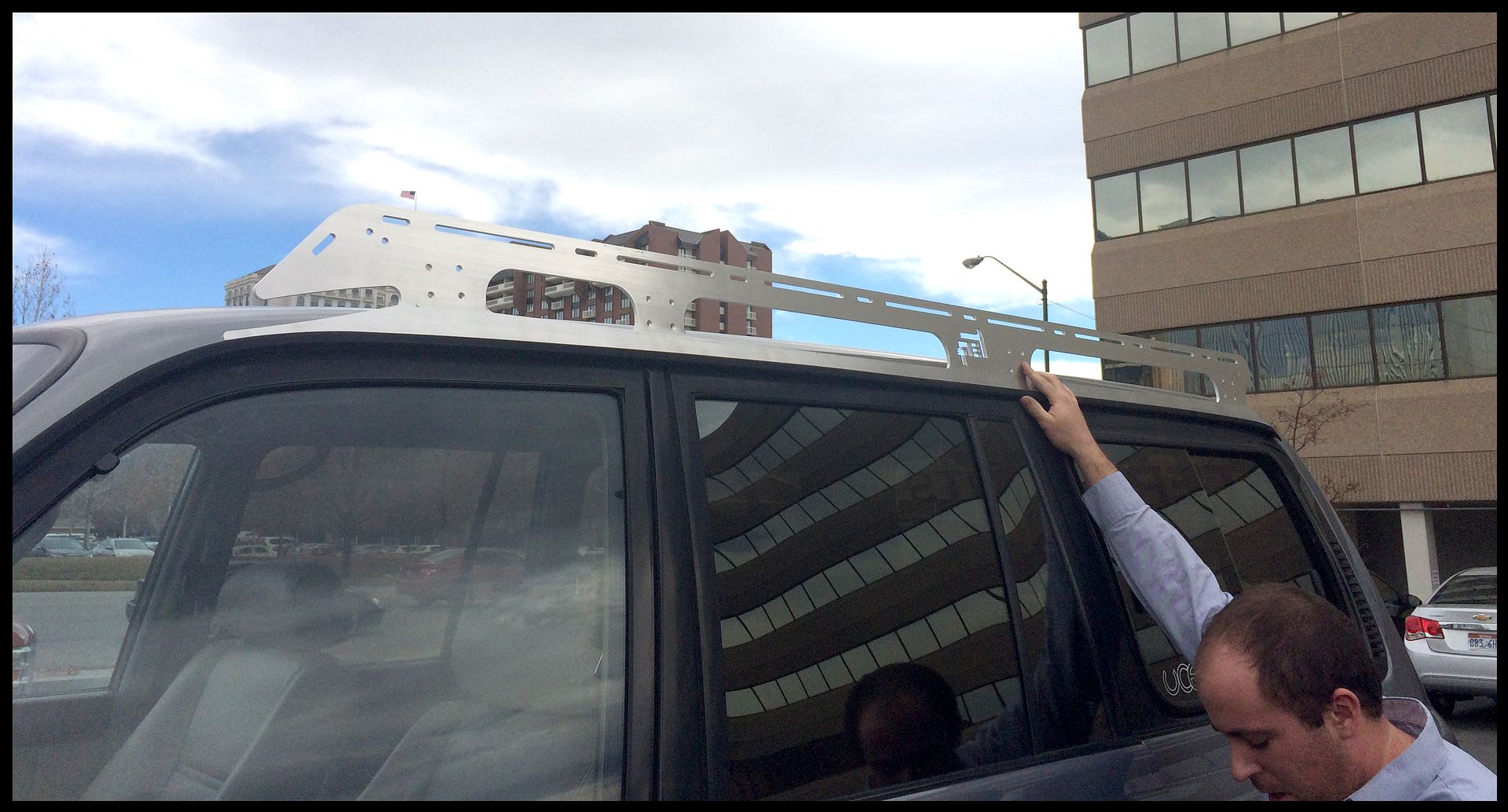

Yeah, I'm very anxious to get the finished rack. I'll share lots of detailed images when I get it. I really think it's going to be a fantastic option for 80 series owners that need a rack.
Any update on this rack - pictures, price, powder coating etc? I am a fan and in the market for a minimalist rack.....
No update. Just waiting on a couple of the brackets to be machined. Hopefully have it in a couple weeks or sooner.

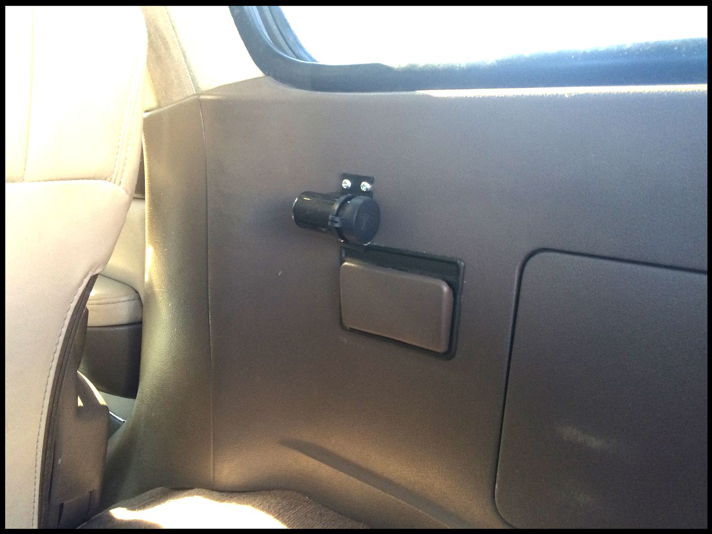

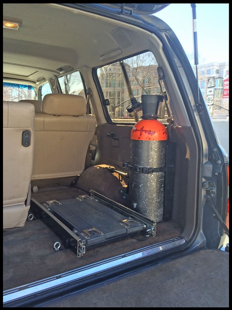

I've needed to get my fridge, CO2 and Aux power sorted out a bit. I got my fridge slide mounted in the rear cargo area last night along with my CO2 tank. I added some bracing behind the plastic panel and the bracket is bolted to that so it's nice and solid. Also fed a simply 12V plug to that panel just behind the middle row so I can plug the fridge in. Nothing fancy but it will work.
If you get a chance, more pics of the CO2 mount. I've been juggling how to mount mine just like that.
Without pulling it all apart it's hard to really show much. Behind the interior panel is a speaker that is attached to a sheetmetal bracket. I bolted a couple small metal straps to the forward corner of the bracket just to stiffen it up a little and drilled two holes in that sheetmetal. I have two bolts through the CO2 bracket into that one behind the interior panel and then I put one through the floor to hold the bottom of the tank bracket. It's very rigid the way I've got it.
Yea. I modified my stock sub metal bracket for my amp, but its dead and looking to relocate it anyway. Was wondering if you did go through the floor and that answer that. Thanks!

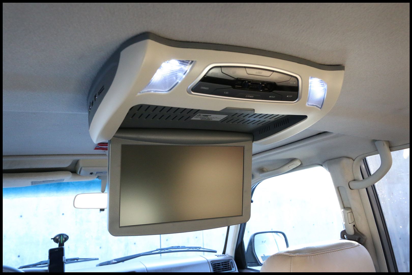

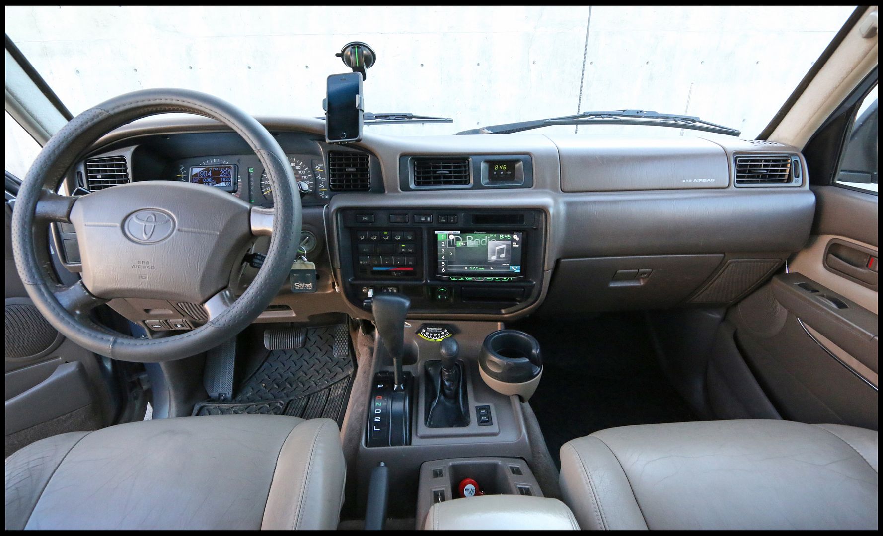

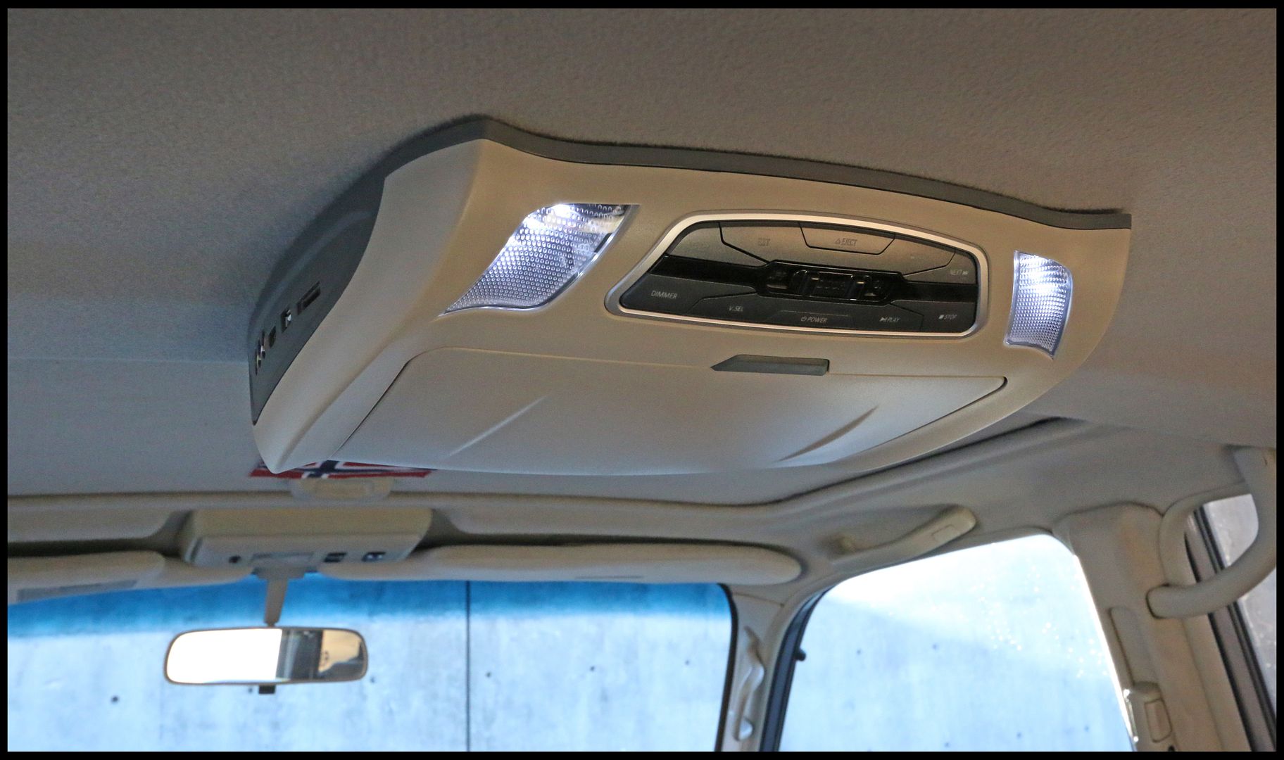

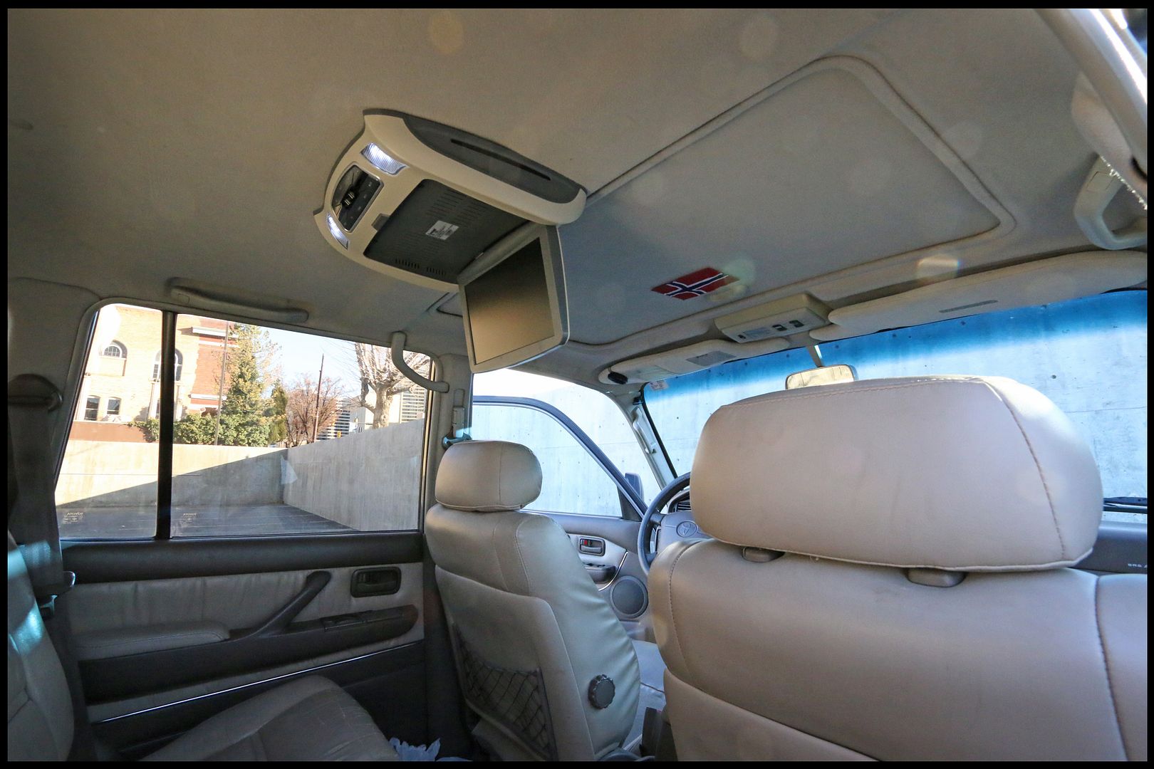

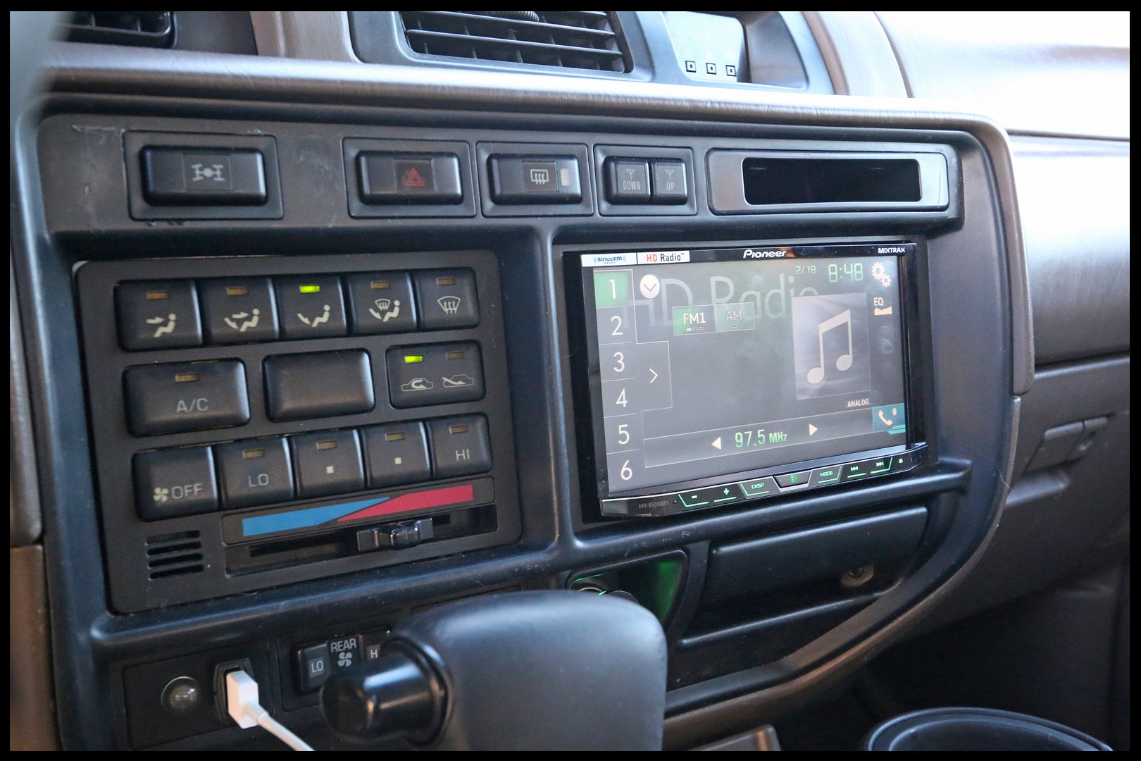

Big props to Ratio AV for some help with interior goodies last night. New Pioneer touchscreen DVD/HD Radio deck in the dash with Bluetooth. As well as a dropdown DVD (10.3" display) with wireless headphones in the back for the kids. The overhead unit is 1080p with SD Card, USB, RCA and HDMI ports. Long trips will be nice moving forward. Pretty pumped about it all and looking forward to trying it out.

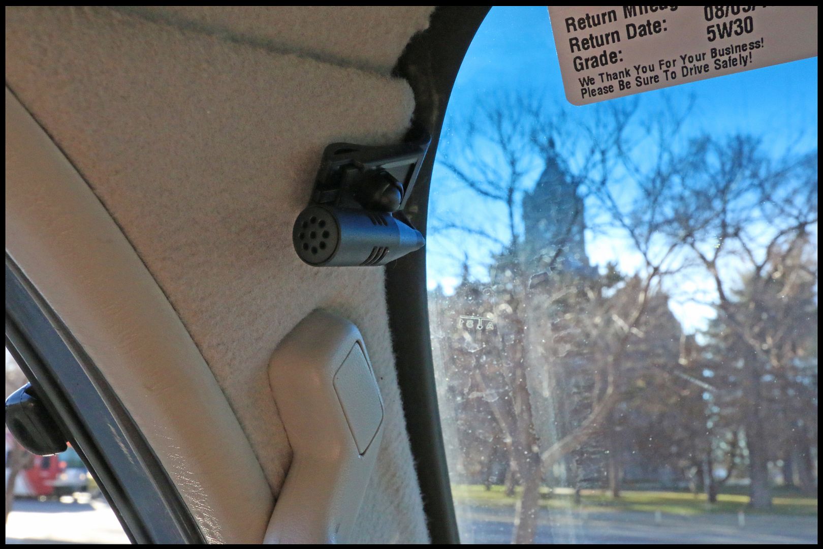

Bluetooth mic on the A-pillar
More info on the USB station with light in your dash! Is that a charging station that lights up when charging?
The light was there as part of an earlier installed security system. The USB was added last night as the USB connection to the new in dash deck.
