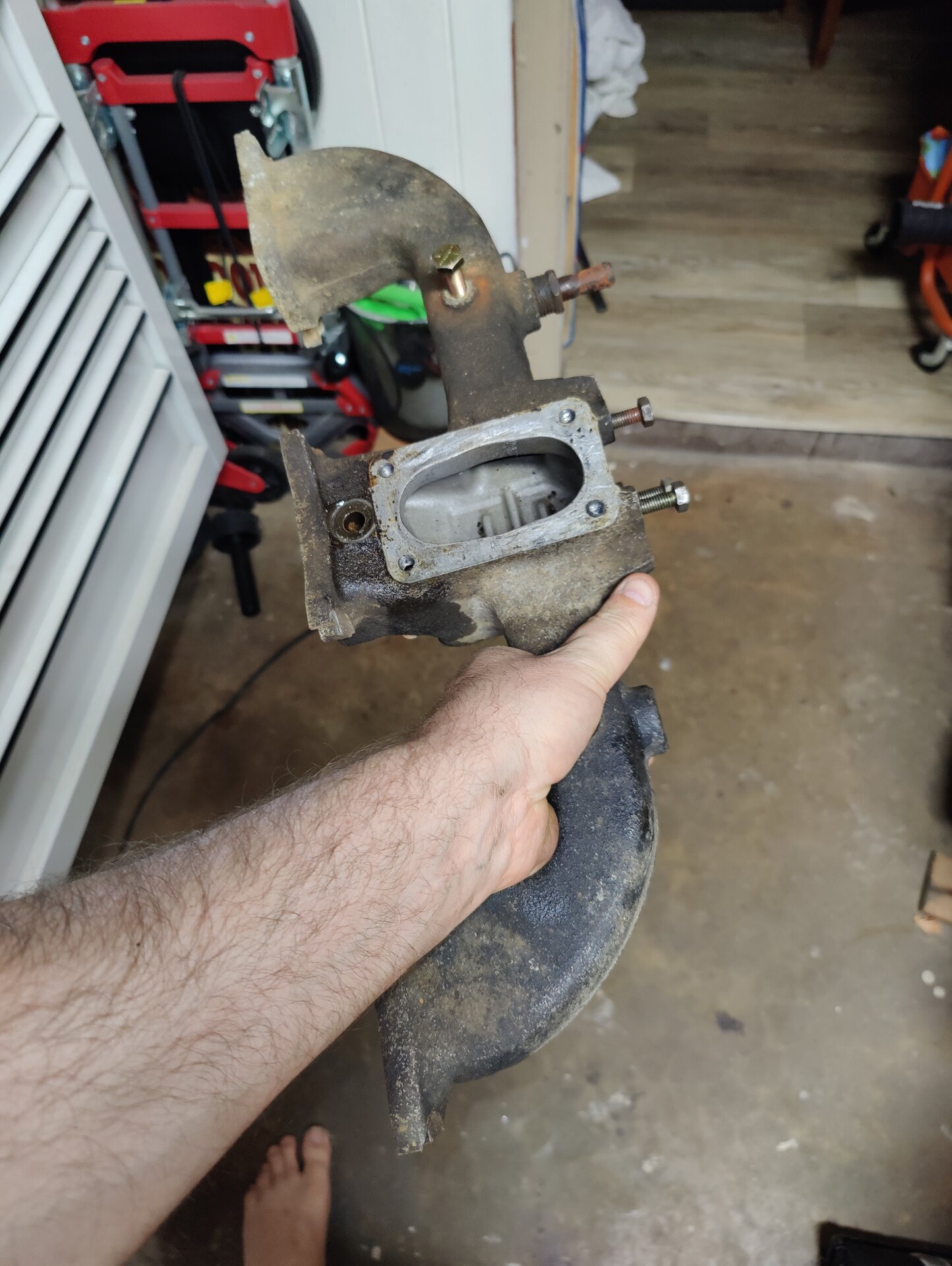

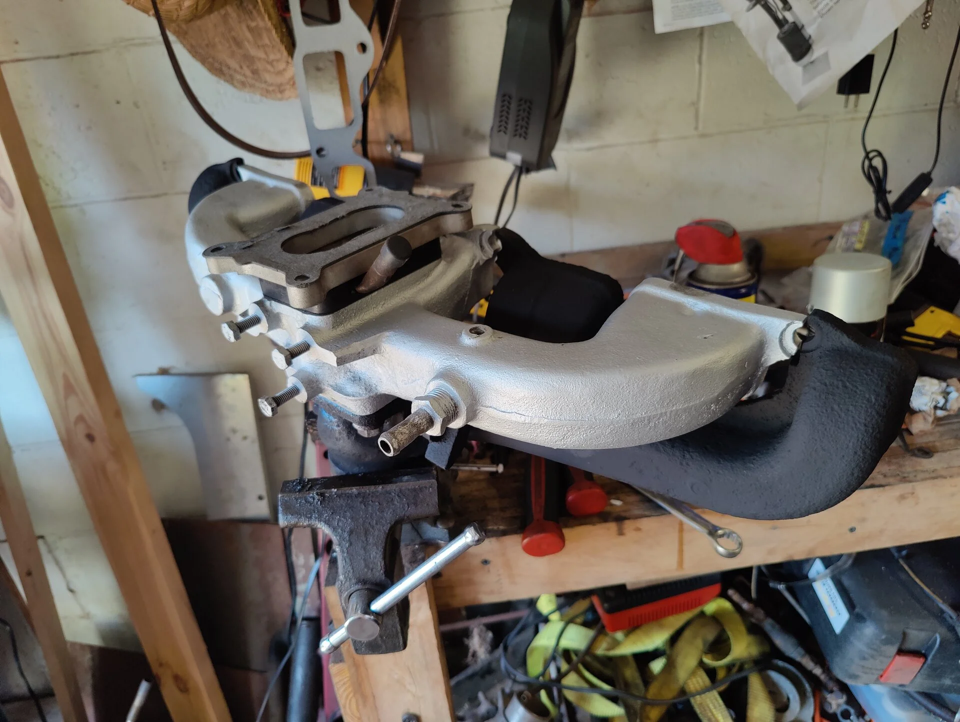

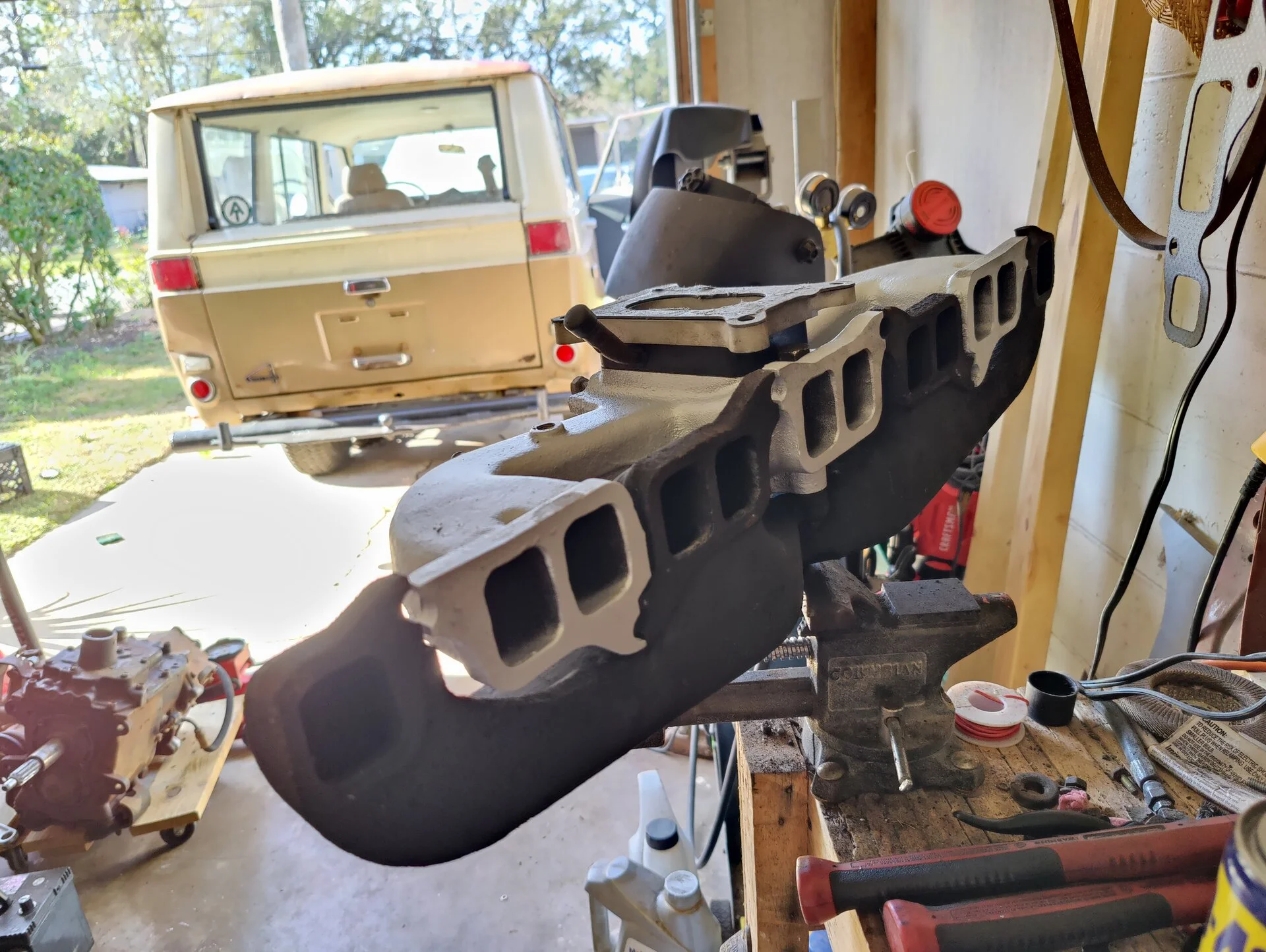

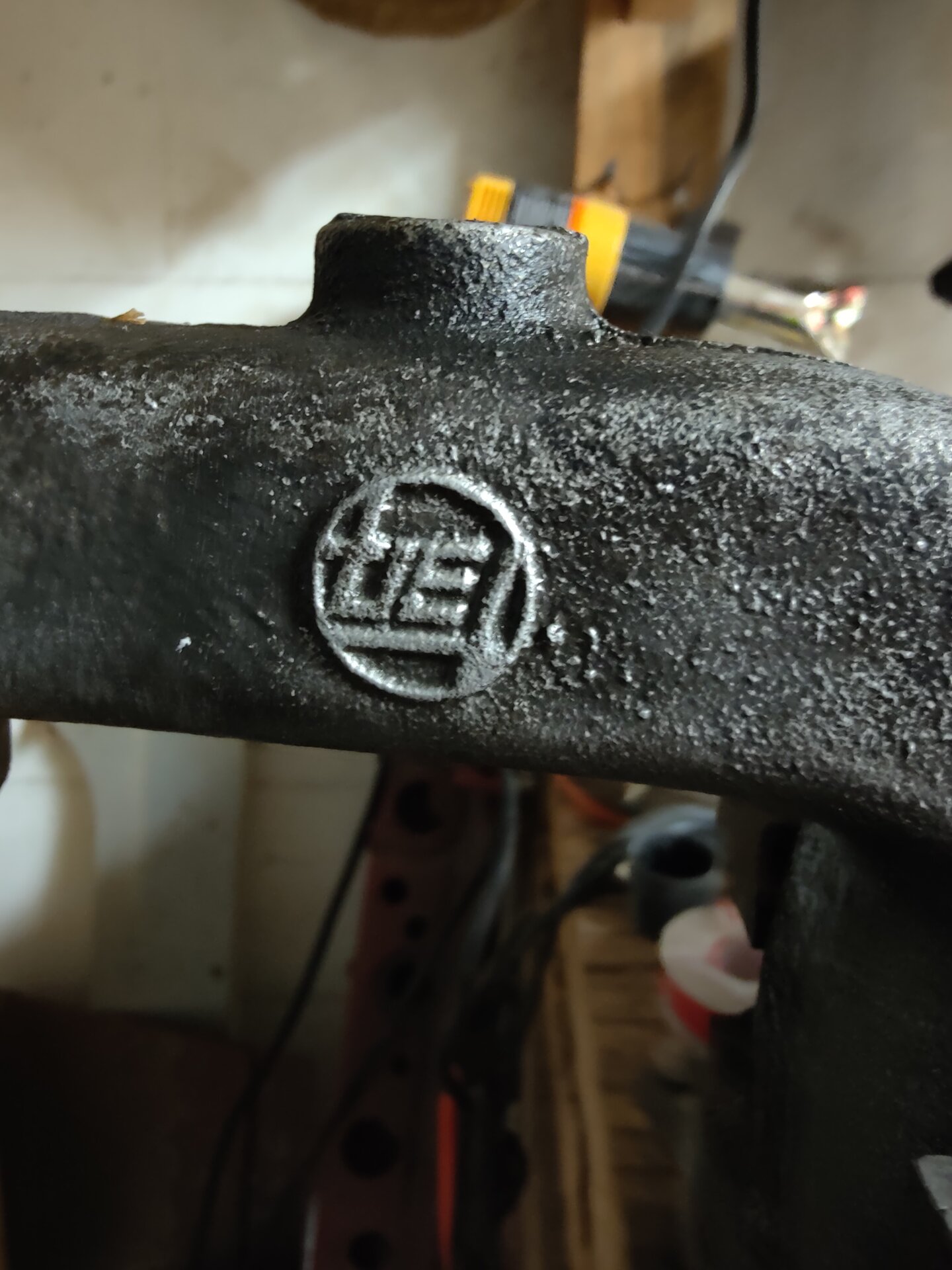

Separated the manifolds and cleaned/painted them. Gonna re use for now. Couldn't find the right studs to replace the boogered up bolts with at the local stores (made an order). Valve cover gasket was hopelessly too small. Might tinker with that before giving up and ordering one with some sort of name on it.
We can get all those parts OEM usually next-day.
All you have to do is ask, no parts order is too small :meh:

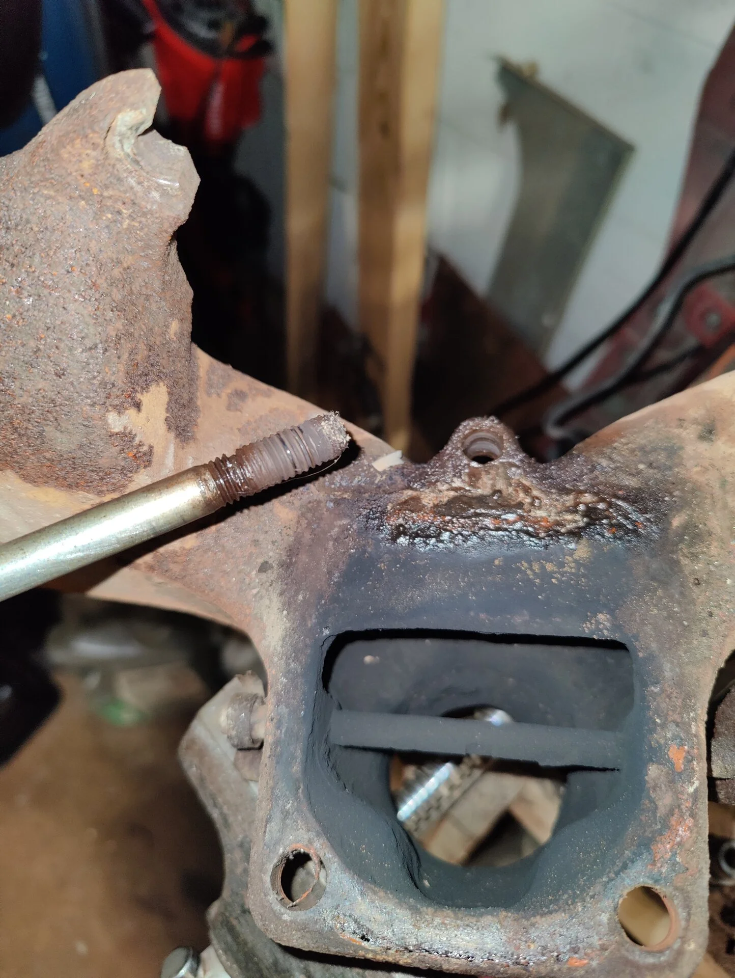

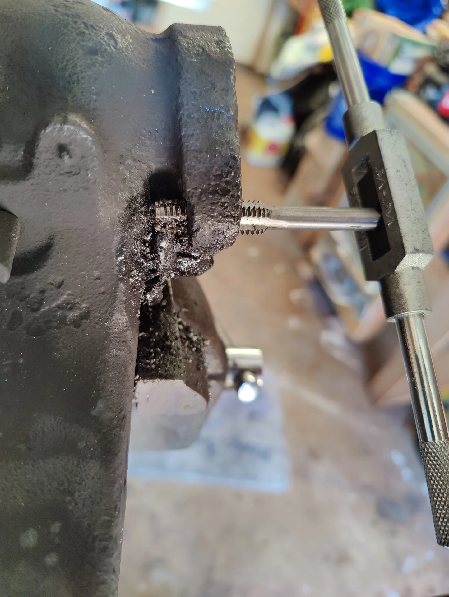

Took a crack at cleaning up the manifolds. Got super lucky and came away with no broken bolts or nuts. The long manifold clamping bolt almost got me but enough heat, lube, patience, and impact guns got it. Found some more PO surprises though. Any guesses what these welds are supposed to be doing? Not much I suppose. Either way,.might be going header sooner rather than later - MIGHT.
As our esteemed colleague @bobm would say, "WTF, WTF, WTF?!?"

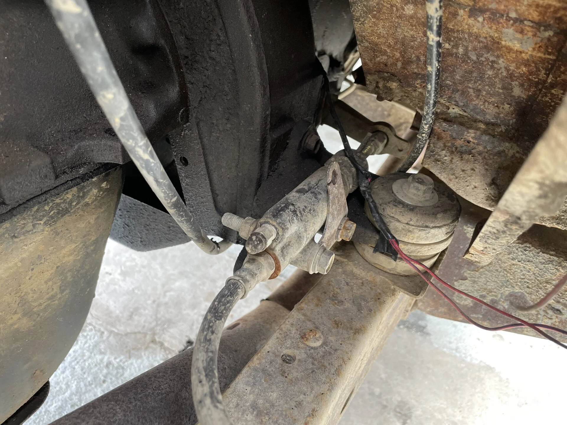

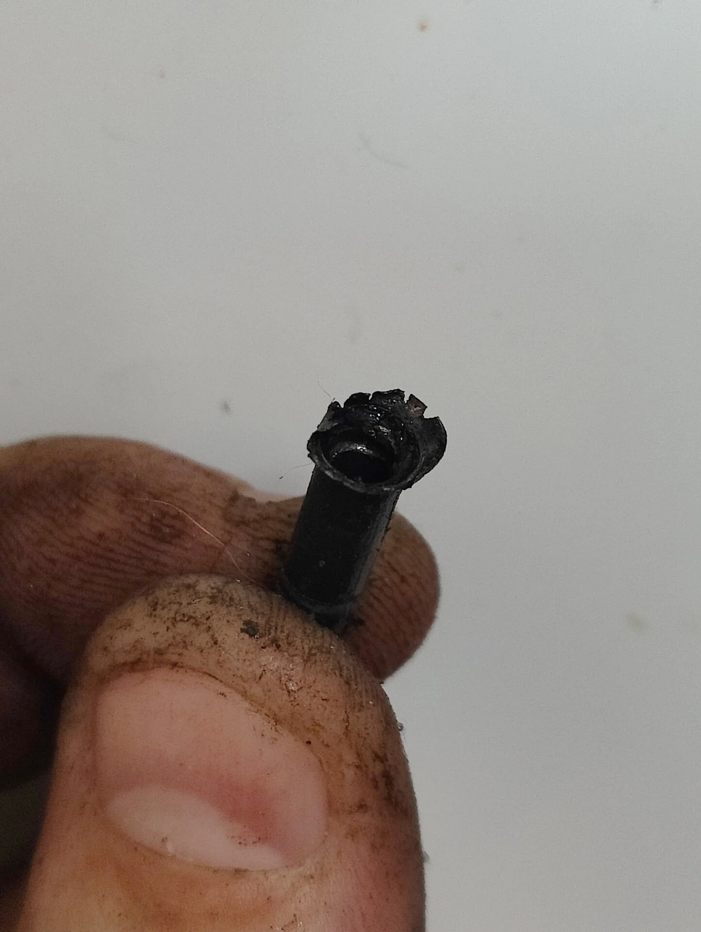

Discovered a while ago that the master would drain itself in about a day. The junction on the front axle was the culprit. Hard lines had recently been replaced (assuming by P/O). Oh boy! Now, I'm no Mr. Double Flare Master by any means but this single flare was the worst thing I have ever seen. Everything seals and bleeds great now.

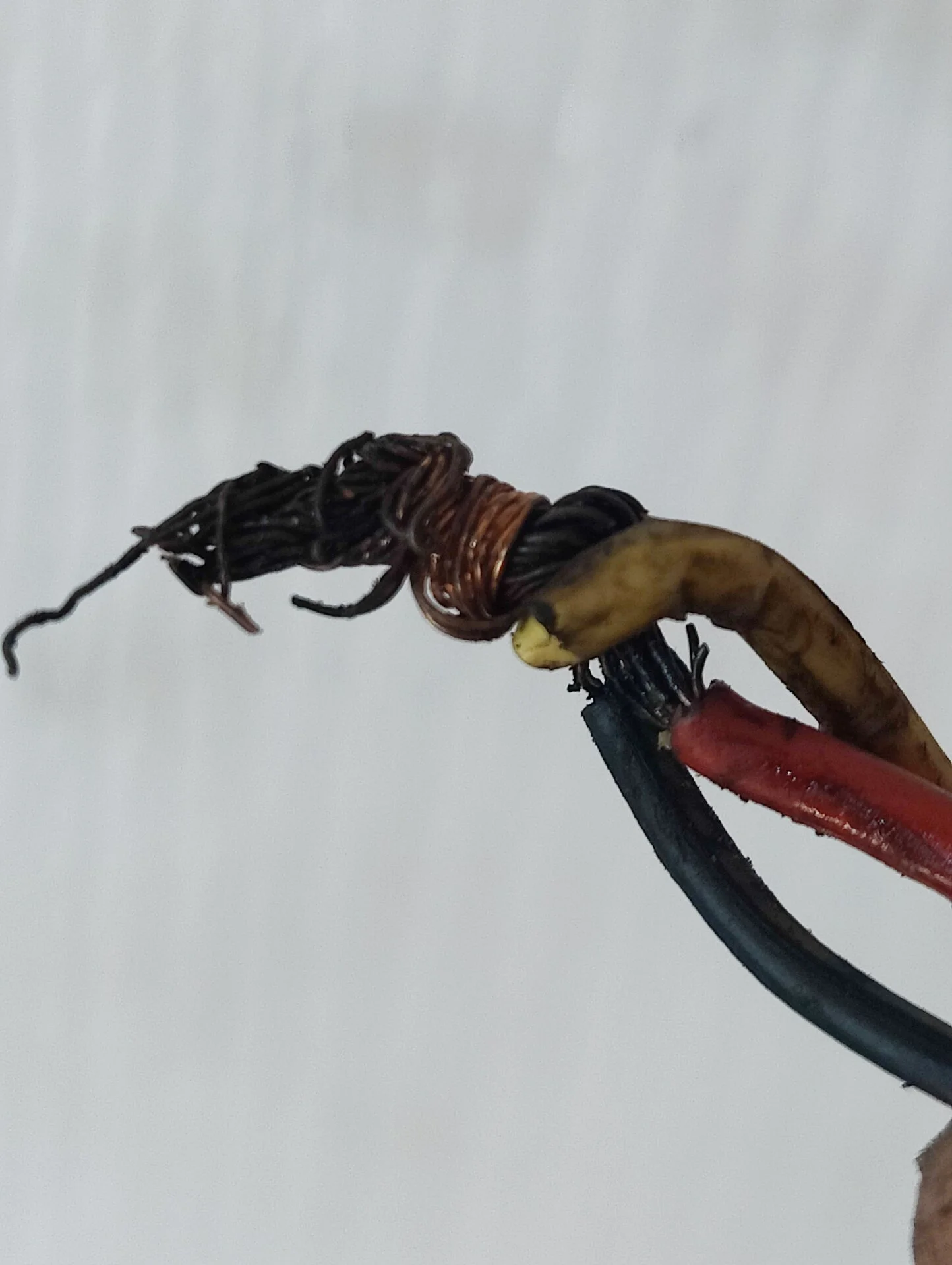

The +12 switch to coil wire was burning. This junk of wiring was hacked to a ballast resistor that was crusty. After unwinding some tape this was the connection I found. No solder, just twist and tape. Anyone have thoughts on bypassing the ballast vs wiring it in? I have my thoughts but I'm curious what other experience says.
Truly amazing what some owners do to their vehicles, those were some good finds.

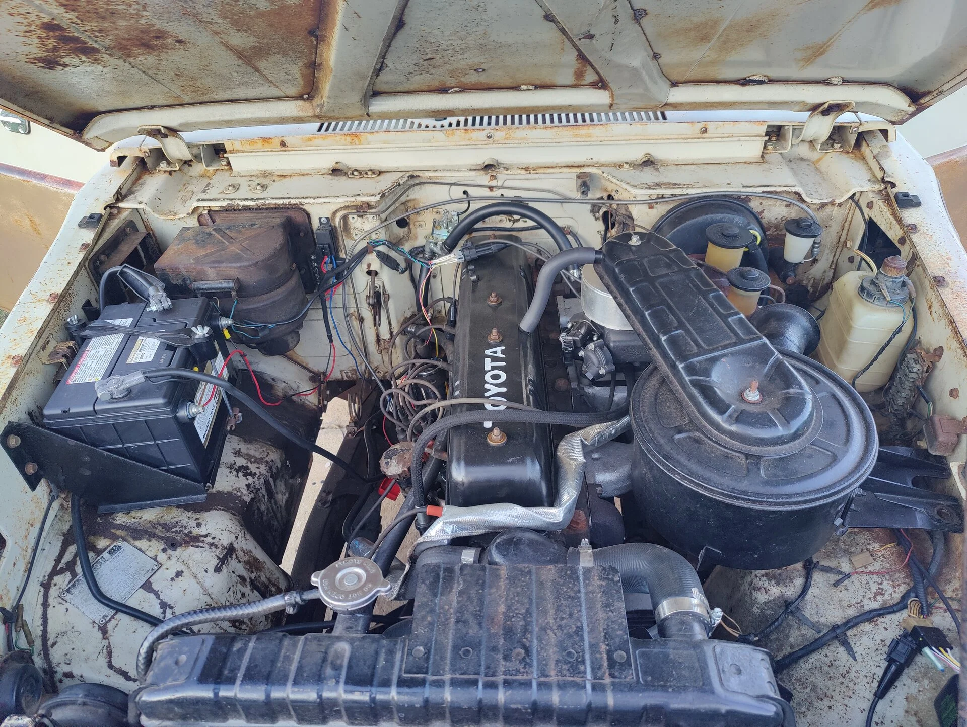

Finally got the engine bay back together. Yes I'm running the cleaner backwards.
Got a good drip coming off the front of the engine while running. Gotta solve that now.
Also, to diag a no-charge condition.
