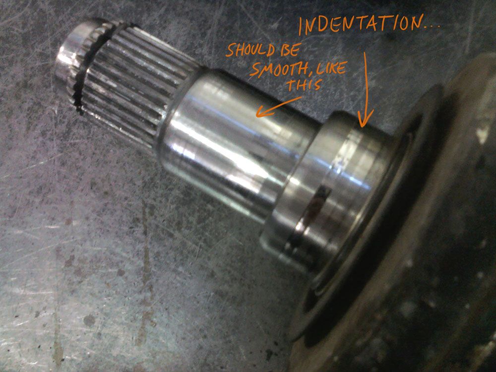

The pre-sale mechanic recommended replacement, thinking the cost would be the same vs. rebuilding the cracked/leaking inner CV boots. My regular mechanic has found that the axels are in fine shape, though. They're going to clean them up and put new inner+outer boots on. Cost to me is $1050.
Uhg... The story continues.
My mechanic IS going to have to replace the axles, because where they connect with the differential, they're 'washboard', instead of smooth. $2200 for parts and labor. The Lexus dealer could do it for $1950 ($550 for the axels $400 labor per side), but either way, I'm now out $2k vs. the original expectation of $750. At least the AHC works fine.
I need to make friends with local Portland LC owners who can train me up. :P
What do you mean by the CVs are 'washboarded' where they connect to the differential? I have never heard of this happening on a cruiser/Toyota and unless the cruiser is experiencing weird front end symptoms I would NOT replace the axles. Only reason to replace are if your getting vibrations from them, or you hear clicking. You probably just need a reboot kit and your mechanic sounds like he just wants to take the easy and more lucrative route and just swap the CVs. Toyota CVs are well built compared to others.
Sounds like he's taking you for a ride o_O
Edit: Just reread that you stated that the boots were almost gone. If that's the case maybe they overheated and warped? All weird signs for only 120k. Is the vehicle with you so you can look at it yourself? Maybe post some pics?

My mechanic offered to let me come and see what's what, so I'll get some pics tomorrow for curiosity's sake, if nothing else. I've gone ahead with the job at this point because his original goal WAS to reboot them, and I believe he's honest (been working with him 10 yrs)... that, in combination with the pre-sale inspector recommending the axles' replacement, leads me to believe it does in fact need to be done.

Here's a pic of my inner axle where it connects to the differential. The washboarding my mechanic's talking about is noted in the photo. Where it should be smooth, there's a shallow ring worn into the metal. I'm hoping to keep these original axles for a bit so that I can learn more about how they work/go together. If someone who knows more about these axles than I feels they can make use of them, you're welcome to have them. Just need to see if keeping them is possible (they may be going back to Toyota to get remanufactured, in which case keeping them would incur additional cost).
Doesnt look bad to me at all. I'd see if you could keep them and turn them into spares or reboot and sell them to a mud member.
