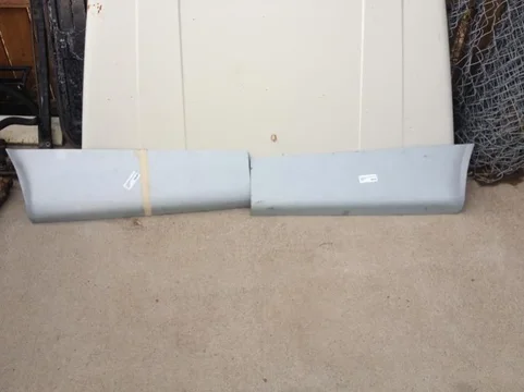

Front bumper is in good shape. The rear is complete, but needs a little bending.
DS & PS lower rear quarter panels from Australia.

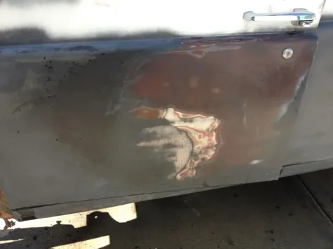

Meanwhile, Pighead hands me some 1000 grit sandpiper & the next thing you know I'm feeling like Daniel-san as I make small circles with my hand saying "primer off".
The paint beneath the primer was GORGEOUS. I couldn't understand why anyone would ever paint over it. As I moved further down the door, I saw the bondo...
