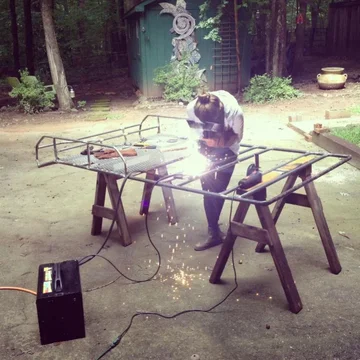

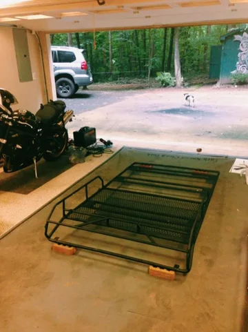

Today's progress. Before the thunderstorm rolled in and the power went out.
Great progress today! Hope to see it mounted next week.
Do you plan to paint or powder coat?
Yeah i was going strong then the thunderstorm came from no where and I had to stop. Hopefully i can do some more work on it tomorrow.
I think I will just spray some paint on it. Do you know anywhere here in GSO that does powder coating. Might be interesting to get a quote at least.

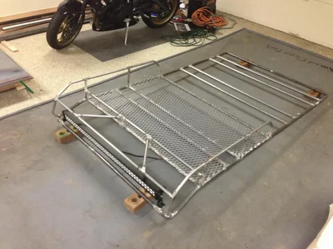

Ok so the basic rack is completed. I'm goin to add som more tabs for light and mount a solar panel later on. Weight is about 75lbs so not to bad.
I started working on the mounts today as well. Hopefully it will be on the truck by next weekend.
Your welds sucks she said and took the welder out of my hands....
Final result.

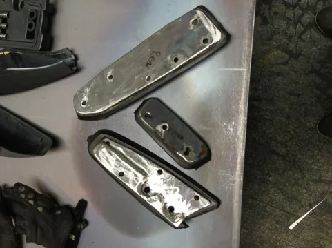

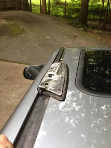

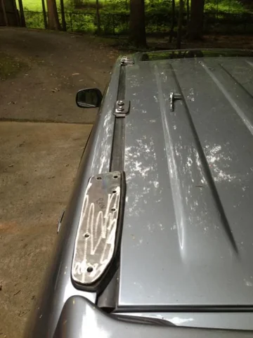

I spent a couple of hours on the roof mounts today. Or the base of the roof mounts I should say. They came out sturdy and pretty good. I designed them so they can use the original seals. Slow progress working on the mounts. At least I got the the base for all three mounts on the left side done and I cut out the pieces needed for the right side. I'll finish up the right side on Wednesday hopefully... and then do the actual mounting fixtures on Thursday/Friday so I can test the rack this weekend. Or at least that's the plan.
Here are some pictures.
Front/mid and rear base
Front left base
Left side. They came out very sturdy. Should easily handle the weight I'm going to put up on the rack.

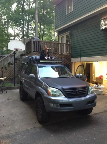

I finally got the roof rack mounted to the truck. I threw the RTT on there and the LED light bar as well. The wife approves.
Tomorrow we will test it on a weekend expedition to the Appalachians.
//Marten

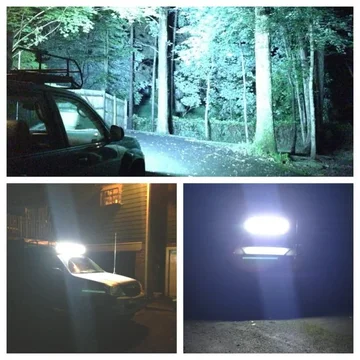

That is some serious light output. Looks good.

Yeah it hurts your eyes looking straight in to that thing :cheers:

Light bars are the way to go. I used a relay and wired mine to the factory fog light on the tree and used a Toyota button for my fogs in the bumper. LOVE my light bar. Night to day bright!
I tried to plug them in and have them controlled by a switch and the high beam but that switched ground was to much of a pain in the ....
So now I have an isolated electrical system and only control them with the switch on my center console. Works great.
Yep, saw your switch setup and get it. I didn't see all those switches on ebay so I went a different way :)
