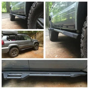

Sliders mounted
Wow, 4 arms on the sliders - must be super strong. You jack it up using them?
Is the measure twice, weld once working better than it does when I cut wood? I can just imagine the angles being slight out of square or other things not lining up perfectly when I try to stick it on the frame...
Those sure are unique looking.
I was thinking of ordering these cheapies and adding the extra length by welding a kickout
and covering that area with a step plate anyway. Do you think that would work?
How much do those bad boys weigh?
Yeah I used 3 jack stands and one lift to get them up and positioned correctly before welding them on.
Haha the measure twice thing is not always working. Measure 5 times is probably more accurate. But in the end all angles lined up perfect. Just a matter of patience.
I think does sliders will work just fine for exploring and light rock crawling. I was actually looking at does myself. The kick out is great for some extra clearance to unwanted dents.

I'm interested to see how those boxed sections do on the rocks.
The sliders worked very well yesterday. Hit a few rocks with them. I skidded of a rock and fell of it and the boxed in section of the bump out took the entire hit. I just lost a little paint. They also made a loud and clear "BING" echoing in the forest. So you cant really miss when they take a hit. Overall they seem to work great.
The sliders worked very well yesterday. Hit a few rocks with them. I skidded of a rock and fell of it and the boxed in section of the bump out took the entire hit. I just lost a little paint. They also made a loud and clear "BING" echoing in the forest. So you can really miss when they take a hit. Overall they seem to work great.
Glad to hear it man. Good work :D
