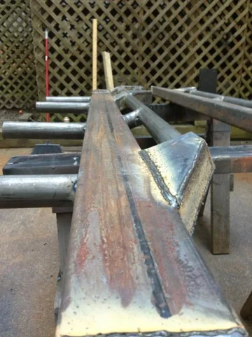

Yesterday I started cutting out the pieces needed to do the rock sliders. I got a general idea of the design (similar to the FJ X-wing and EVO sliders for the Wrangler) and how I want it but I might change some things along the way.
I have left the idea of bolting on the sliders. Driver side have tons of holes to use on the frame but the passenger side is a little empty. I dont feel like adding a lot of weld screws either or altering the design (think metal tech sliders) to add more weight.
So I will just weld the suckers straight to the frame instead.
I was able to cut out the parts needed for the sliders frame/structure yesterday. And will cut out the rest of the parts once I got this tacked up.

Testfitted some parts
[URL="http://i1293.photobucket.com/albums/b585/Marten_Medin/image_zpsafffa9eb.jpeg"][URL="http://i1293.photobucket.com/albums/b585/Marten_Medin/image_zpsafffa9eb.jpeg"][/URL][/URL]
[URL="http://i1293.photobucket.com/albums/b585/Marten_Medin/image2_zps993db339.jpeg"][URL="http://i1293.photobucket.com/albums/b585/Marten_Medin/image2_zps993db339.jpeg"][/URL][/URL]

With a lot of help from Bretthn (thanks Brett!) I was able to get some good progress today. I have some welding and boxing to do but am pretty close to have the actual sliders done. Then it's just a matter of adding the legs and welding it on to the frame.
We continued to have some good progress with the sliders today. Brett helped out today as well (thanks!). I am happy with the design we did on the sliders. Kind of a unique look compared to other sliders.

I had some pretty good progress on the sliders yesterday. Was able to get the mounting brackets and legs welded on to the sliders. Took some time getting them positioned but it was worth the hassle in the end.
Whats left to do is to grind down some edges and clean them up a bit. Throw some paint on and weld them to the frame.

I'm interested to see how those boxed sections do on the rocks.
Me too. Probably not as practical as round tubes. I might not slide as well if a rock hits one of the edges. But I am sure they will hold up for the extra abuse.
So after a looong evening I am finally done with the sliders and I managed to get them welded to the truck as well.
