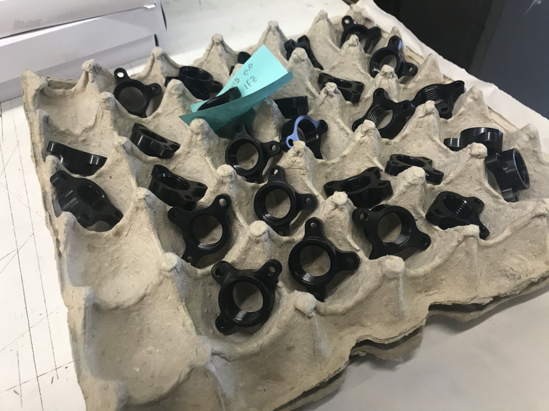

Nothing major but the oil drain adapters are back from anodizing and off to the laser etcher.
