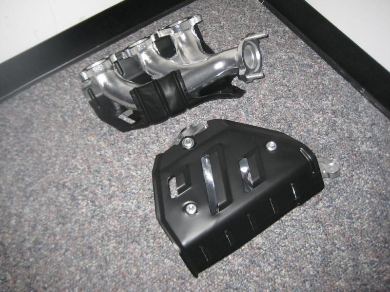

I dropped my manifolds and heat shields off yesterday for coating.
Titanium Ceramic Finish Heat Tolerance 2000 Degrees
The vendor also has a 2000 F black, but strongly recommended the titanium finish as being more durable. Will be $300 for all 4 pieces.
I will coat the other parts you mentioned if they are not already coated.

Faux ceramic or Swain ceramic coating?
My exhaust manifolds in both black and silver ceramic. They both still look like this after 6 years and 100k. Can you tell which one it is?
