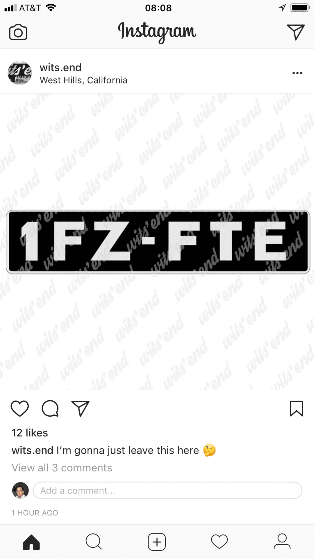

Oh I guess everyone already knew Wits End/Joey/NLXTACY was behind the turbo setup. I thought for sure that was going to be a much bigger reveal. Ha!
*crickets*
Just one more thing for everybody to pester him about :flipoff2:
