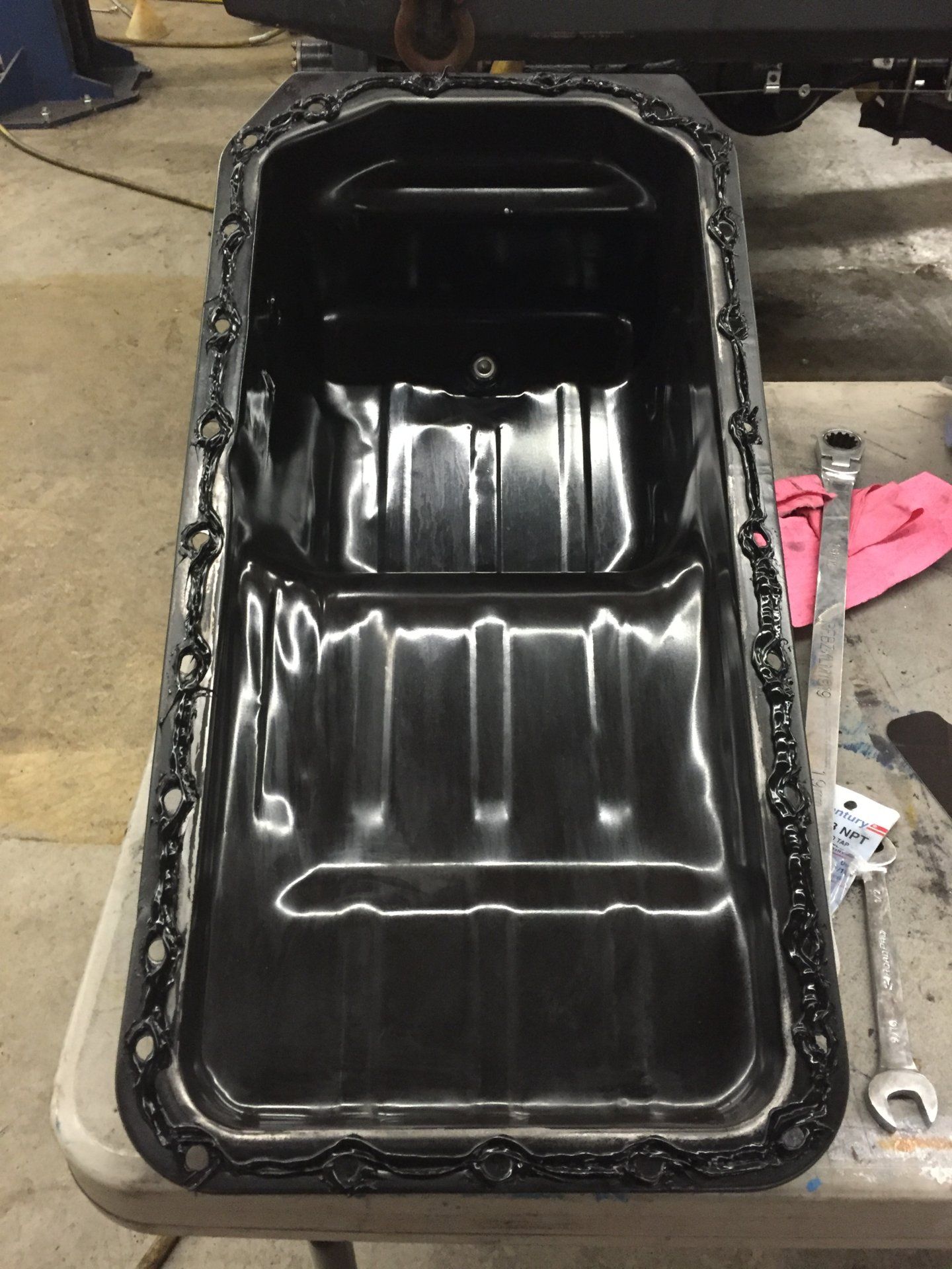

I'm mostly in, depending upon how bolt on is bolt on? From past turbo install threads, I know that there was drilling into the oil pan for the oil cooler? Does this kit involve something like that, or is this mostly going to be removing exhaust manifold, adding in some plumbing, there, etc. Apologies for my ignorance--just wanting to make sure I'm clear on the work involved. Thanks for putting all of this together.
The drain back valve was discussed and illustrated a page or two back. Most here in past have welded on that bung but this kit has a no weld option. Yes you are still drilling pan, adding adapter ring, and tapping three holes to secure it to pan.
Post 515
The drainback is not for an oil cooler it is to oil the bearing inside the turbo. The turbo has to have oil or the bearings would burn up in a matter of minutes. You will have to drill and bolt on a threaded bung for the drain hose but everything is being done to keep it as bolt on as possible.
Same as my GT2056 on my 3B:
