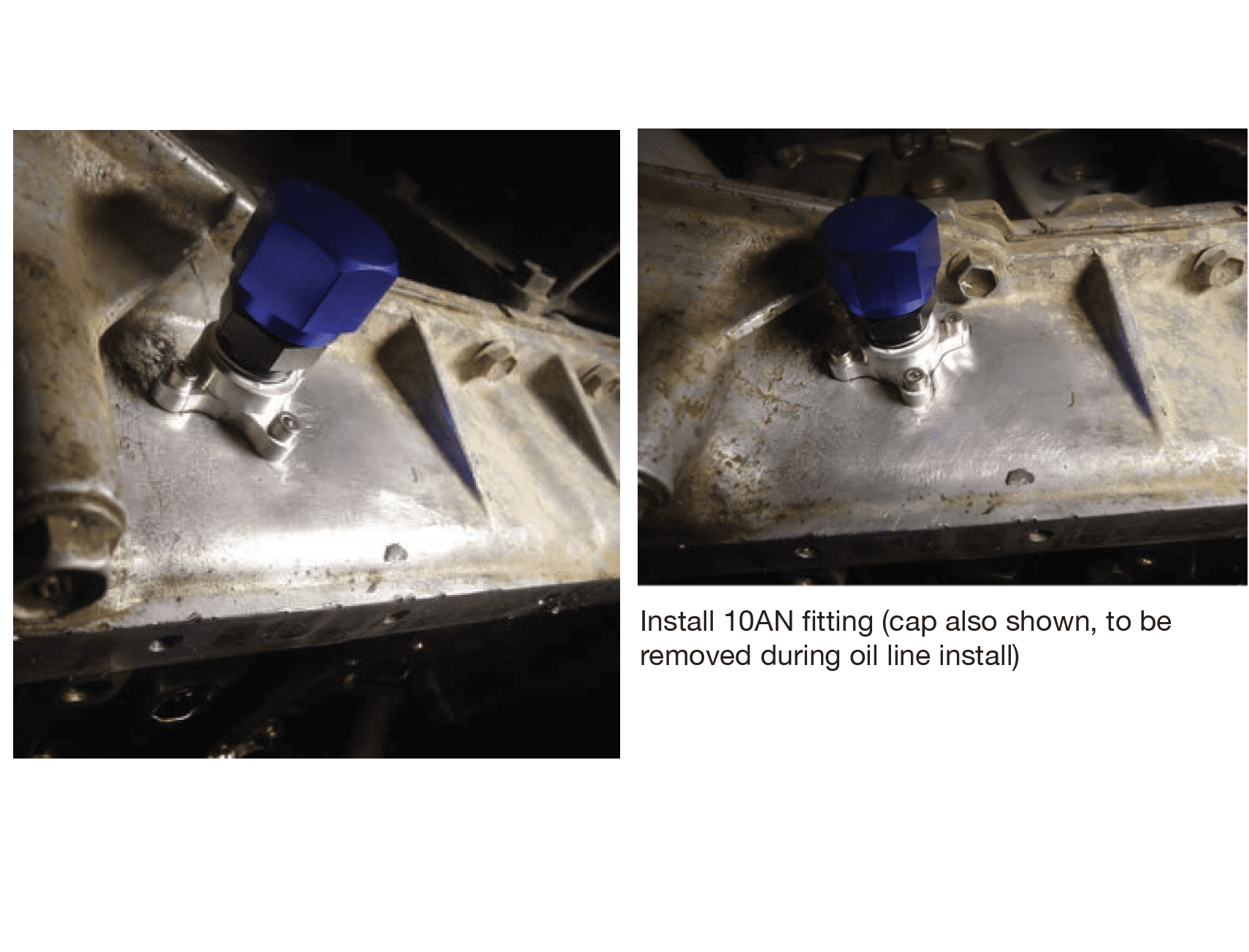

Like I mentioned earlier it might be a while between updates. The shop has multiple other projects that came before this one. But I am very grateful they are even doing it. And it certainly takes time for ideas to evolve especially since we are talking about making this a bolt on kit with hand tools.
For example the oil draining back valve. We want to use only high quality hose with AN hose ends. This is a little harder when you can’t just TIG an aluminum fitting to the oil pan. So you see the progression and documentation of how things all come together. This might not be the final outcome but it gives you an idea of the process and how things are being worked on behind the scenes to provide not only the kit but documentation and even the drill bits and taps to do the install.

View attachment 1564122 View attachment 1564123 View attachment 1564124
Does the oil return fitting need to be above the oil level in the pan to function properly? I think that the bolt-on bung is a clever solution, but my simple mind wants a more simple solution. Also, I'm assuming since it's cast and guaranteed to be oil-soaked that welding to the upper pan is not a likely solution? I understand that welding is not "bolt-on" - I'm just thinking out loud here.
You'll see in that post I mentioned having the drain TIG welded on. If that is something you have the ability to do you certainly can. I have the drain TIG welded on my oil pan, but I also had the pan out of the truck. I think 90% of people are looking for a turbo kit that they can do in their two car garage on a weekend. I am not sure what is going to be more simple and still work properly. I know some people use banjo bolts but turbo manufacturers will not warranty a turbo using a banjo bolt and it is well known that they are a poor solution...
Here is a quote from "Turbochargers" by Hugh MacInnes:
"OIL RETURN-Oil entering the turbocharger is relatively air free. As oil passes through the bearings with the turbo running as high as 130,000 rpm, air is whipped in and the oil looks like dirty whipped cream. For this reason, use a drain line from the turbocharger that is much larger than the oil-supply line.
The line must angle downward at all points and have no kinks or "sink traps". The drain line must dump oil to the crankcase ABOVE THE OIL LEVEL. Running the oil line below the oil level causes foamy oil to build up in the line and back up into the turbocharger bearing housing. The only place it can go from there is through the seals."
Pages 75-76
