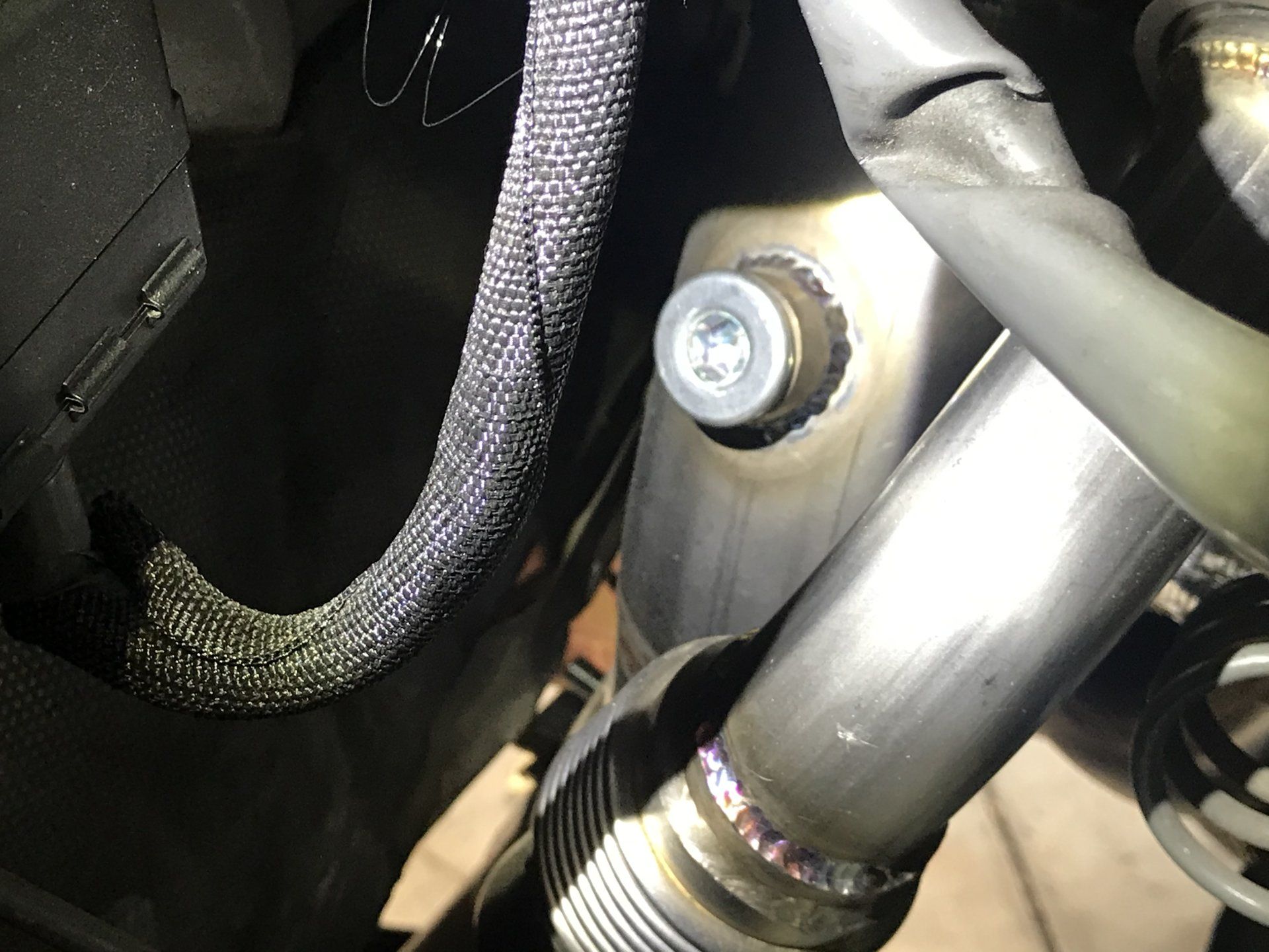

What’s the latest thoughts on ceramic coating the j pipe and down pipe? Any harm in doing so? Any real benefit? Seems so easy to do before install.
(Already coated exhaust manifolds and new heat shields as well as put in new motor mounts last year).;)
It’s not like the Northeast, but I live in a place that gets some snow and sees road salt. How much snow/salt is too much for running your downpipe blanket? Will ceramic coat help the pipe live longer under an occasionally wet blanket? Otherwise I guess I can try building heat shielding in the places the factory had it.

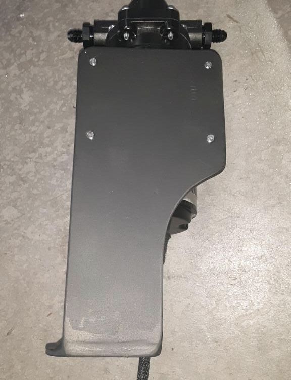

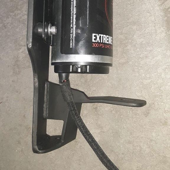

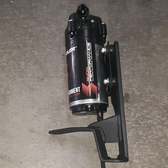

Trying to make decisions for mounting the methanol injection pump on the turbo test mule. It’s all cut, welded and painted so I can install it and get the hoses run and start playing with this bad boy!
View attachment 2099988View attachment 2099989View attachment 2099990
Are you mounting the pump where the 2nd battery location would be? I have a 2nd battery so I'm thinking maybe the right rear q panel space for the pump and AEM 5 gal tank with a filler of some sort.
